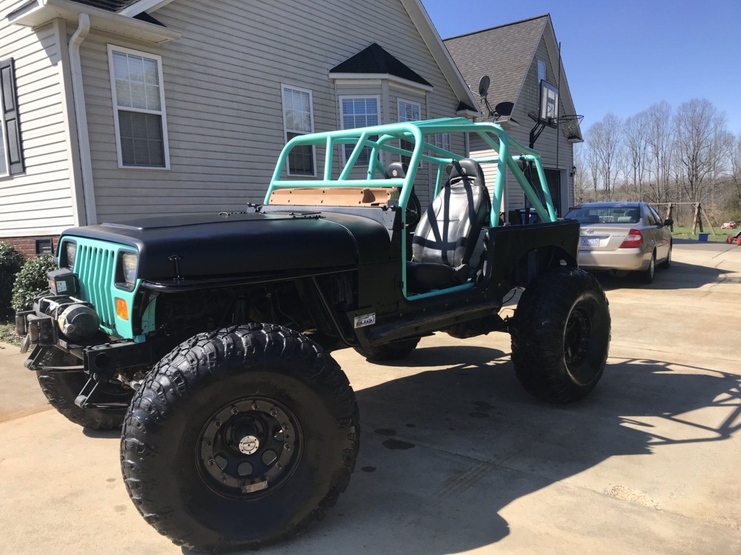

I’m giving in and letting everyone see it so I can get all the criticism out of the way before AOP. Gonna go in order of the progress. If you’re on FaceSpace you’ve already seen it. So here’s how I got to that point.

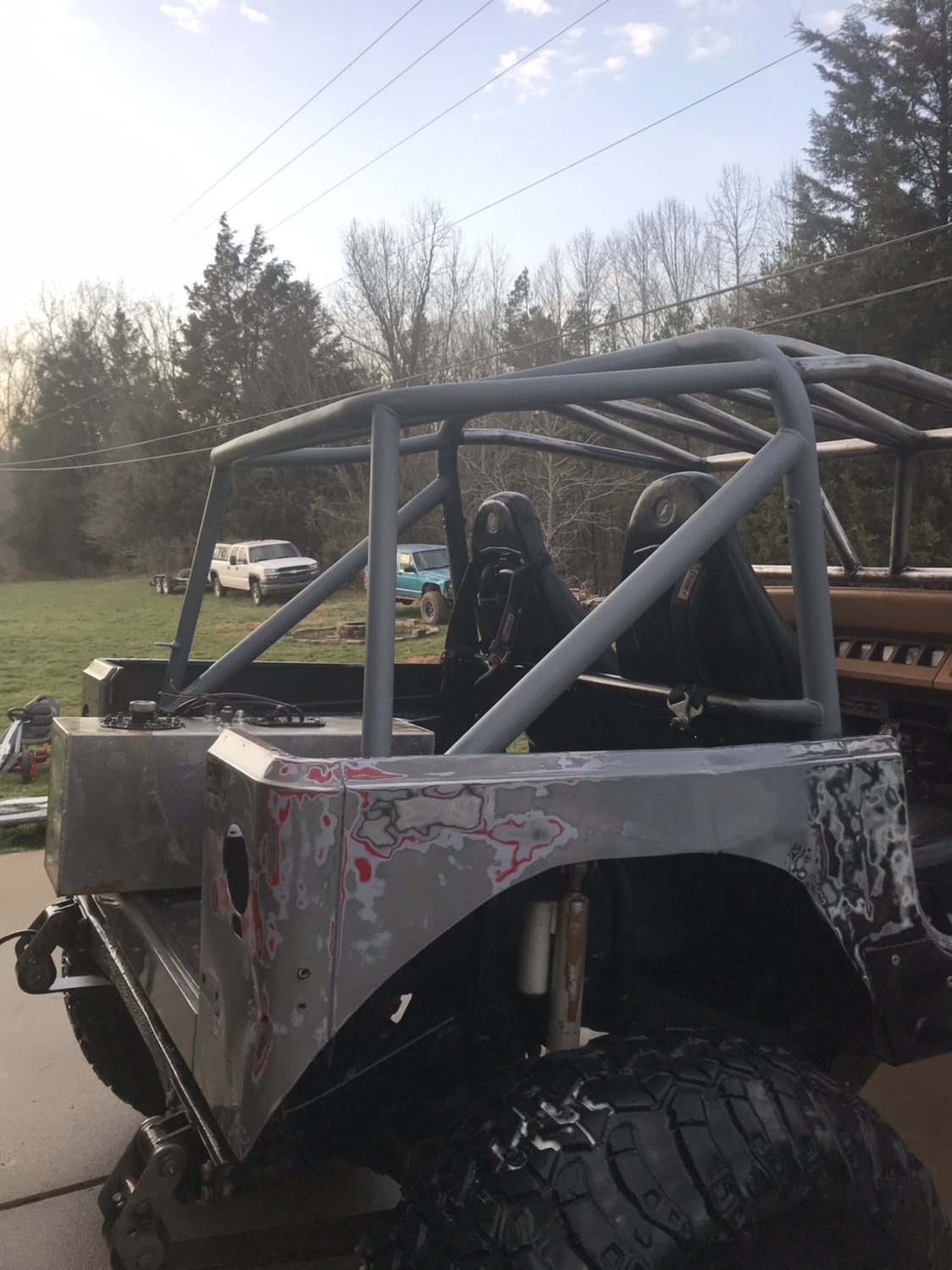

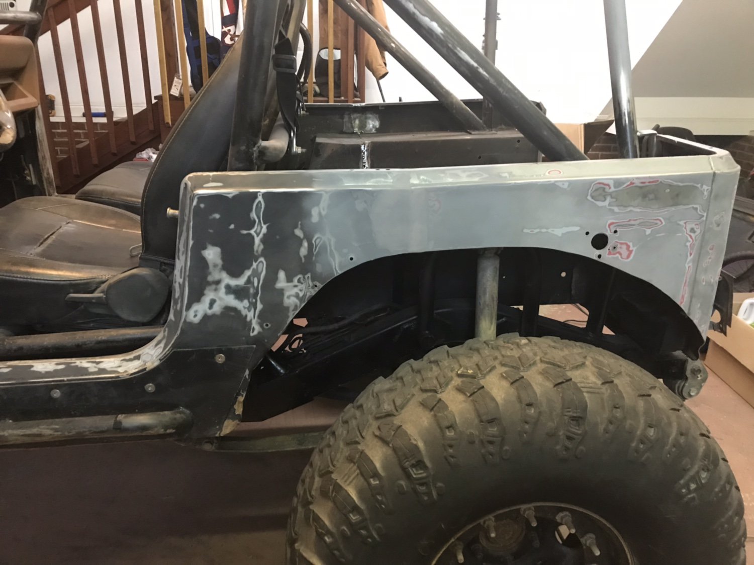

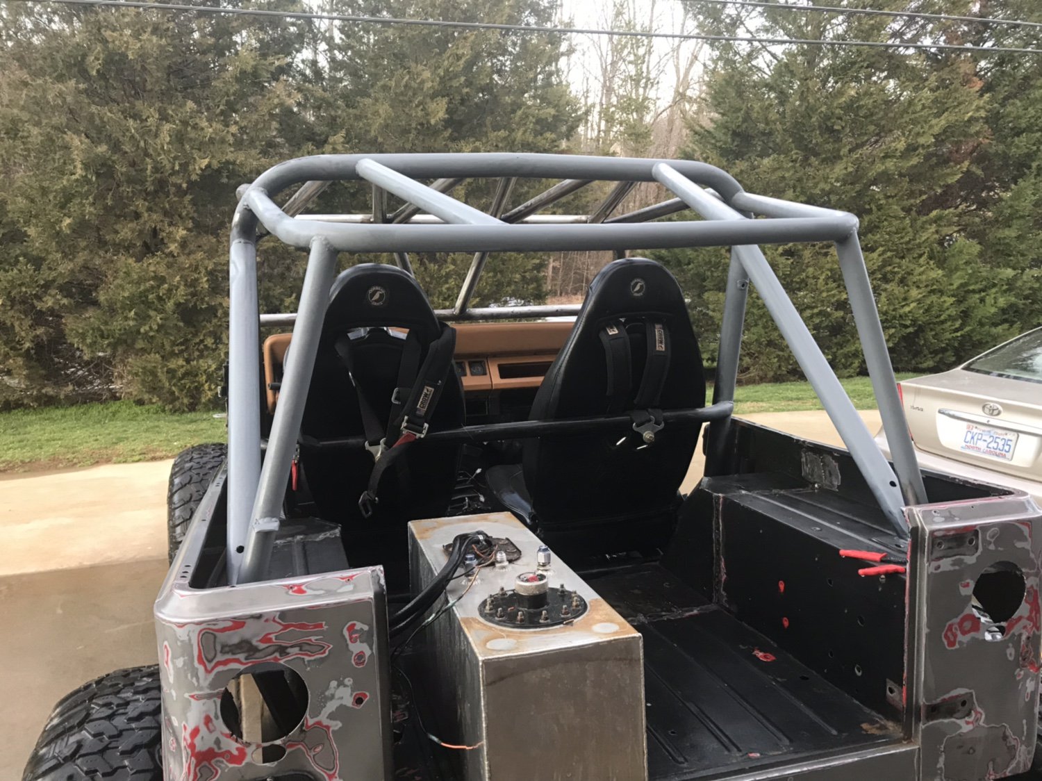

New tub all patched up in temporary primer. I cut the wheel wells the way David had them and I’m very happy with that vs the comp cut.
I set the fuel cell in and wired it up all sketchy like to pull it out and wash it good to get all the dust and contamination off before primer.

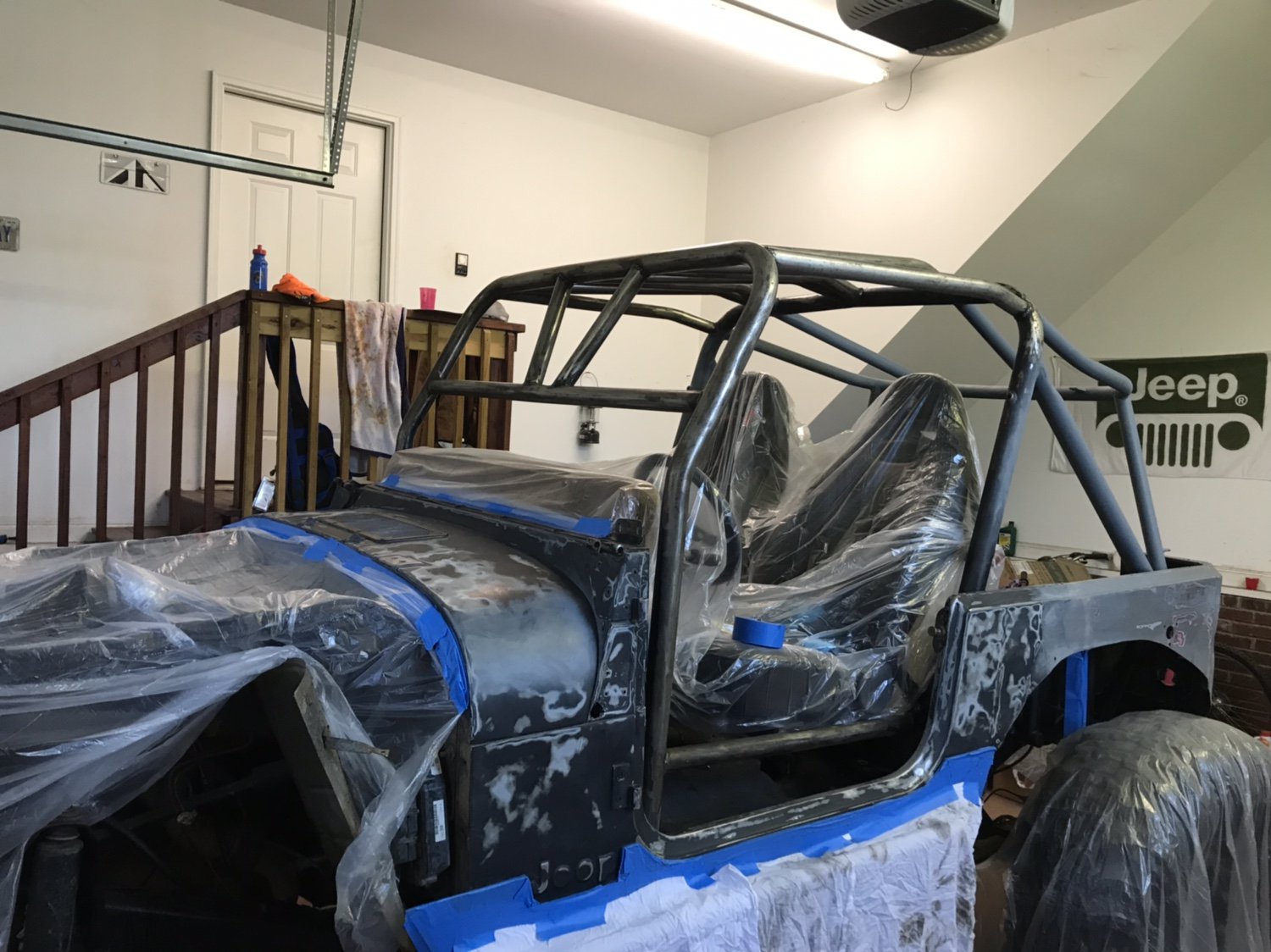

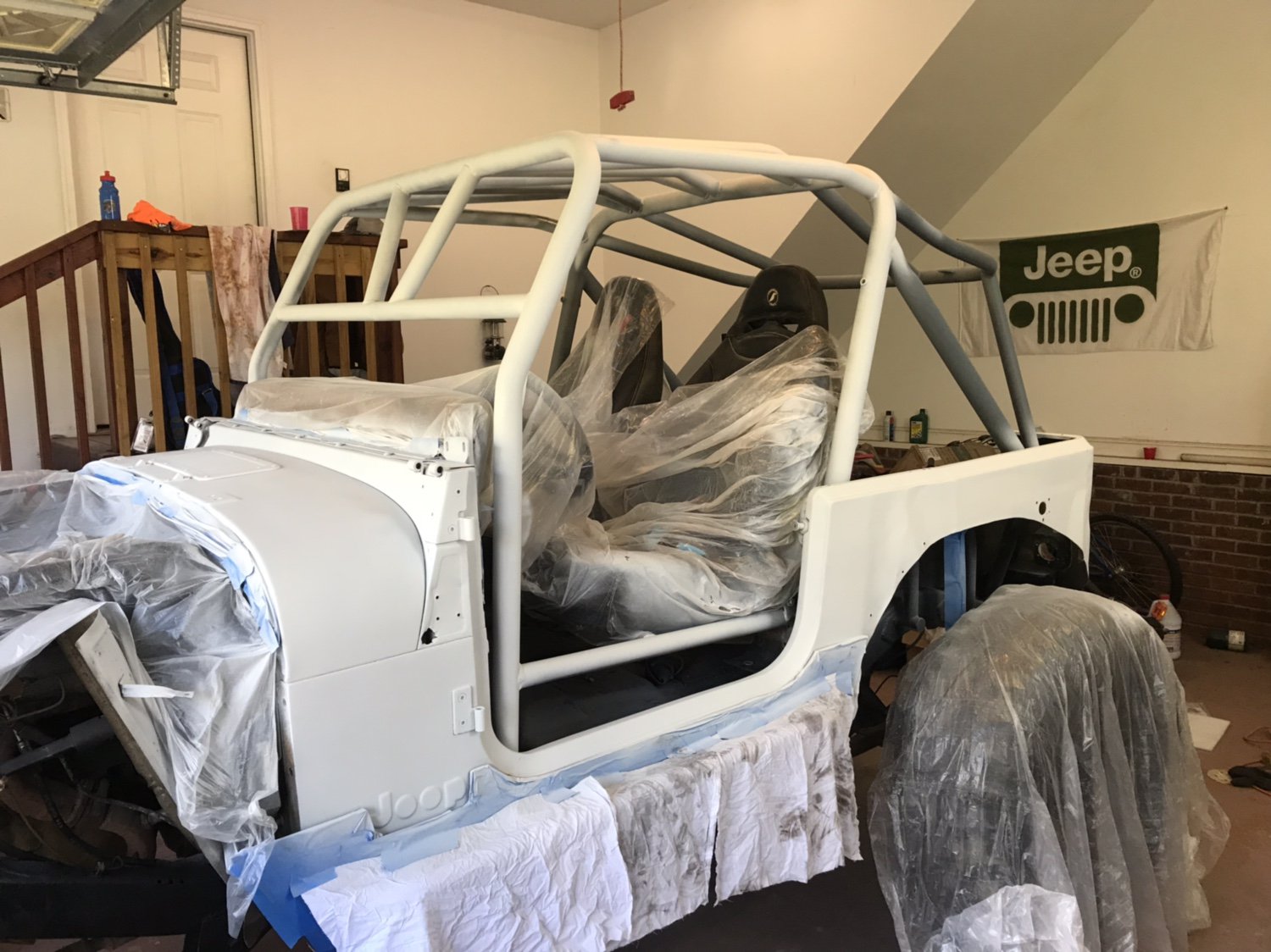

Pulled it back in to tape it up and spray primer. I sprayed the cage and the body in white primer at the same time.
Stripping the cage down to bare metal had me at a point where I wanted to walk away from this project or take a long break, but that wasn’t an option.

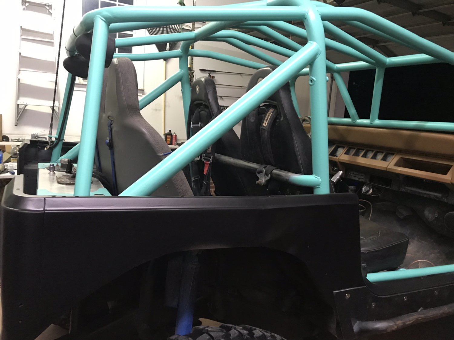

I taped the body up and began painting the cage the wild color me and the wife chose. It’s Sea Glass Green. And yes I like it. A lot. And so does my wife, and she hasn’t even asked how much money I spent on all of this so happy wife=happy life.
Several coats were applied, and painting the cage was very hard to cover every nook and cranny. I used canned spray paint for the cage. Funny story, I bought the wrong color at first because I have a color deficiency for green/blue and it all looks similar to me. Long story best told in person about that, ask me at AOP. I bought Carolina blue at first by accident.

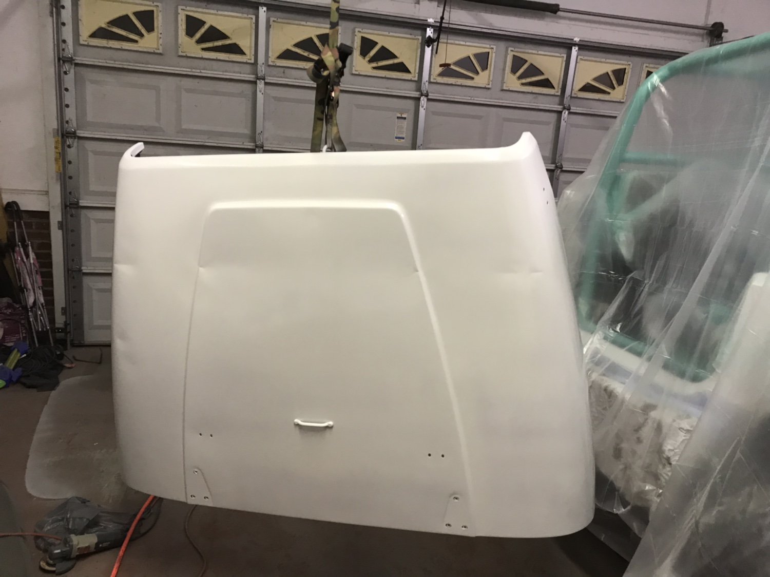

Since I’m not painting in a dust free environment, I decided to hang the hood so it would not be such a large horizontal surface to collect dust in the wet paint. This had its drawbacks but work well enough. Rigged up some sketchy stuff with ratchet straps.
I also decided to prime and paint the fenders the same way instead of rattle can.

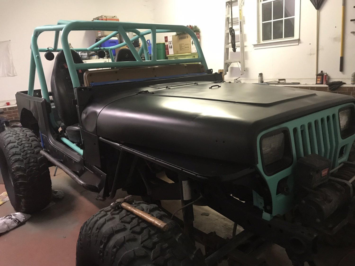

The next day I washed and dried the Jeep again and laid down some black.
Thanks to @Chris_Keziah for letting me use his air compressor when mine decided to give up the ghost.
I also removed the grill, sanded it down and painted it to match the cage. Already gotten some hate for that, but I think it goes together well and makes it pop.
In this pic it looks like it’s a different color but it’s just the light.

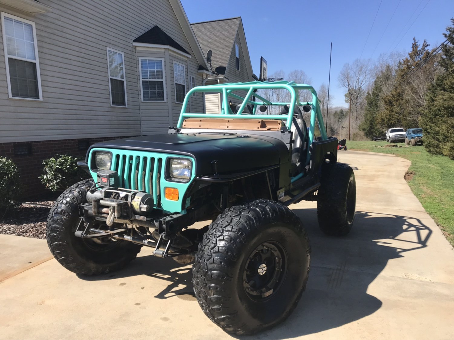

Got the hood back on. Had every intention of getting the dent in the cowl out but forgot and said screw it.
Then today for the first time, I got to see it outside in the sun light. I cleaned it up and even felt like some tire shine was in order.
I also added a Boss Rebel Bluetooth stereo. It runs off my phone but it also has a volume knob in the dash so I don’t have to fumble with my phone to turn it down. It rocks out, loud! And clear too! I can’t even turn it half way up. 4 speakers, very compact, weather proof, for $100. Money well spent.
When I had the cage stripped down I welded some tabs for the rear speakers, and a tab for a CB antenna.
I also added a Beard rear seat with child harnesses for the kids. It’s tight but they have plenty of room. An adult would not be too comfy there but could get a ride out of a trail if needed.
I also painted the fuel cell cradle the same as the cage and grill.
And of course, some Dale Yeah stickers!

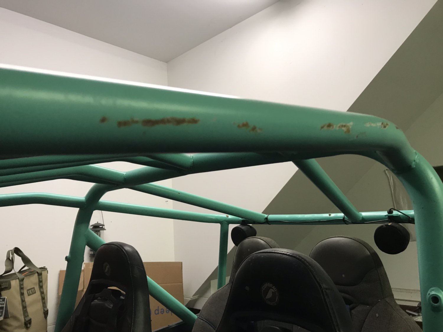

When I got the Jeep, the tan dash had been spray painted black, but it was peeling off everywhere and looked like dookie. David gave me a mint dash and all the other trim parts and I replaced that before I started all this.
Well, when I took the plastic off for the first time after paint, instead of being excited I was instantly disappointed because the tan dash sticks out like a sore thumb. So I will strip all the paint off the other dash, and use the real vinyl die to paint it black the right way and install the black dash, but this will be after AOP.
I still need to install the CB and give it a good bolt check as well as change the front drive shaft and service the front hubs. Also service my truck and trailer and get it all ready to go to AOP on Thursday!

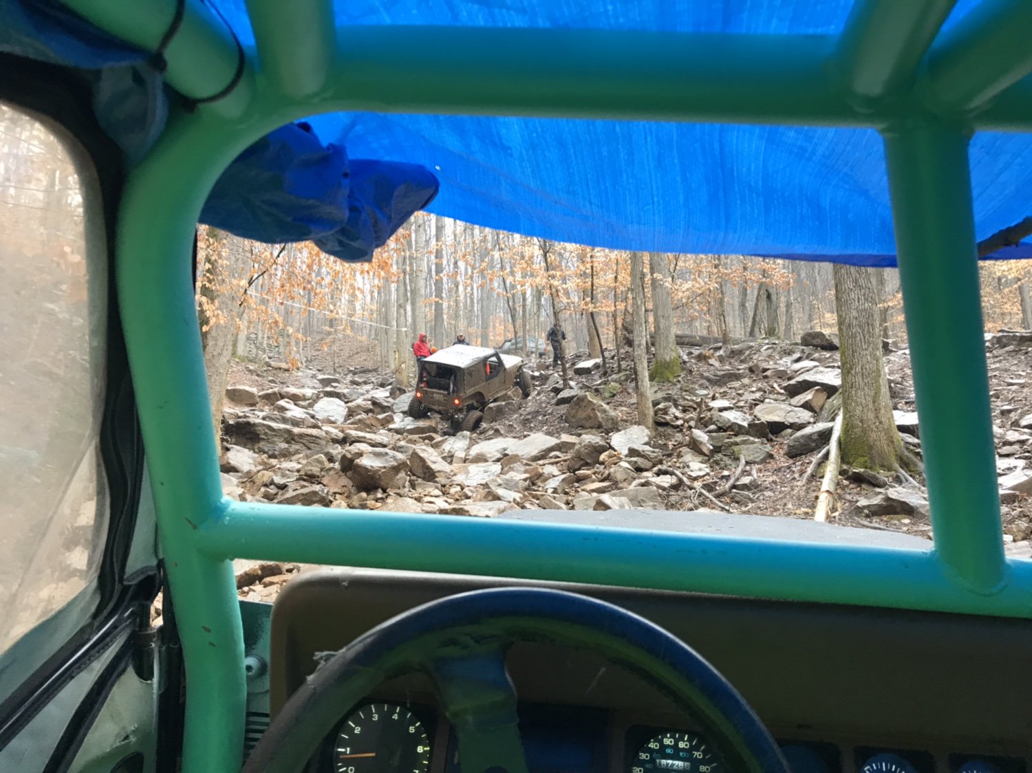

So the Jeep done absolutely amazing at AOP! I love it. It’s a really stable, predictable, point and shoot rig in my opinion.
Funny how opinions differ by the way. This Jeep has plenty of power in my opinion, so much so that I wound up texting David to ask if work had been done to the motor. He said he didn’t think so and he always thought it was lacking. Perspective is everything, and I’ve never driven a manual 4.0 engine. My XJ has a very low mileage motor but man that AW4 soaks up a lot of power. I love the direct drive immediate power this YJ has. 5:13 gears may play a big roll in that.
Anyways I drug this thing down to AOP with no less than 13 people pulling alongside me to give me the rock on sign and even one dude in a WJ revving his engine at me for 1/2 a mile screaming “yeah buddy!”
I did not listen to someone previous post here about putting a back plate on the butt weld in the body to help add strength. I flopped the Jeep onto its side and promptly split that weld open. That re-mangled the drivers side, scraped the cage pretty good, and left some odd color paint scheme on a rock. I was able to throw it in reverse quickly and back out of it no problem. It was pretty cool and I think I can fix it up a little.
The stereo is totally awesome and worth $100 without a doubt.
Also, David mentioned the Jeep running warm with that radiator and the lack of air gap. That was based on the factory gauge, which I replaced. With the fan on it runs below 160*. In fact I turned the fan off at times to get some better floor heat, which will run you out!
But you gotta remember to cut the fan back on!
Turned the fan on and it was back down within minutes.
Saturday the rain came in for real, and I decided to climb a steep muddy hill that was a full throttle assault. Literally 3-4 minutes of 2nd gear rev limiter. It was my favorite part of the whole trip. I finally made it up, but had broken a rear brake line somehow and brake fluid pissed on the exhaust. I’ll be replacing both rear lines tomorrow with upgrades.
