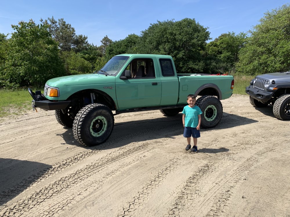

I have a loose idea about shortening the wheelbase 10” and doing a 4 link. I’m thinking to front bob this bed (+ rear bob and/or dovetail too?) and get this one ready for a swap to minimize down time. I was originally thinking to section the frame, but for a dual bob, it might make more sense to just tube under the bed instead of keeping the original frame. From there, my imagination runs away with my check book...

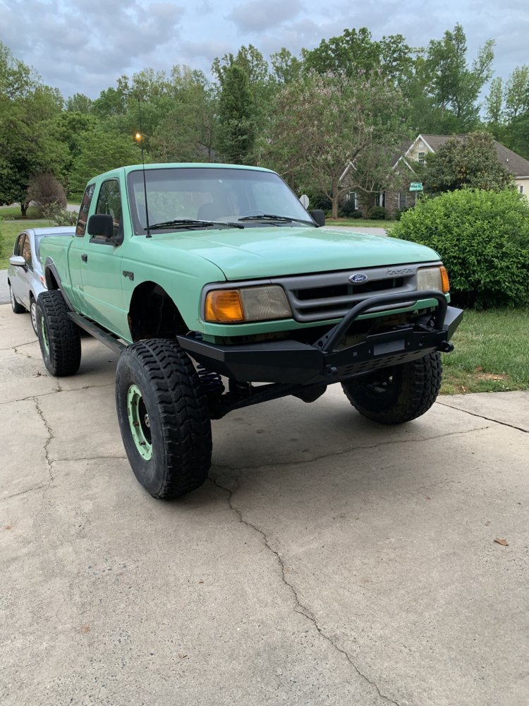

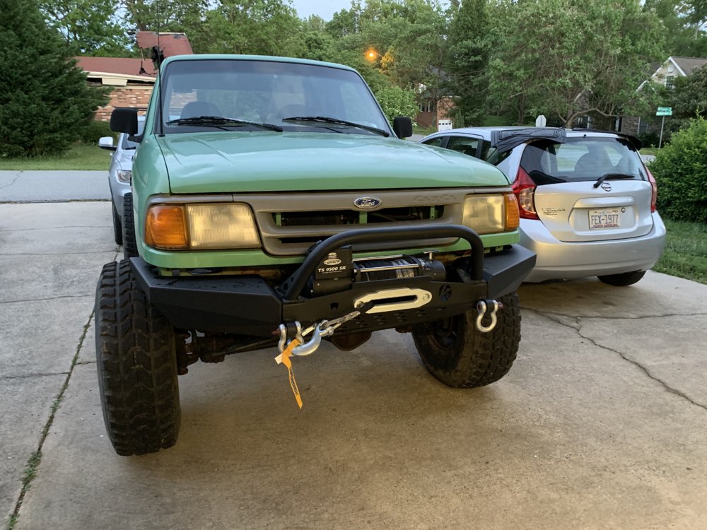

Is the front bumper something you made / modified?
Deep down in my heart I wanted to build it myself, but life is full of compromise. The bumper is this one from Affordable Offroad: Elite Ford Ranger Modular Plain Front Winch Bumper 1993-1997 - Affordable Offroad
It tucks up to the body a bit closer in the photos on their website. I might have to see if I can make some adjustments to get it closer to the bottom of the grille. I get that he probably had to make it modular for shipping purposes, but would rather have had the side wings welded on vs bolt on. Also, the side wings are only 1/8" steel plate and I think 3/16" probably would hold up better to wheeling. I'm interested to see how it holds up over time. That being said, it is a well made bumper. The welds look great and it doesn't look like he took any shortcuts on it. It also came with an abundance of hardware.
I also need to trim the wings back from the wheel wheel. Since my front fenders have been trimmed, the bumper sticks into the wheel wheel at least 3". Of course that didn't occur to me until after I had it powdercoated :shaking:. I was lazy and didn't test fit it. I should have.
Got the bumper adjusted upward as much as possible and the winch installed. Not digging that 10 lb hook so much, so might look to replace that in the future. What’s the best replacement for under $50? Plain old d-ring?

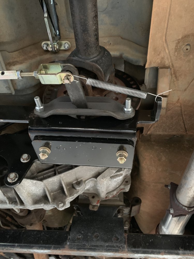

I put a ‘return’ spring on the caliper arm of the Xcase ebrake in the hopes of reducing on road vibrations some:

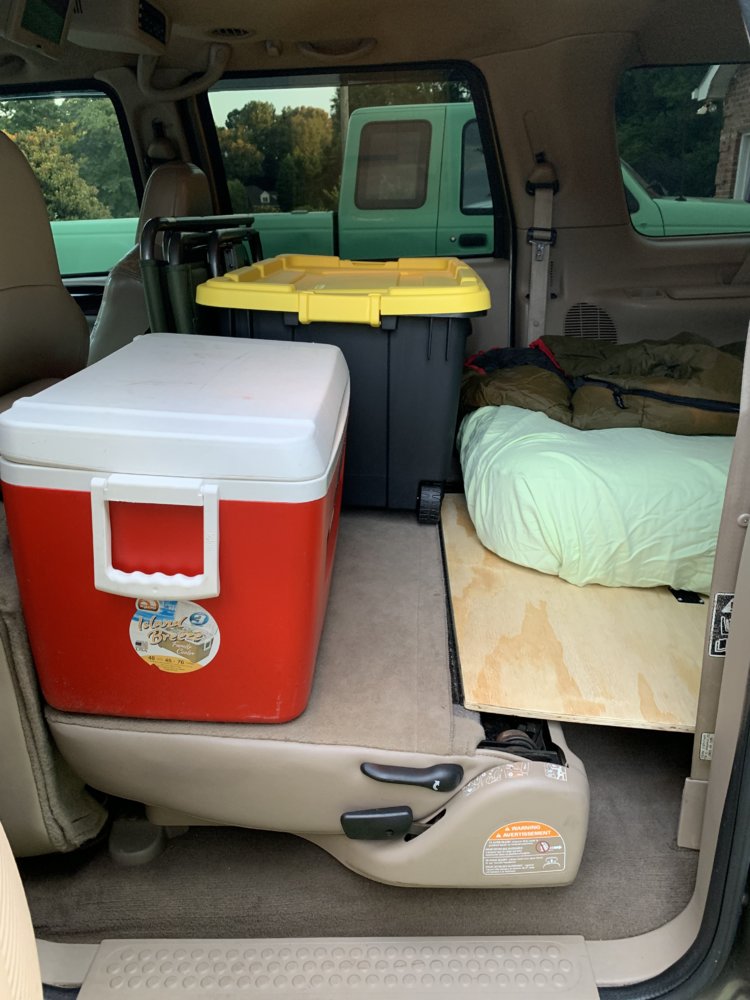

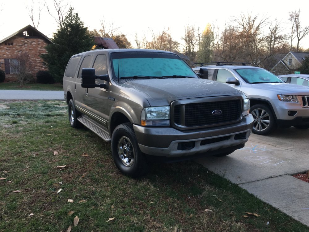

Replaced the broken floor bridge thingy in the back of the Ex so I would have full length air mattress support:

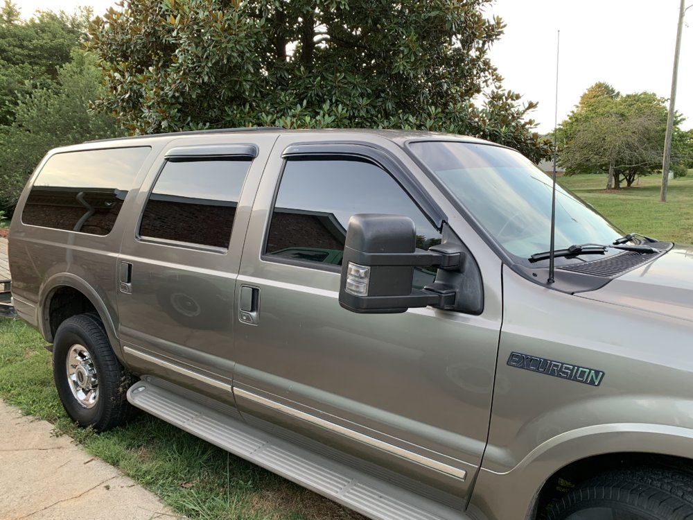

Installed some vent visors on the Ex and made mosquito nets (not pictured) so I can get some air flow at night without the bugs.

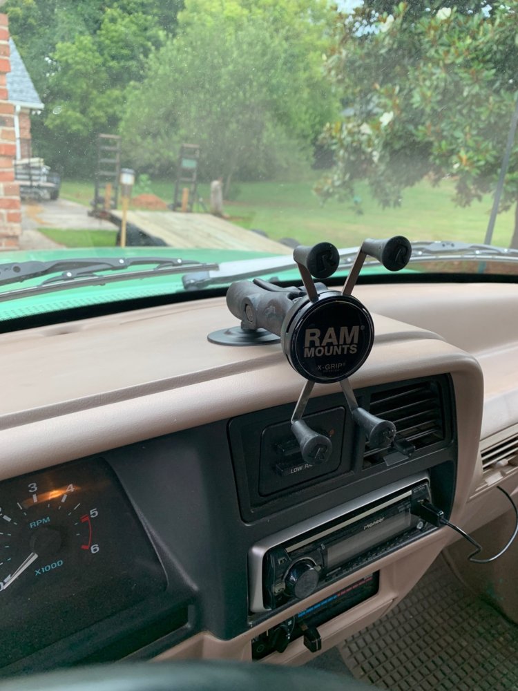

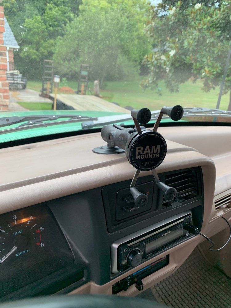

I needed a secure mount for my phone. I've been just throwing it in one of those $2 walmart cup holders that's screwed into my floor, but as you can imagine, that's no bueno. So I ordered up one of these RAM mounts to test out. If this one works out well, I'll probably buy more for my other vehicles.
I use them on the bikes, they work good.
