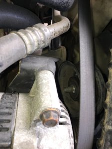

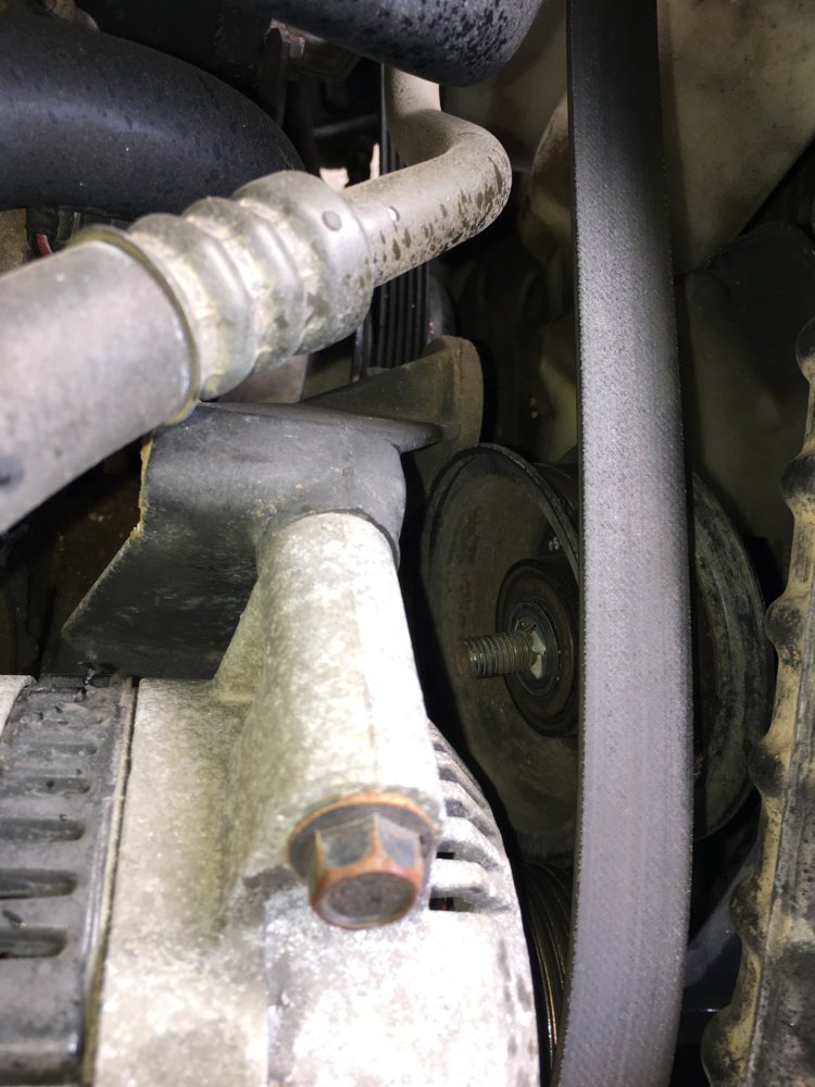

DoubleMint scared the shiz out of the kids and I today. I feel pretty lucky that no one got hurt. The kids and I were cruising down Stratford at about 45-50 mph when suddenly the motor died and the rear wheels locked up. I tried to hold it straight but couldn’t and we did a 180 across a couple lanes, ending up in the middle turn lane facing the opposite direction. All that was going through my mind at the time was “please don’t flip, please don’t flip, please don’t flip..”. Luckily it didn’t. I got out and took a quick look around and didn’t see anything funny with the drivetrain or steering. Then hopped back in and fired it back up easily and the rear tires seemed free. Limped over to the side of the road and coolant steam started coming through the vents. Popped the hood and saw that the idler pulley had come off the front of the engine and was wedged against the alternator pulley.
Long story shorter, I got a new idler put on to get home. In the process of replacing it, I noticed the tensioner is also about to let loose and the belt needs replacement. My JB weld plug blew on the radiator, so looks like it’s time to get the whole rad replaced as well.
I might not make it to the Veterans’ ride this coming weekend.
One more thing so I don’t forget to replace it - the fan hub is cracked all the way through in a couple of places.
The idler and the alt getting a little too friendly:

I made some assumptions and came to this conclusion, but I'm not sure I got it all figured out. I was on a straight section of road just cruising along when suddenly the rear tires locked up. The rear end started to come around, so I tried to counter steer and had no power steering. My mind jumped to 2 conclusions: 1. Something in the drive train broke and 2. The motor died (no power steering).
After I pulled my shorts from my ass crack, I found that the idler pulley was dislodged. It's possible that the motor was still running and the belt just wasn't driving the accessories. This idea is supported by the fact that the engine was obviously overheating (caused by water pump not spinning due to loss of belt tension) as shown by the coolant steam coming through the vents. This led me to believe that I had probably been without power steering/water pump for some unknown amount of time prior to the rear tires locking up. I never heard anything that sounded like catastrophic failure from the engine bay, but then again, 37's + 40 series flowmaster + radio + chatty kids isn't exactly a quiet environment.
I also found nothing in the drive train that appeared out of the ordinary. So how would the rear tires have locked up so suddenly? I haven't quite been able connect the dots between the idler pulley failure and the drive train lockup, but there was no other damage that I can see.

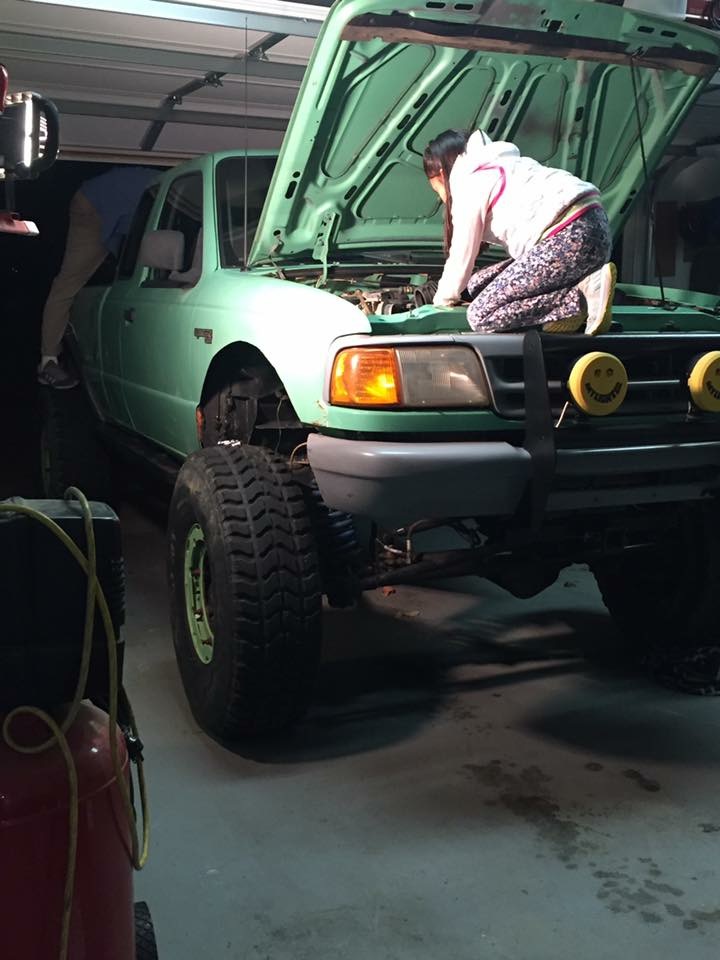

DoubleMint has been mostly left alone out in the cold while I've been wrapping up some house projects. We got that one fall day in the middle of winter this week (thanks NC), so I took advantage of it and got the new radiator put in along with a new tensioner and belt. The stock length 4.0 belt is just a tad short with the power steering mods, so I ordered another one that is 1" longer from Rock Auto (thanks for the NC4x4 discount :burnout:). Application was for a 2009-2015 Miata or a 2011 Porsche 911.
Victoria was a big help getting the belt on.
