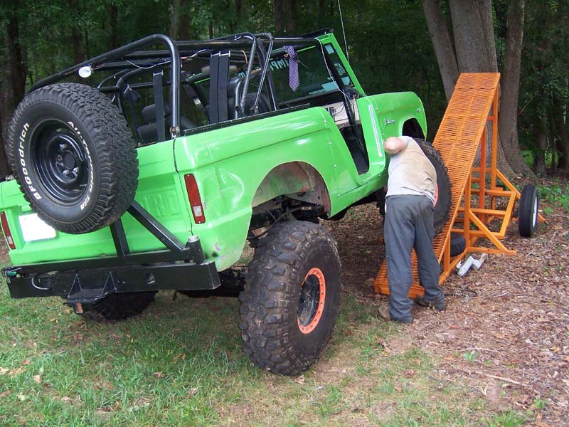

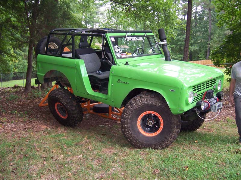

Earlybronco 3 1/2 inch lift buildup

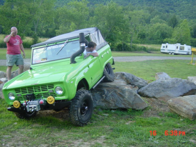

Here are soem pics of what it looked like on 34x9.5

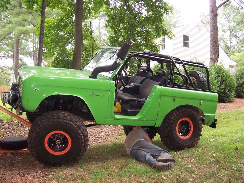

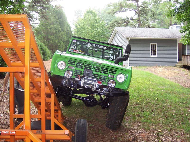

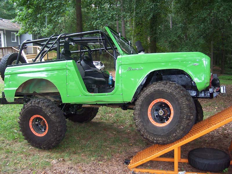

More progress

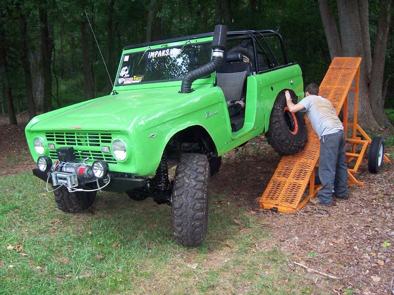

We after spending most of the day in the garage I was able to finish up most of the small odd and end stuff to make it to Tellico next week. Started out installing the front and rear shocks. I then removed the stock rear bump stops and installed the new ones I received from bronco graveyard. This required moving them back about 1 inch so they would hit the truss I installed across the top. If not I would have ended up with 6 inch bump stops. I also had to install new front bump stops that needed to be 4 inches but were only available in 2 inch so I took a piece of 2x2 tube and fabbed up some simple risers for them. I then installed new brake lines in the rear and mounted the distribution block for the front. I got a second coat of paint on the skid that Jon and Ken helped me build this past weekend. I then mounted some universal brackets for the exhaust because the new rear truss and inboard shock mount does not allow me to run it our the rear like I had before so I put some 90’s after the mufflers and have it pointing to the ground. I then finished installing all the screws in my rockskis that protect my rocker panels. I then took it for a test drive around the neighborhood and it rode allot better than before. I hope I can mount the ram for my red neck ram steering tomorrow but, if time does not permit I will run without it. I need to do a front end alignment tomorrow and hopefully that will be a stopping point before I leave.

Well she is off to Tellico and we will see how she does.
