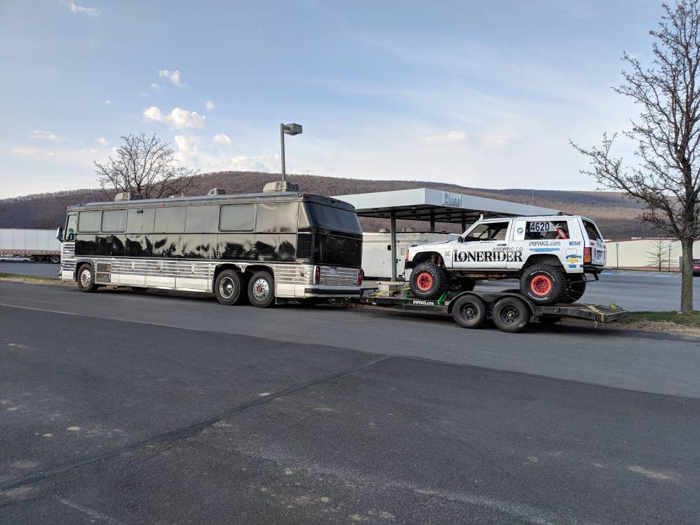

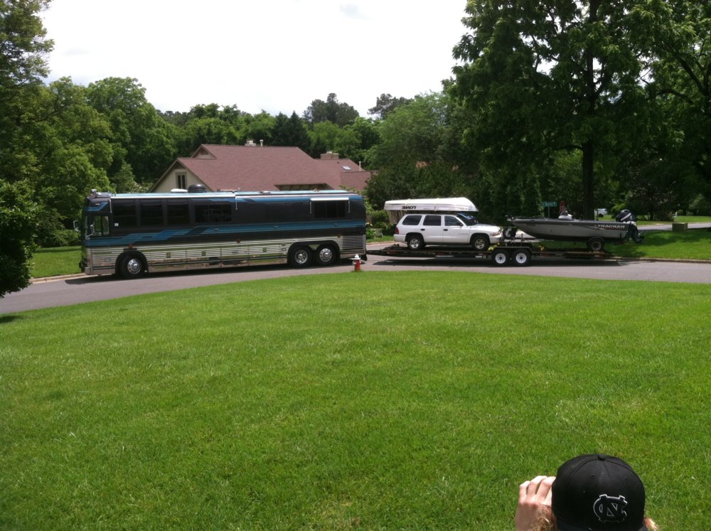

We towed a 32’ flatbed trailer behind a 40’ bus multiple times from nc to Minnesota. We never had any probs except that it got tight in towns and backing up was a bit difficult. Cops never gave us trouble. Actually had more taking pics and giving the thumbs up than hassling us. But we generally run under the speed limit to let traffic pass us.

Judging by the guys that tow similar trailers behind 40ft buses to go racing, the answer is "it depends". It's like towing without enough weight on your truck tag. Pull it on I85 through Salisbury or on 321 to Boone, probably going to get pulled.
The "fix" is to get a CDL and put truck tags on the bus. The law doesn't say nothing can be longer than X feet, it says you can't be longer than that and be considered a recreational vehicle and fall under the recreational vehicle exemptions.
But once it has truck tags on it and using a CDL, log books come into play, DOT numbers, weigh stations, dot restrictions in hours driving, etc.

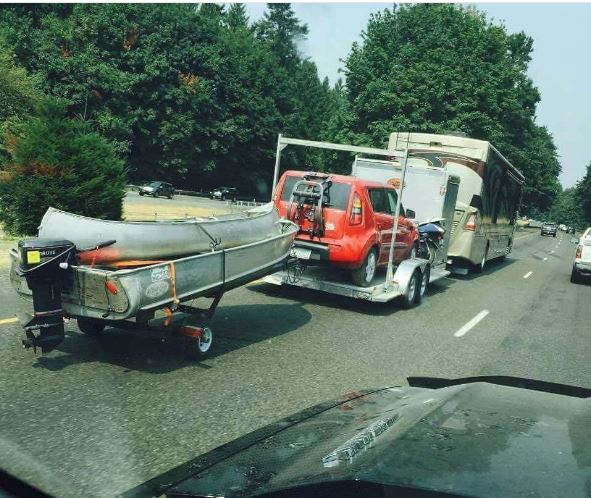

Saw this today and thought about this thread.

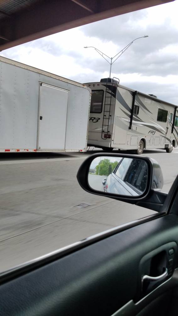

Saw a longer RV and longer trailer sitting at someone's house but couldn't get my phone out fast enough
