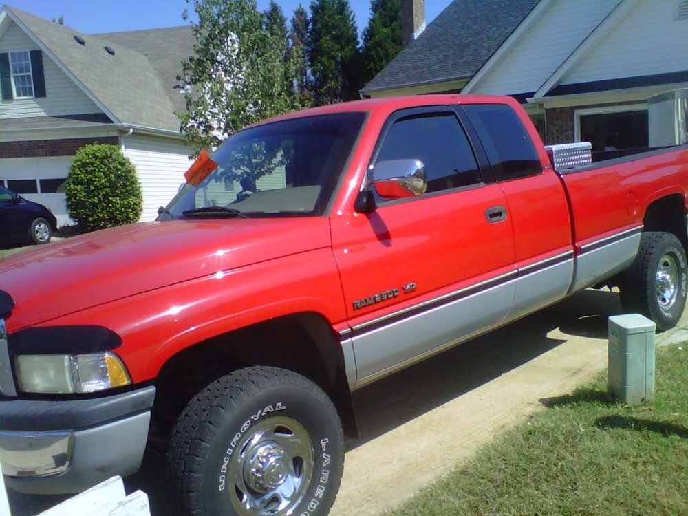

I figured I would start a little truck gallery for my old beater of a tow rig that has gone through a couple updates and upgrades over the year. My kids affectionally call it “Big Red”

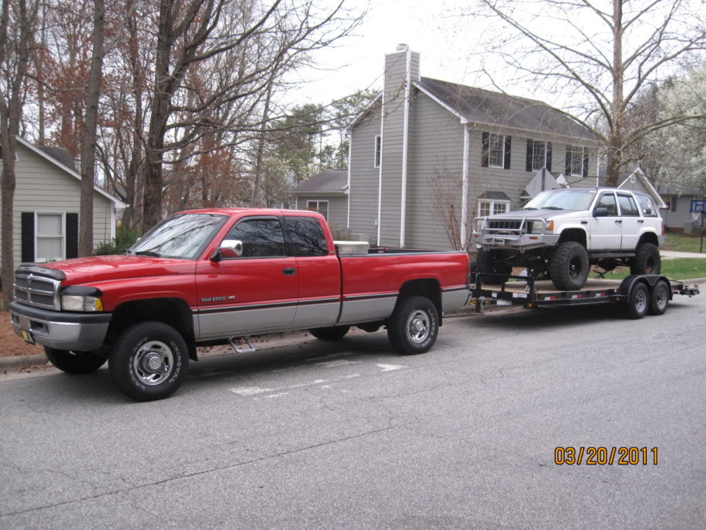

The day I picked it up. 1996 2500 V10 NV4500 that came with the D80 rear axle.

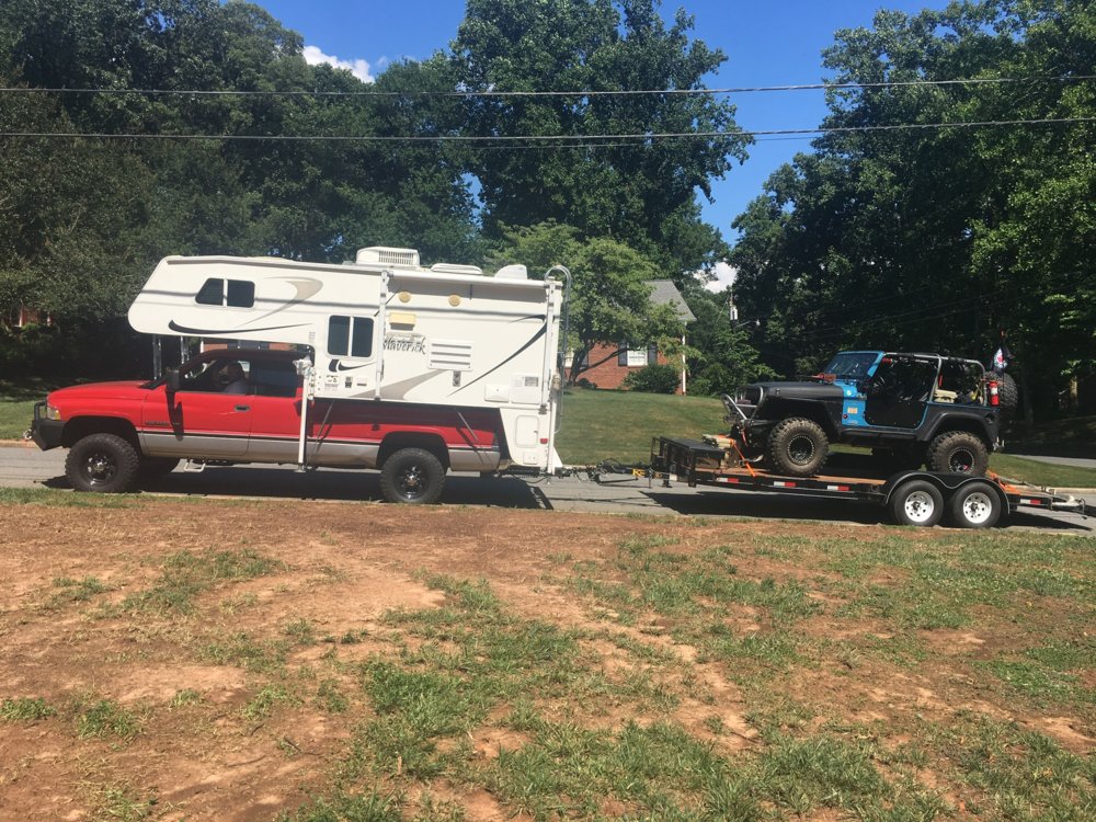

Bone stock towing my old ZJ

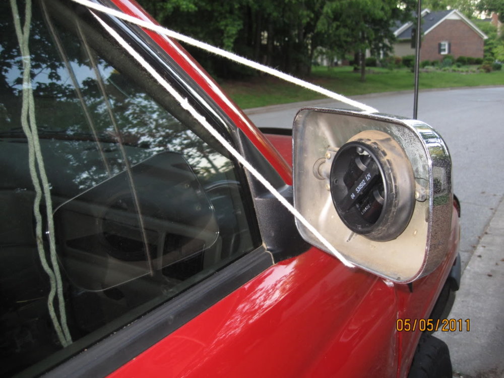

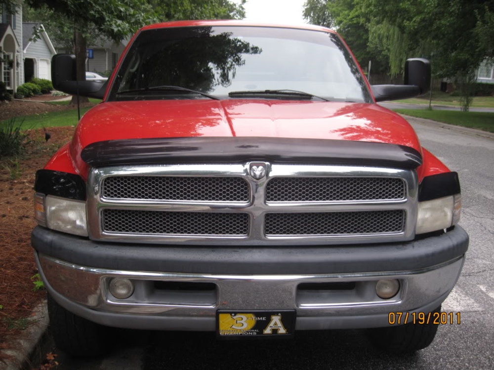

Smacked a tree in the woods so the stock mirrors got replaced with tow mirrors

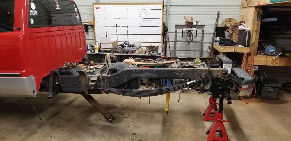

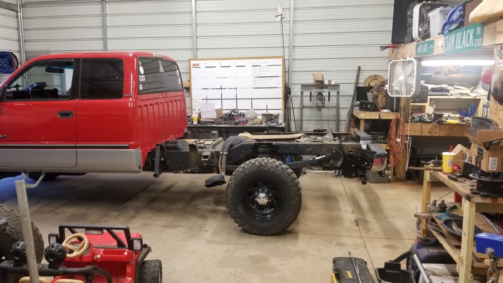

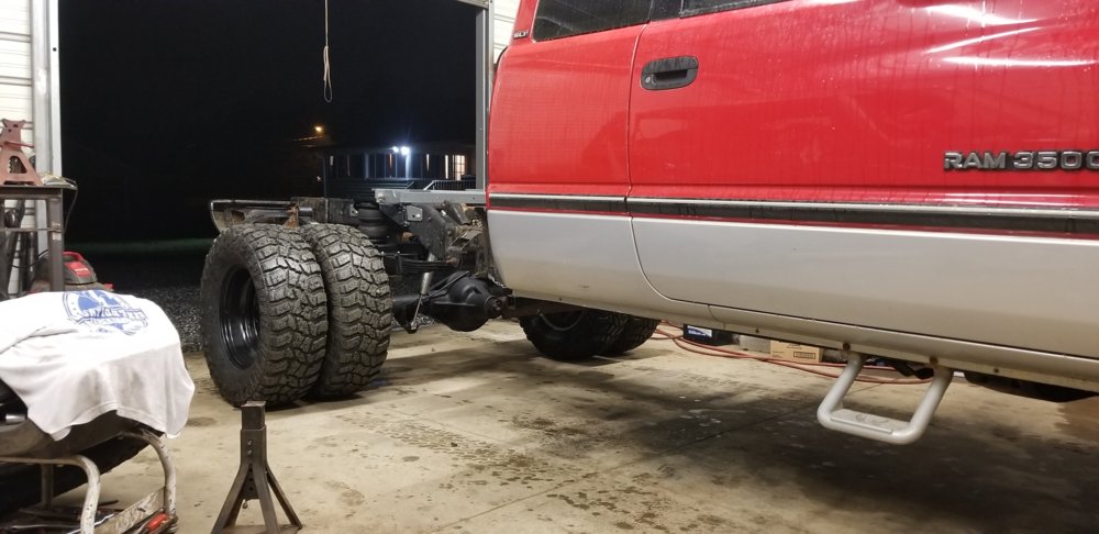

Some changes are on the horizon

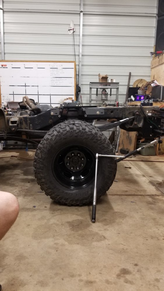

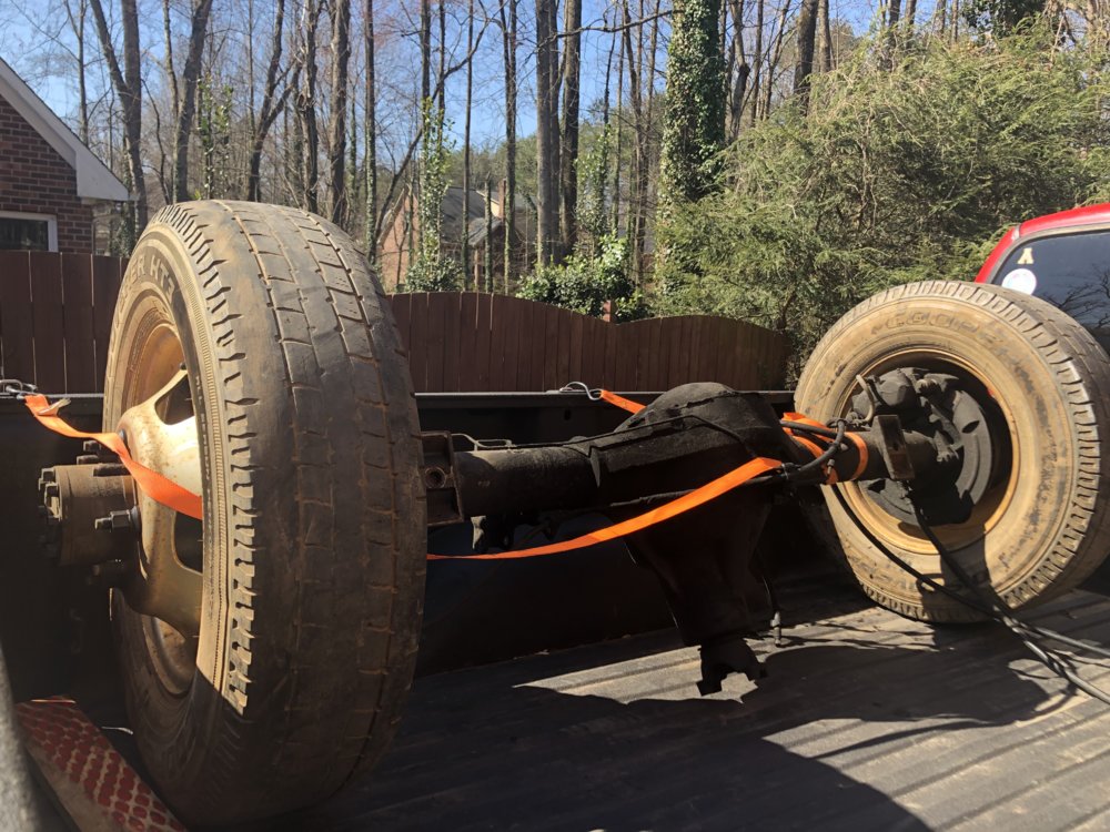

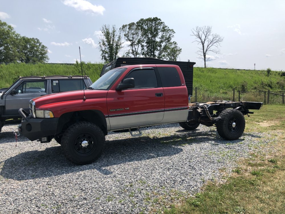

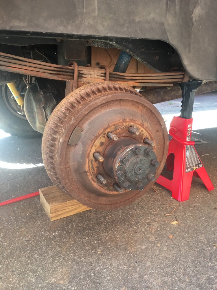

Rear dually D80 with disc brakes out of 2001

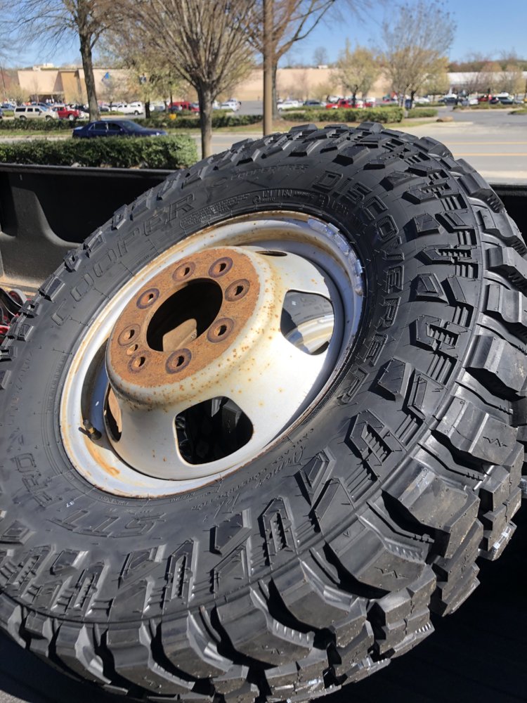

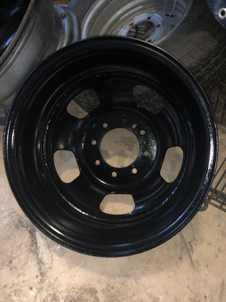

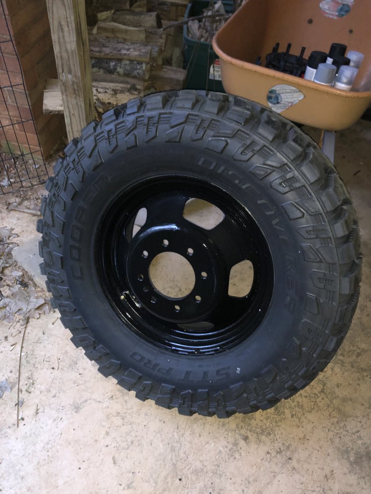

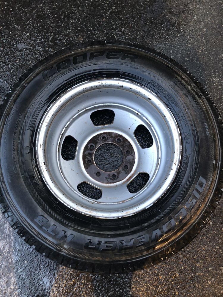

3rd generation steel wheels with matching 285/70/17 Cooper STT Pros

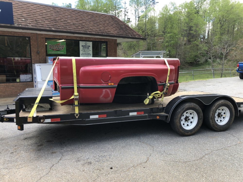

1996 dually bed that is red, and will kind of sorta match the cab until painting is in the budget

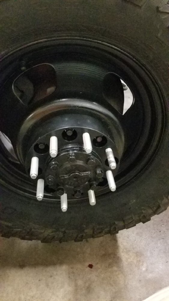

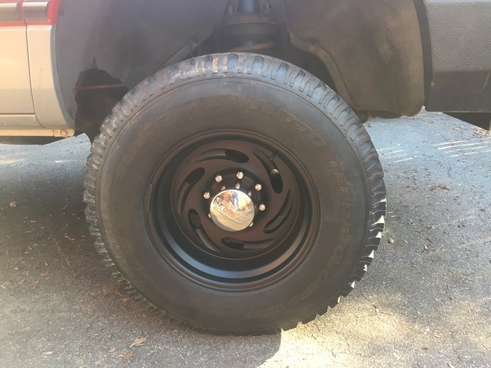

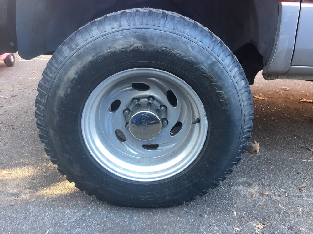

Spacers, pretty much all trucks after the mid 90s used spacer/adapters for the front.
I thought that’s how it worked. I know mine is that way but knew older ones were different hubs between srw/drw front axles. Wasn’t sure where the cutoff was for dodge as the only 2 gen I had was a 2500
Yep, adapters on the front. I did learn there are generational gaps in the adapters, I had to find a 95-97 series

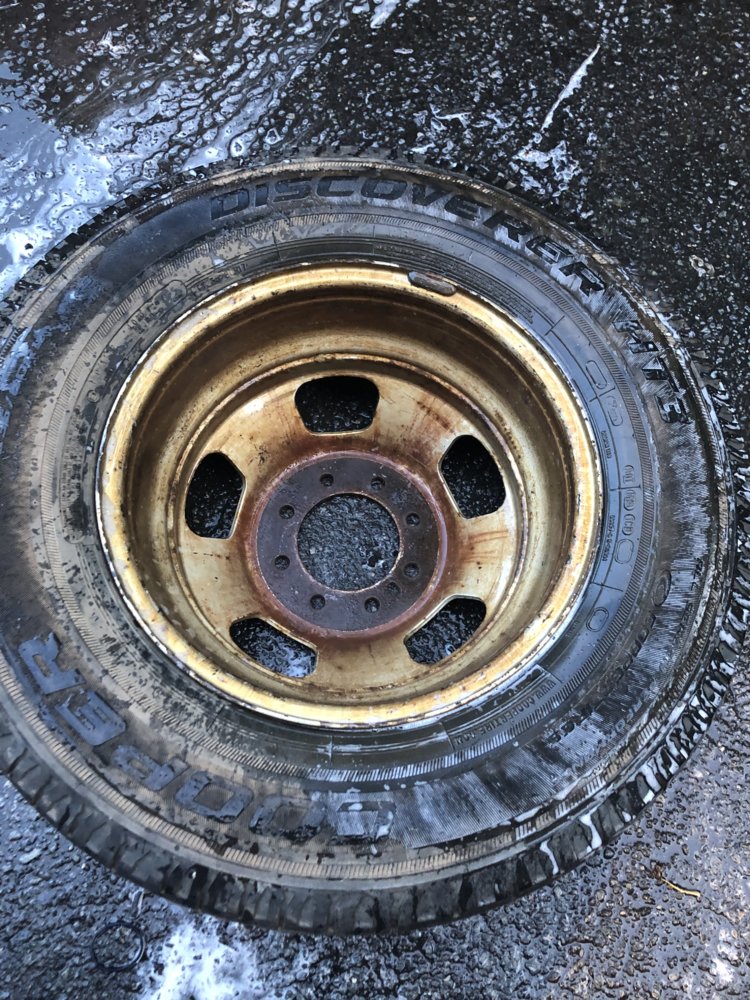

I was cleaning up a set of 3rd Gen Dodge wheels for my truck yesterday afternoon and was thinking about having them powder coated a nice charcoal gray or something. I think they'd look pretty good against a black truck too.
Clay you should just hold on to the SRW dana 80 for when you put tons in the TJ :D
I was gonna say that the 80 is way to wide but I just went and measured it and its ~70" wms. Perfect for a 05+ Dana 60.
