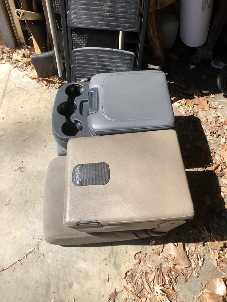

So 2nd gen dodge interiors suck, plain and simple. The cup holders in mine broke a long time ago and before they broke they weren’t what I would call sturdy.

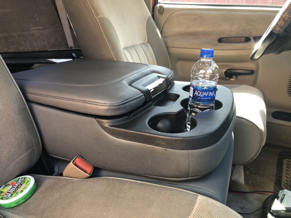

I read about swapping in a 4th gen center console that would give me cup holders there instead of in the dash. I found a used one and picked it up. My first intention was to just swap the top part and not the bottom seat part. Well i could not for the life of me get the 2nd gen top off, so I decided to just swap the whole thing.
The bolt holes do not line up exact, you can mount the front two or you can mount the back two. First i mounted the front two holes, but decided that out the lid too far back. Now my plan is to mount the back two and make a small bracket for the front. That to come soon.
