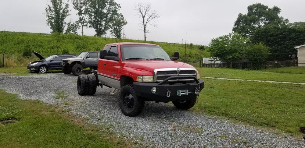

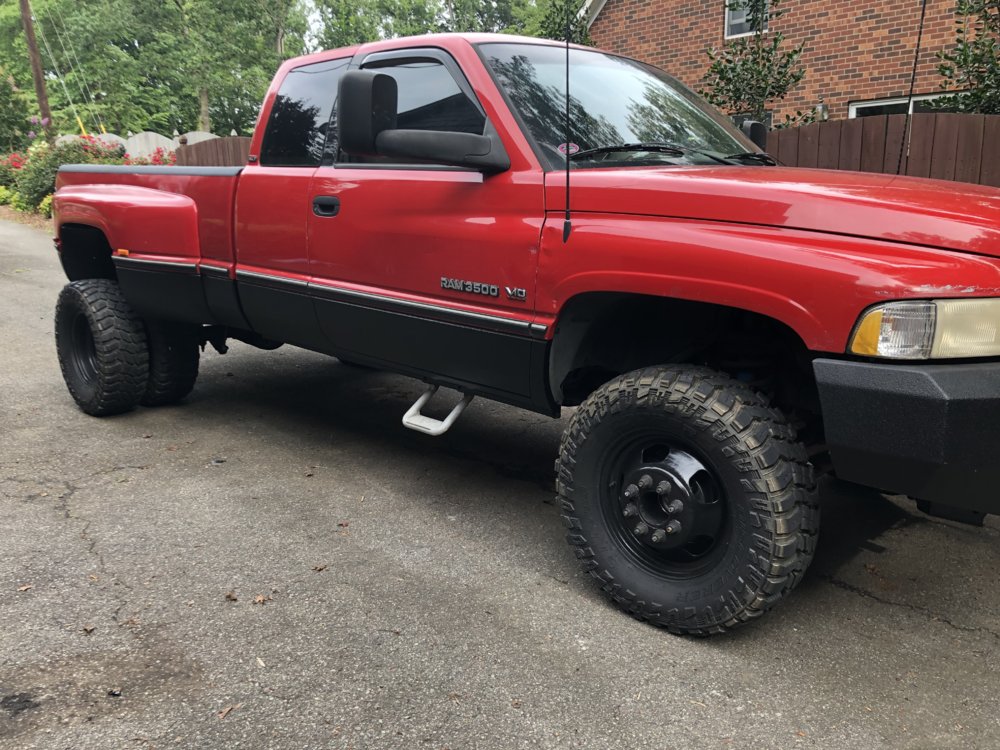

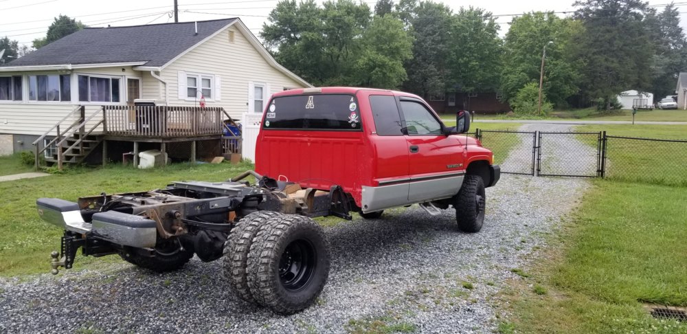

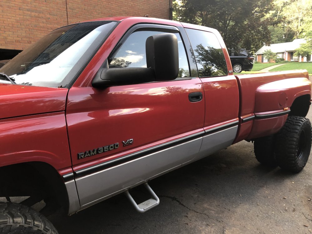

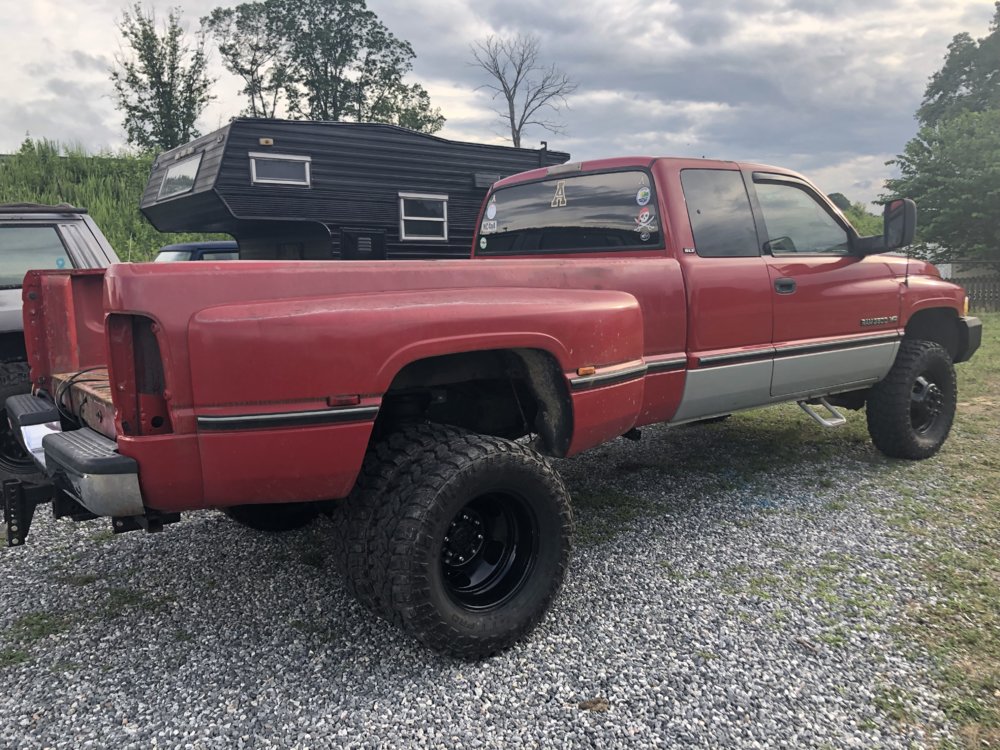

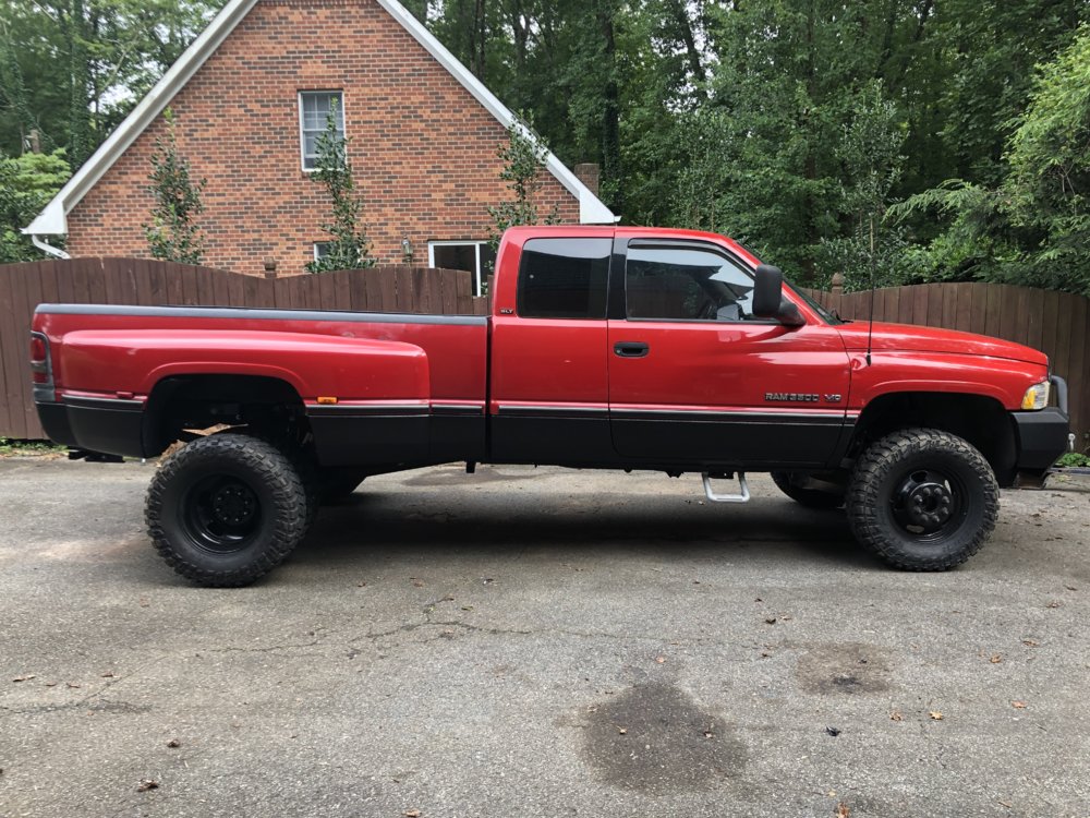

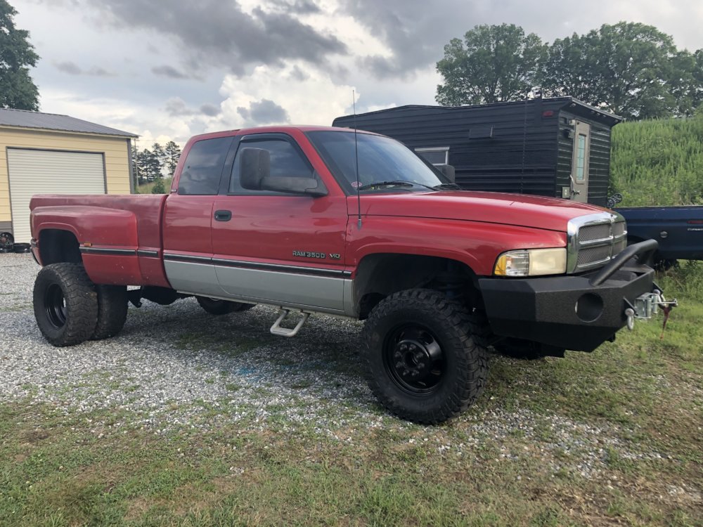

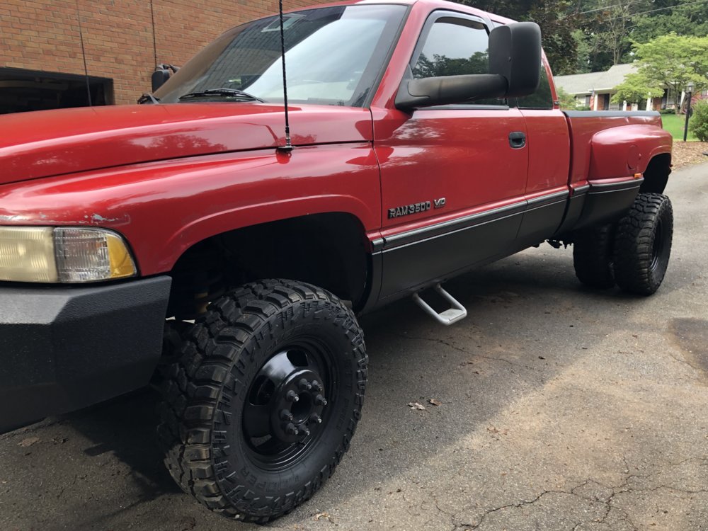

So who knew the unit bearing in a D60 in a 1996 2500 were different that in a 1996 3500... well they are. Now the front dually spacers are on as well as the wheels. @Chris_Keziah is doing an amazing job on this swap!
I vote FLATBED!
I thought about it, but going with a dually bed for now, will help keep the camper a little lower

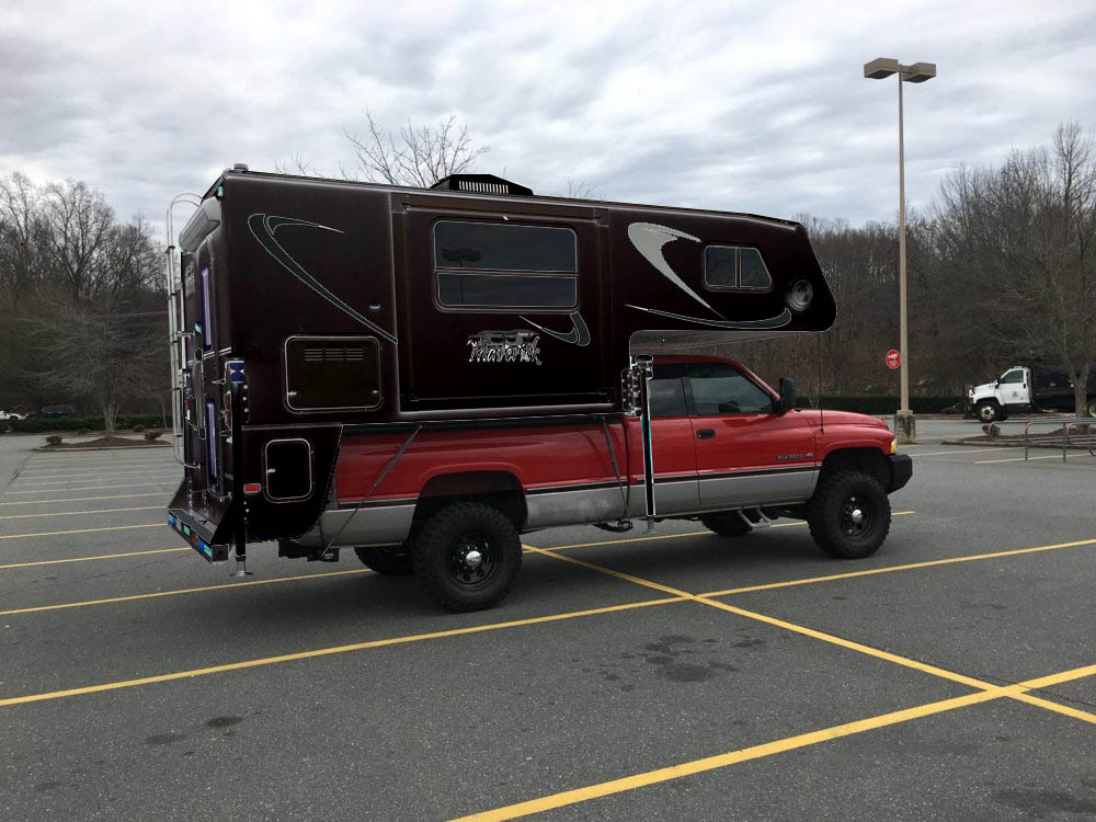

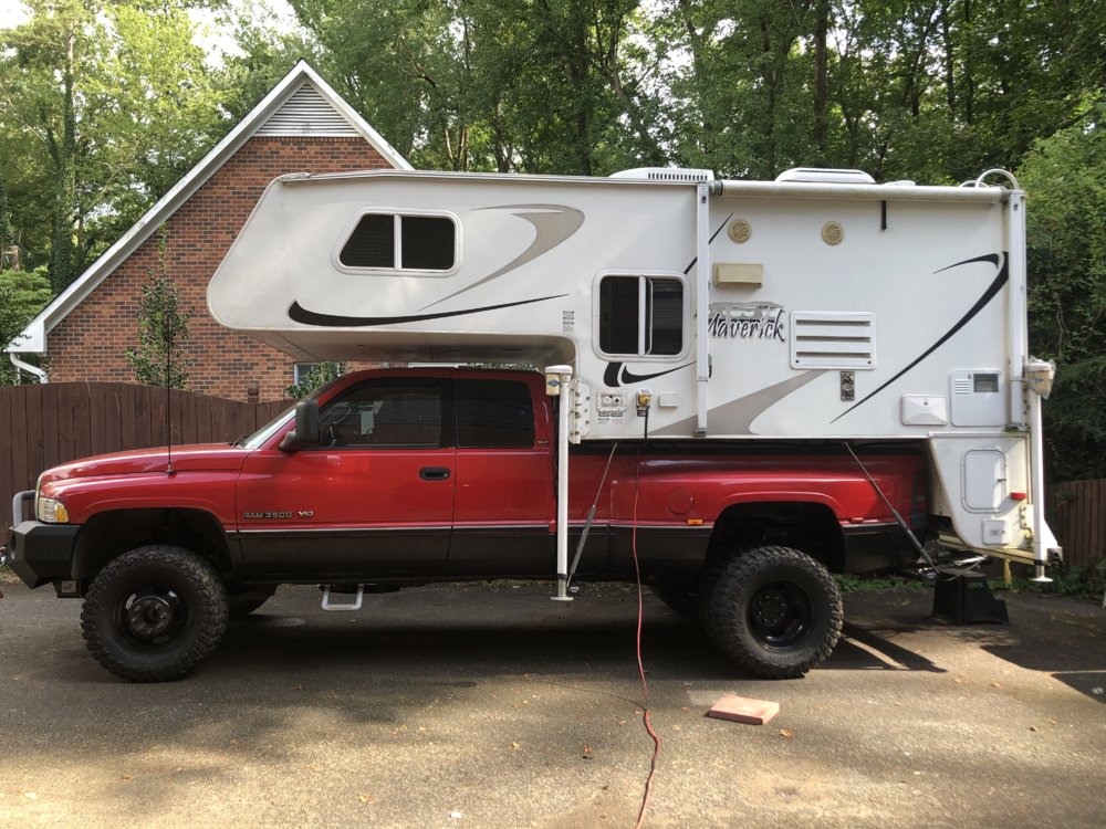

I can't wait to get the camper in the back and see how much more stable it is and how much better it stops with the rear discs. I was really pushing the limits of the SRW last time I towed with the camper loaded up and pulling the jeep both in weight on the rear and stopping with the rear drums.
Question: does anyone run a rear sway bar on their dually? I don't think the second gen dodge duallys had them.

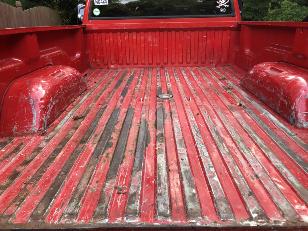

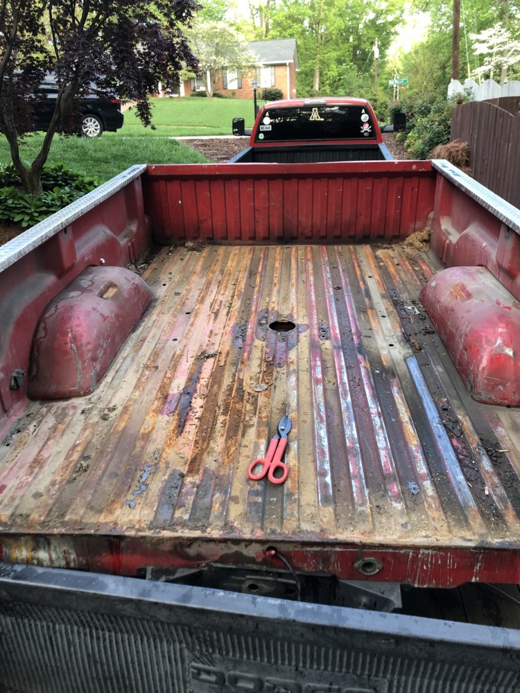

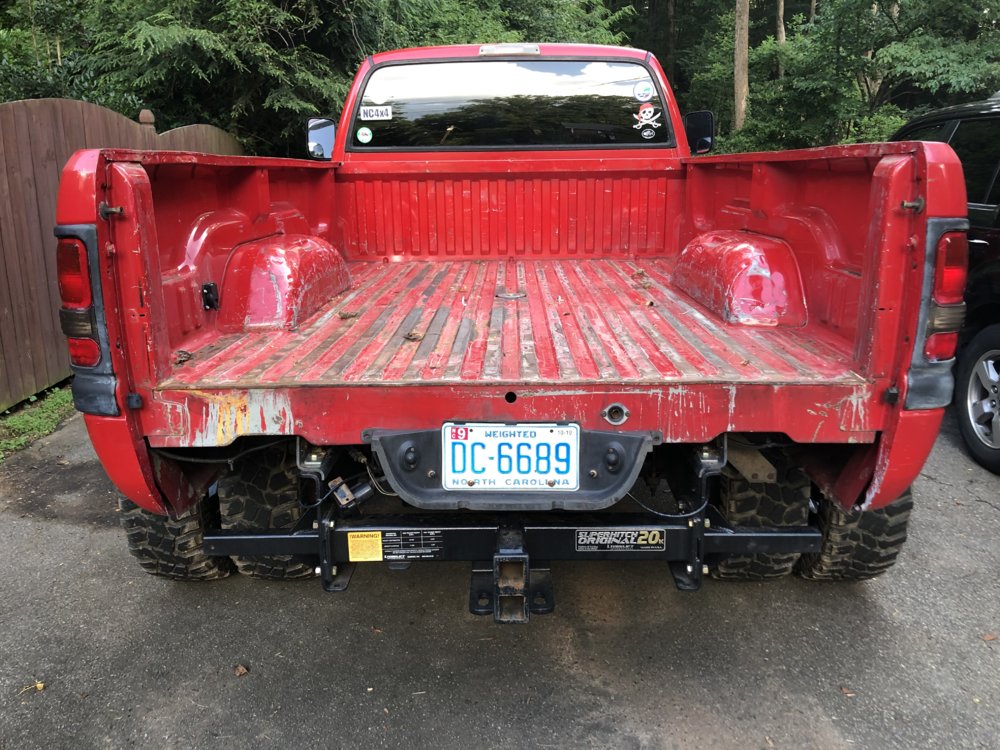

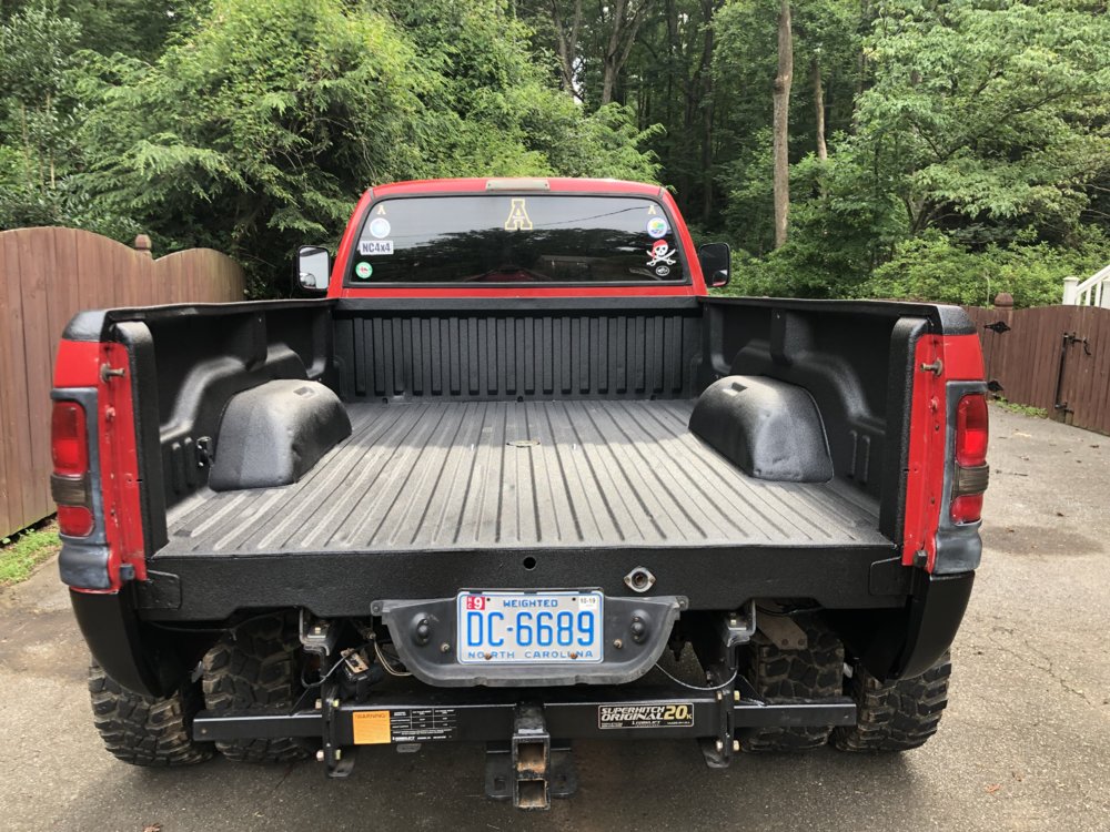

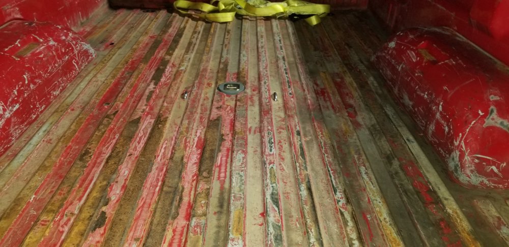

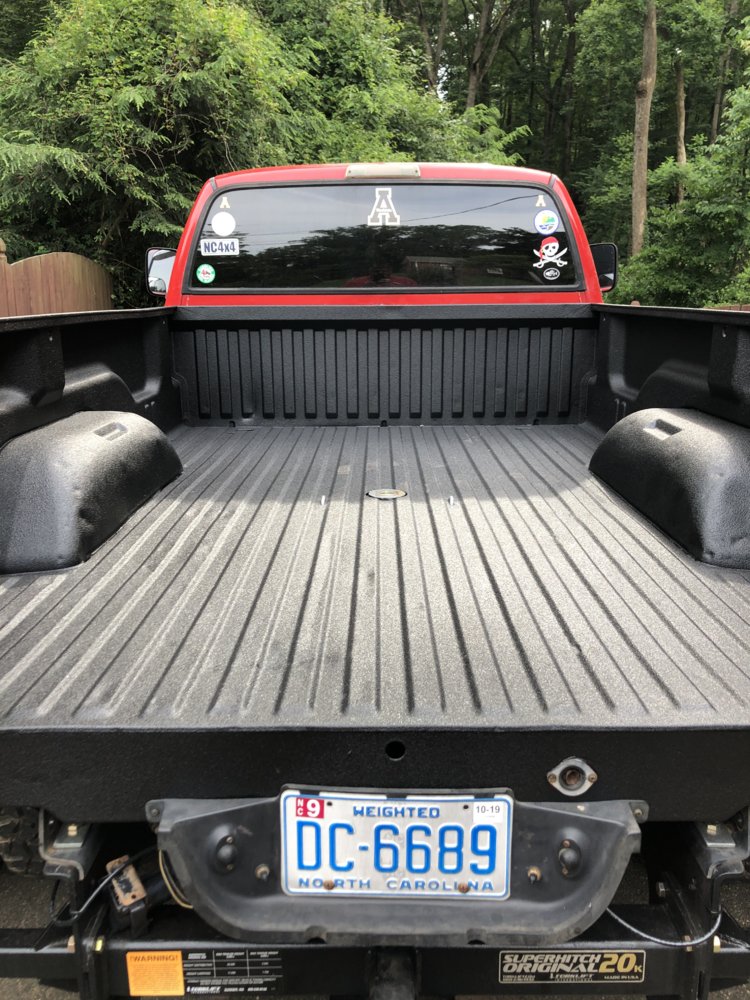

What is that in the bed haha (and no I am not talking about the terrible condition of the bed, yes I know it needs some attention)
And this thing is wiiiiide. It is going to clear the legs on my slide in by less than an inch on each side.

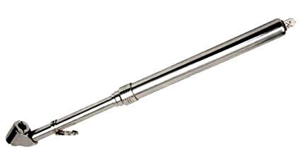

So what do you dually drivers do to check the pressure in your rear tires?
Ive got a dual Chuck like the one @powerstrokin04 posted. Just pay attention when you mount the duals and you can “phase” the rims so the inner and outter stems are next to each other for easier checking/ filling.
You can also get longer, brass valve stems and bend the neck of it through the hole in the outer rim like they do on big rigs.

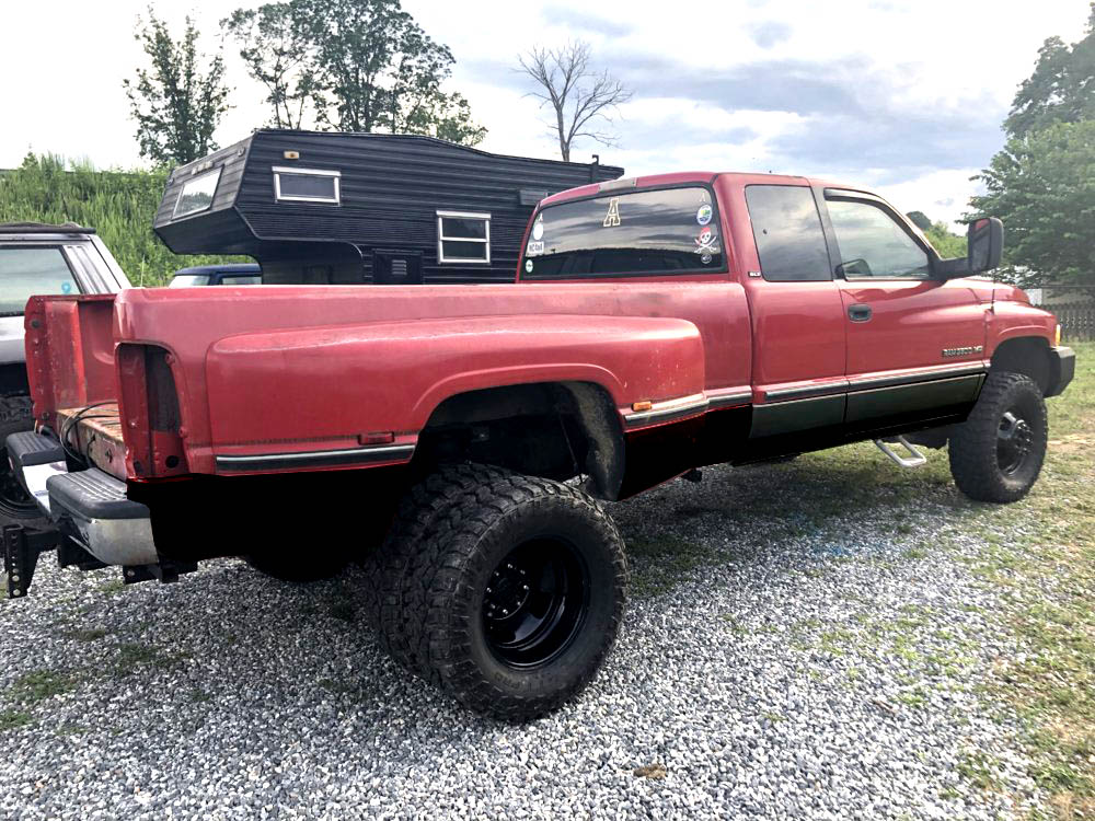

So verdict on the brakes is... wow, what a difference. More than once I have about given myself whiplash because the brakes are much better and I forget and ht them as hard as I used to have to hit with the drums.
Dang that looks great clay.
That's kinda hot. What'd product did you use?
