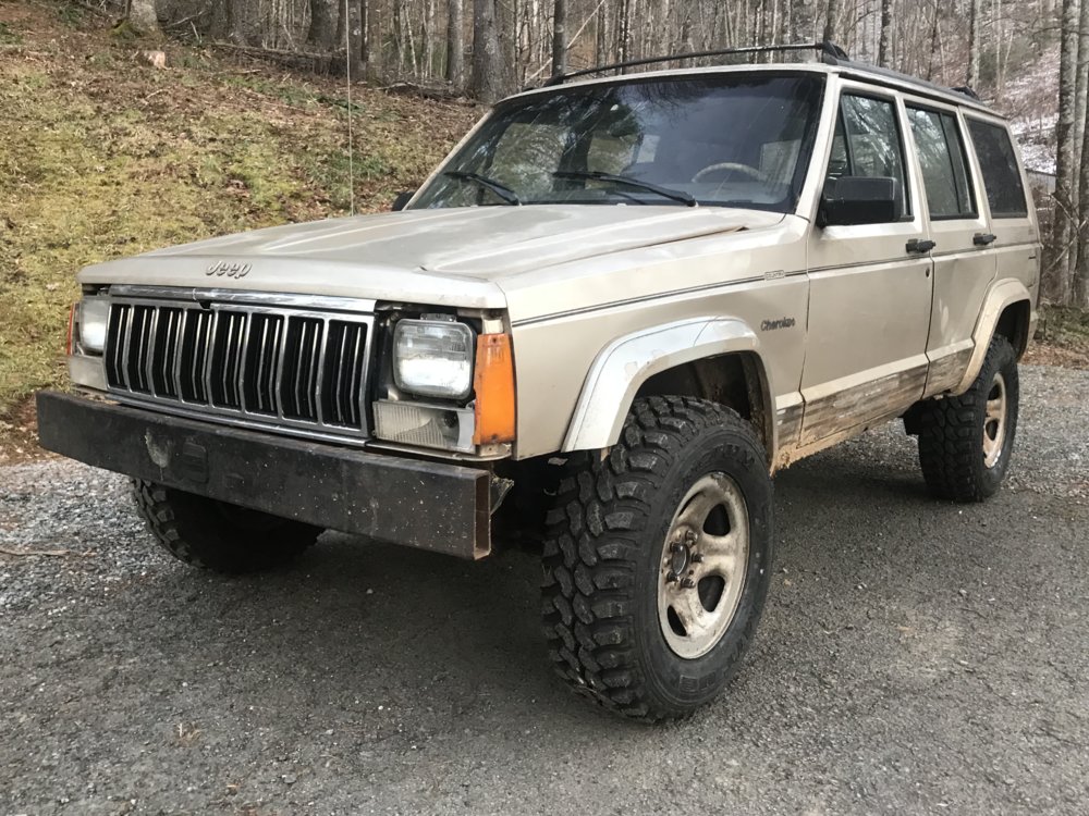

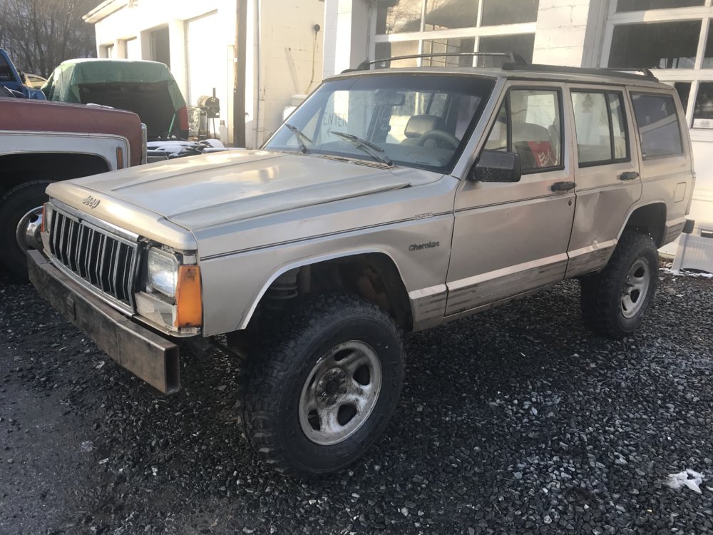

I've always had short WB Jeeps. This is my first foray into LWB Jeeping, traded for an XJ that has a 4.0/AW4/NP231 with a non-vac HP30 and 8.25 with 3.55 gears.
The front currently has a 1.25” coil spacer and the rear is on Dakota springs with an overload.

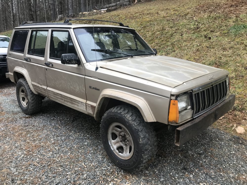

When I got it:

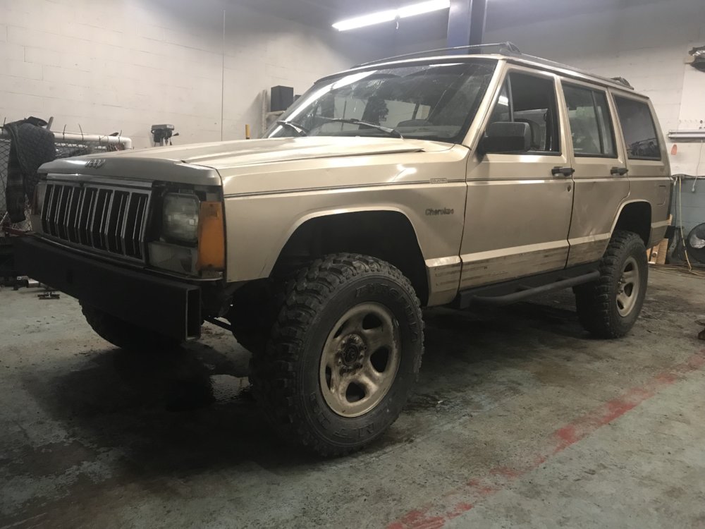

Today I put some 235/75r15 MTs on it and with some 1.25” wheel spacers.
More to come as the build requires.
Honestly I put them on there because I thought I would need them to avoid rubbing, but I don’t. So I took them off this morning.
Last night I happened upon some JKS adjustable lower control arms and some 2” Teraflex spacers that @ChrisM had in his shop. Stay tuned!
Near term plans are add those parts, a Ruffstuff track bar, and HP30/8.25 Ruffstuff diff covers.
Pic without wheel spacers.

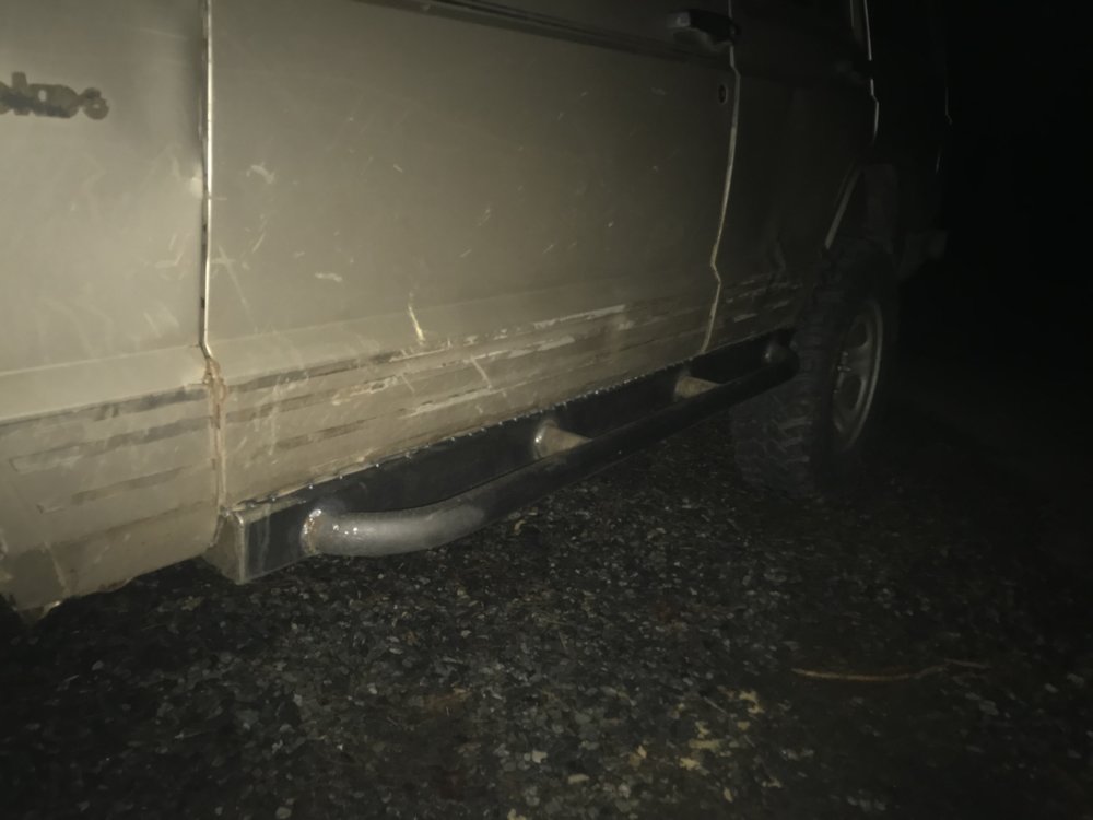

If it has rockers and you want to keep the doors usable either repace them with 2x4 or 2x6 tube or invest in or build some rock rails. Love a stockish xj for good fun.
please fit 37's with no lift

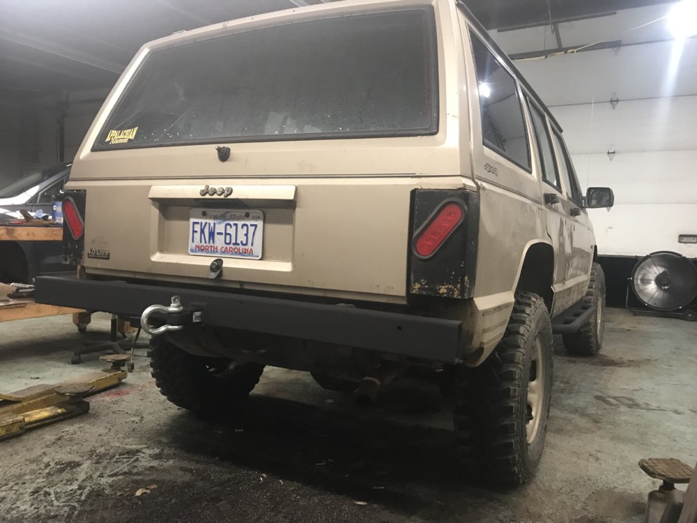

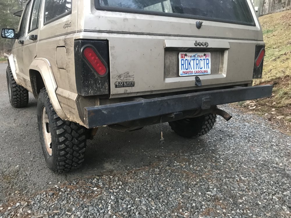

Yeah, 31x10.5s require spacers, I used to run 235/75 on it before those mustang tires.. Nice bumpers. Probably make another set, and another set of tail lights. I like that they never broke. Oh if the blinkers ever quit, you'll need to install a resistor or change the bulbs in the rear quarter panel. The lights run of the trailer harness, which is factory, with relays. If you want more power out of the engine, you need a flashable PCM & the interface & software. That ported head wants more fuel.

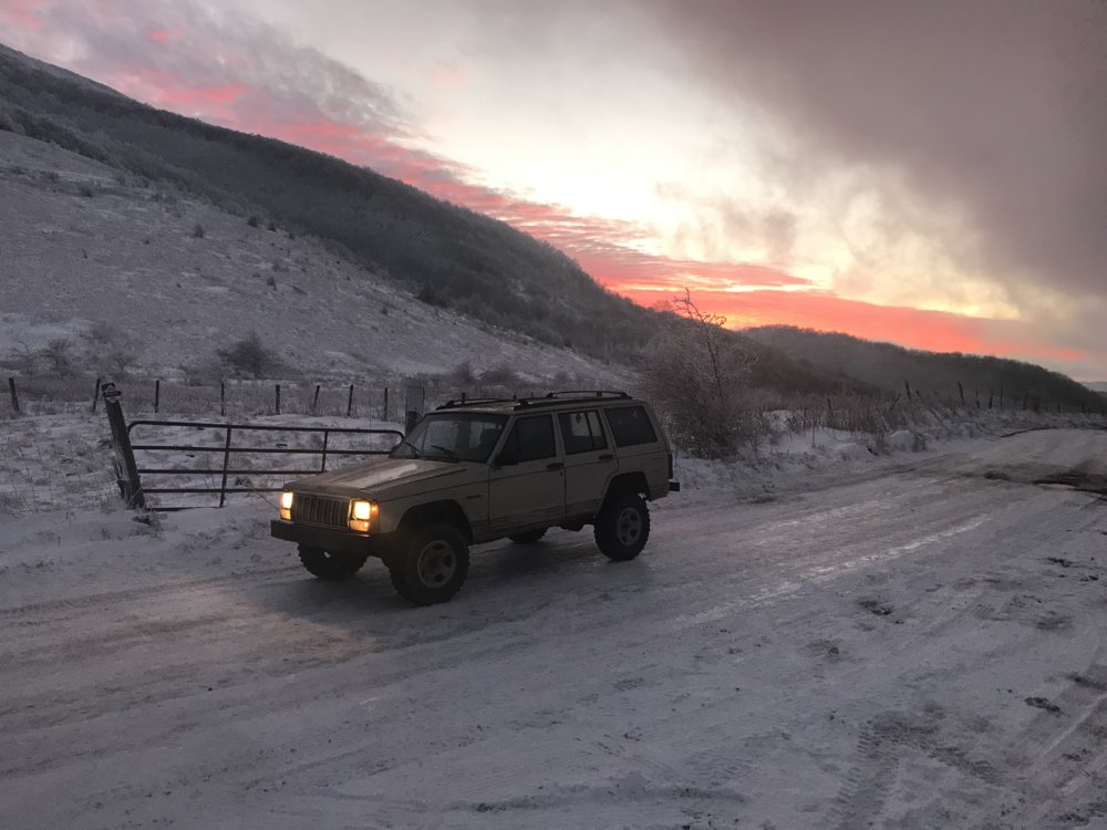

Did some fender trimming this past weekend and rode around in the snow
Will be doing the 2x6 rockers soon as they’re arriving via FedEx tomorrow, followed by a 4.5” susp kit that’s on the way as well. And some front end goodies from @untchabl here real soon
That’s on Rich Mtn Rd, the gravel part near Tennessee

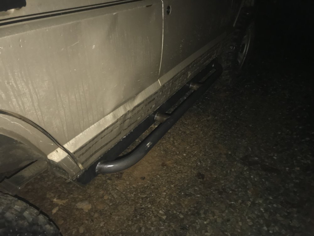

Got the sliders done and painted tonight

Damn she cleaned up good & looks good. I notice you shot the bumpers too. Those tail lights beg for a fresh coat.. I didn't box in the bottom, you might want to, maybe not. It's got some flashing tape to seal the interior off behind them.
