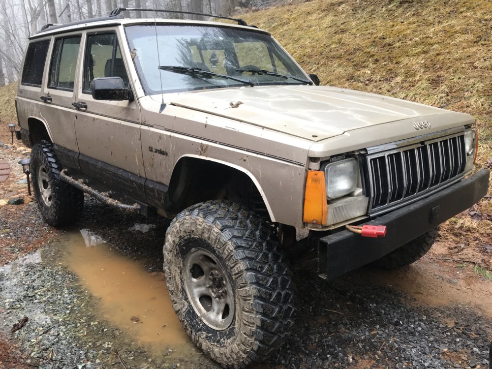

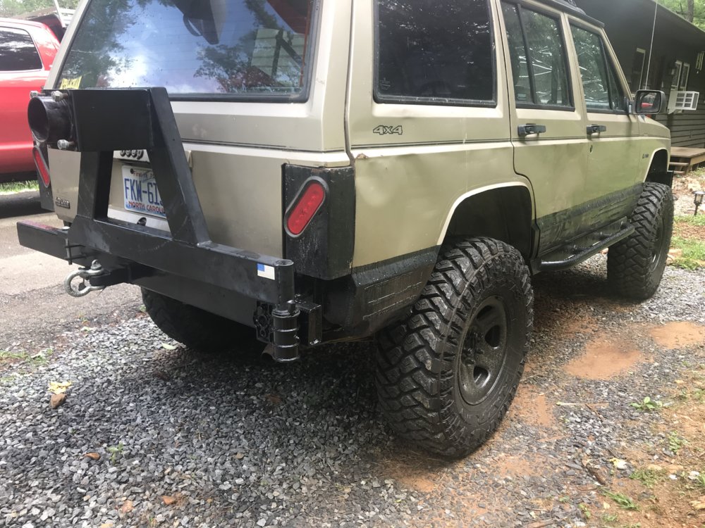

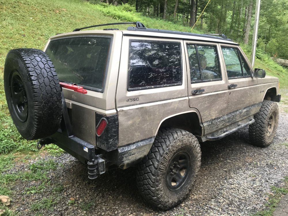

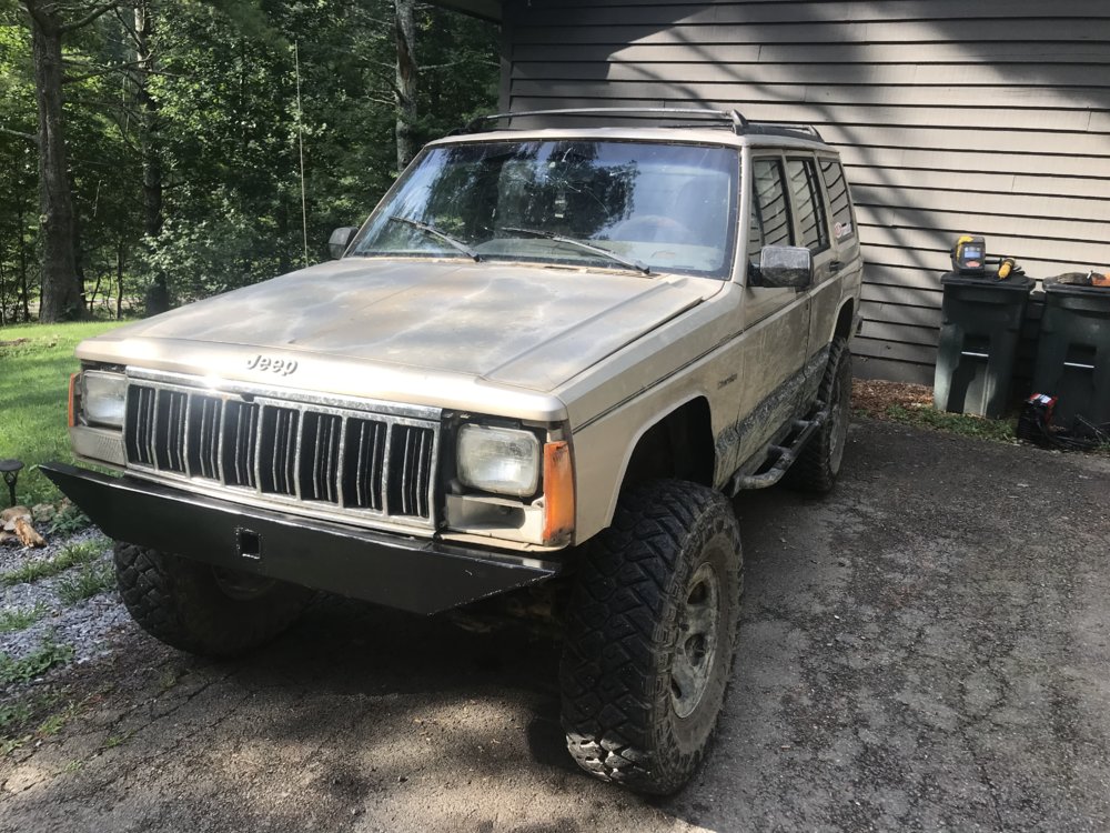

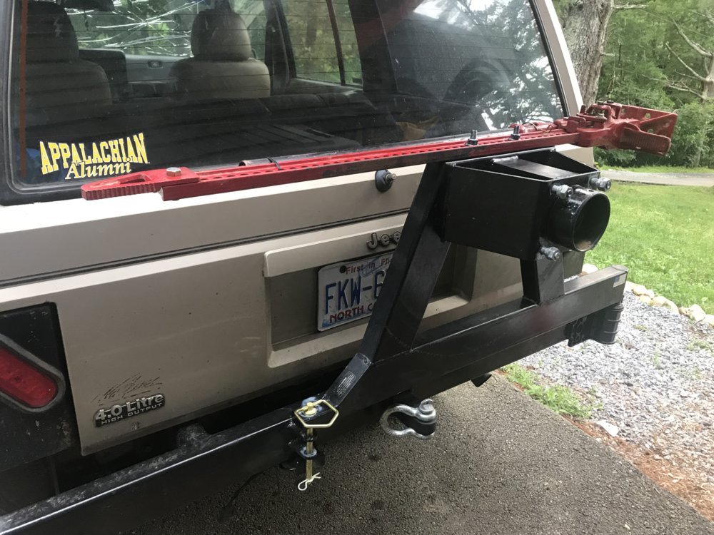

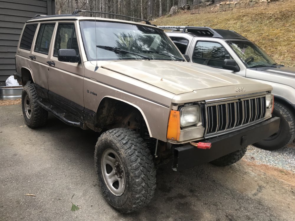

The rear leaf spring bolts were seized > 3 out of 4 ended up getting plasma’d out and welded a new nut back in.
It had Dakota rear springs. These are XJ springs with a shackle and full length AAL.

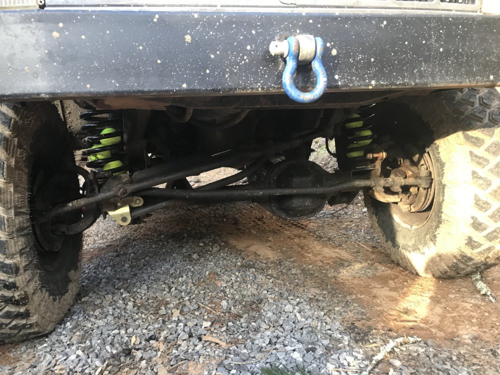

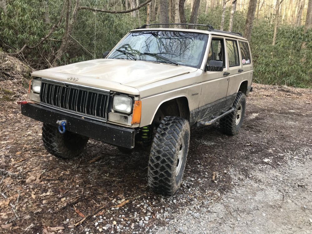

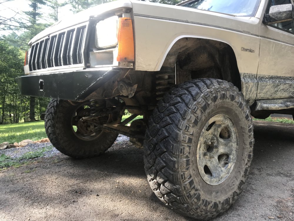

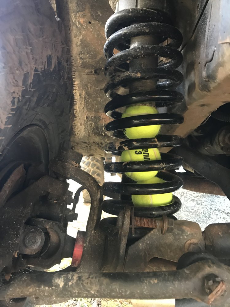

Up front is 4.5” coils with 1” isolator spacer, new LCAs.
We got the lift on, then I sunk the front end into a ditch about 15 minutes later. It was dark
Hoping to get the gears & lockers done over the next week. Currently saving for bigger tarrs, will run the weenie MTs until then <driftcar>
