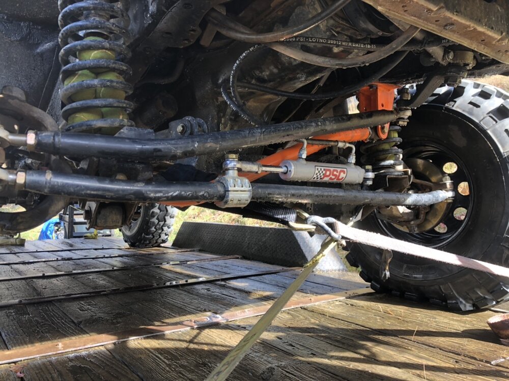

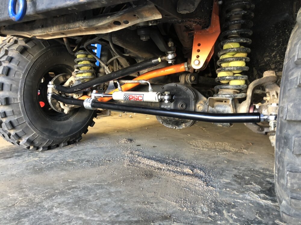

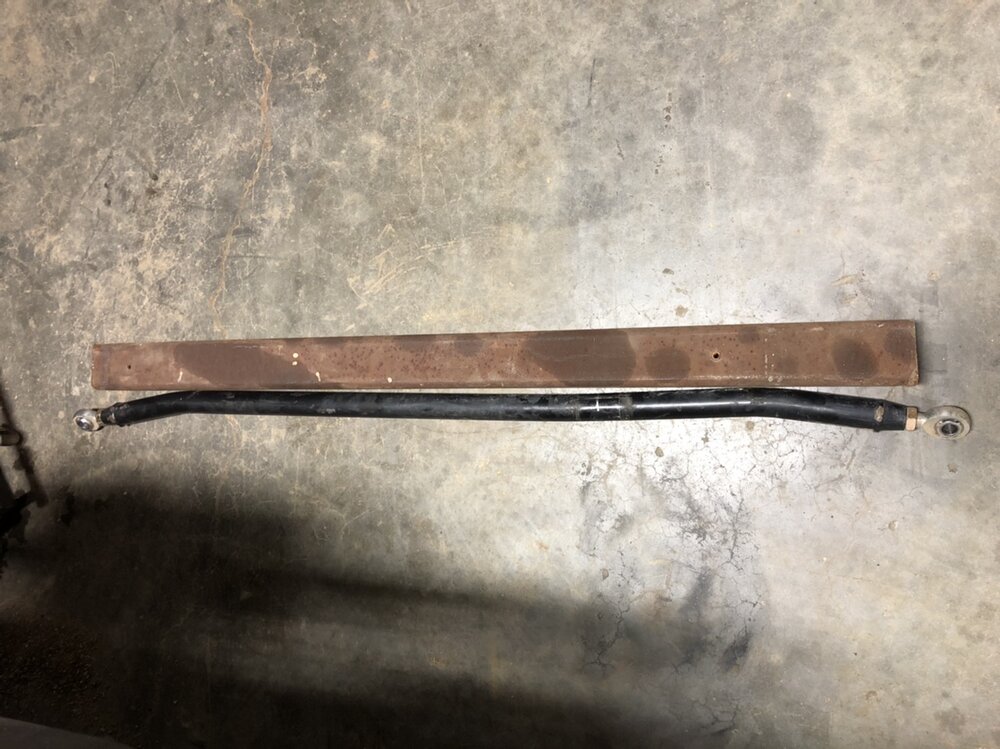

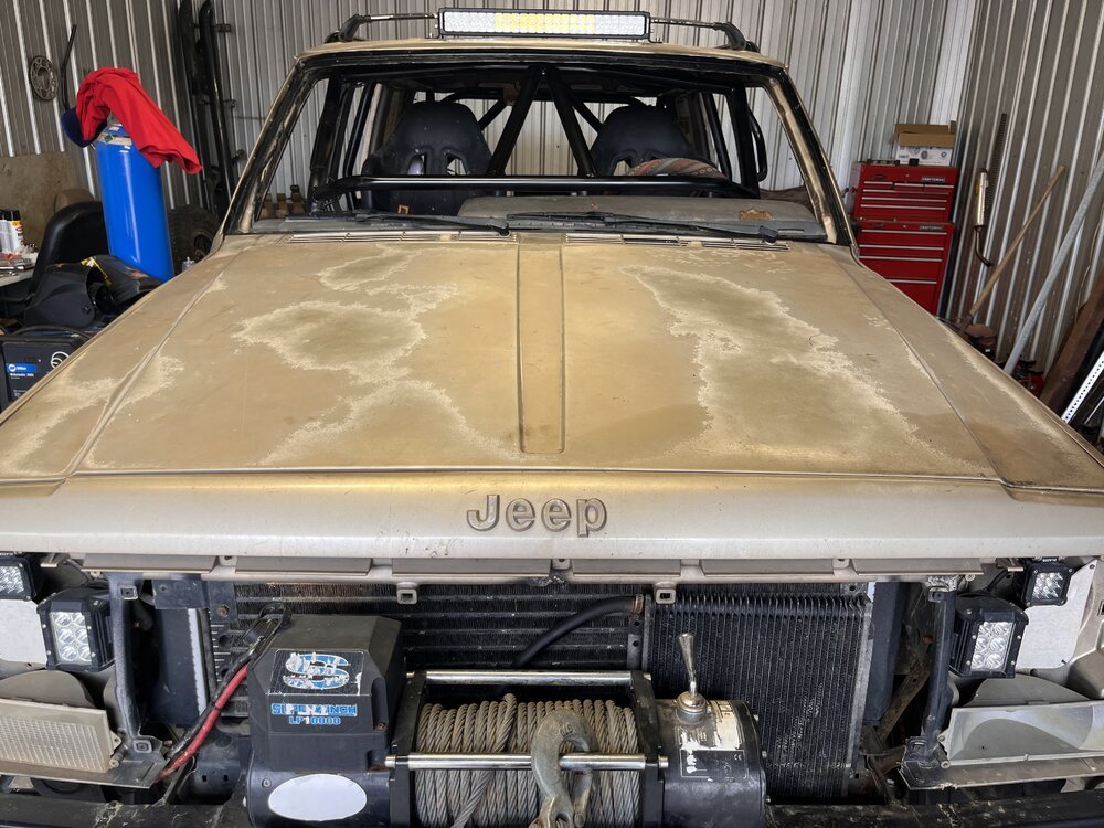

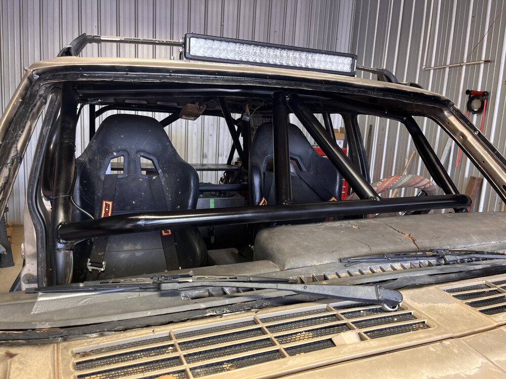

Well last weekend @URE I bent my 1.5”x 0.25” wall DOM tie rod for the second time. So I ordered up a CavFab 1.5” solid stock tie rod and got that installed this morning > hopefully it’ll hold up!
Update: it’s still getting beat on. Haven’t done too much building on this other than a few little upgrades like Azzy’s t-case linkage, etc
Mainly just trying to consistently go wheeling these days!!

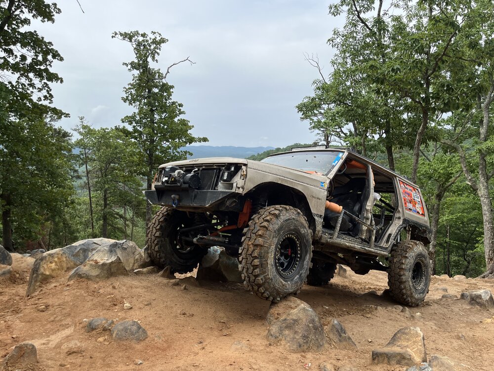

Pic from yesterday.

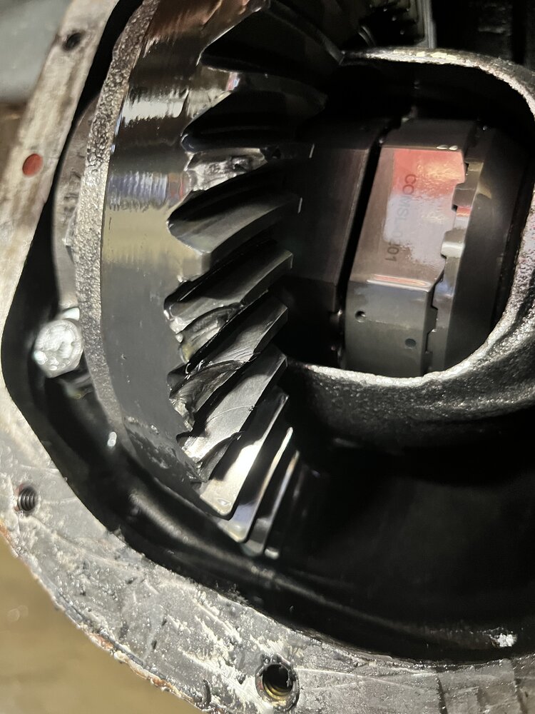

Well this is a minor setback
Anybody know of a local company that does cryo treatment for R&Ps?
What axle and tire size? What gear set? I'm too lazy to look back. They could have been set up bad. Unless of course the @Jody Treadway did them...
Haha I set them up 😂 however they were chinaBay special US Standard or whatever. I have a set of Yukons on the way.
36s with chromo shafts and 300M joints, idiot driver, healthy 4.0, 4.88s
Front30? rear8.25? Either way 36's is too much tire for those axles. JMHO.

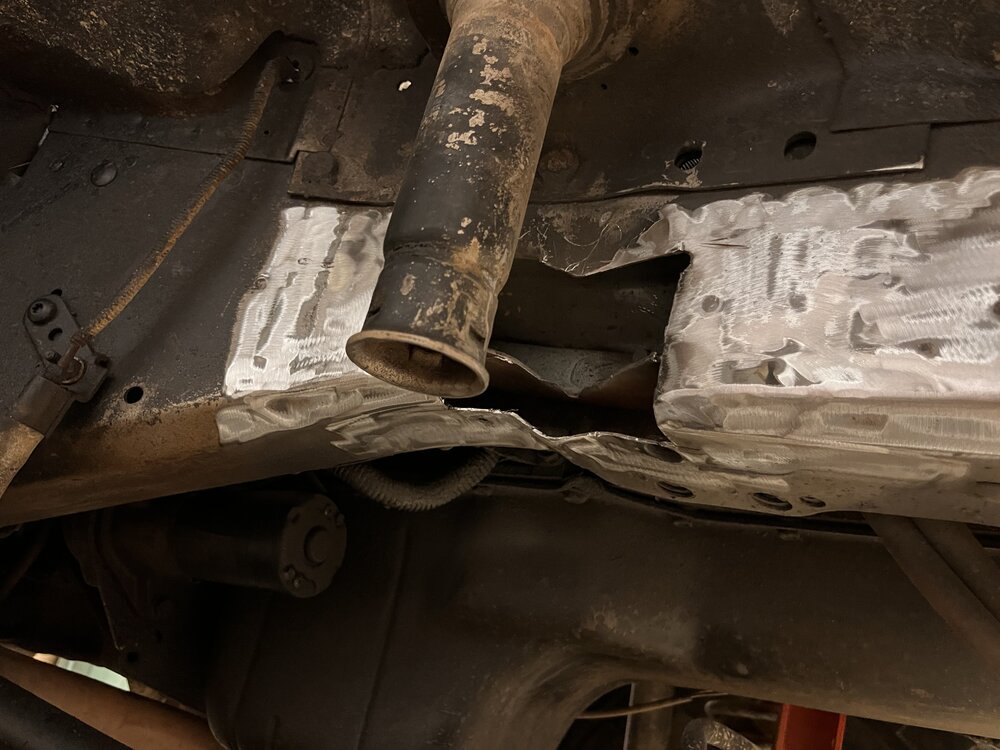

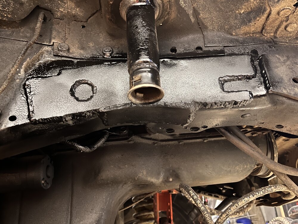

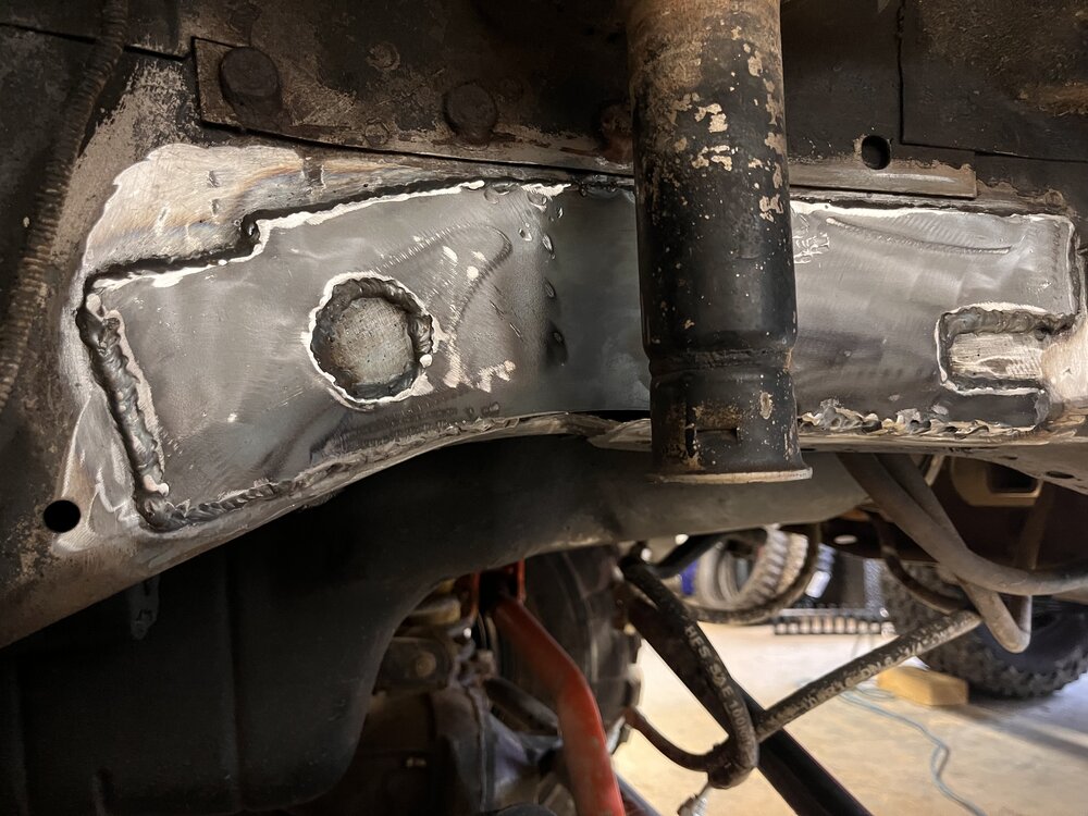

After the last Harlan trip and two nights of night riding, I bent the unibody on the passenger side. Got the jeep back, cut out the bent part and straightened it back with a bottle jack. Plated the unibody, now back in party mode :beer:

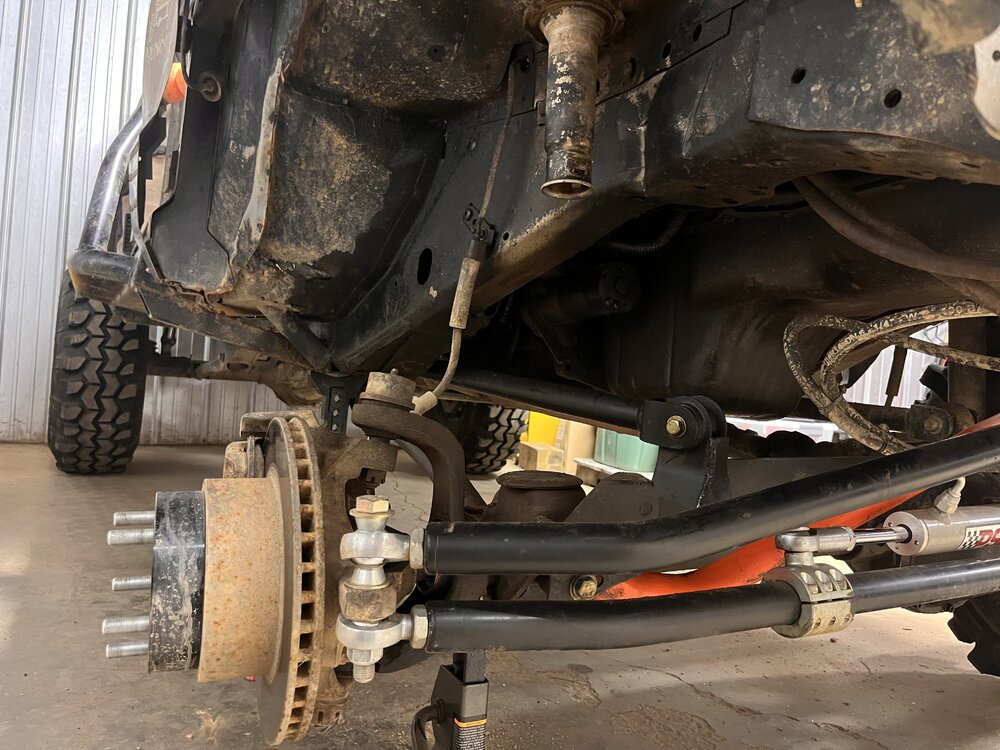

is the upper ball joint not pressed in or lifting out? Maybe the camera angle?
That side has a moog adjustable ball joint on that side and has always sat up like that since it was installed 4 years ago. Not sure why it sits up like that to be honest, I guess the shoulder on it bottoms out before that lip?
