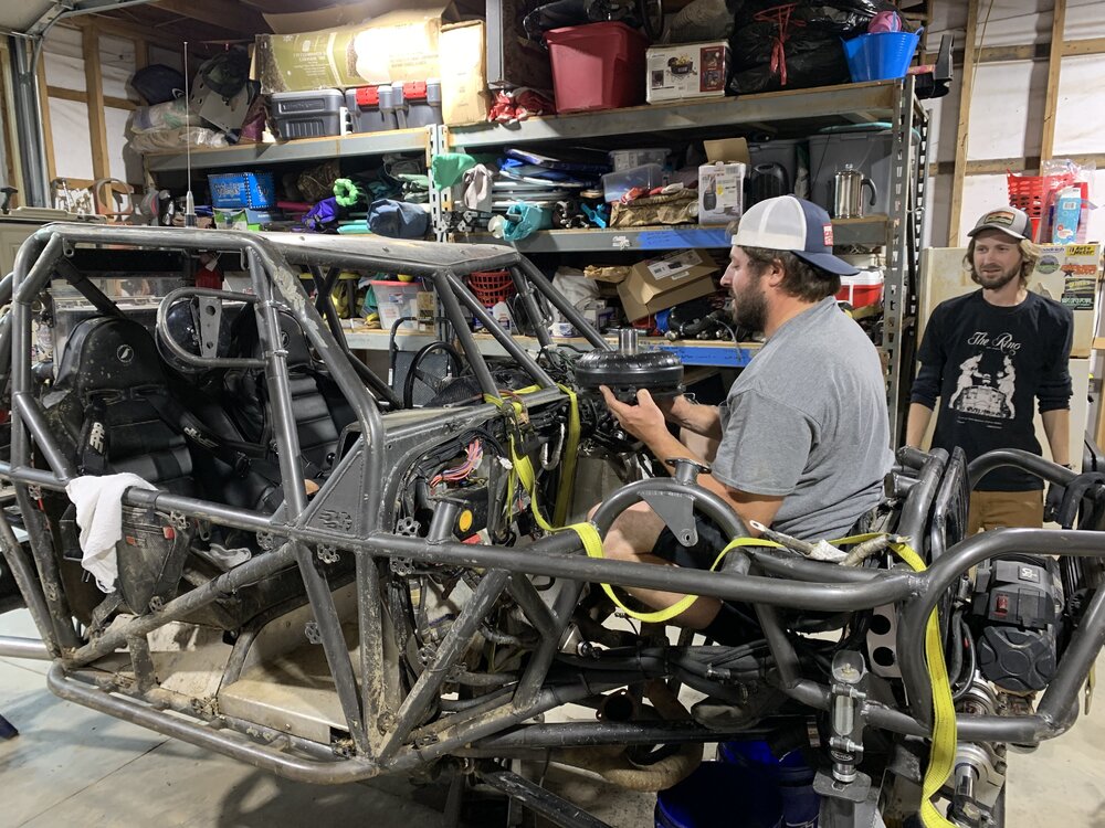

I'm guessing there's no room to drop it without pulling the motor?
If I drop the pan, I’ll cut the oil pan skid protection tube off. Then just weld tabs back on to make it removable in the future.
