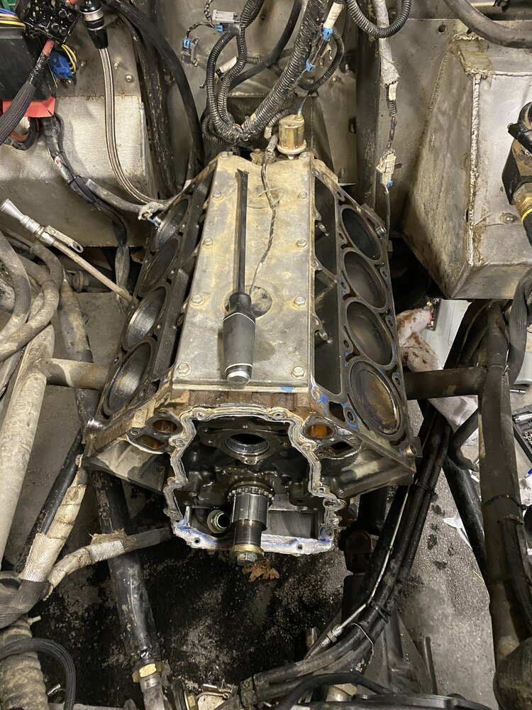

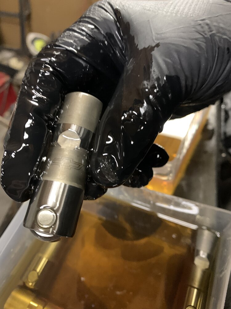

Found extra parts in my oil pan

These ls7 lifter failures are getting super common it seems, I just got my caprice back together from a lifter coming apart at highish rpm.
I think it's a manufacturing issue since they became the only factory replacement for all LS lifters. I picked up a set 10 years ago that have been doing quite well.
The ones I've seen fail have been, more often that not, run with stupid heavy double and triple valves springs. A lot of places suggest running more valve spring than what the cams realllly need.
Although, if I ever do pull the heads on my motor again, I will probably opt for some Johnson link bar lifters.
Hopefully the genuine Chevy performance ones are better quality.
