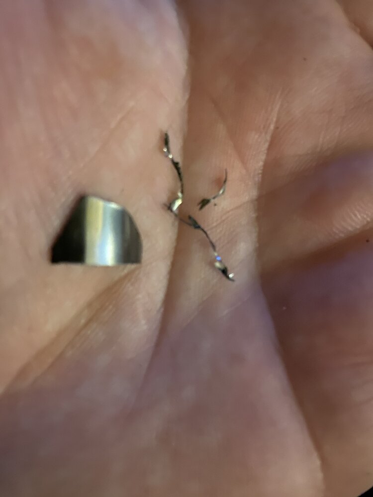

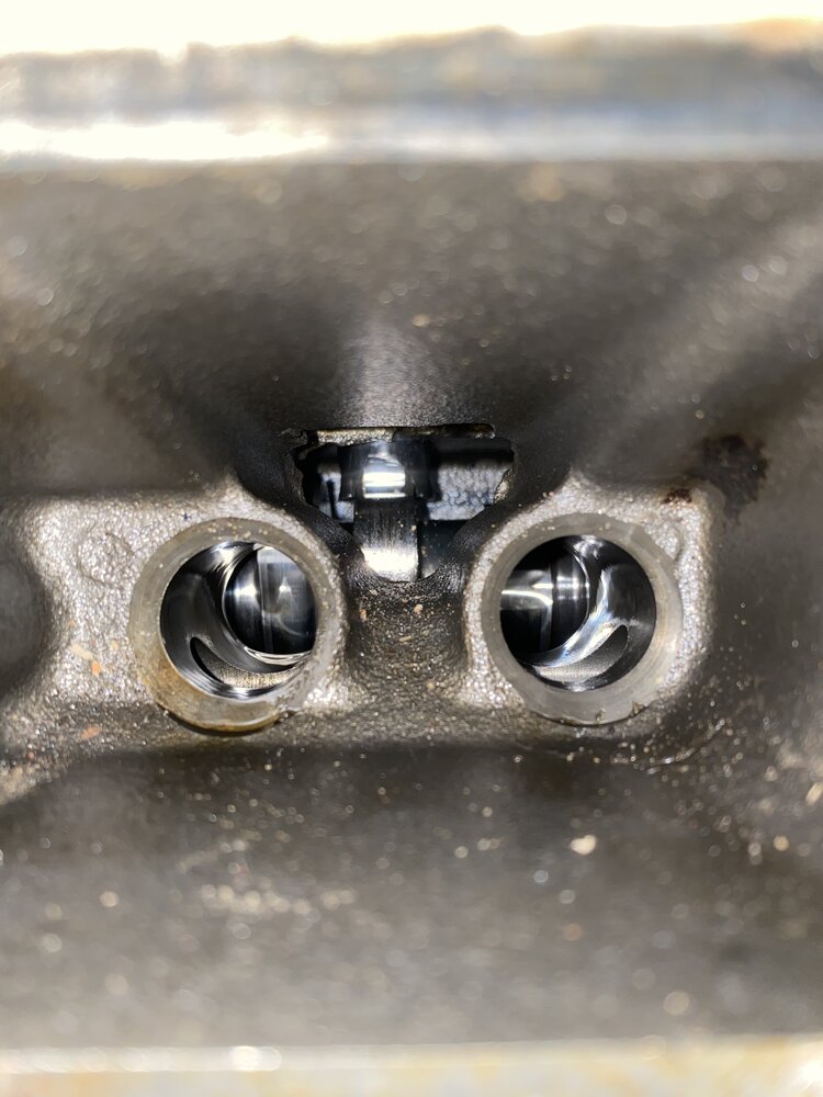

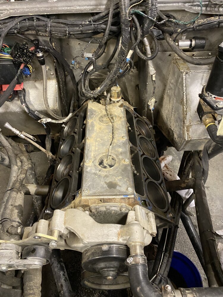

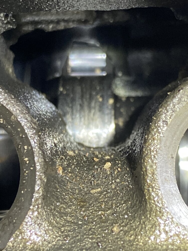

So….. did some fishing with magnets today and pulled a couple more pieces out. There was a couple that wouldn’t fit thru the drain hole 😳. I’ve got the parts ordered to replace the lifters and trunnions. So I’m going to go ahead and pull the heads and see what I find. Hopefully my cam is still good and I’ll be able to install the lifters and rock out. 🤞🏻🙏🏻
Definitely part of a lifter on the left. I don’t like the drill shaving looking pieces on the right 😳. I’m going to cut the oil filter also and see what I find. I’ll let y’all know what I figure out!
I’ve got an LS1 with your name on it. 🤣

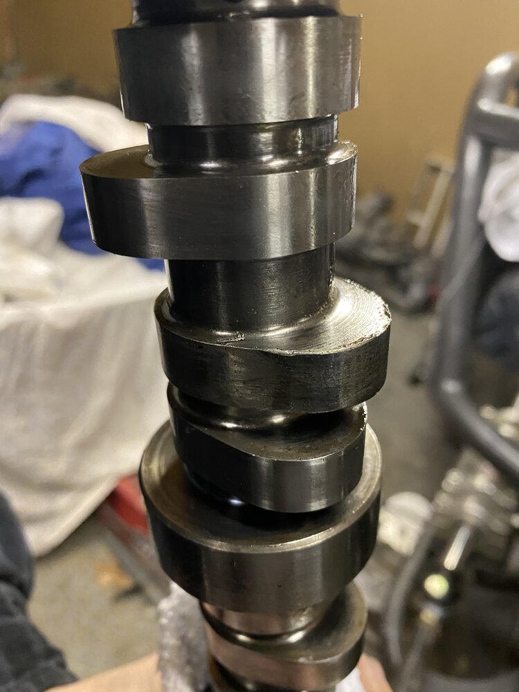

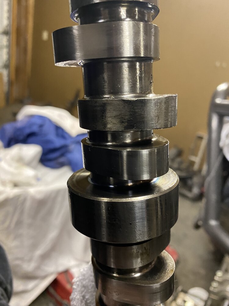

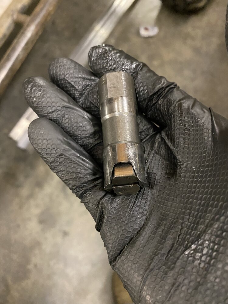

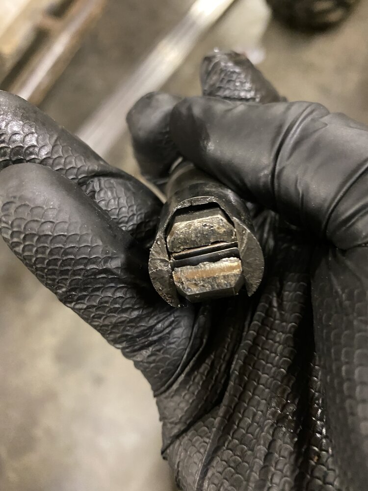

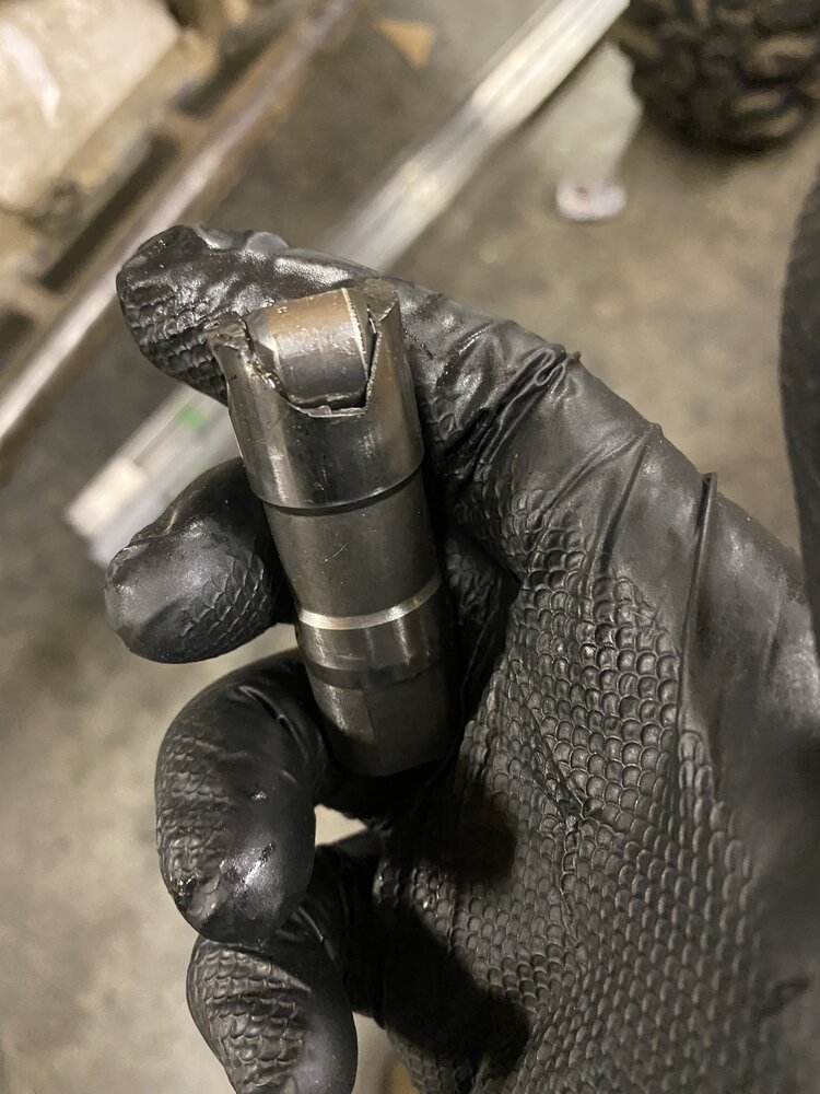

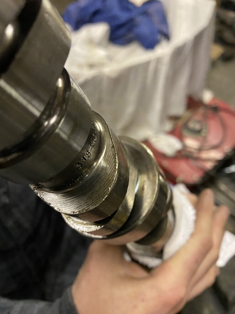

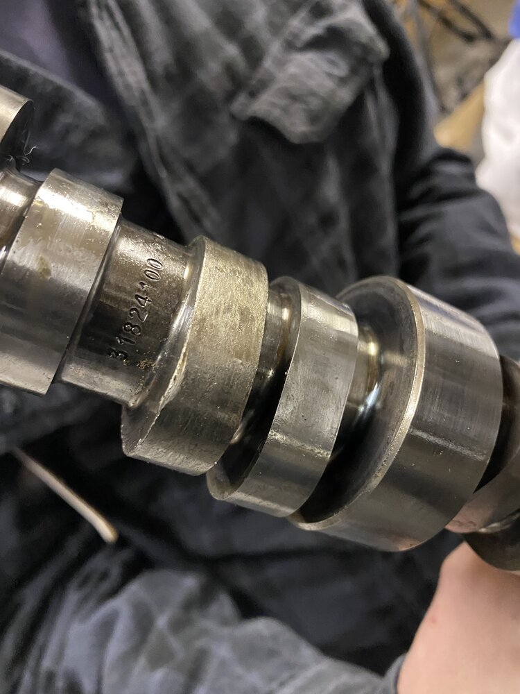

We’ll…. Glad I took the heads off. Found one lifter with the side blown out and half the roller gone. Also, wiped out the one lobe on the cam that the lifter was riding on. The lifter was a bit$h to get out and scored the bore as it was removed. Have to hone the bore to get it right. Going to replace the cam and lifters and let her ride. I’ll let y’all know how it goes.
