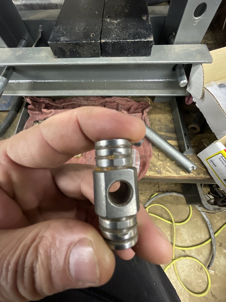

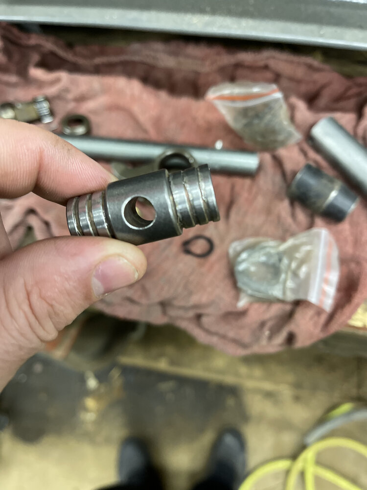

Found extra parts in my oil pan

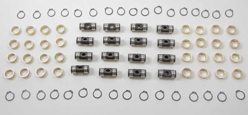

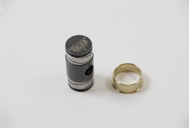

You need to post a picture of those trunions you ordered from jegs.
They was absolutely $h!t machining! Hard to tell in the pictures. Ended up ordering the CHE brand and they look sweet. Hopefully they will be the same in person.
It’s a good thing you went ahead and tore it apart and didn’t listen to me.
So do you think it failed from the heat, or just coincidently was a bad part that showed itself after the beat down?
