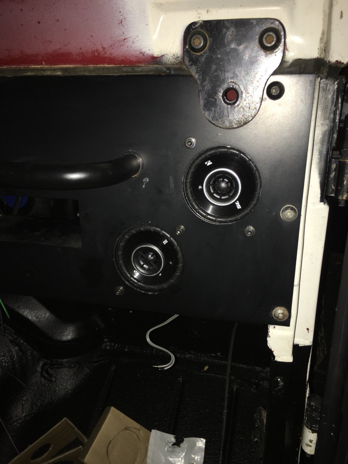

i picked up some audio materials so i can wire up this radio. also picked up the mini wire clips needed for the wiper. ill jethro something up with mr. fife and get them workable. ultimately ill need to acquire a new motor in order to get the pigtail that comes with it, and then get a new wiper/brights assembly for the column. then ill be able to use the signal lever to operate the wipers. or ill leave it as is and use one of the switches to run it.

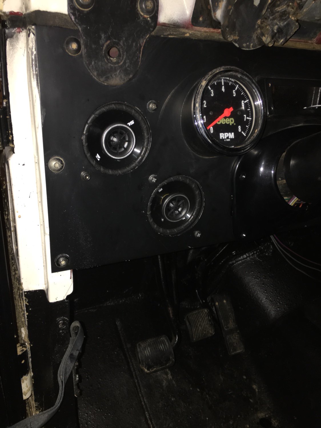

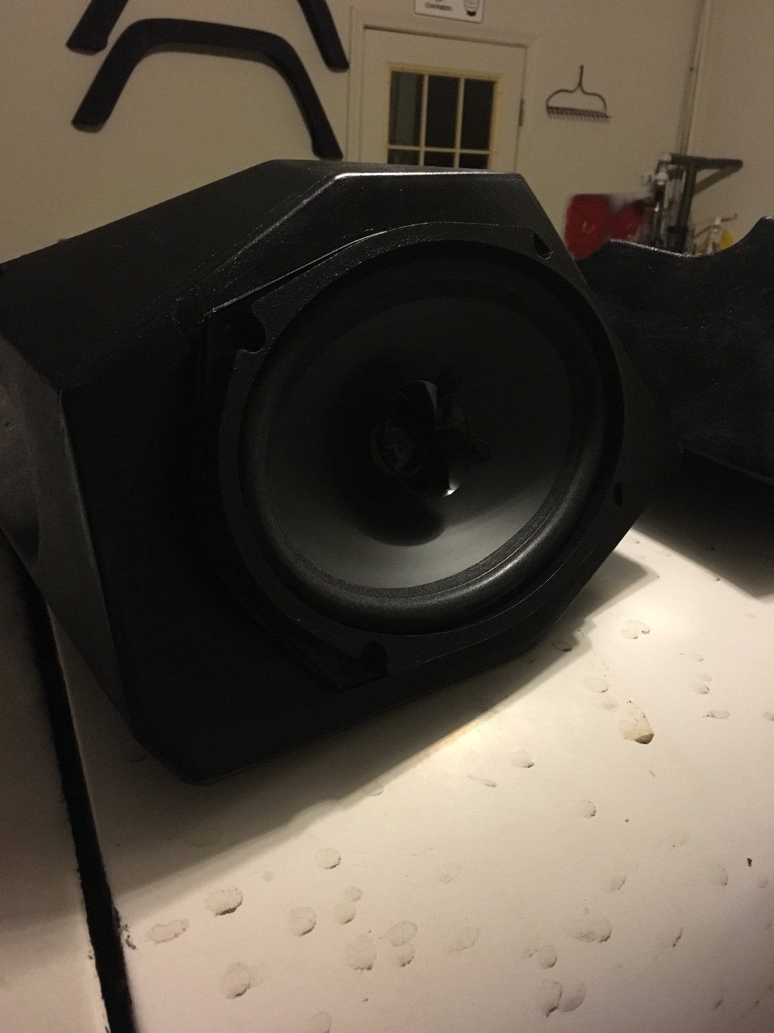

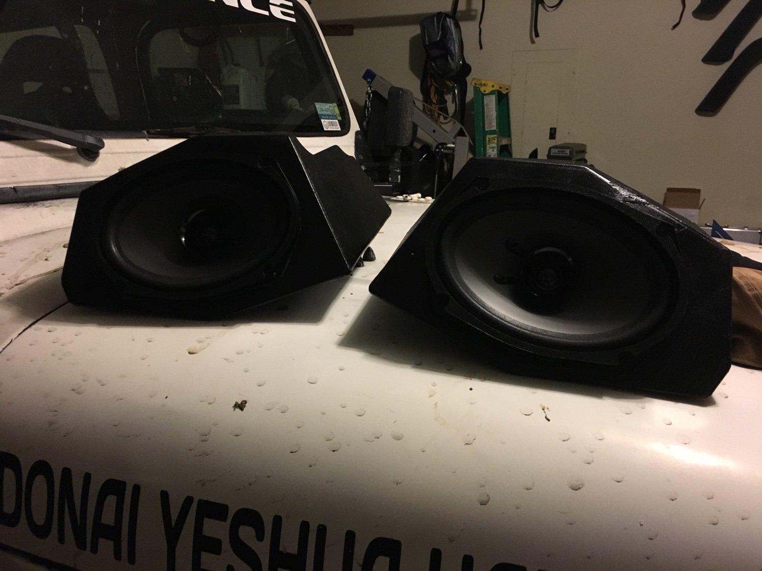

Speaker stuff
Shoulda got some sony xplode speakers for the dash, that way you could have kept your red/orange and black theme going from the engine bay to the inside... :flipoff2:

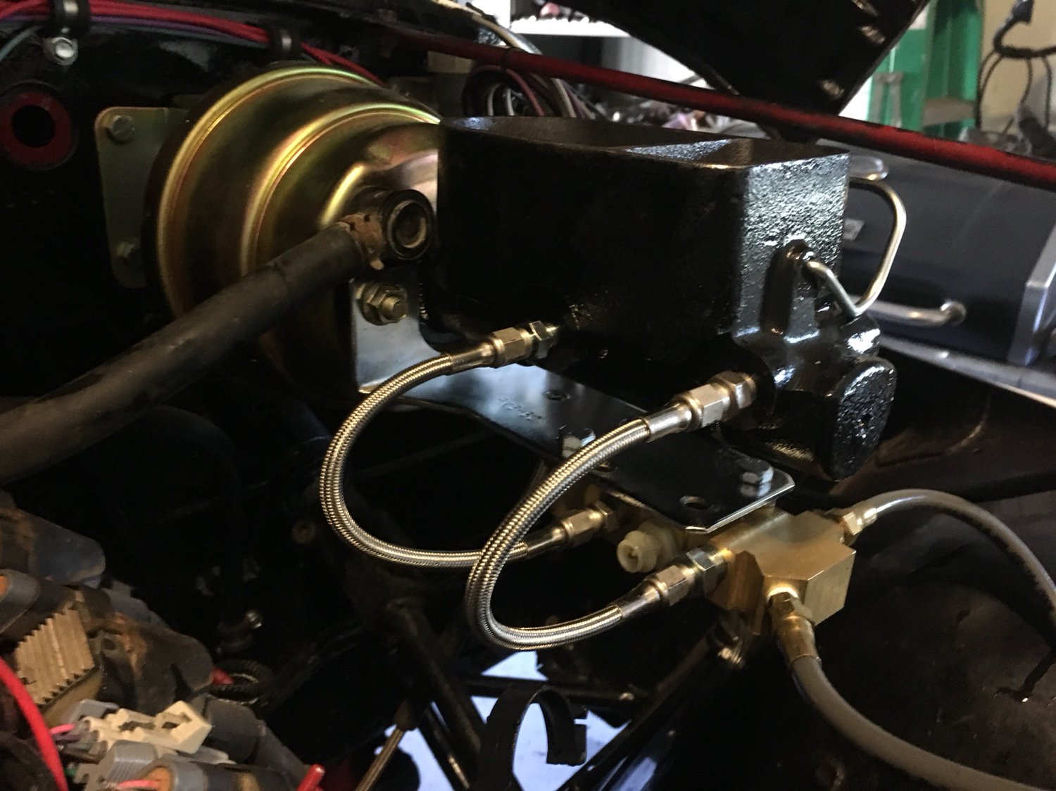

These are the braided lines i got off amazon to do the master to prop valve with. They are working extremely well. Super cheap compared to braided lines jegs/summit and other places had. No leaks. Used some -an to inverted female fittings to get bolted to the master and prop.
http://amzn.to/2DsJh1M

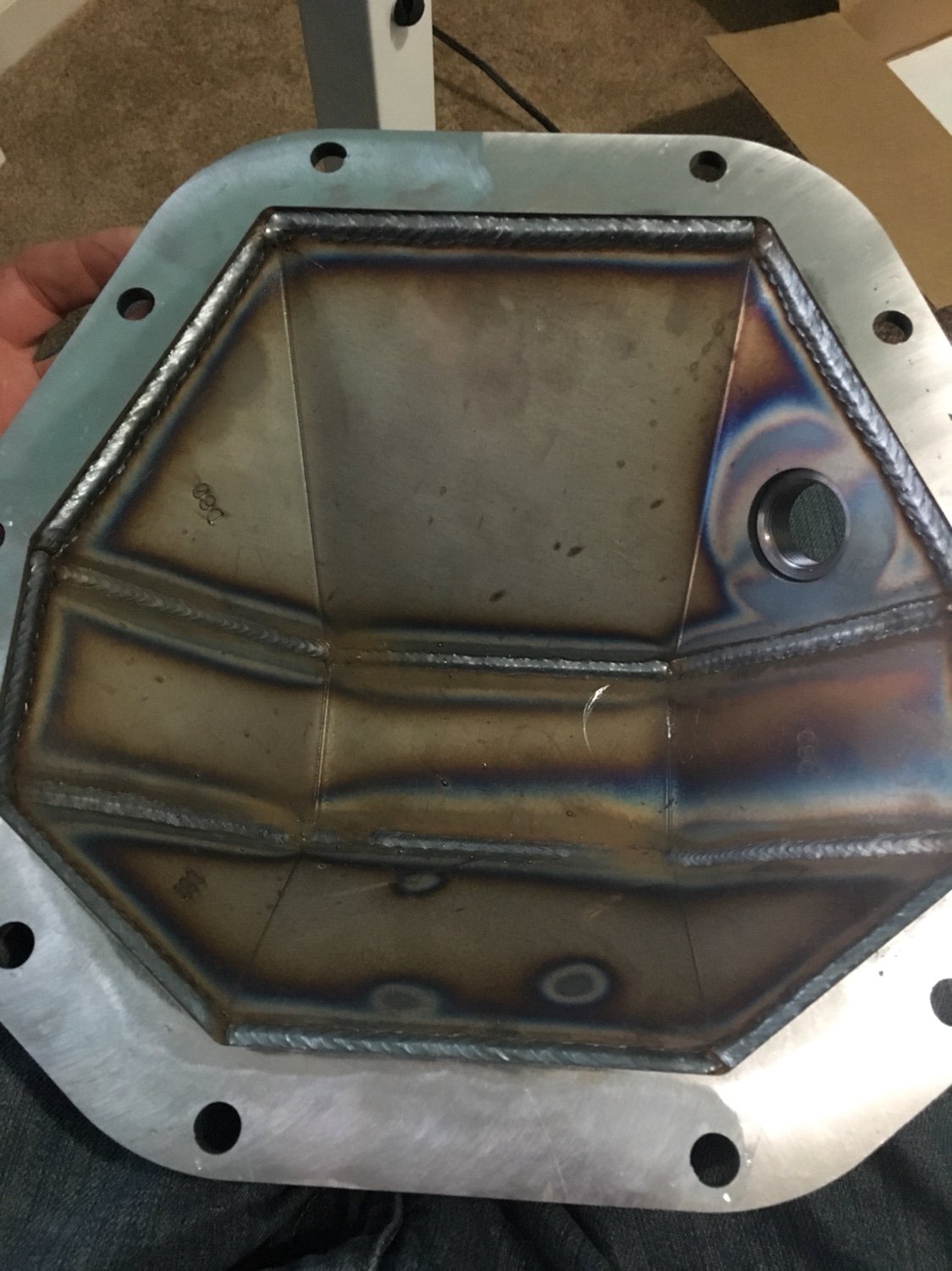

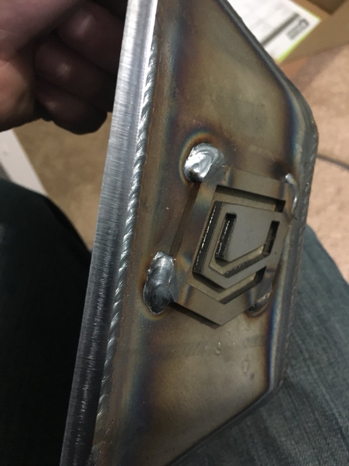

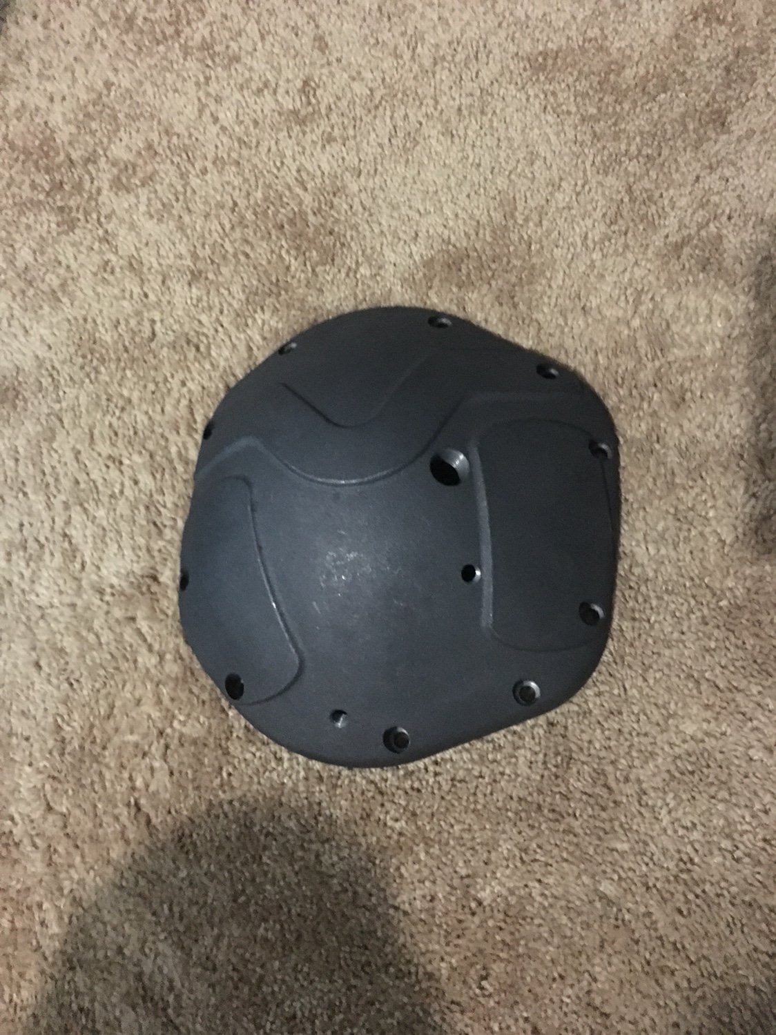

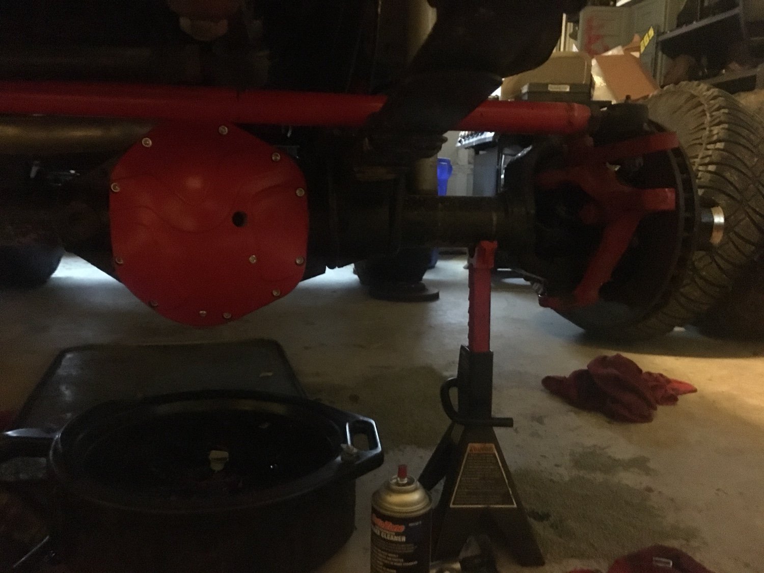

Installed the spartan locker today. So officially 4x4 now! Forgot to take pics (woah...) but here is a pic after done and the Metalcloak diff cover installed.
Filled it up with fluids and finished putting the calipers and wheels back on.
Now need to dig out the torch and get this shifter rod bent for the 4wd shift.
Ordering a 60 diff cover with a high fill tomorrow. Then just gunna bolt up the stock skid plate for now. Need to go buy some sheet and befriend someone with a plasma cutter lmao.
