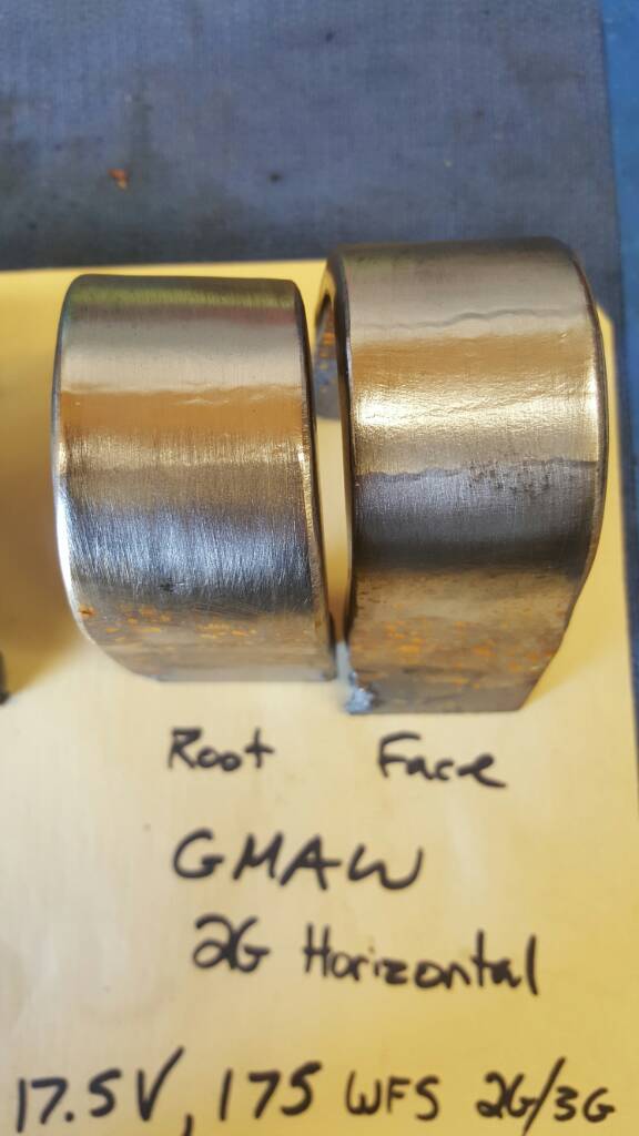

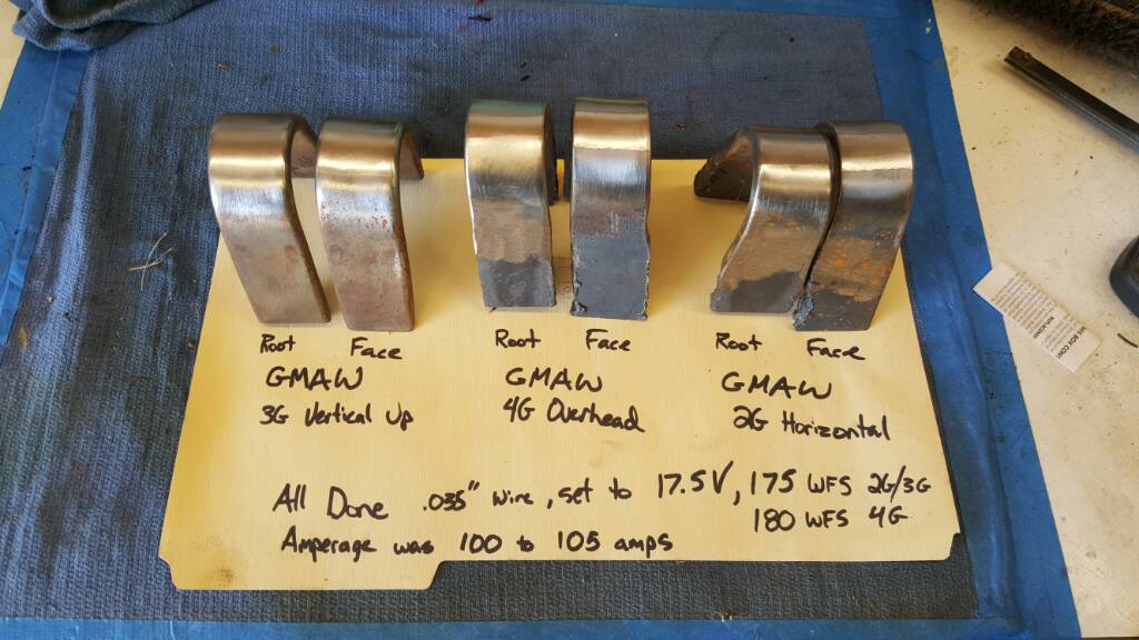

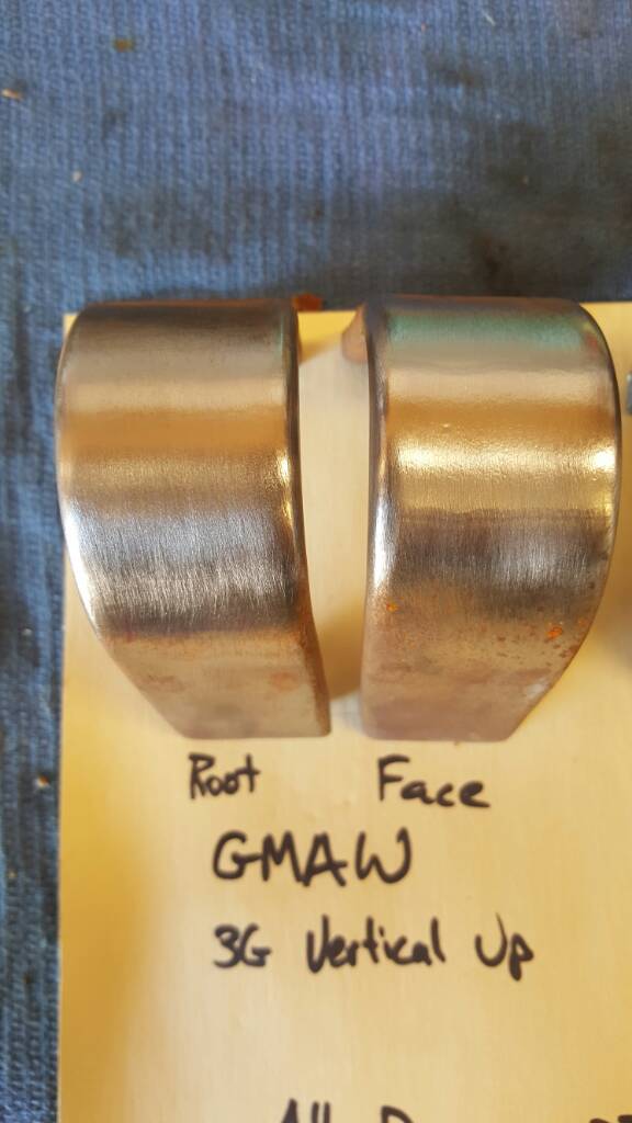

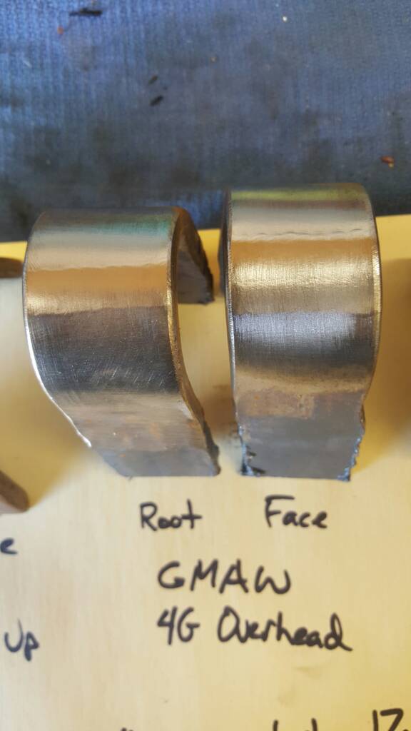

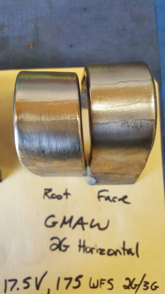

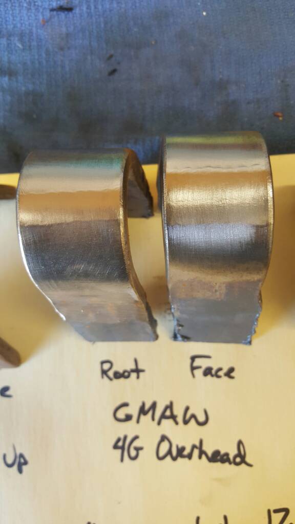

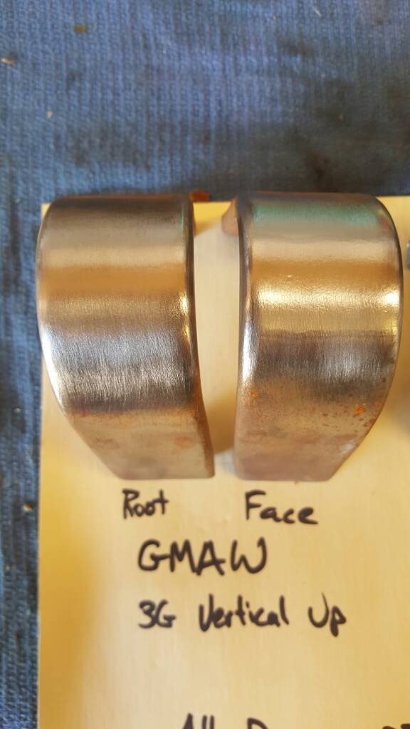

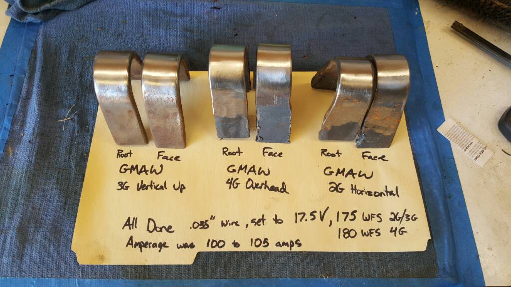

thanks for the pictues but I have NO CLUE what I'm looking at...sounds like you welded with .35 flux wire with 110v welder???I'm just going to leave these here.
I thought I would push the amperage range of .035 hardwire and see the outcome.
All 3/8 plate, 22.5 degree bevel, 1/4 " backing
ohh ok. was confused. so am i getting 3/8plate too for my little welder or am I getting the "normal" stuff that is meant for 110welderThis is a basic weld test results.
Not a 110V welder, a 220v or larger.
MIG welded horizontal, vertical, and overhead. Was done on 3/8" plate with. 22.5* bevel with a backing plate.
Weld the plates together and bend them in a U shape to see if the weld fails. No failures when bending, these are good all day long.
