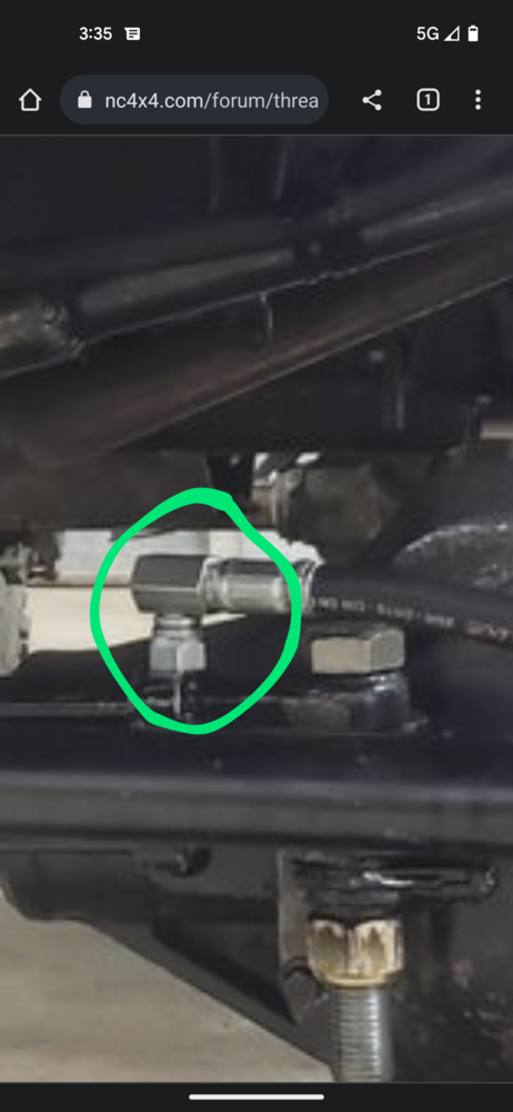

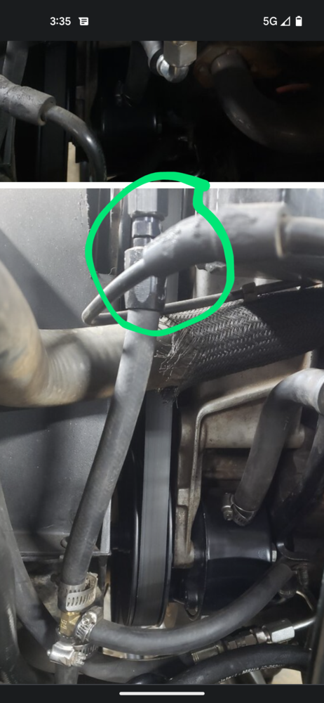

On top of poorly modded pumps and likely mismatched parts, these ain't helping at all.
The first one is a major restriction.
View attachment 384208View attachment 384209
can you shed light on what's the restriction? the fitting I'm using? I use those DYI power steering kits for the LS swaps and they work great so I thought they would work on Full Hydro but apparently they are not advised??

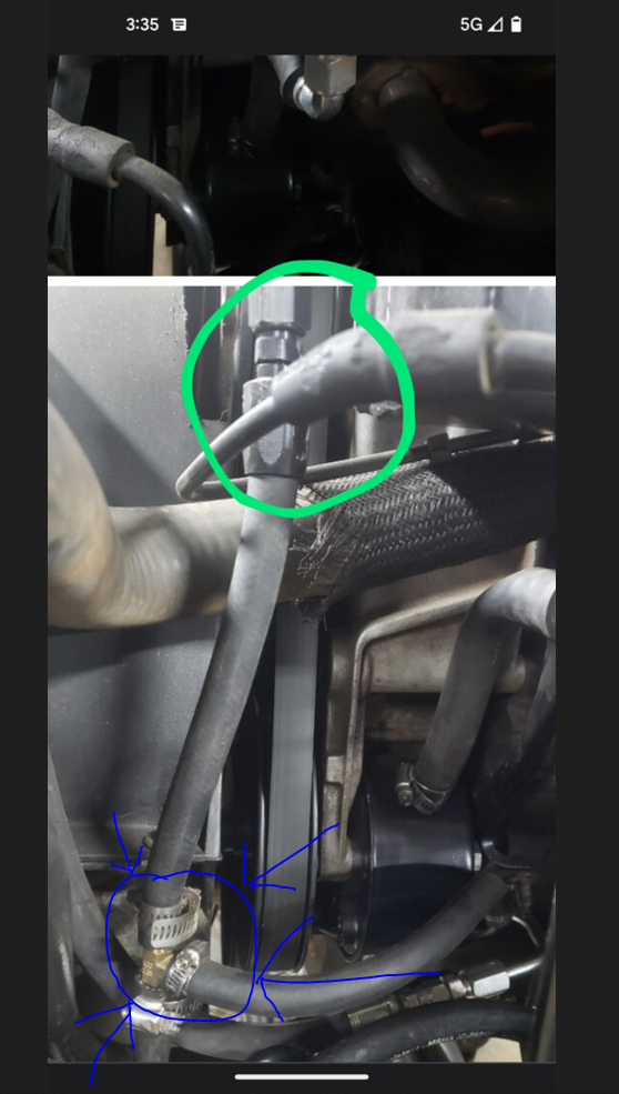

That pump was for hydro boost brakes. I think he might have T’d in the extra return port for to another point in the system
Absolutely bad idea. Delta P from external resi to internal resi needs to be positive otherwise you're balancing the pressures and slowing the inlet flow something major. Not good.
