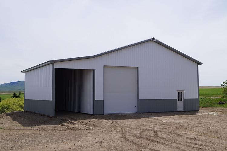

You are correct that traditionally a lean to is open except for the shared wall that the lean to is hung from. I will be enclosing one of mine, similar to this picture.
I'm building my barn to house my camper, peterbilt, 5ton, excavator, ctl and attachments, tractor, atvs, sxs, and hopefully have room left over for future projects and some parts so that my shop can stay clean and organized. Atleast that's the plan. I'm doing the lean to because I don't need 16' of height except in the main section and trusses over 40' raise the price considerably due to needing bigger post and I'm guessing larger steel in the trusses also.
