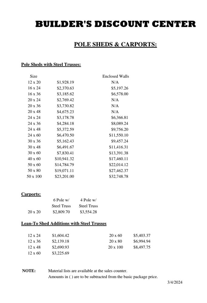

Got the quote back Friday. $42,xxx 😕. The base package for the building before adding in doors, lean-to, soffit, etc was 28ish. The quote never mentioned the insulation so I'm not sure it's even in there. I did go for a slightly higher pitch and 2' higher walls than "standard", but idk how much those changed the price. Bit higher than I was hoping for but honestly, I can't say that I have much for a frame of reference. Gonna quote builders discount next and see where it stacks up. BDC shows $17,xxx for their bare bones, enclosed, uninsulated 40x60.

Same package, including 3 insulated/wind rated garage doors is 30 on the nose from BDC. $12,000 difference will go along ways on the concrete!

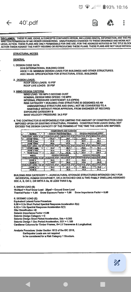

Care to elaborate? I can find the engineered drawings for BDC but not r&r.

Man I cant find my notes from a year ago.
I remember the conclusion I drew was that the R&R trusses were stronger but in a no snow area like mine didnt justify the add
Are they both using the metal truss with wood poles?
