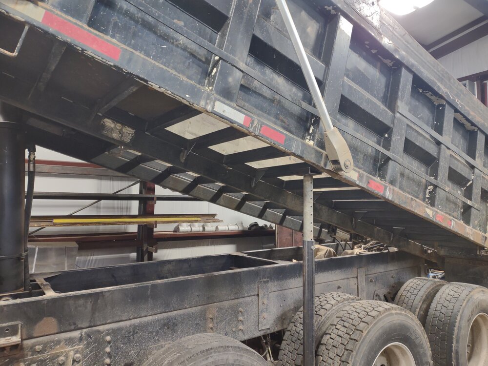

I'm 60 by 40. I can pull a tandem dump truck inside and I'm full.
Did I say full. I mean this guy has it's cab hanging out the front door. My small plasma room table is behind it. The center is full of tools and storage and the other bay is full of "project".

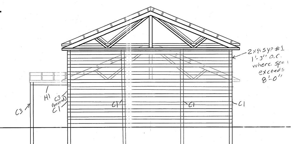

Has anyone here enlisted the services of an engineer to review/stamp post frame building plans? My county is going to require them due to the size of the structure. Most of the places i see advertising it will only give you the stamped plans if you buy their kits. For a number of reasons, i don't really want to go the kit route.
I have no problems drawing up a detailed set of plans with footer sizes, lumber sizes, fasteners, etc, but i have no idea who to go to have my drawings reviewed and stamped, or if an engineer would be willing to do that to prints he didnt draw himself.

Usually an independent structural engineer (see also retired from big firm and still doing small stuff) will provide you a 18x24 sheet with a small plan, details, elevation, section for a fee. Usually $500 a sheet or close to that.
Helps to know a few contractors, architects, engineers, inspectors in your area to find that person.
But they will likely double the cost of the build because they will take it from 6x6 posts to 8x8 posts and want 2x8 on 15" centers...etc
Just a sample

This is my concern with the engineered route. I don't mind a little overkill, but i know what can happen when an engineer gets a hold of something like this.
The flip side of that, is you don't want it to collapse because you decided to be a cheap bastard 😎
@Spence I know a great PE, if you are interested. He won't let anything slide that isn't structurally sound, but he won't overbuild it if you don't need / want it bombproof.
