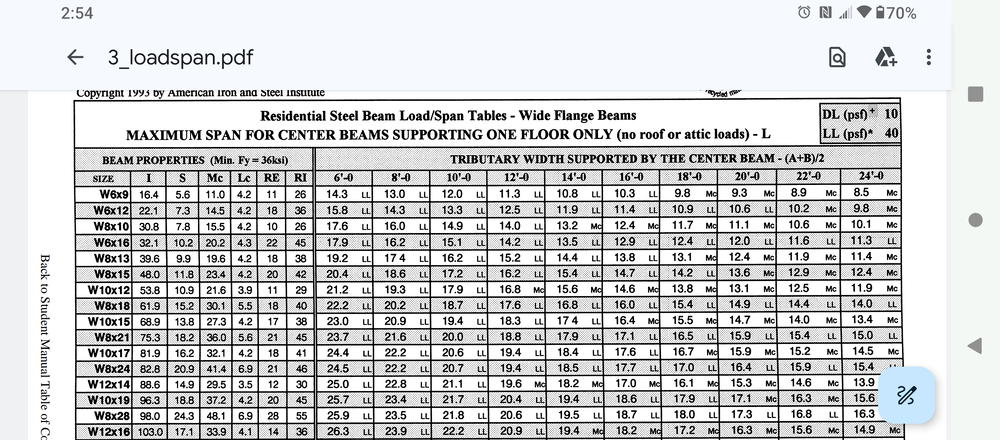

Because this beam will be supporting one side of my 10" loft, the tributary load will only be 5' if I'm reading this correctly. 6' tributary load is ok for 20' span so it looks like I should be good with 1 post in the middle. I'll report back it it all falls down.

You'd have to check the fine print, but that's probably based on a 40psf live load. Make sure whatever it is actually matches your use case.

Yes, 40psf live load is what I was using. What would you suggest I base my numbers on? I don't forsee storing thousands and thousands of pounds up there. I have warehouses for that.

I don't have an opinion on the matter, just wanted to make sure you were aware. Some folks might see that chart and then plan on storing pallets of old blocks and heads or rows of shelving stacked with who knows what "up out of the way".
As a point of reference, typical office loading is 100psf (though vibration often controls) with 200psf or more used in places where high density files or other concentrated loads might be. 100psf might be high if you actually do the math, but it's to allow for unknowns down the road.

Thanks for the heads up. This will be more for Christmas decorations and junk like that. Possibly a hangout are for the kids with a pool table and foosball table in the future. 8' pool table would be the heaviest "thing" that would ever be up there other than live weight. It would be situated the long way so not too much of a point load in my mind. I've got a few spans of pallet racking I'm putting up along another wall for storing heavy stuff.

Stairs + Pool Table = Not Enough Beer In the World for me to help you get it up there! An 8' slate table is ~1000# plus.
