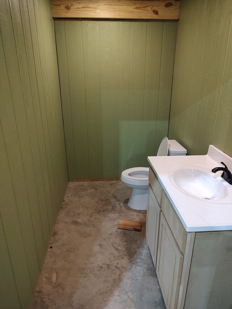

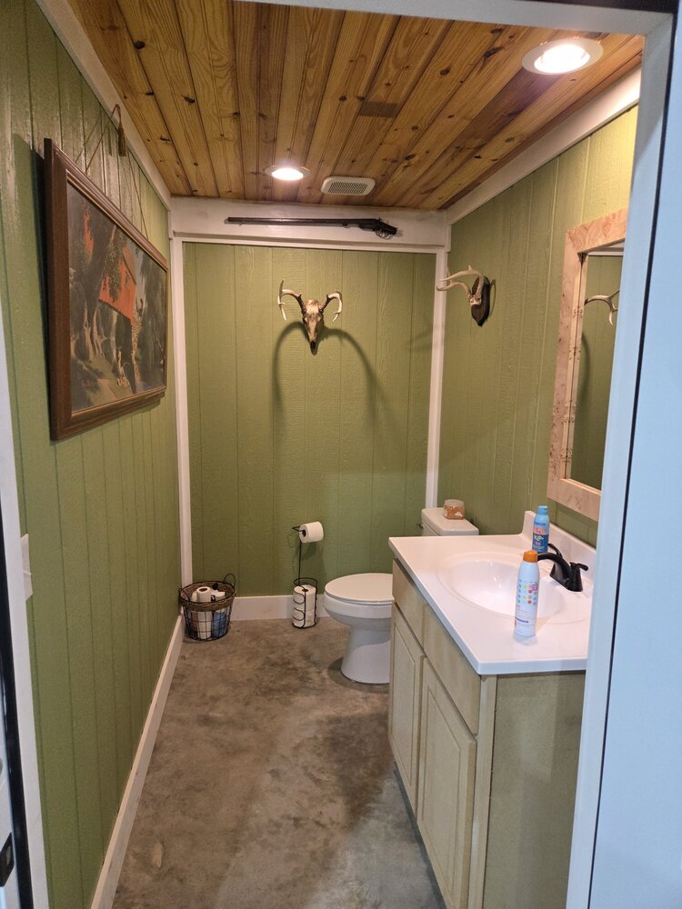

love the flat wood trimI just realized I never posted finished bathroom pics. I still have a little trim paint touch up and paint on the vanity (neither of which I'll likely do).
Homemade septic system is holding up well. Had my son's 6th birthday party here a few weeks back and with a gazillion people using the toilet no turds were floating in the yard.

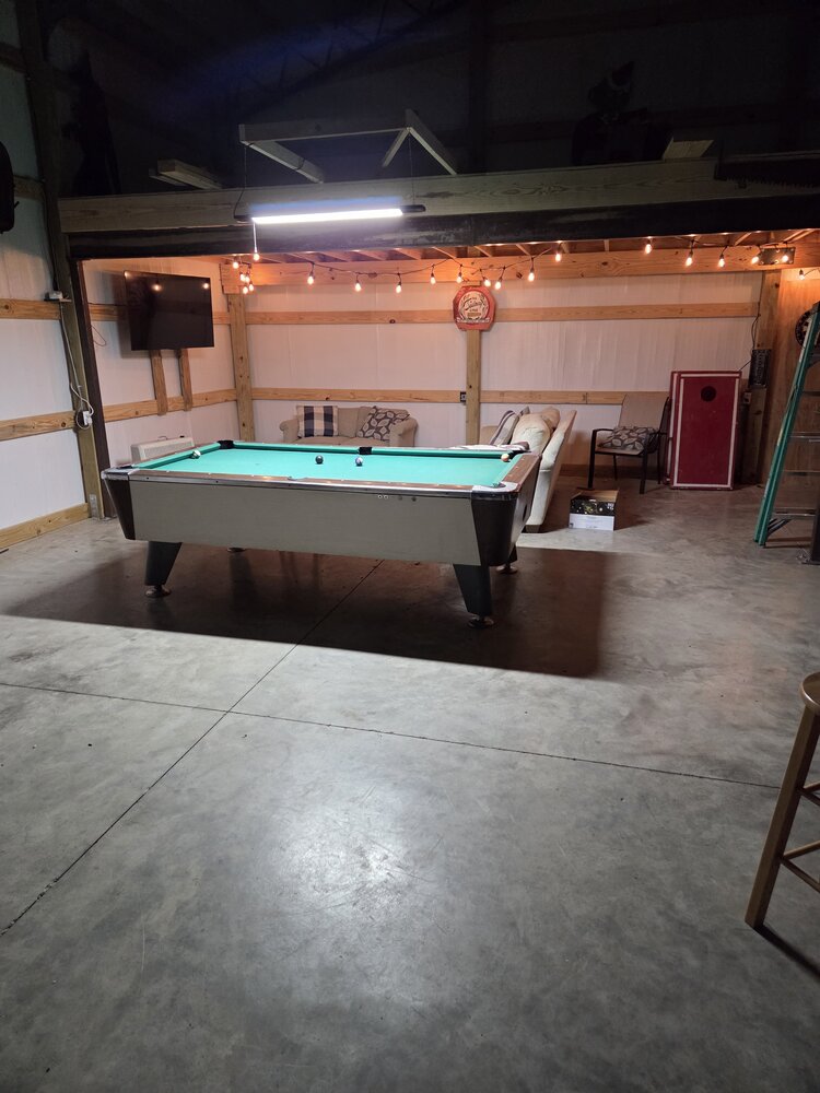

How high are your garage walls, that "shelf" loft and the roof peak in the center?This place is turning into more of a hangout space than workspace, and im not mad about it
Eaves are 14' precisely for the loft. Loft floor is 9' from shop floor. The horizontal 2x6's on the walls are 3' centered vertically for reference. Im 6'2" and i can walk all the way around on the loft until I get to the closest lower 2x6 on the trusses. @jeepinmatt could walk all the way wall to wall. I could reach up and stick my hand in the exhaust fan if I were so inclined. From floor of loft to roof peak is probably 10'.How high are your garage walls, that "shelf" loft and the roof peak in the center?

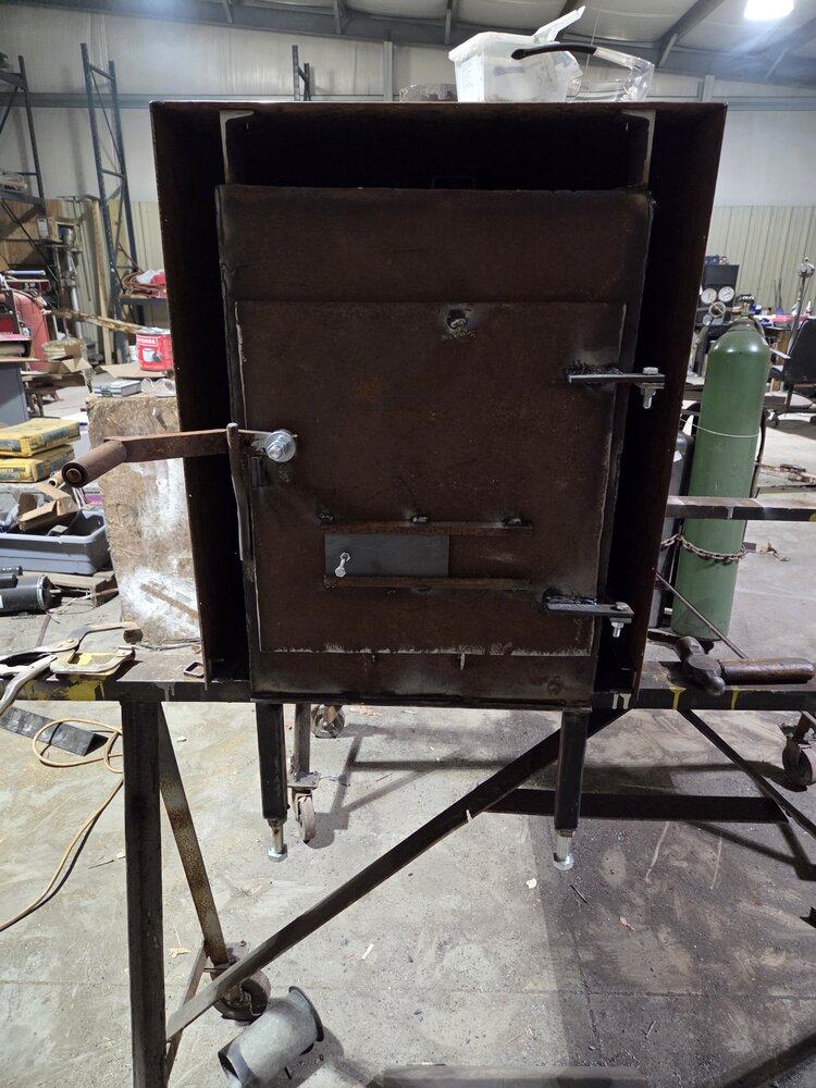

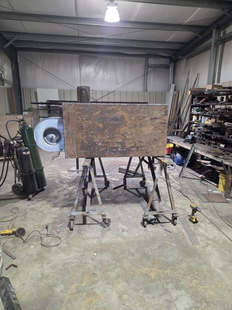

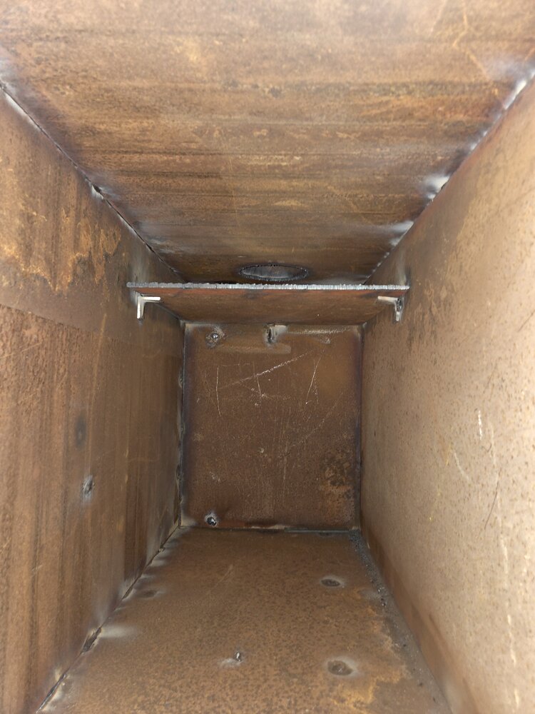

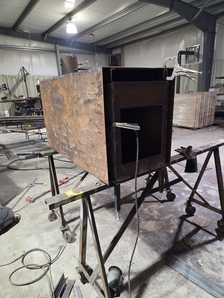

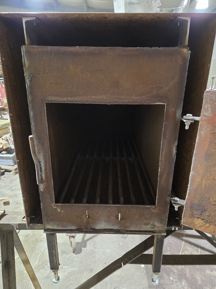

How big is it? Is that 1/4" steel you used? I've been kicking around a wood fired kiln for drying wood. My thoughts where a fire place insert but I want to load wood from out side and have the hot air circulate inside. This reversed could do that right? Or am I crack pot?Finished product. Not fancy but should work. I need a different blower though. This one is on the small size and all but one speed are bad. Got my buddy that does hvac looking me a bigger one.
Fire box is 18w×24hx48L, 1/4" plate. Its longer than most folks would make but I have an unlimited supply of busted pallet boards so I wanted to make sure it was ling enough.How big is it? Is that 1/4" steel you used? I've been kicking around a wood fired kiln for drying wood. My thoughts where a fire place insert but I want to load wood from out side and have the hot air circulate inside. This reversed could do that right? Or am I crack pot?
