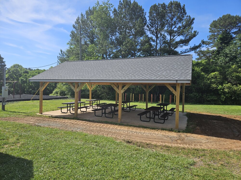

Roof looks great, but the rest of it looks questionableFor a materials price comparison....I built this for my wife's school this year. It was a 20x30. Had around $7k ($2k trusses, $4k for the rest of framing, $1k for shingles) in it for just materials, concrete pad was $4k, and I put it up by the hour when I had time and had the high school carpentry class help roof it.......maybe i should have got them an R&R that was about twice this size
Also I didn't bury the post, just did 2x2 footer underneath post and anchored them in the concrete. Ive never done an R&R but I don't think I would do an open one without sleeving the post and burying them. This one sturdy but you can tell it's not the same as burying the post.

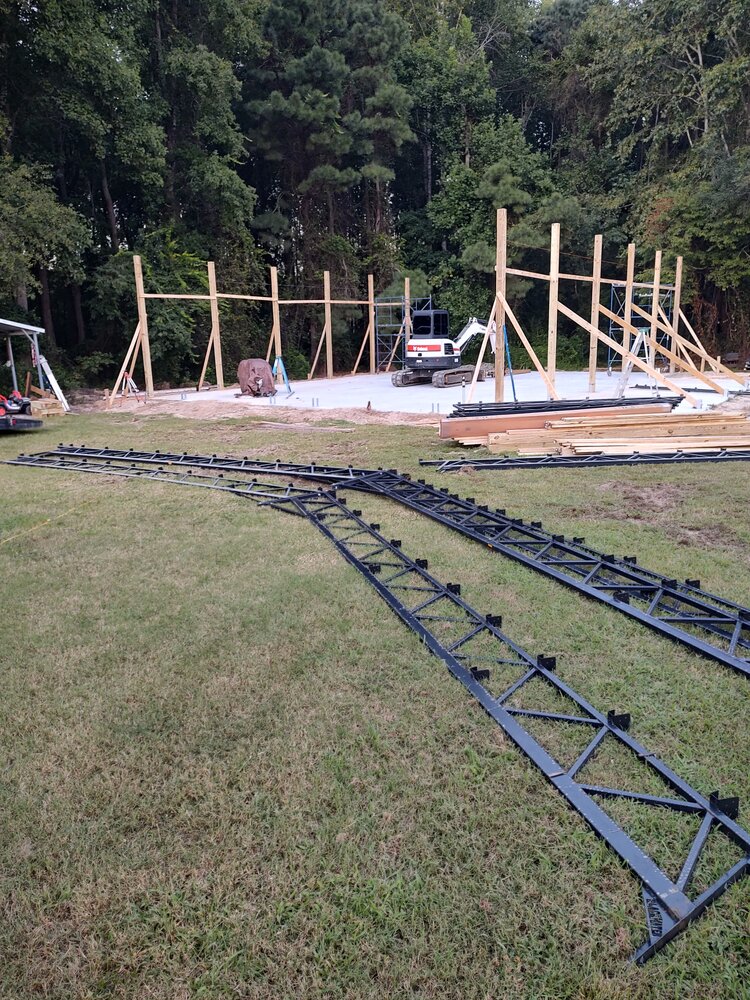

Where did you buy your wetsets? I looked at them online for the price I may make my own.Ready for trusses tomorrow. Dude said he really likes the wetsets, esp since my concrete guys put them in the right spots.

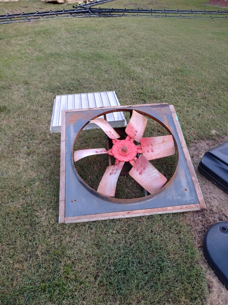

Picked up a 36" old school Dayton exhaust fan with louvers and the motor off marketplace today for $150. No mad about it.
Home Depot online. I thought about making brackets but honestly, I don't have a break or a punch and it would have taken forever to cut, drill, and bend 19 brackets. Then if you do the ones with rebar you have to cut and weld all those on. When I weighed the cost, and the fact that the Simpson brackets have an actual rating sealed the deal. I still welded some rebar angles to my corner brackets just because I wanted them to have some more grab.Where did you buy your wetsets? I looked at them online for the price I may make my own.

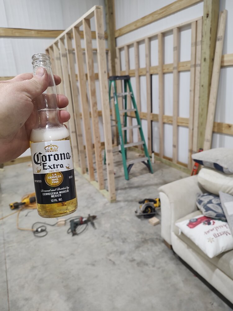

Got most of my bathroom framed up yesterday.
Got to drink like a framer to think like a framer.
That probably explains why I made the walls 3" too tall the first time and had to tear it back down and trim up the studsNo self respecting wood butcher drinks Corona
Modelo FTMFW
Looking good BTW
Now you know why studs come in 93s...when you figure out the 92 5/8s tell me so we both knowThat probably explains why I made the walls 3" too tall the first time and had to tear it back down and trim up the studs![]()
Assuming that pad was 20x30, what was the thickness? Trying to figure out ahead of time whether it is worth pursuing doing my driveway this year.For a materials price comparison....I built this for my wife's school this year. It was a 20x30. Had around $7k ($2k trusses, $4k for the rest of framing, $1k for shingles) in it for just materials, concrete pad was $4k, and I put it up by the hour when I had time and had the high school carpentry class help roof it.......maybe i should have got them an R&R that was about twice this size![]()
