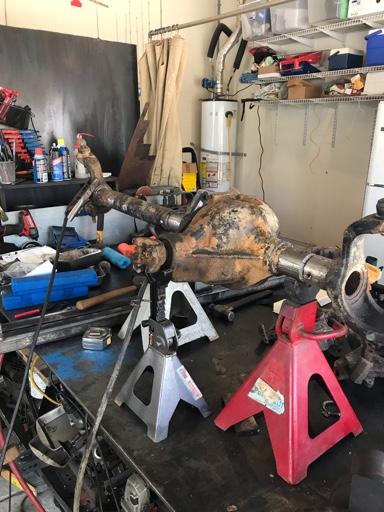

we get that, but we're trying to help guide you into a little heavier duty axle for the rear than a Dana 30. A d44 would be a better choice. In a Cherokee, we pop front ball joints, uj's, shafts & r&P's. A 44 is stronger & better suited. Yes, your motor may only make 25hp and 35 lb-ft torque, but add in gearing and you've got serious torque going through it. We're just trying to save you money by pointing you at better axles. D30 will work, but for how long? That's all. Good luck to you and i hope they hold up for you.I think most people don’t understand what I’m trying to build. It will be more like 3/4 scale of a Jeep on one tons.

Not trying to get in the way of the build thread but bro chill. Why do you keep coming back and trying to derail the whole idea here. Not everything needs to be over built to work. Homie will be on 31s or 33s and not bouncing it up hills. The setup will last and if something breaks occasionally then you can always replace it. And a d30 just works best because it already has the offset rear diff he needs for his transfer caseX2 we are trying to help you but you’re not listening. The only ton you can use to describe those 30s are tons of time and money wasted.

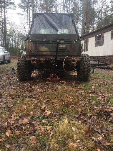

Rear steer is cool in any rig regardless of size. I think the idea here is for a one of a kind build that will run almost any trail that bigger rigs will run, out here on the east coast. It might not help as much with the smaller wheelbase but it is still a useful tool to have for those situations you wish you had it. And the whole point of a smaller rig is that you're more nimble and can hit those tighter spots (that's what she said) that bigger rigs can't.What's the fascination with rear steering? Not like it has a long wheelbase, guess somewhere in the low 90"? If that's the case then rear steer is just a party trick, doubt it will need to get used in real world crawling.

I feel like it is more of, a steering axle fits the offset of a Sami better, and isnt "custom". The ability to make it steer is just icing on the cake.

You better take a 6 pack of spare axleshafts with you to Harlan. Tac the caps on some 760 u joint shafts and get real good at changing them. Upgrade to rcvs and then start blowing up r&ps if the BJs last that long.
I want to see you do the rear steer just because it's unique. However, I have to agree with everyone that a d30 is a strange choice. That's a weak axle in it's factory front application, it will only be worse in the rear.
