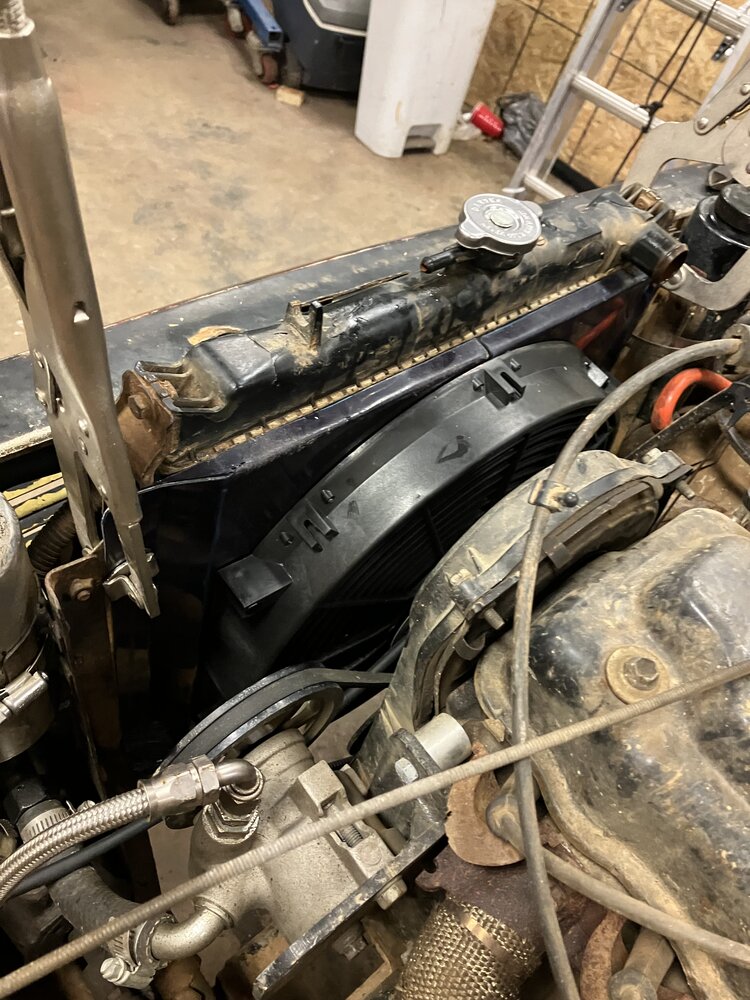

I’ve been having some problems keeping the engine cool when going slow in the rocks.

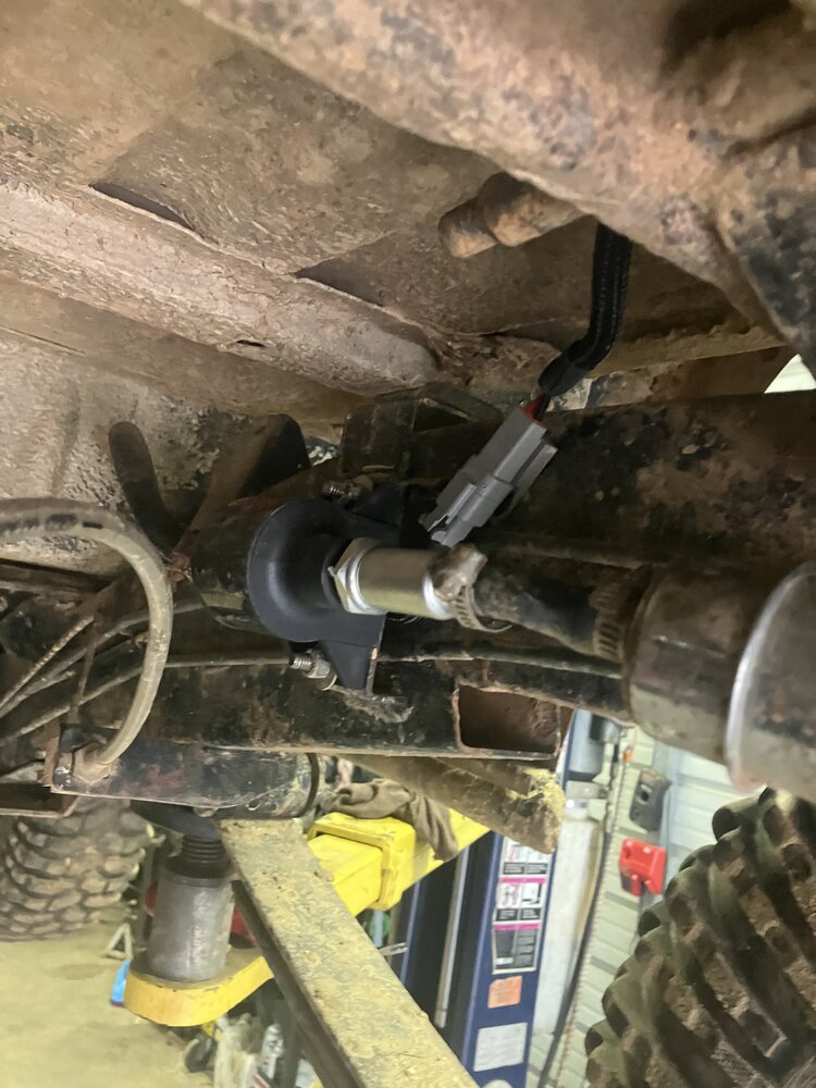

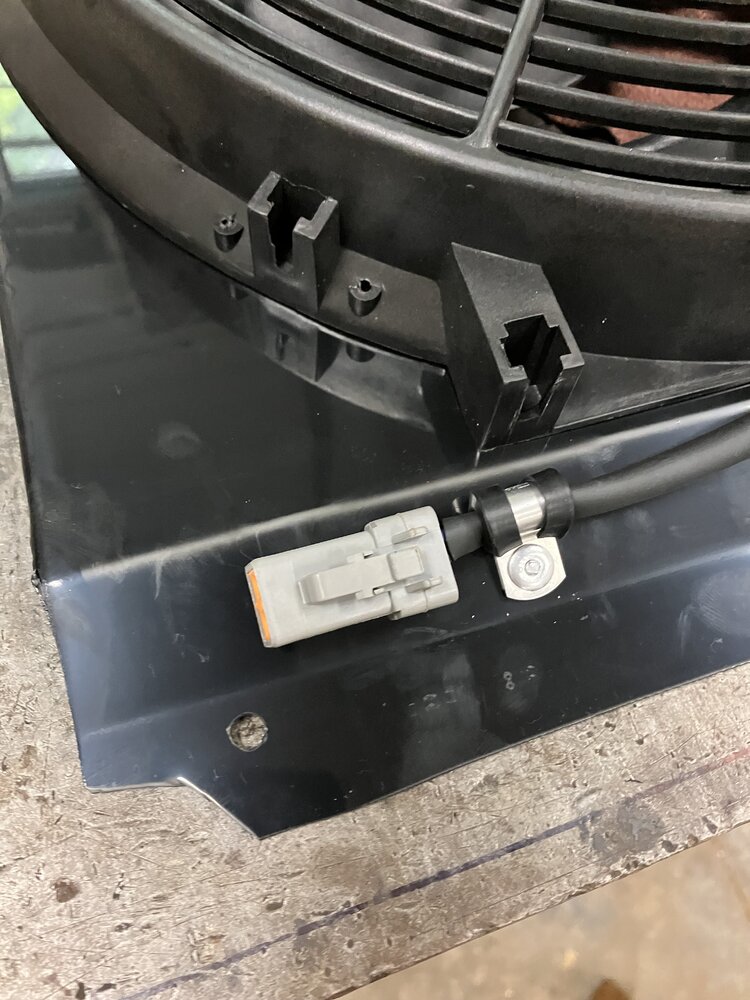

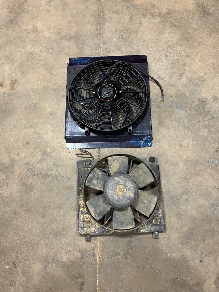

My old fan was one that was laying in the back of the geo engine donor I bought. No clue what it came from and it didn’t cover the whole radiator. It was too thick to run any sort of shroud. I fabbed a new shroud with some sheets of abs plastic. And got a thin 14in fan.
It’s clears the water pump by just enough to not be worried about it. I used some jumper wires to turn it on and it holds a sheet of paper flat against the grille with the fan running, so it has good air flow now.
I’m trying to improve my wiring skills, So it got wired in with a Dtp connector and the chassis side got some cloth loom.

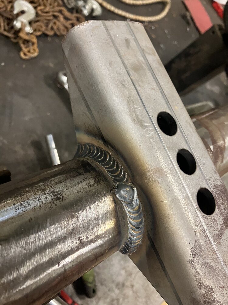

I cleaned the old brackets off the Dana 44 and welded on new spring perches and welded the axle tubes to the center section.

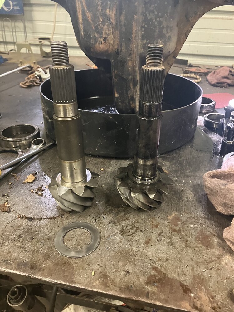

I’m working on getting the 5.13s installed. Revolution gear is having to send me ring gear bolts because the ones in the install kit were the wrong size.

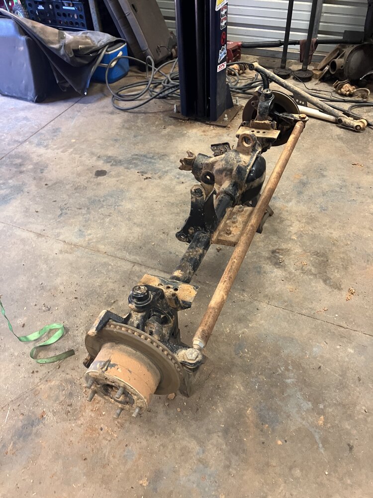

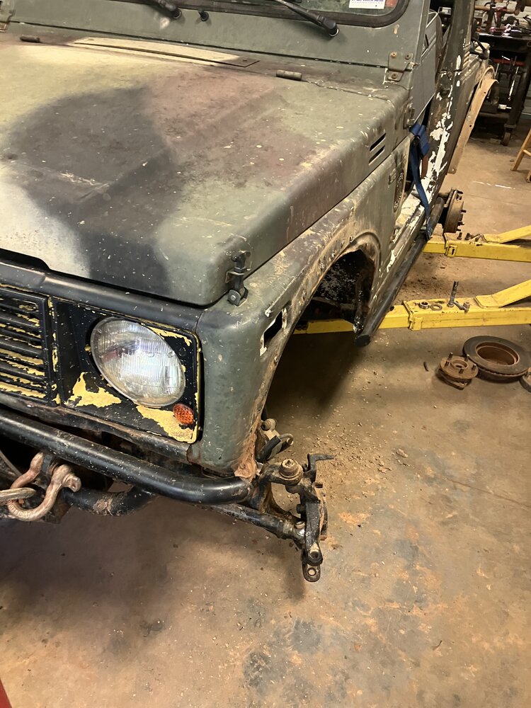

Dropped the Dana 30 out on the lift. I’m honestly surprised the welds holding the tie rod from moving never broke.

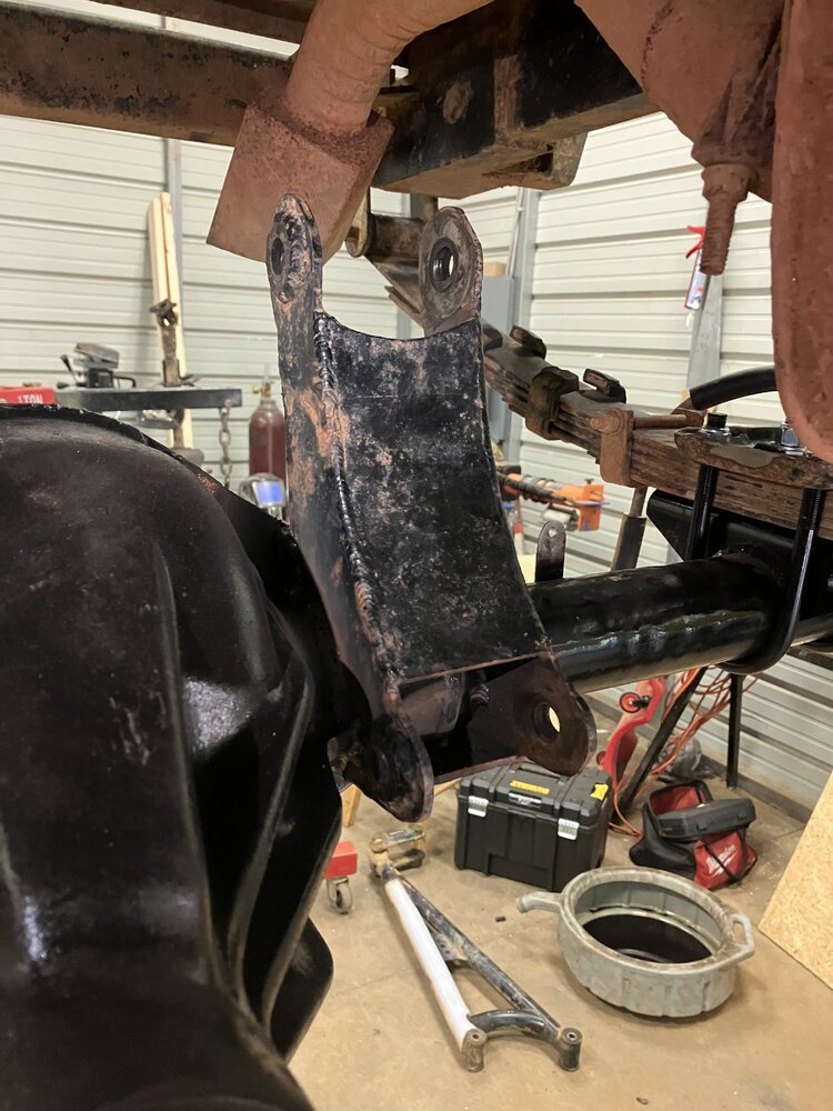

Once the Dana 44 was bolted to the leaf springs I could see that the traction bar mount was going to be up on the casting of the center section. I reused the traction bar mount from the old rear axle.

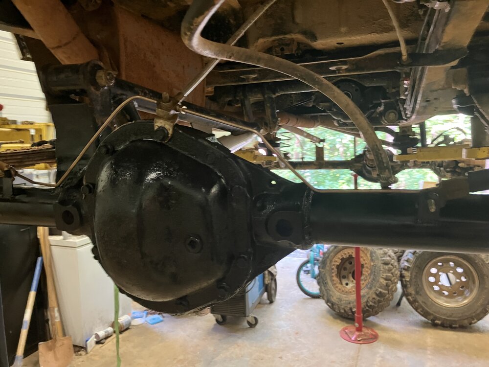

Made custom brake lines for the new axle. I used the hoses from the old setup. The they are tj front hoses at the caliper. The hose that drops to the axle is a rear hose for a lifted tj.

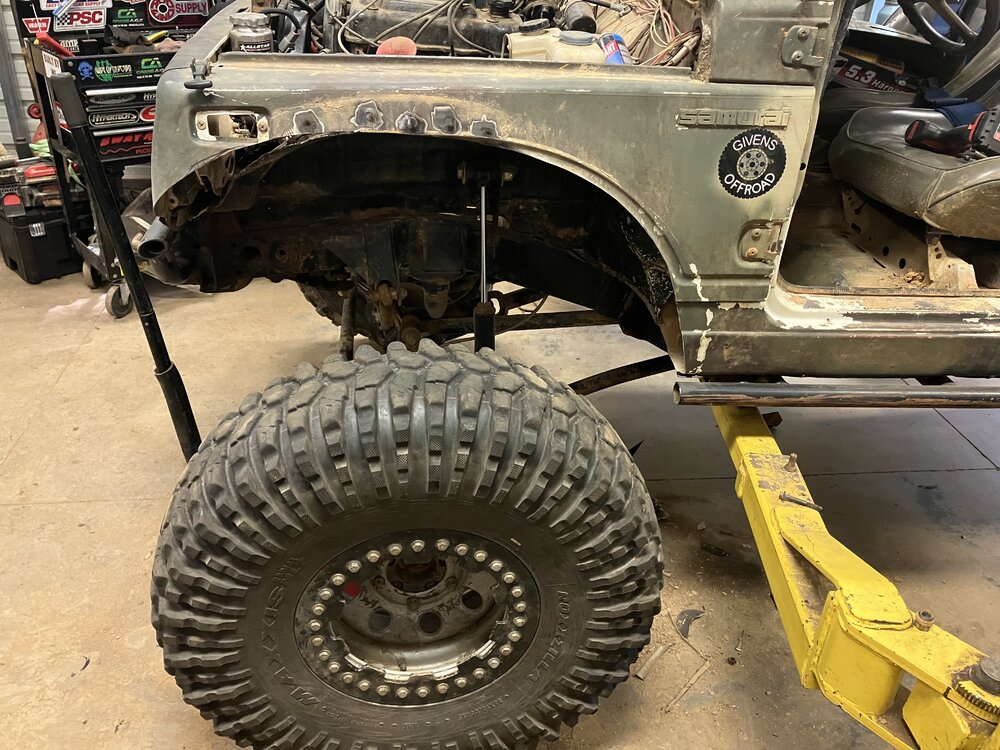

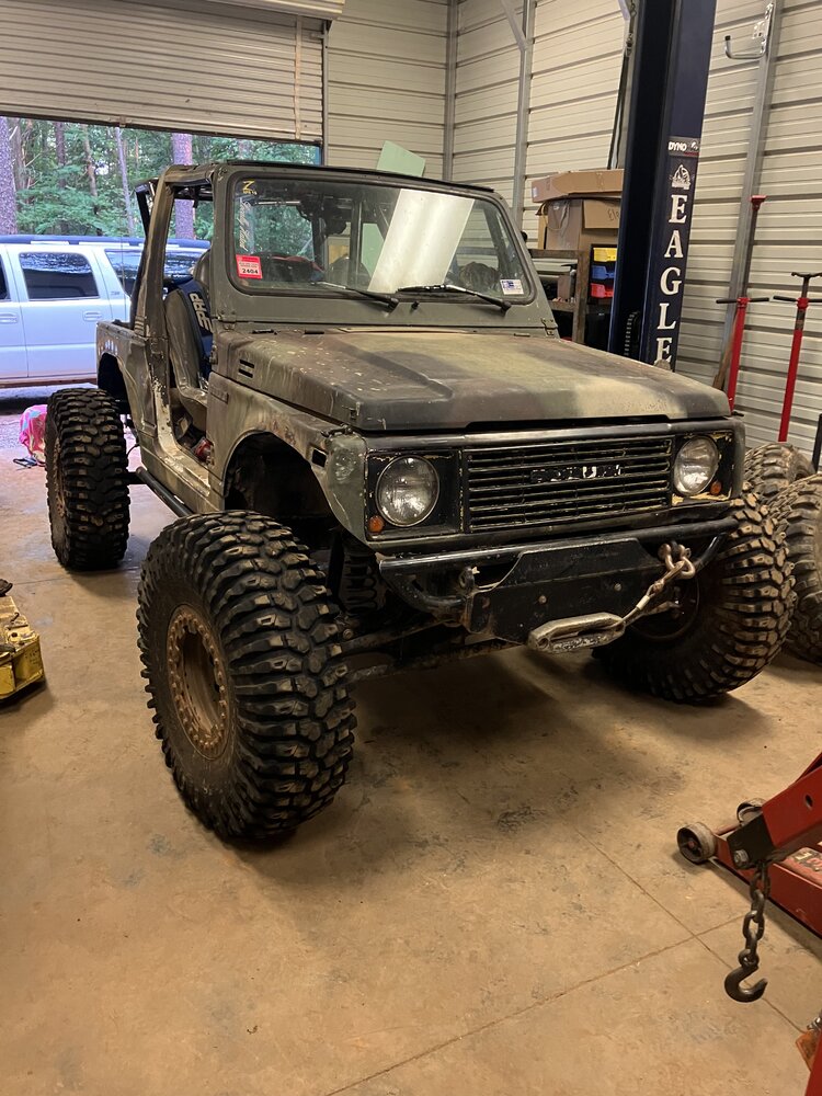

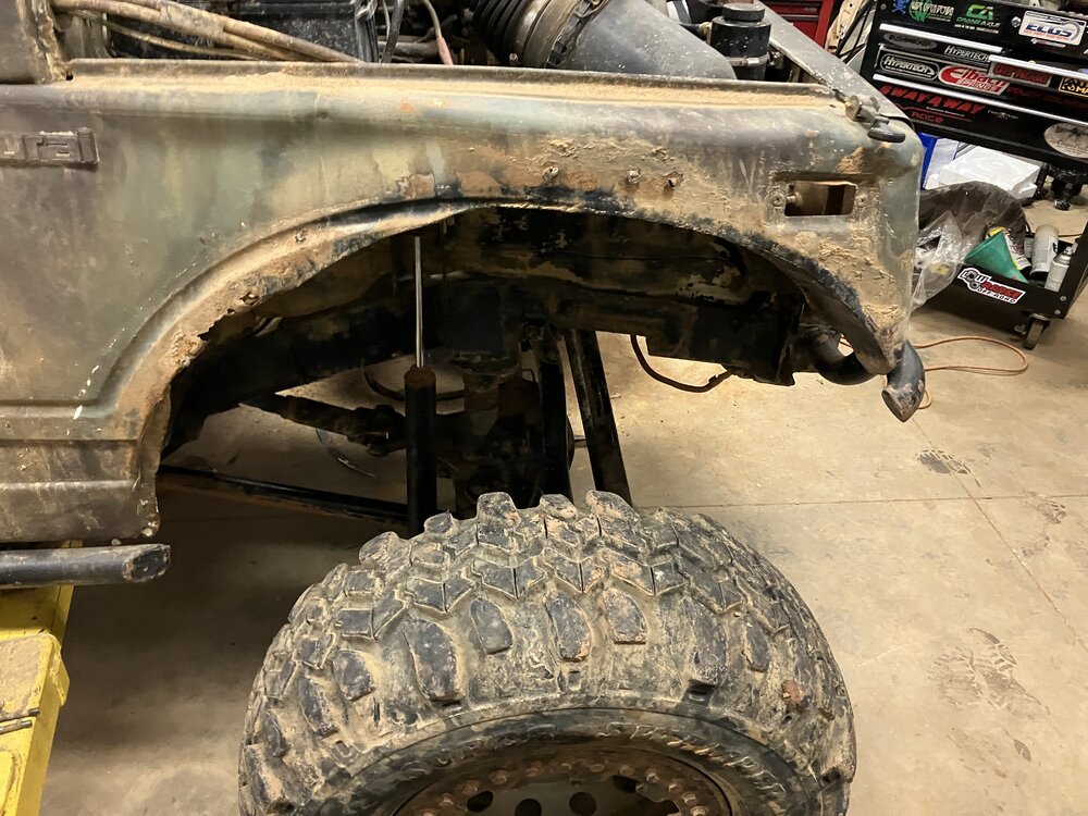

I got the front axle geared and started removing the fender flares. They were rubbing with the 31s. So no way they would clear the new tires.

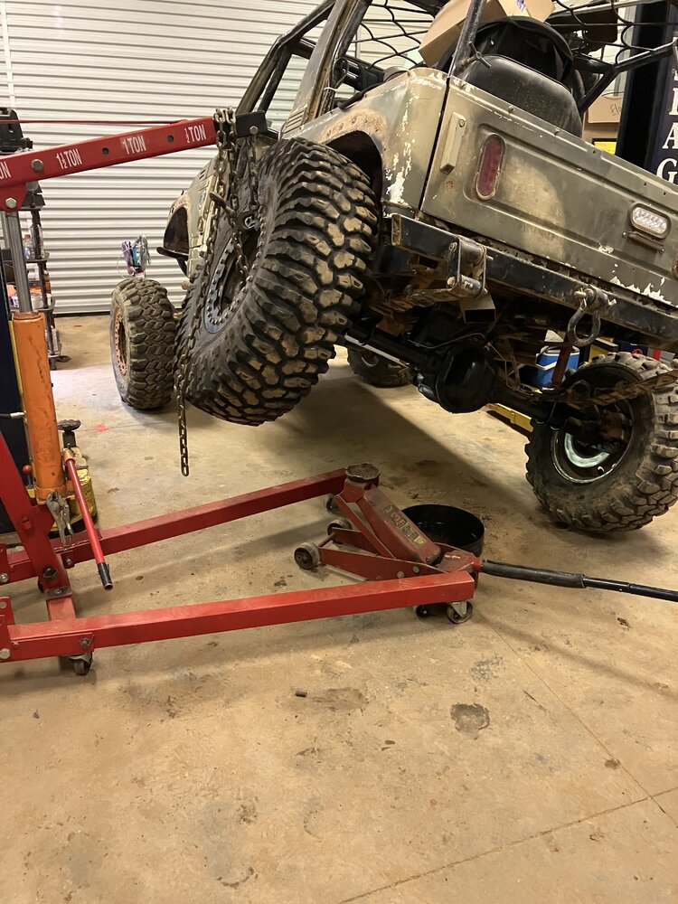

Flexed out on the engine hoist and found the rear was pretty close to clearing. Just some slight sheet metal trimming and it was good.
A before shot of the front fenders before trimming for the new tires.
And after. It stills rubs a little in the front but I don’t want to rework the front bumper more.

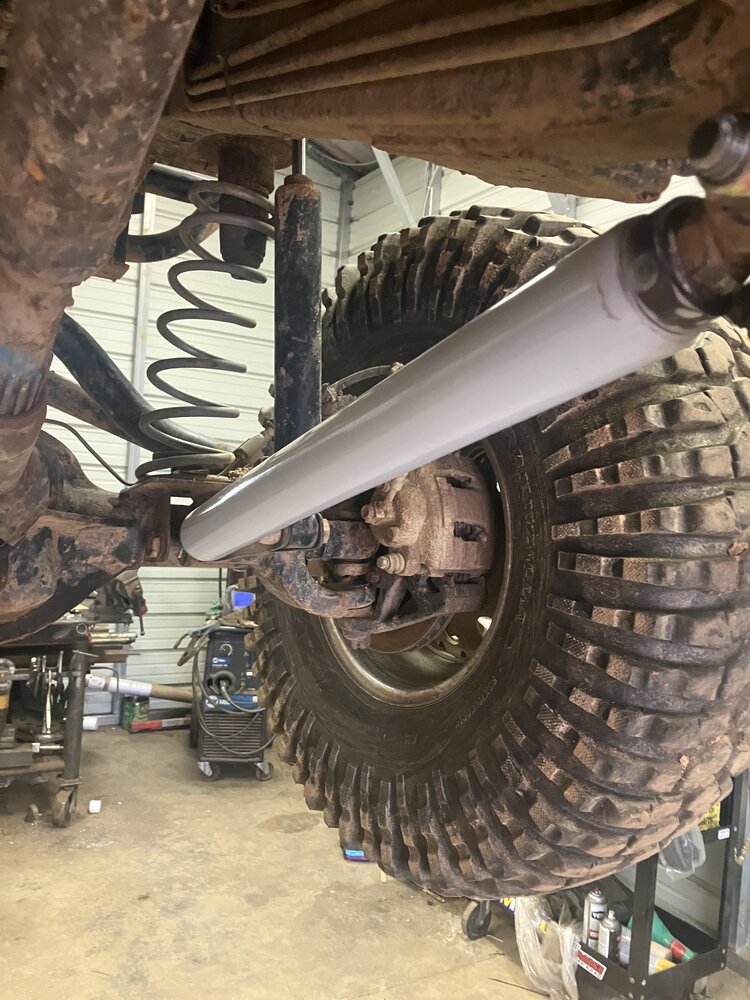

The uhmw pipe on the traction bar works so good I wanted to try it on my front lower links.

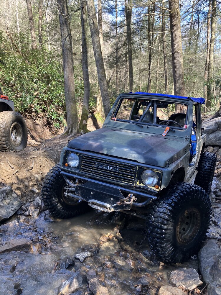

We went to ger in April and it was an awesome trip. I had the underdog rig since the group was mostly buggy’s.
I decided to try cripple creek the second day and made it without winching and only needed a spotter twice. These tires are magic lol. We ran all of the hard trails I know are there. It even walked can opener with no trouble. I had to winch there last year.
I did get stuck in the honey hole when I tried to bump it and got hung up on the rear leaf springs. Lost a bunch of transmission fluid out of the shifter.

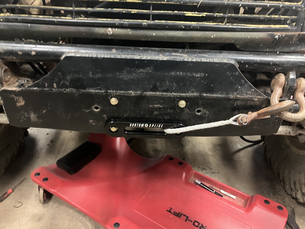

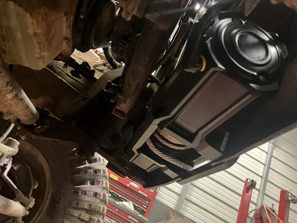

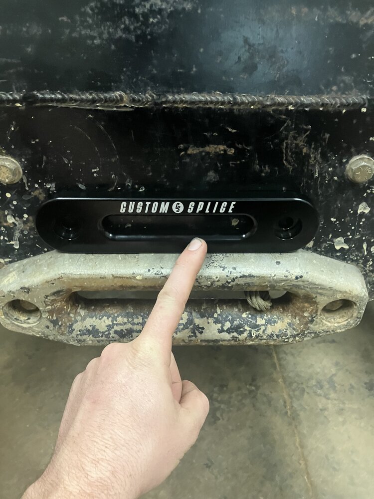

Twice I tried to use my winch at the ranch and it didn’t work when I was pointing uphill for some reason. The rough country 6500 side by side winch has been on my radar for a while as an upgrade/weight savings, so I ordered one when we got back.
It fits in front of the radiator where my old Ramsey 8000 was under the radiator.
Synthetic rope and wireless remote are a big upgrade too!

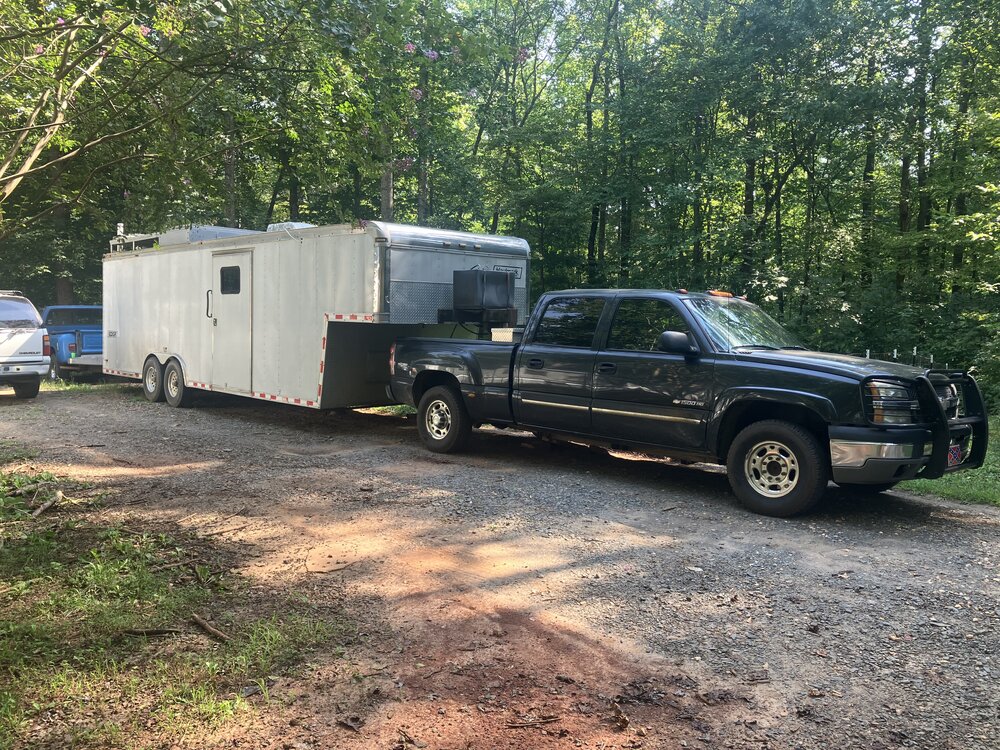

I had been looking at market place knowing I was going to wrap up my hitch installation. I found this enclosed and went to check it out.

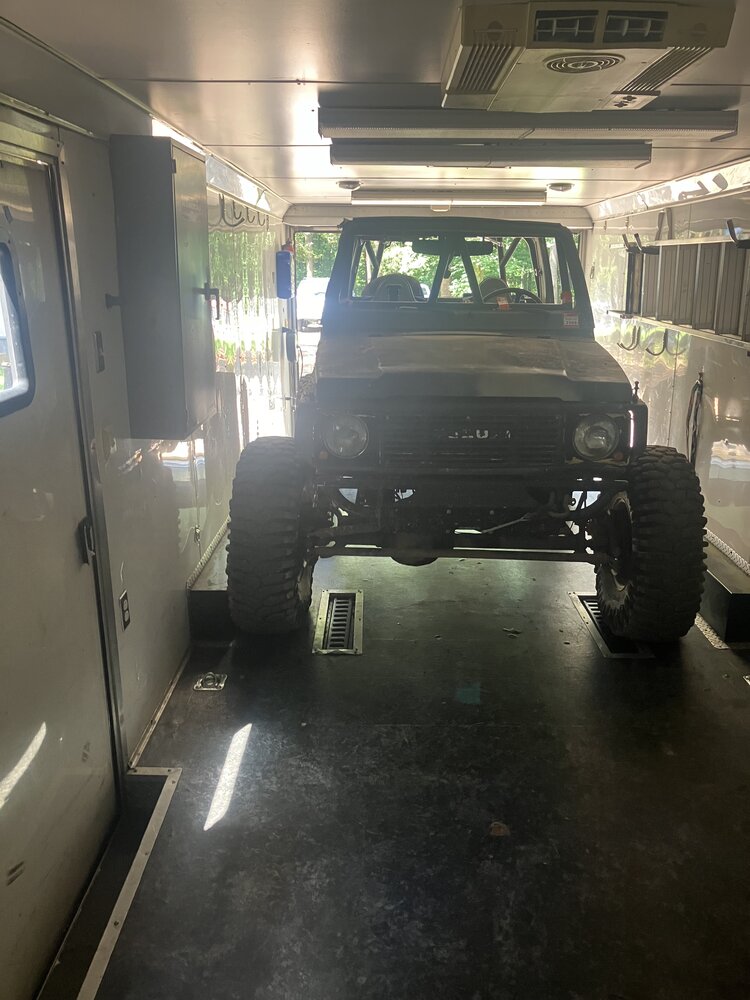

It should fit our needs pretty good. It has rooftop ac with a heat strip, it’s wired with some outlets. Since someone who raced circle track owned it before, it has an observation platform with fold up railings too. It hasn’t run in almost 10 years, but it has a onan 4000 generator in the front storage compartment.
I test fit the samurai and there is plenty of room.
We are going to add a sink/small water heater and a mini fridge

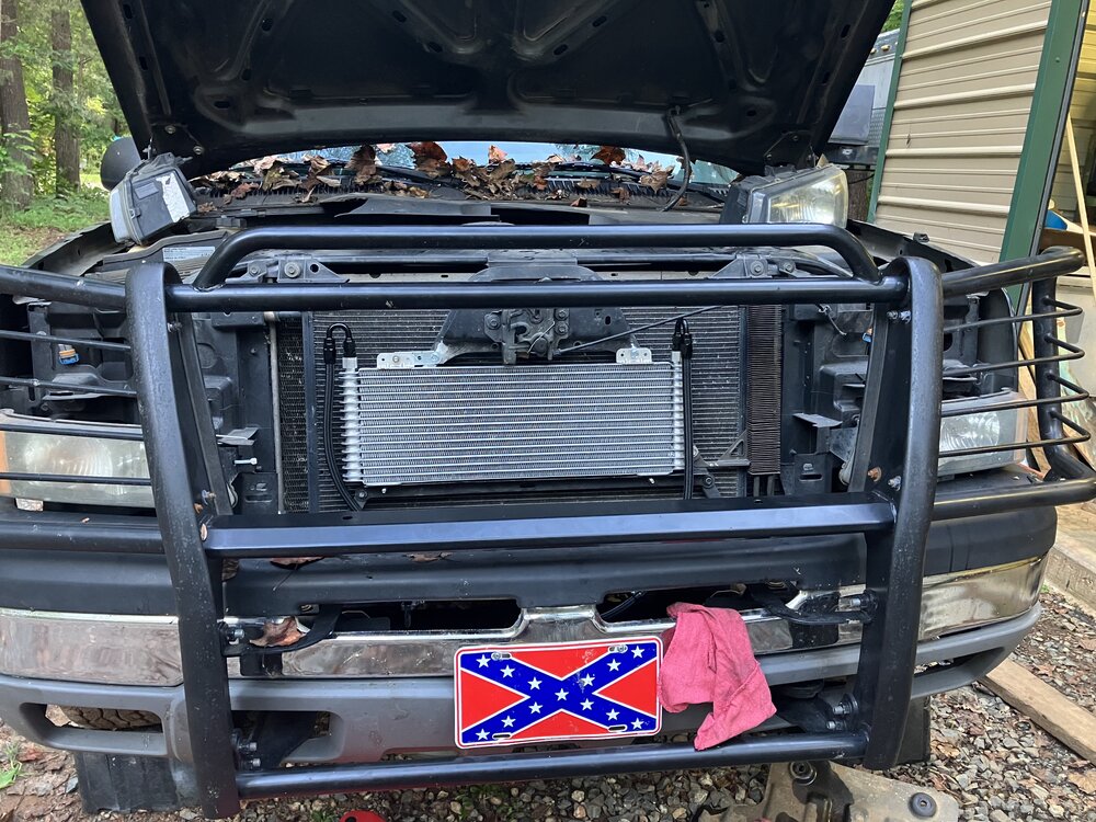

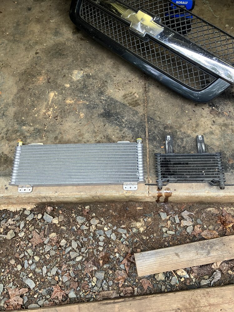

I had wanted to upgrade the quadrasteer transmission cooler already because sometimes it will get warm pulling a grade in 3rd gear since the converter is unlocked. My research lead me to the tru-cool 40k
Plumbed it in with more an hose. I had done some of these already to delete the factory rubber transmission lines that were leaking.

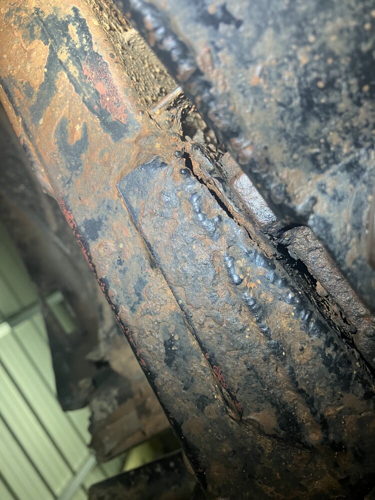

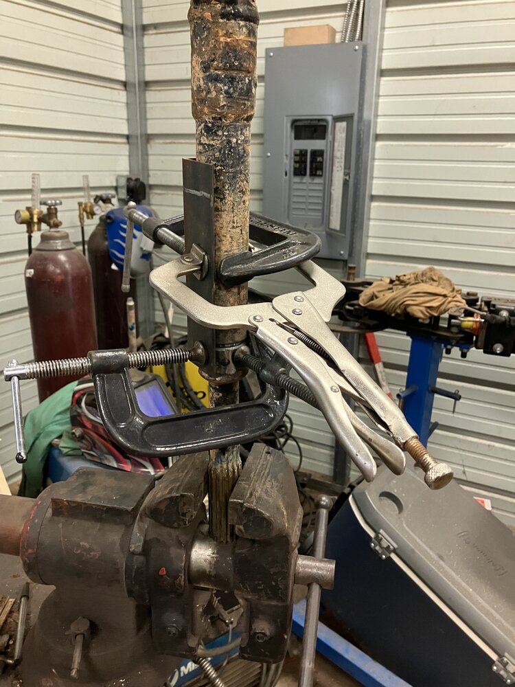

I was checking over the samurai because I wanted to make a run to uwharrie on Veterans Day and found the steering box mount cracked and the frame near it cracked. It’s taken a lot of abuse since I don’t have hydro assist.
I’ve had this on the shelf for a couple months but haven’t bought an orbital or a Clevis kit yet. So I’m going to groove out the cracks and weld it, to make it too the gtg ride hopefully.

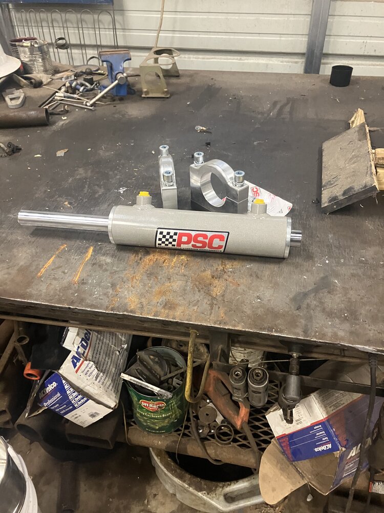

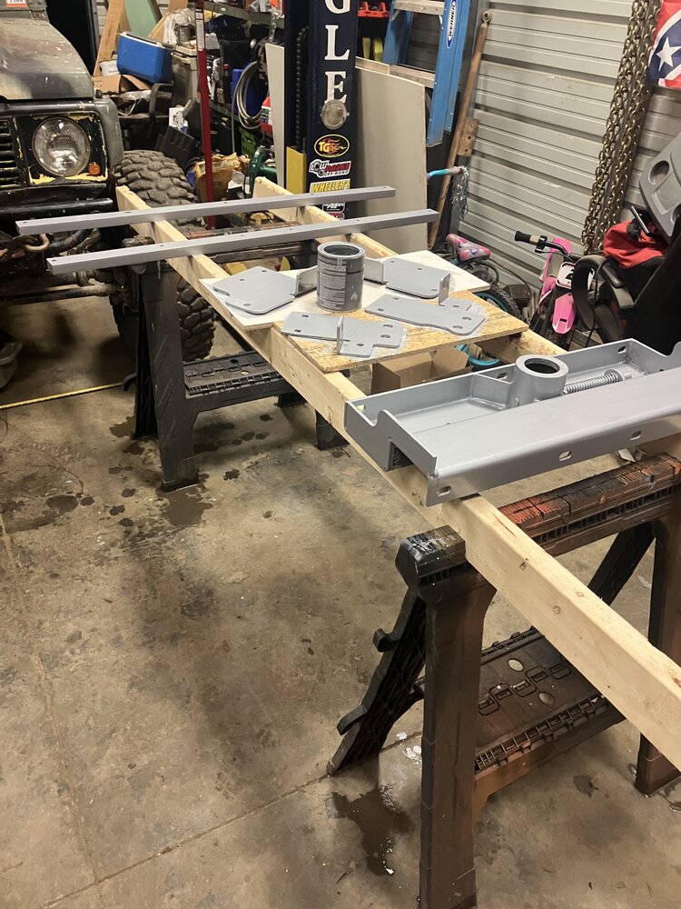

I have been working on converting the Sami to full hydraulic steering finally.
I wanted minimalist mounting with the best tie rod angles and ground clearance.
Braced the back up to take some side to side forces, before I capped the top.
The cylinder clears everything at full bump
It spans from the center section to the upper link mount so it’s locked in side to side.
