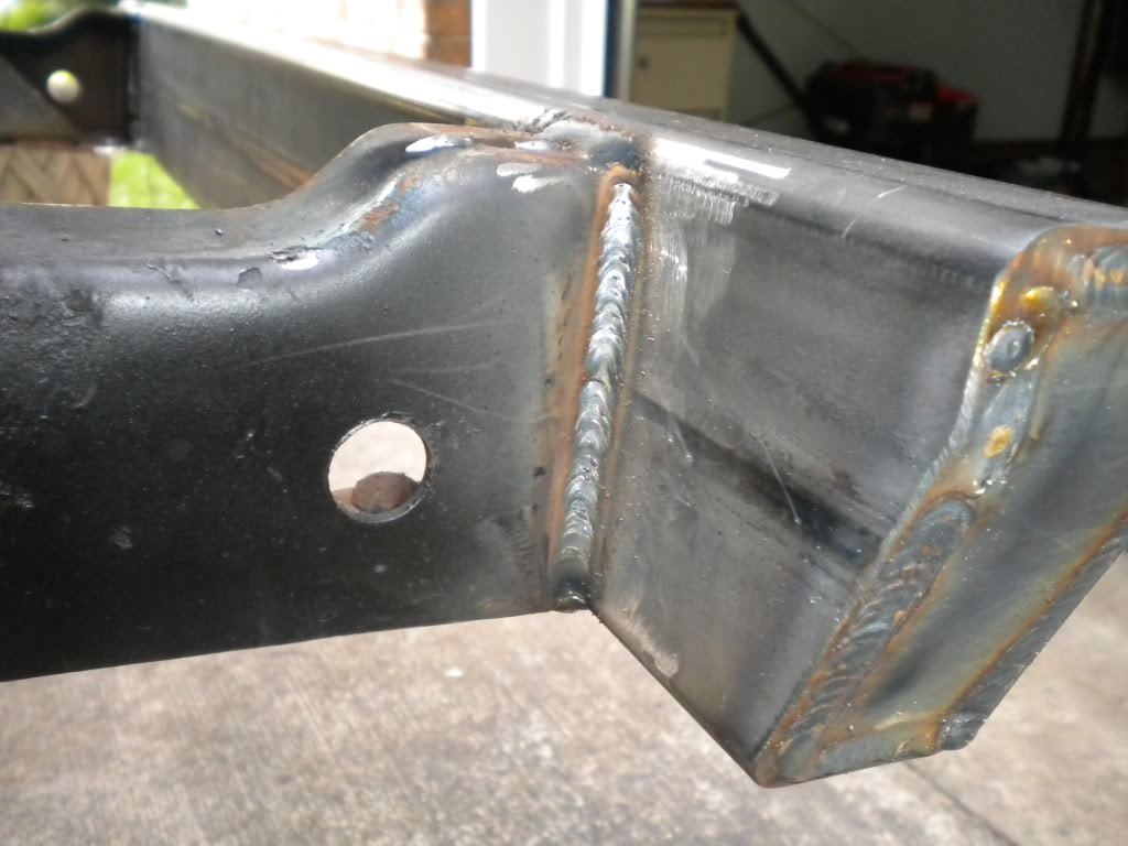

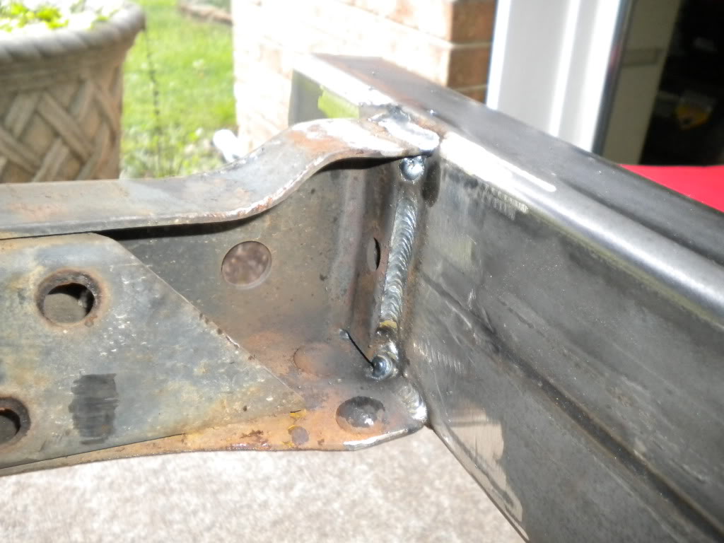

i plan on stretching the front about 10". i'll start on it this week hopefully. the shackles will angle back a little more. i sat in it (~200lb) and it got to about the angle i wanted. it should be just right when i get the fuel cell and body armor on it.
Those welds are lookin good man. I look forward to seeing how this thing turns out.
man coming from your work that is a huge compliment!

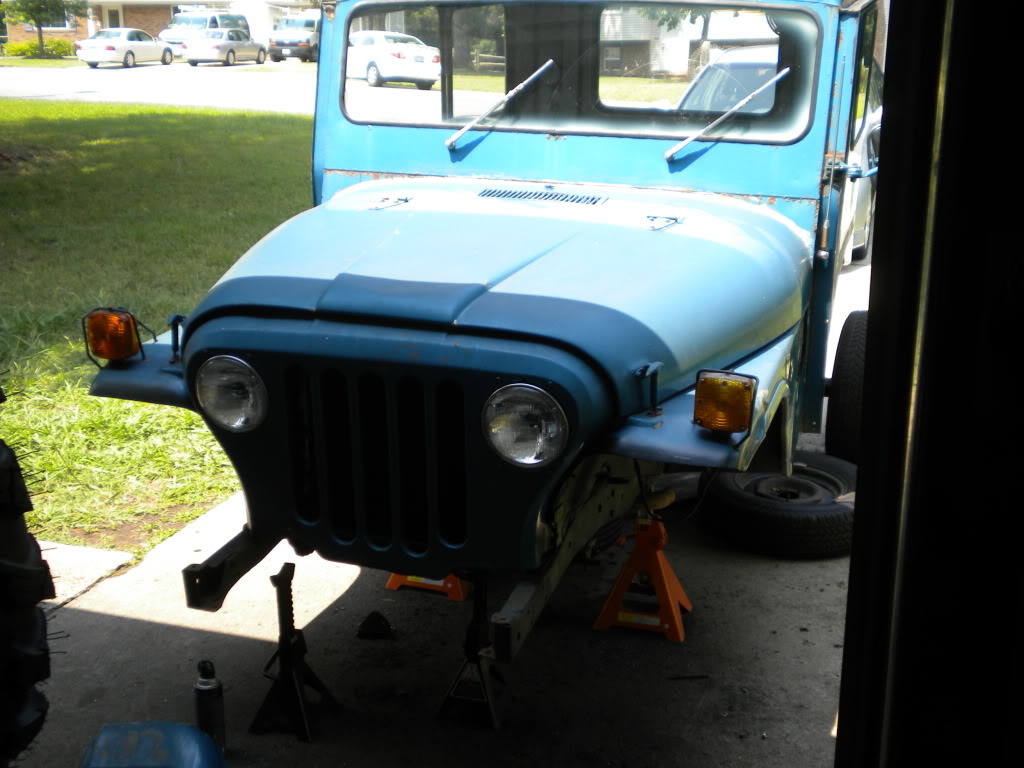

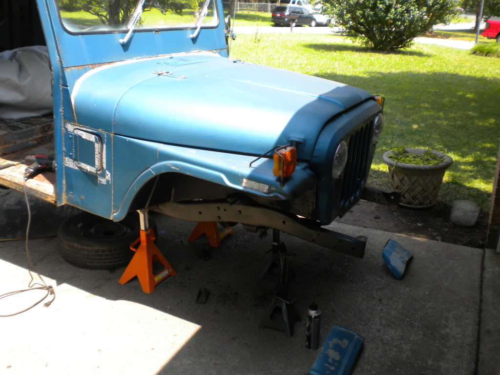

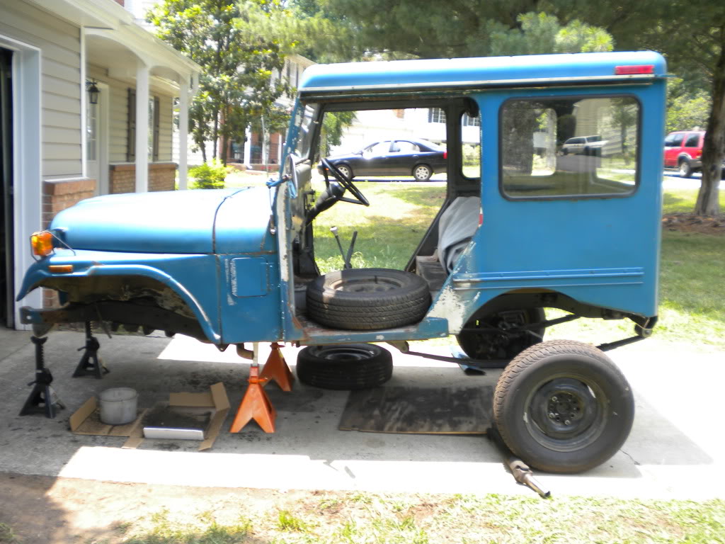

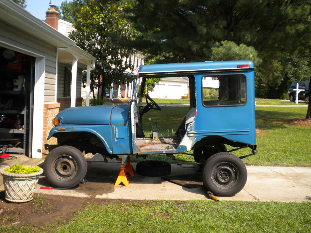

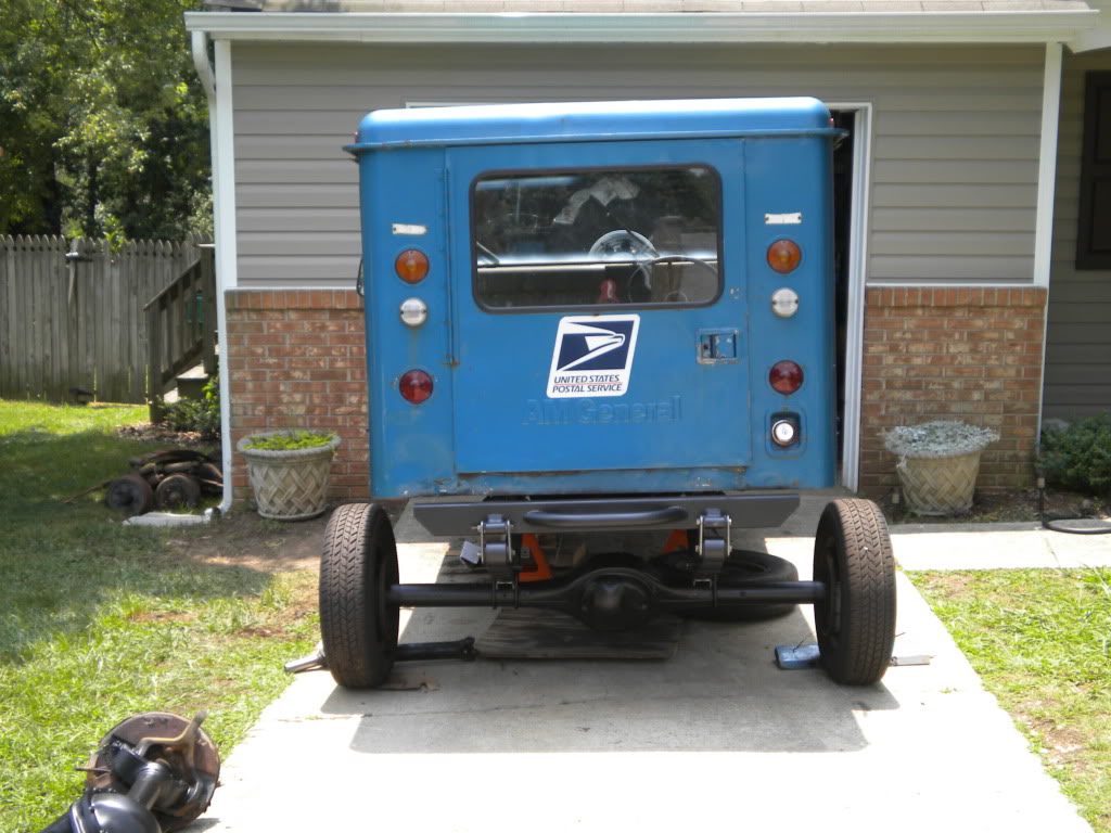

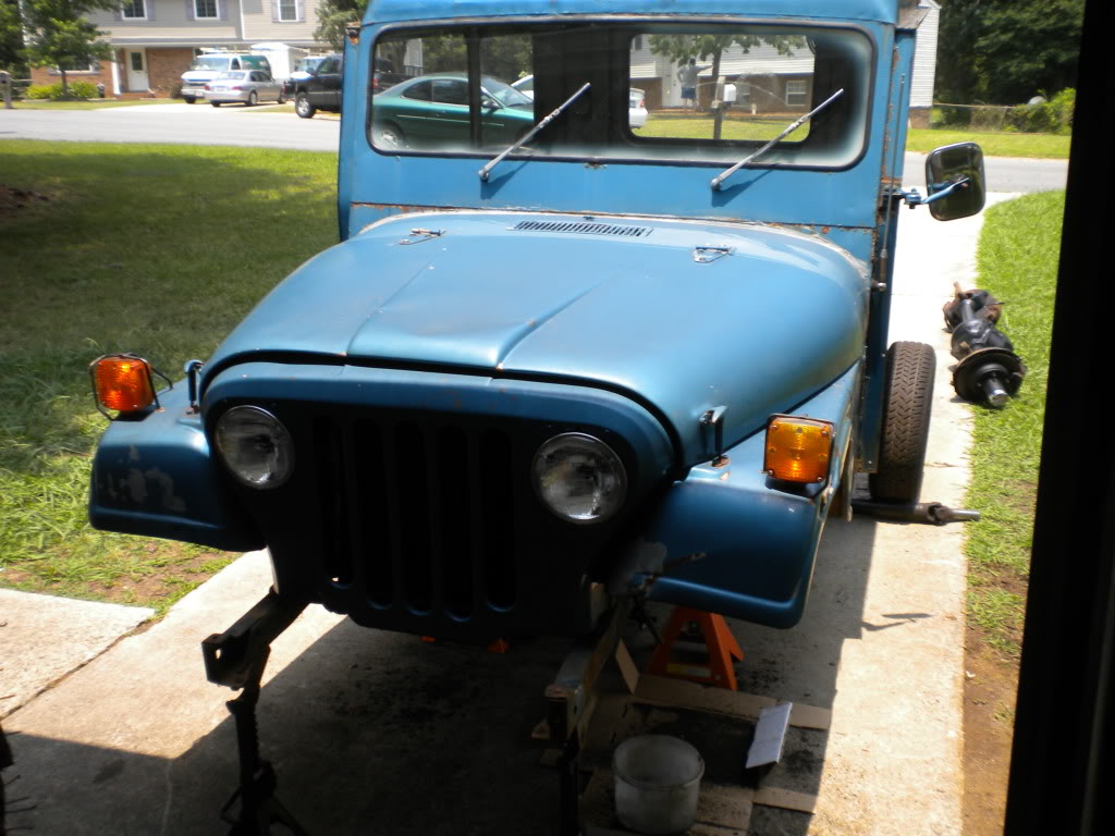

got a bit more done today. turned the jeep around in my driveway and then got all the old front axle parts torn off.
the front end lost some weight! :)

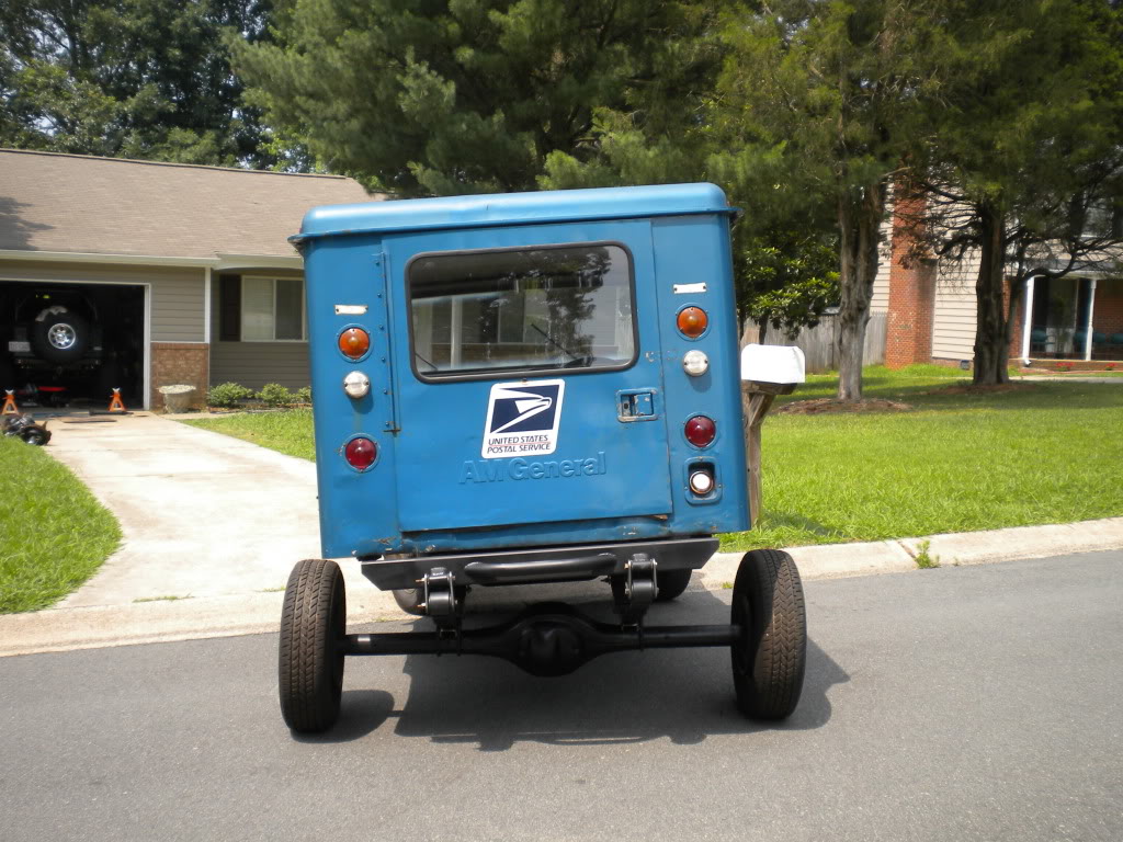

another one of the back.
Looking forward to seeing this end result; it's always been in the back of my mind to build a DJ. Any ideas about what the final rear fender cut will look like?
me too! i can't wait to get it rolling again. i want to see it with some tires on it. i'm planning on cutting the fenders in a half circle that starts where the factor location is and wraps around to where the rear bumper ends. i'll mount the 37s i have on my yj to get the tire location for my cuts. i'll do that in a week or two.

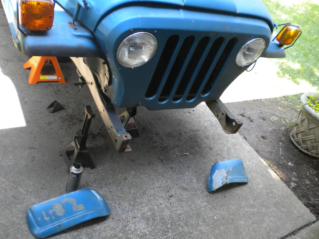

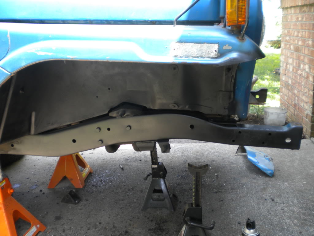

i got the front suspension mounts cut off and made some flat fenders...kinda.
i'll cut a little more out of the fenders when i add the DOM to them.
i wirebrushed the frame and inner fenderwells in the front and rear and added a little spray bomb to them.

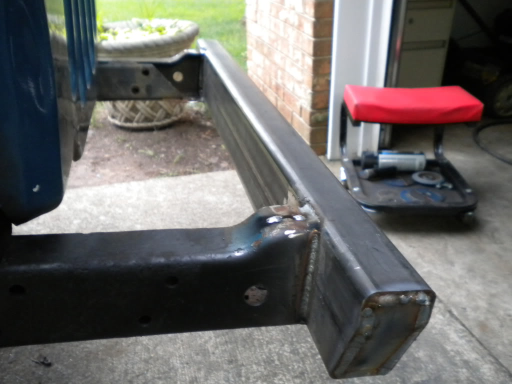

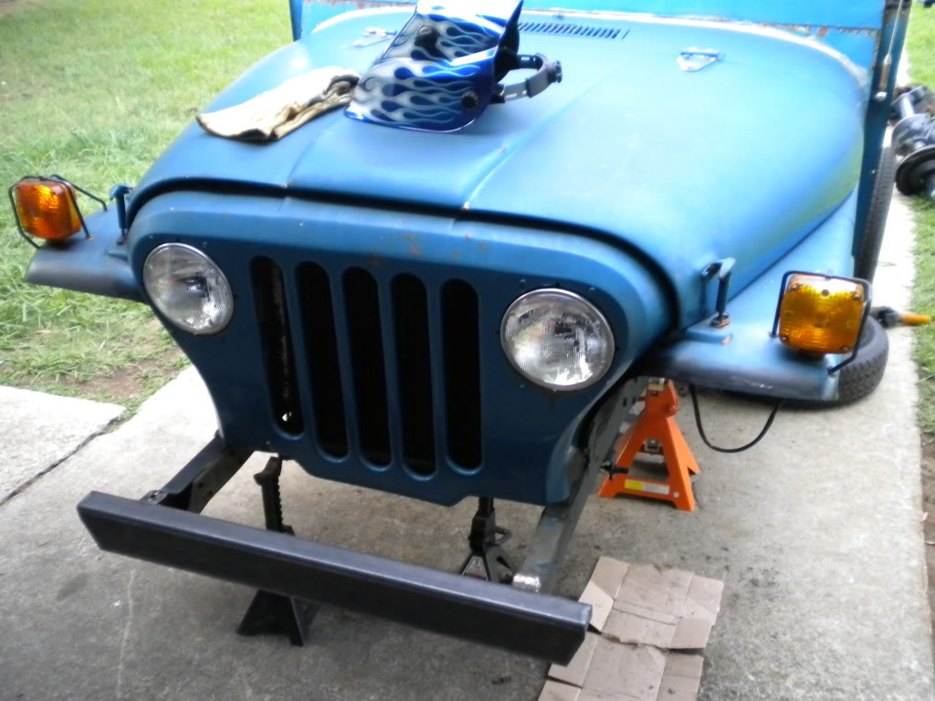

i got the base of the front bumper welded up tonight. i also picked up some DOM to bend up a grill hoop this week. i am still going to add some bracing from the sides of the bumper down the frame rails but it's a good start.

on to the pics.
up close.
another. i did grind the bumper endcaps after i snap'd these pics.
i like it a lot man, always wanted to do something like that
