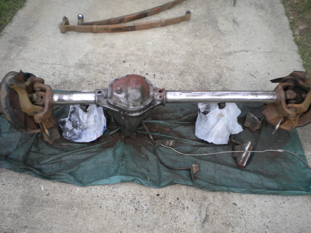

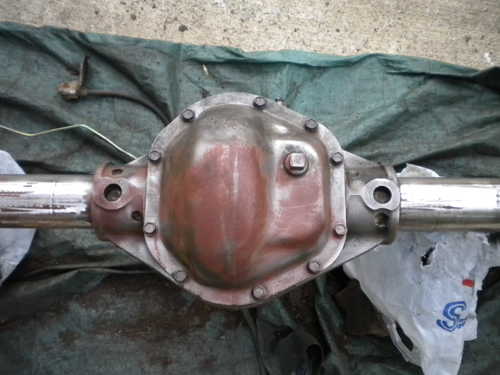

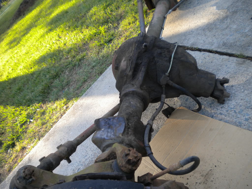

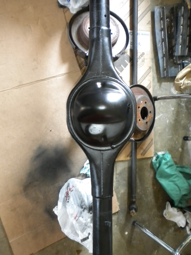

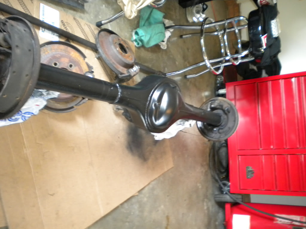

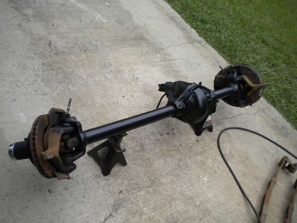

ok guys. so i haven't been slacking. i've been working on a buddy's tj. i'm doing the finishing touches on the suspension, shock mounts, brakes / lines, etc. that being said i haven't gotten much done on my mail jeep. i did pick up some ubolts and plates and some XJ leaf springs from pullapart on saturday. i got them sandblasted, painted and ready to go in. i also got the 9" sanded smooth and painted. pics are below.

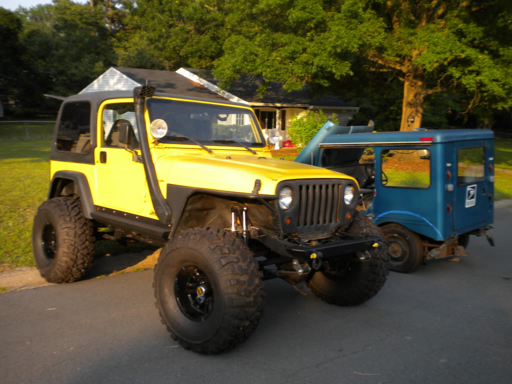

my mail jeep, my yj i just finished and my buddy's yellow tj i'm working on.

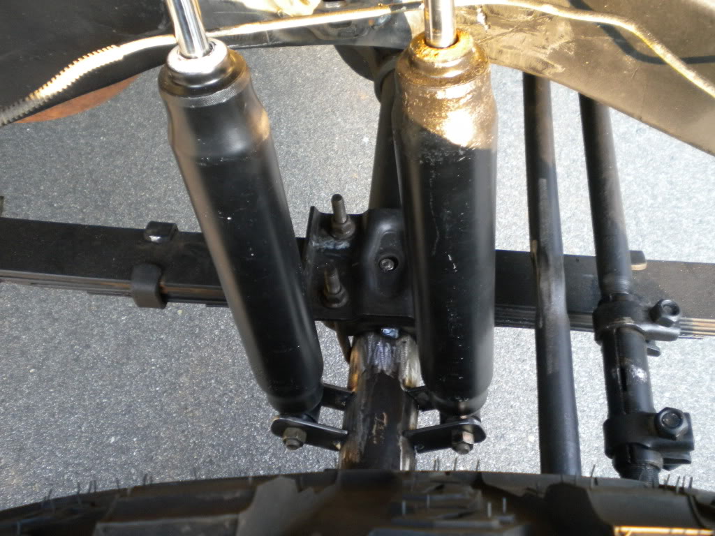

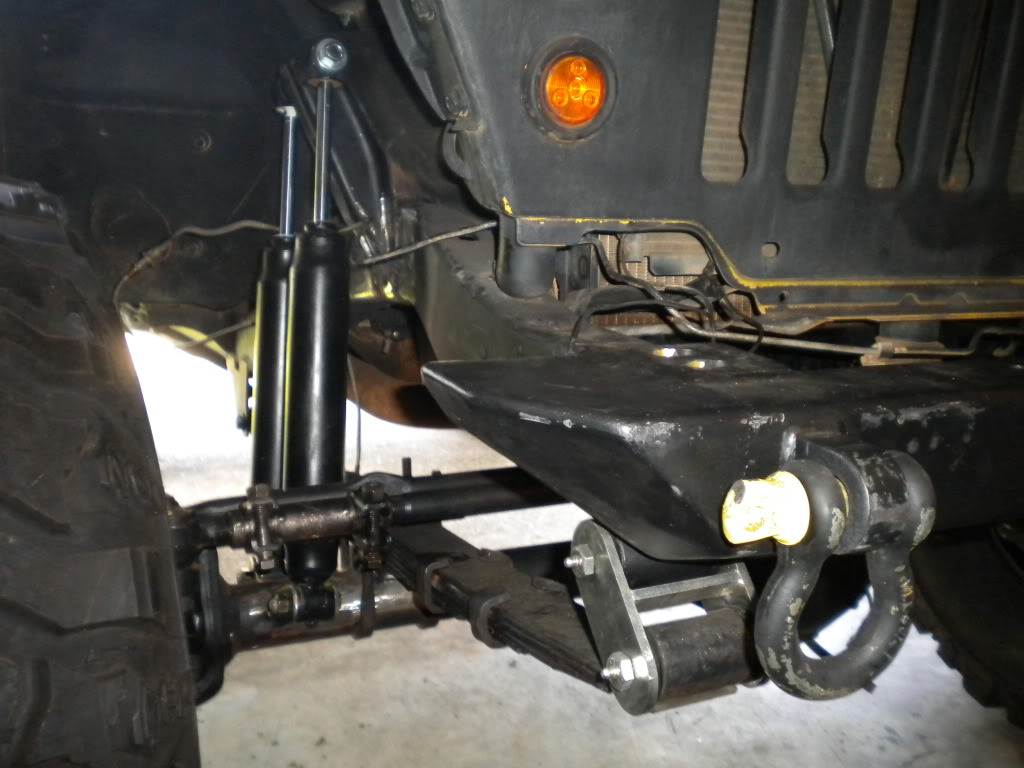

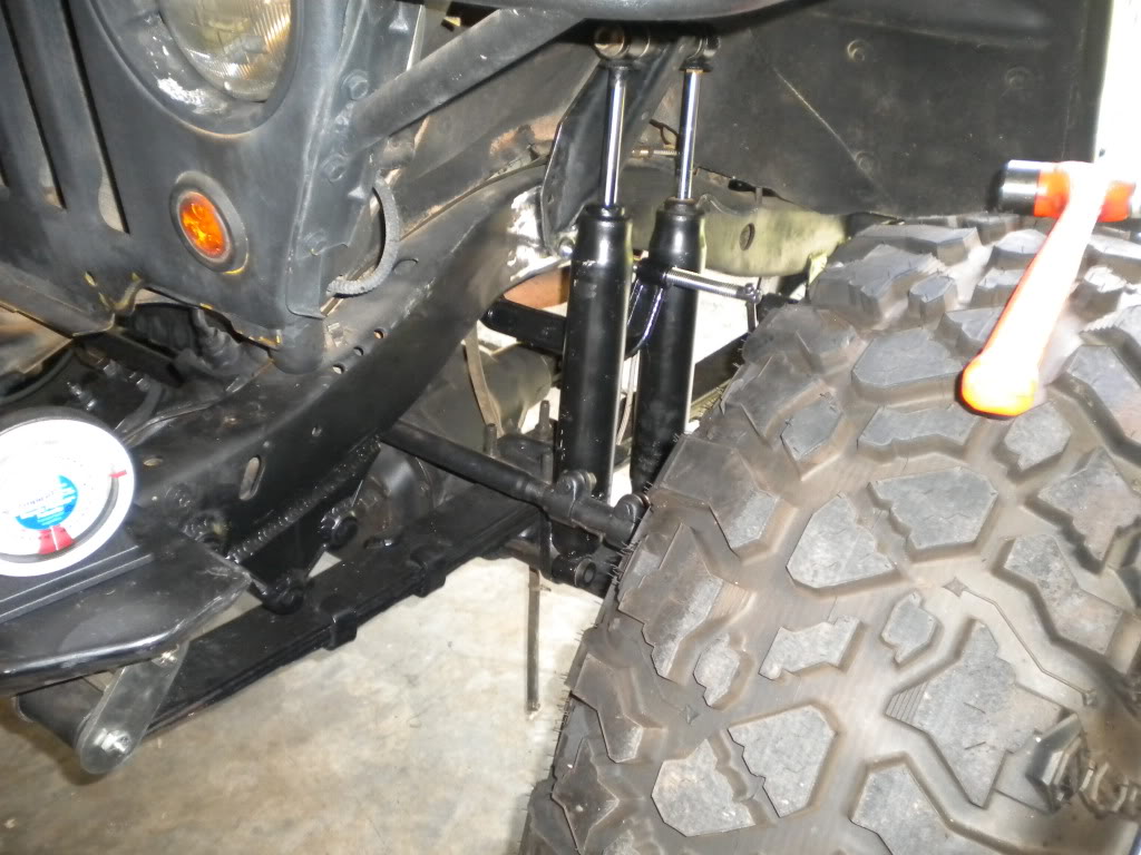

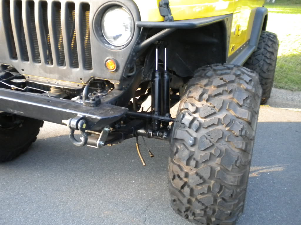

i built some dual shock mounts for his tj. yes his tj has leafs front & rear. :) it's a long story but it works and it is a super nice setup now.
couple more.
i made all of the shock tabs. the outer tabs are longer so the shocks can sit at an angle without binding.

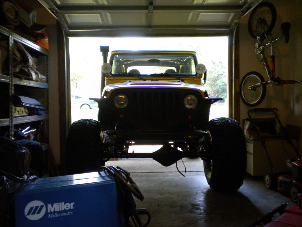

my mail jeep looks TINY next to the tj with 37s. soon it will grow up too. haha.

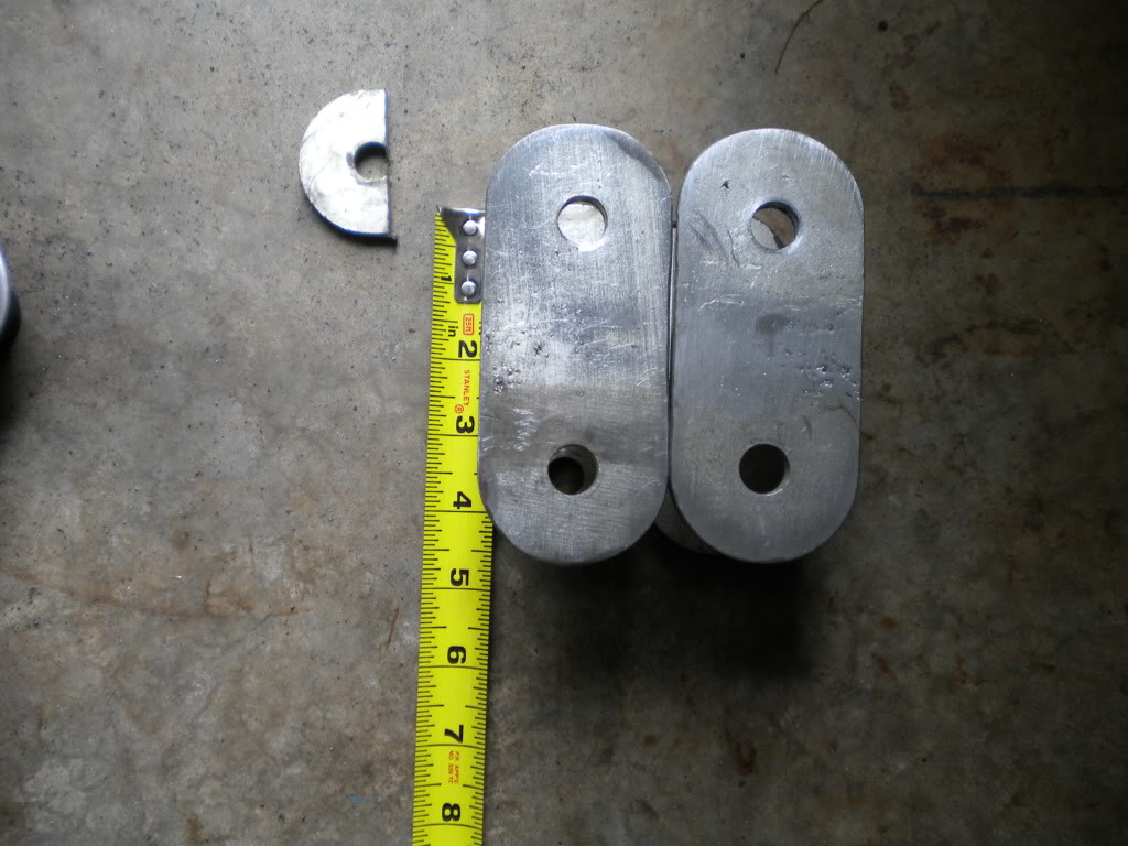

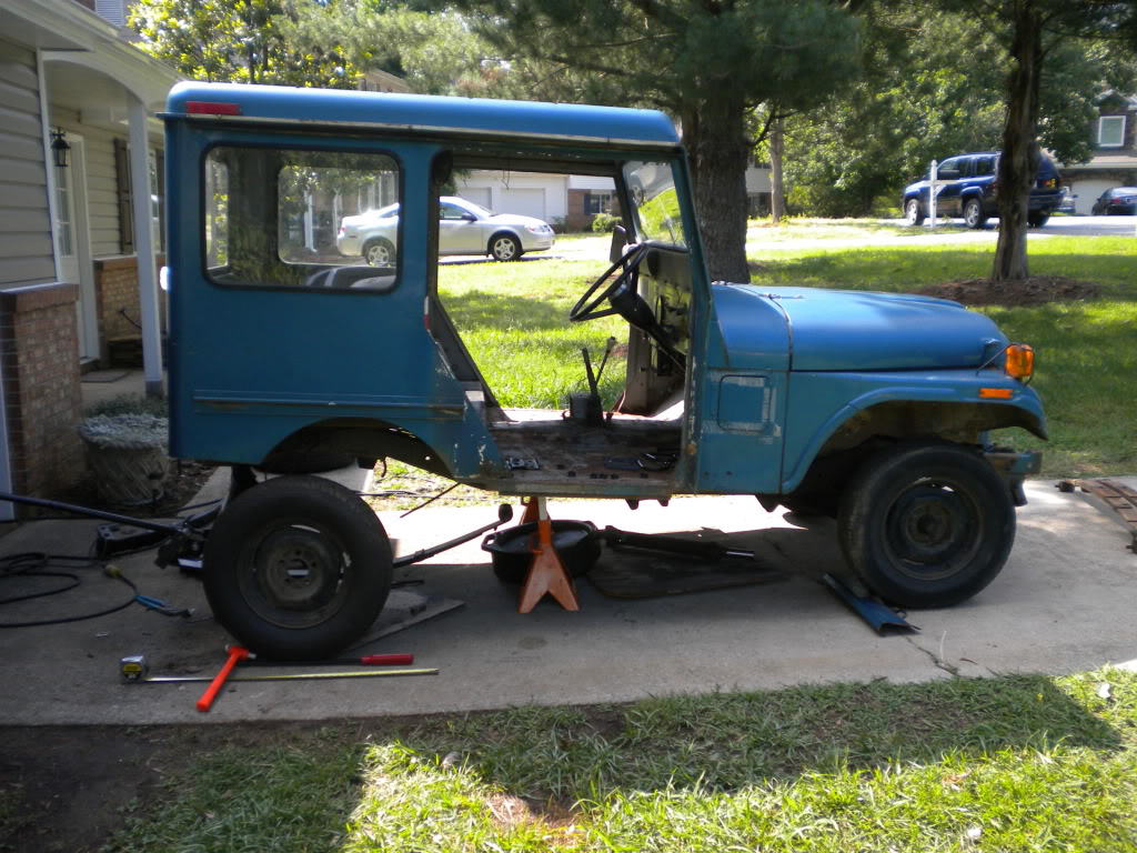

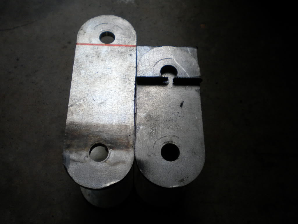

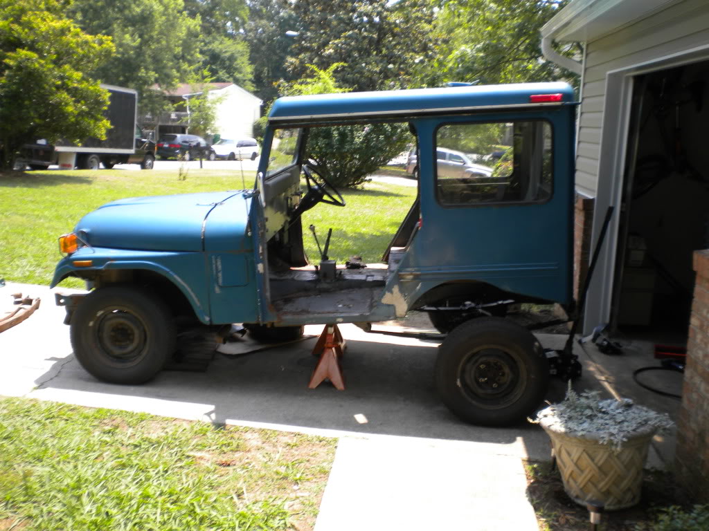

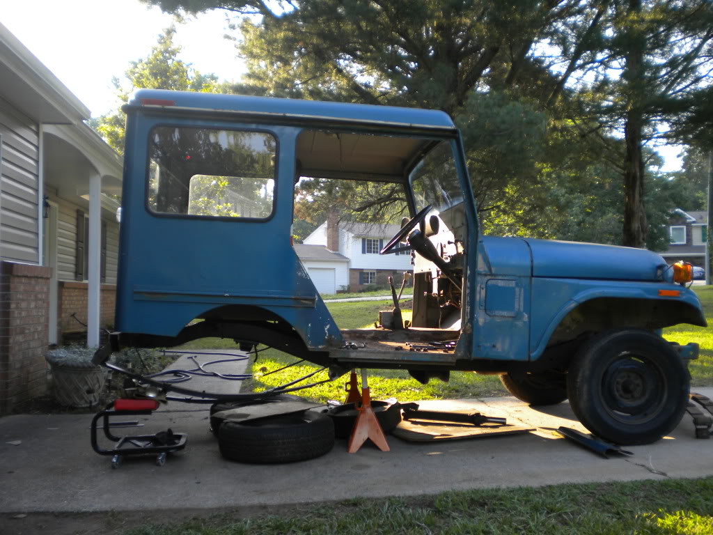

so i got busy this weekend. i cut down some daystar shackles i had laying around. i'll be running them up front. i also removed the rear axle, cut off the old suspension frame mounts, and started mocking up the xj leafs for the rear stretch.
just goofing off!

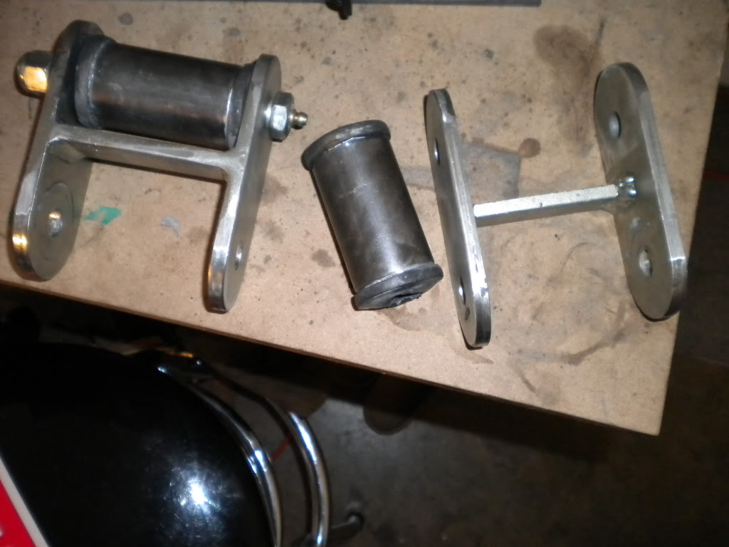

i also made some dom tube poly bushings for the front & rear shackle hangers.

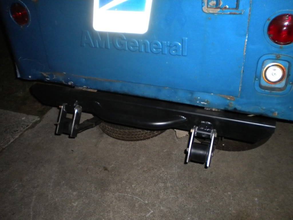

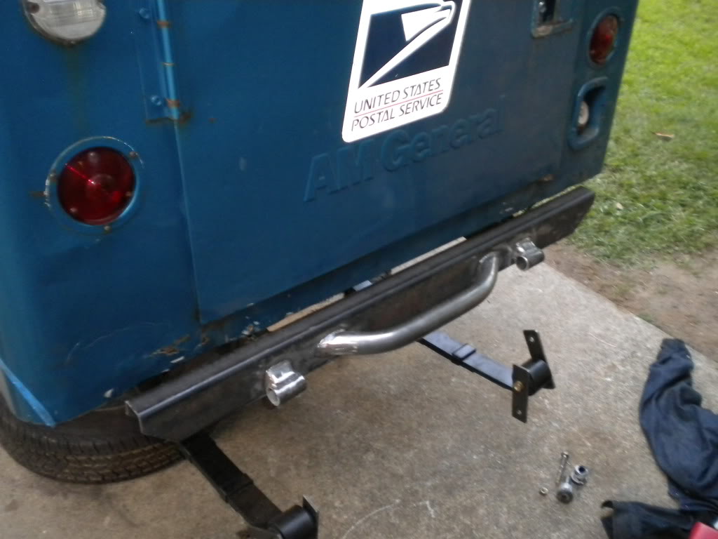

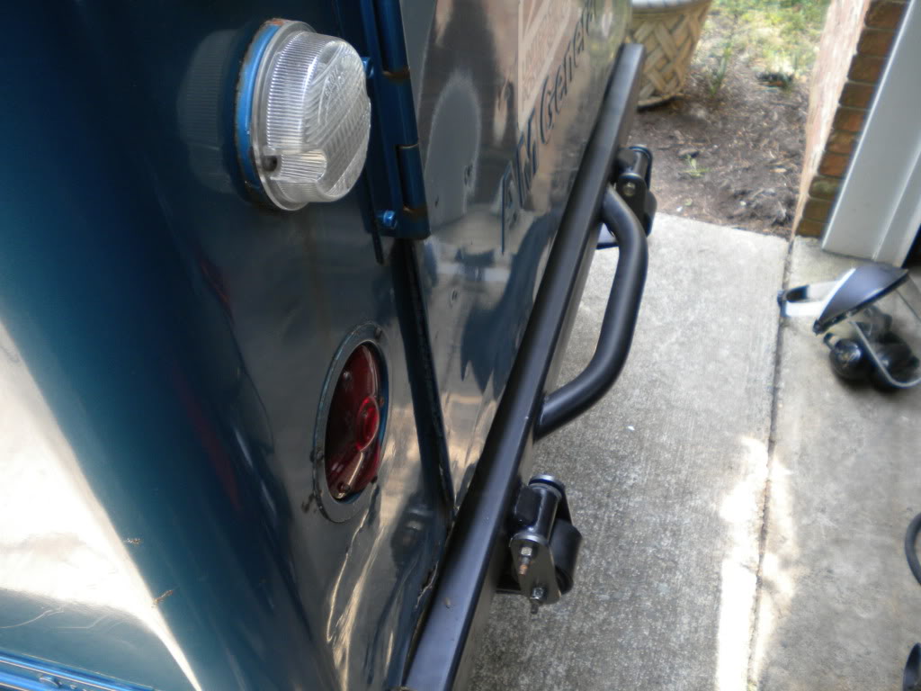

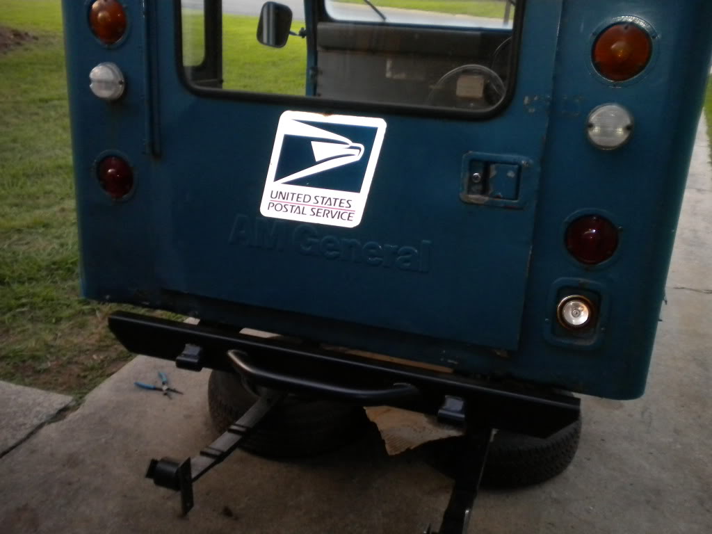

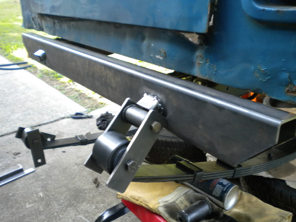

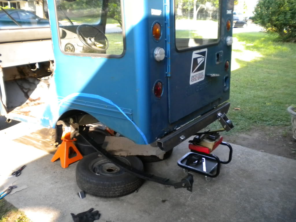

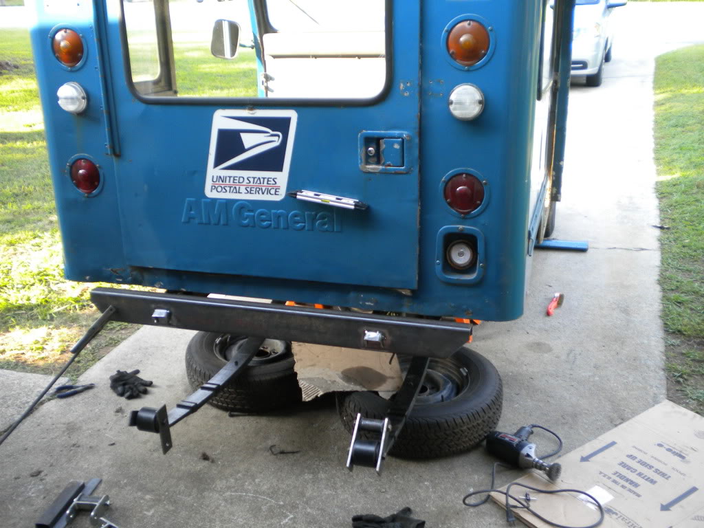

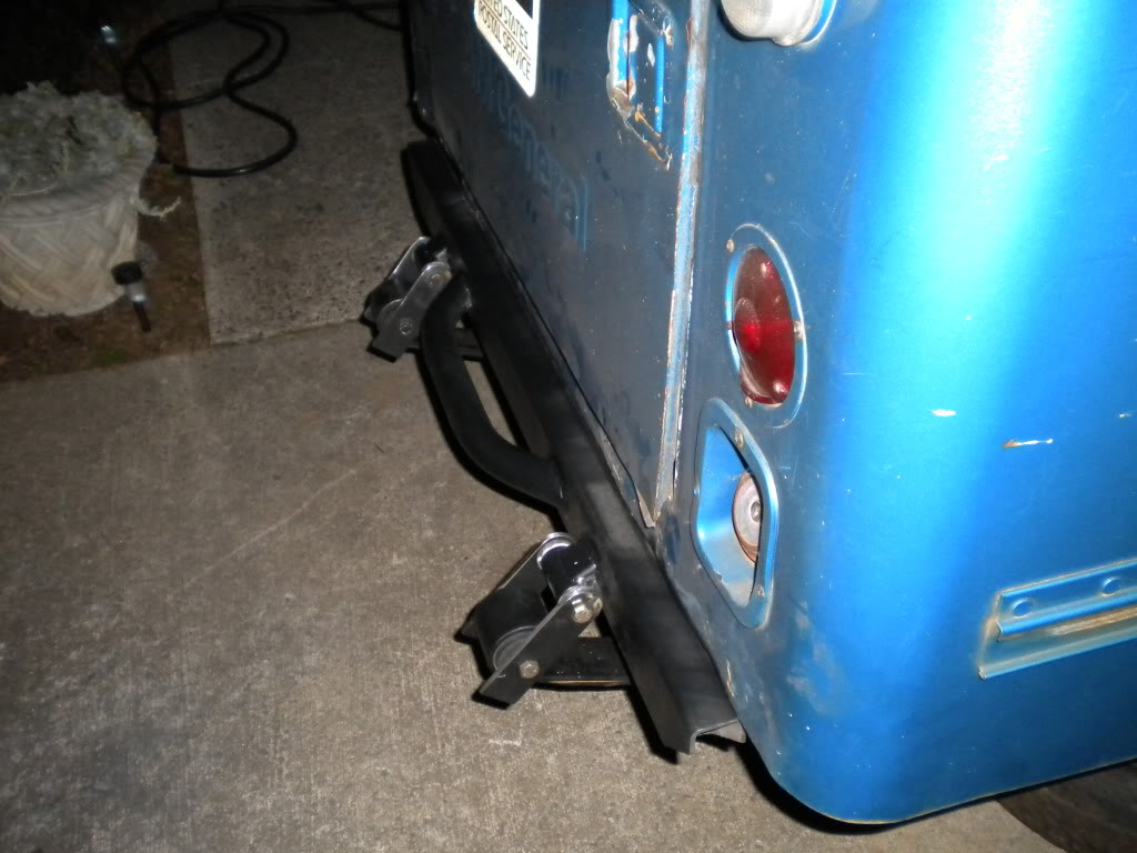

i got the rear bumper cut and tacked. i also made some shackle mounts for the rear bumper.
rear stretch.
i'll be rounding the shackles out much more than they are now. i just wanted to throw them in so i could get an idea of the length.

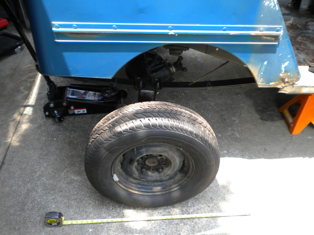

i put a tape measure of what the original wheelbase was for the rear. the tape measure is the new wheelbase. I'll be gaining about 9" in the rear. I'll add another 8-9" in the front. the wheelbase should be 98-100" overall.

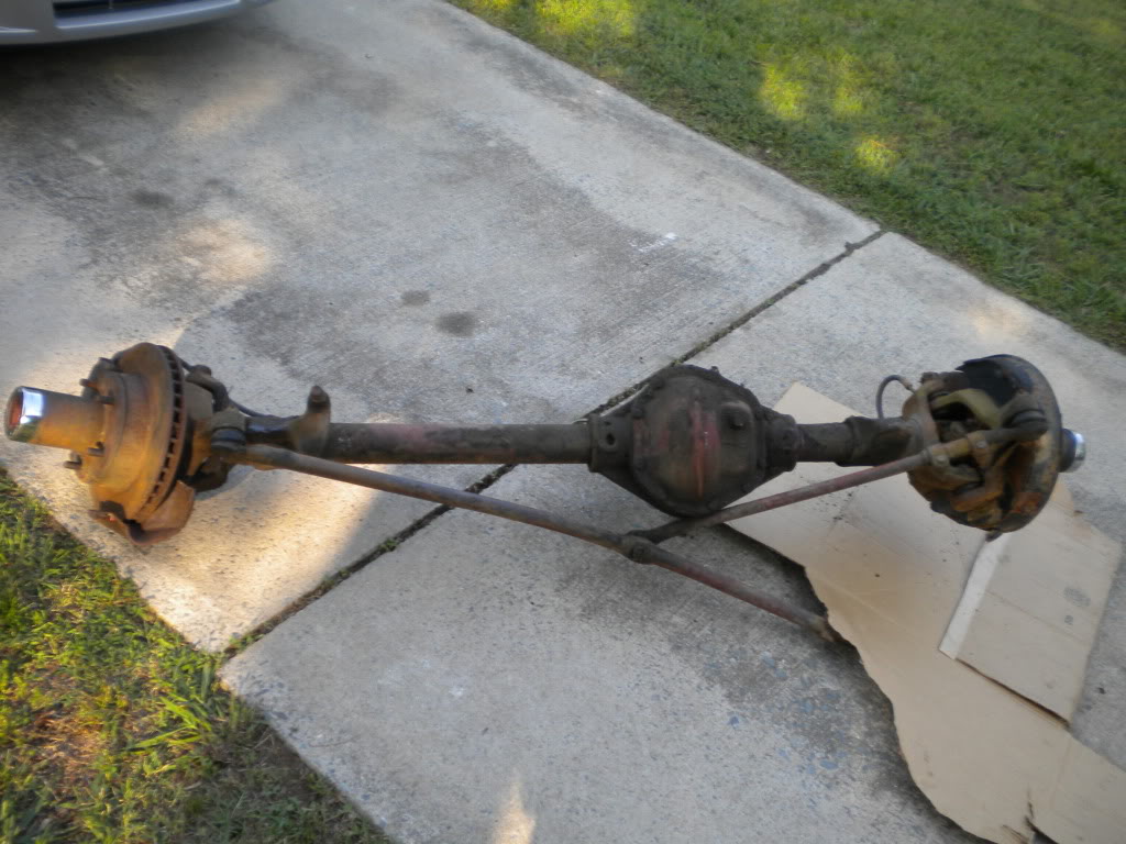

and look what followed me home saturday. hp dana 44 from a '76 f-150. i got it from jovibuilt (super guy to buy from btw)
i'll get this thing cleaned up and painted this week. i got it out of the car and that is where it will sit until i work up some more strength to move that heavy bastard around.

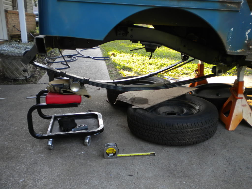

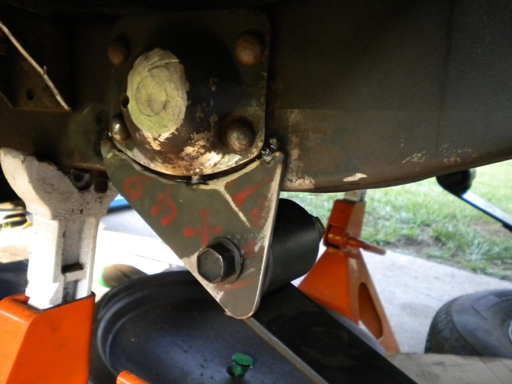

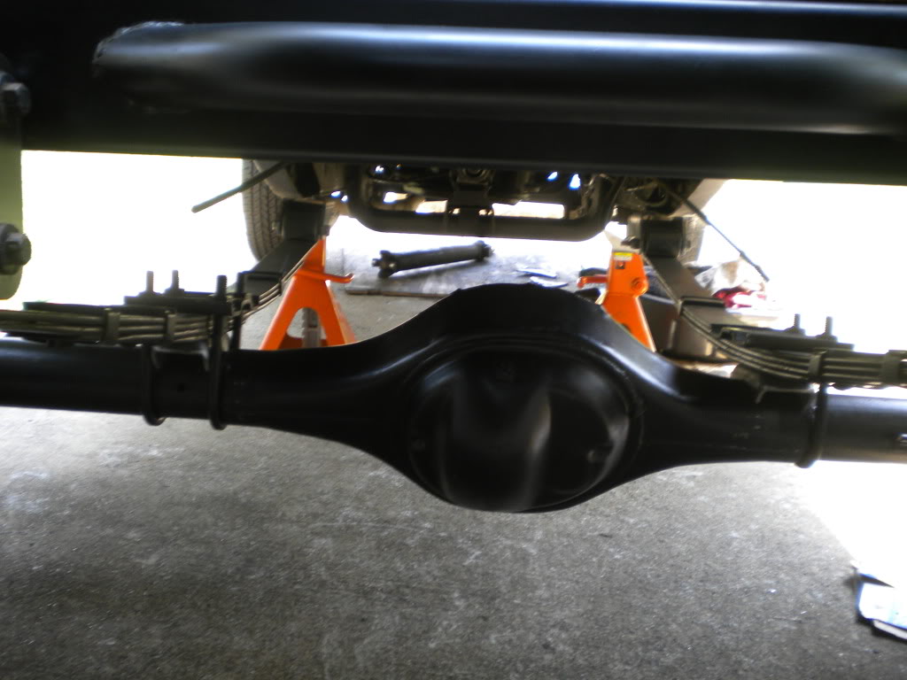

what do you guys think of my rear shackle angle. it will probably flatten out even more when there is weight on the springs. should i move my frame spring hangers forward to get the shackles a little more vertical? let me know.
I'd approximate the final load... fuel tank, fuel, gear, etc with something (sandbags, kids, neighbors) and drop it on the leafs. Once the weight is on them, they'll flatten/elongate and the shackle angle will likely get worse...
I'd shoot for this.
thanks guys! i was figuring they were a little too far out there for unsprung weight. i'll get the rear bumper / shackle hangers welded up since they are where i want them and then get the axle under the rear so i can add some weight to it and see what we're looking at. i'm pretty positive that i'll have to move the spring hangers forward 1.5-2" to keep an optimal shackle angle when at ride height.

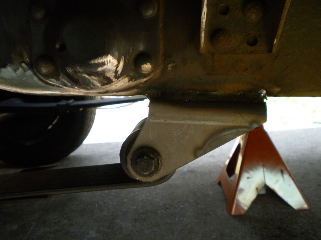

i got a little more work done tonight.

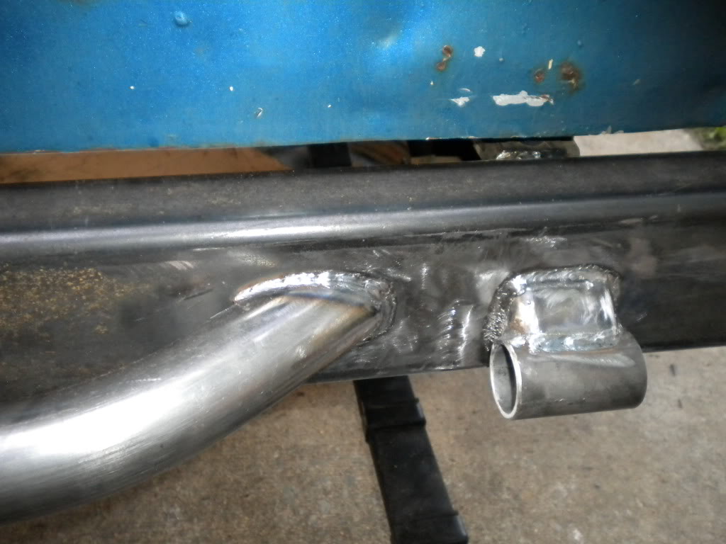

i welded up the bumper and shackle hangers for the rear and rounded out my shackles on the bumper ends so i could bolt up the springs to the bumper. I added a 1.75" piece of DOM tubing that i bent to prevent backing up into the shackles or springs since they're mounted to the bumper. i'm pretty happy with how it turned out. i still have to move my rear spring hangers forward to take a little bit of the angle out of my rear shackles. i should have the rear axle under the jeep by the weekend if i'm lucky.

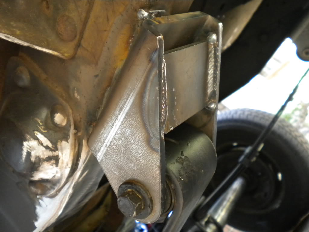

i got some more work done over the weekend. i got the spring hangers welded in. i ended up buying some hangers from barnes 4wd. those guys are awesome to deal with and they are super quick.
anyways, i got the rear wheelbase set. the tape measure gives you an idea of what the 38" tires will be front to rear.
another. the rear stretch ended up being 9". my total wheelbase without stretching the front yet is 91.5". i plan on stretching the front about 10" or so for a total wheelbase of around 101.5-103".
new shackle angle. MUCH better!
the barnes 4wd spring hangers come in two pieces so i had to weld the cross brace in.
cross brace welded in.

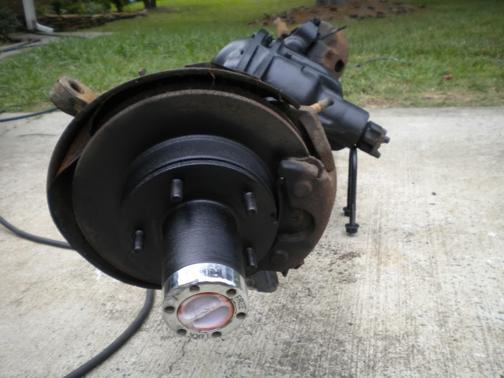

front axle wedges cut off and wire brushed the axle.
paint makes something look so good.
everything that is still rusty will not be used.
