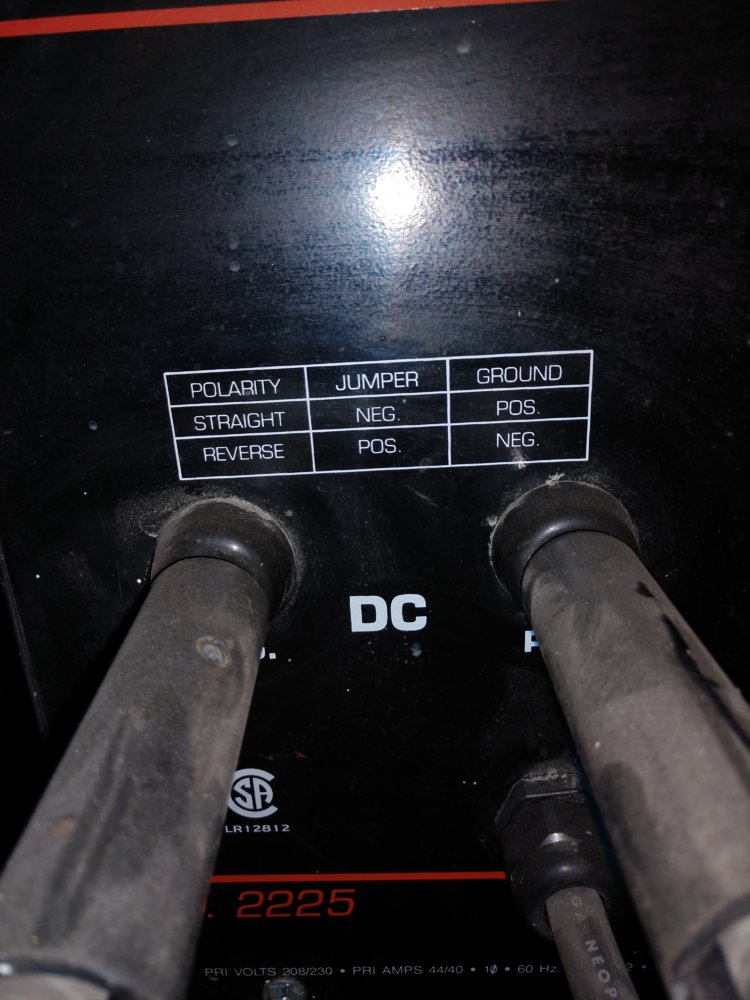

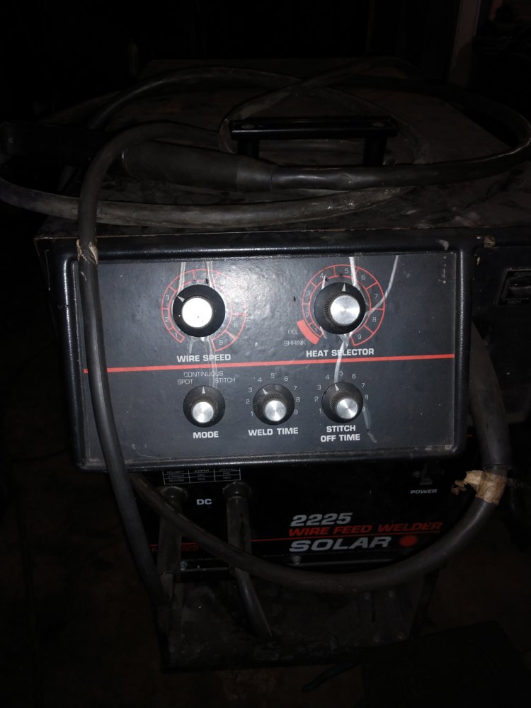

I can only speak to self-shielded wire (gasless flux) at the moment without reference, but I know that it is DCEN.
Not a clue on that brand. Yes innershield or flux core runs on DCEN. Outer shield or dual shield runs on DCEP.
Huh?? Sorry I don't know those terms, so reverse it

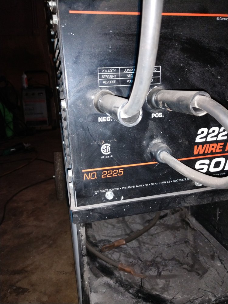

DCEN = direct current, electrode negative. Positive side goes to clamp, negative is the gun. I'd be careful with saying "reverse" since there's the slim chance it could already be set up that way.

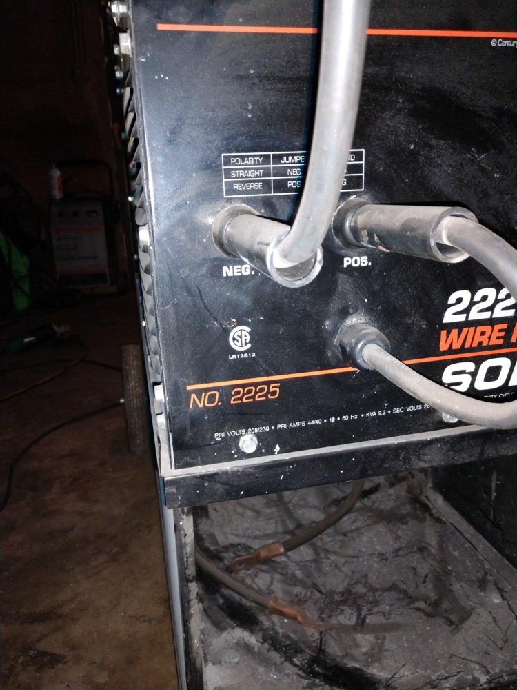

This is what it has now so I put that jumper to negative and put the negative leaf to one of the positive sides? This has weird jumper thing
Wait according to what u said it's wired correctly for gasless right now
No sir...DCEN is considered straight polarity. Set it up with the jumper to NEG and swap the other lead.
Ok I got it lol thank you
No problem. That's what I was eluding to earlier when I said be careful with "reverse." Happy wire burning!

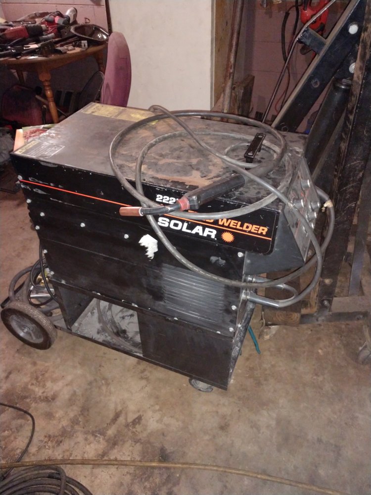

After 9yrs flux welding with a 110v, can't wait to see how a 220 burns flux. I hope I like it cause ain't gonna find a better deal on a big welder than $260
I'd say it'll be a nice change. I used a big Miller 452 at my last job that was set up to run solid wire, dual shield flux, and stick. Kind of like this one, but with two wire feed leads, two gas bottles, and a stick lead all coiled up on the front.
My little Hobart 180 in the garage still feels like a tinker toy when I fire it up. I'm sure you'll see a huge difference.

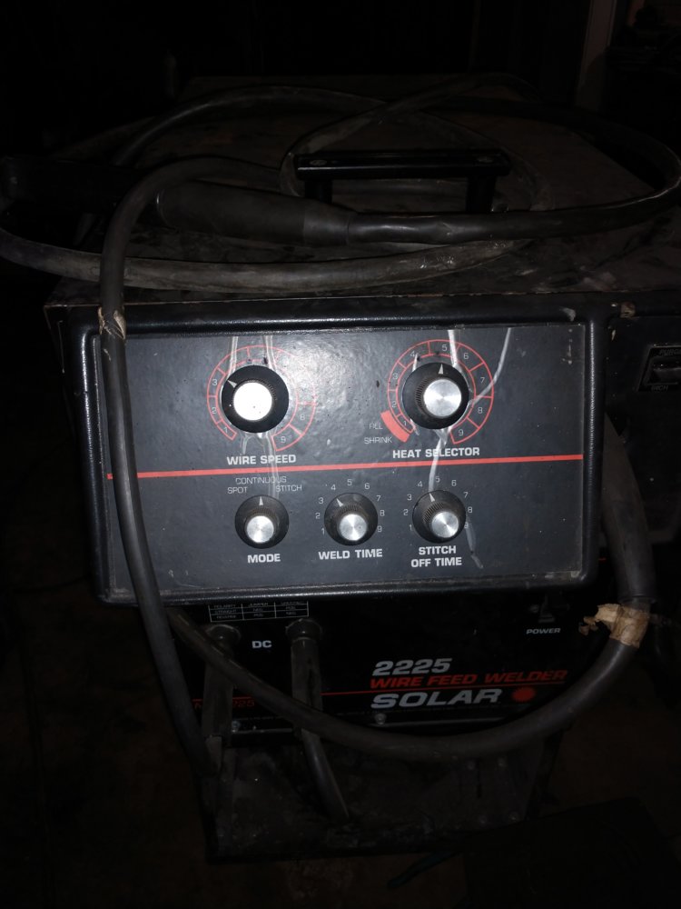

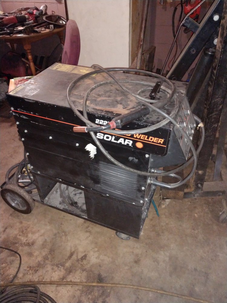

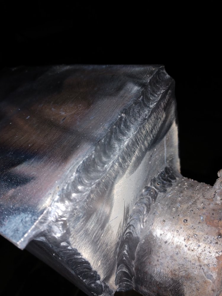

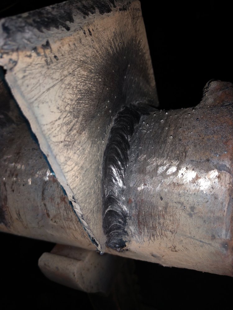

Holy good Lord good heavens good freaking geez Batman... DAIIIUUUUUUUMMMMM this welders is well,...bad ass!!! Where have you been all my life whoooeeyy it bent 1/2" steel plate on middle heat with .30wire like nothing.
Boy this welder burns amazing..but too hot lol. Thin stuff man, struggle is real!! Hard to dial it in on welding up the roof cage pieces, heat 1.5 is hot (feel like a newbie all over again lol)
Well I have to cheat on my upside down welds for these cage pieces using the "stitch" mode..coolest thing ever!! You can set the time and duration of welds and never release the trigger. Very cool and handy feature. I got the hang of regular down/up/lateral welds but upside down looks terrible lol

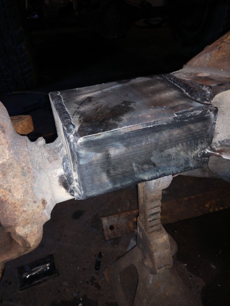

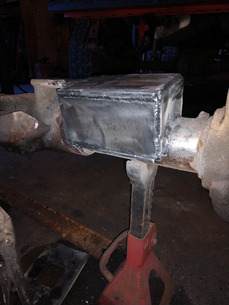

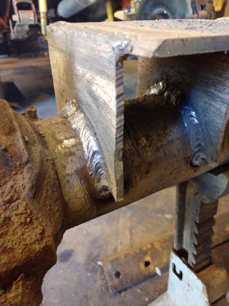

Got my coil boxes finished and welded in. Getting the hang of this welder a bit, not too shabby. Don't know if I'll ever get em to look as pretty as my mig welds.
