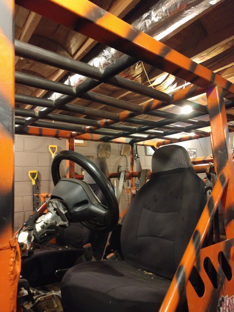

I think I overkilled the roll cage now that I'm looking at it in deep thought:confused:

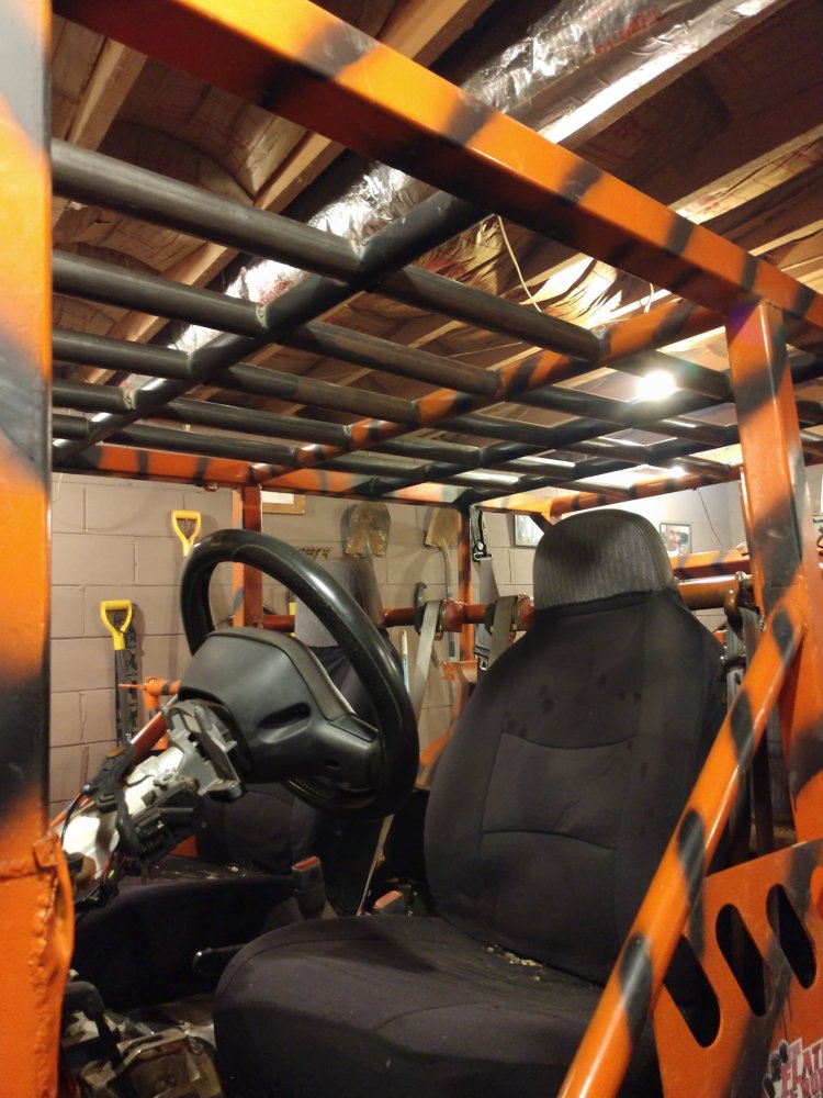

Did I mention I finished my cage.. HOLY moly lol I think it's plenty strong
I had materials and cut and notch at work so why not, it was quick to make em all and we'll w feel pretty confident about it!!View attachment 263012
img_20180215_214343756_ll-jpg.263012
So much work, so little inherent design strength. Yes, it will probably work just by sheer quantity, but doing lots of the wrong thing doesn't make it right. Can someone please mail @marty79 a book explaining triangulation?
Ok ok enough about them stinking triangle. Too much work to cut out sections then more cutting and grinding and special funky cuts and longer pieces. This took me less than an hour and done plus came free from our scrap pile so win win..
You and I both know in reality that cage would and will never give under any circumstances, just saying.
Don't kid yourself, there are plenty of circumstances it would give under.
Ok just curious now for argument sake...why is heavy machinery/fork lifts/tractors and such square cages just like mine and not round with triangulation. They weigh tons more and that's what most have so it can't be that weak at all
I will take a guess at the answer to this, and this is in no way a jab at you or your build.
I think heavy machinery have cages built to support the weight of the machine if it tips over on its side.
A trail rig would need a cage that can withstand multiple impacts from different angles, with out weakening the entire structure. As in a rig rolling multiple times...
