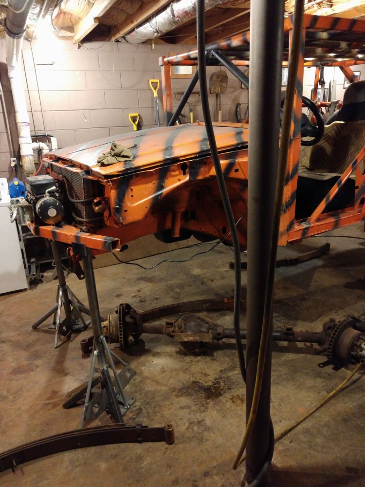

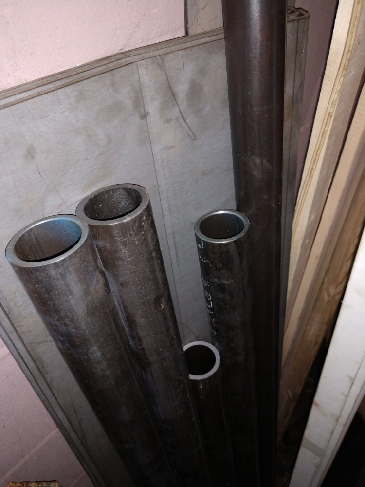

Well stage 2 complete, the teardown lol. Not everyday my garage had that many 8lug axles lol. Got my tubing today too.
Yeah yeah my jack stands are ghetto..haha, something I put together quickly but works for me
You support with additional stands before crawling under that right?
Heck yeah, ain't getting nowhere under till I make at least 2 more with all the framework and such I gotta doYou support with additional stands before crawling under that right?
Ok so bigger base and longer braces to go out wider from middle way down, got it. Thanks.Make the bases larger if you're going to have them that high, because you're using them as jackstands and not underhoist supports (underhoist supports don't really see much tipping moment, just compression loads). I don't want to start the cage argument again in a different context, but you can make some much simpler jack stand bases that are much stronger than those, with 3 or 4 legs and some plate or strapping to tie them together and prevent spreading (both outward and sideways, which yours are lacking).
I look at the tall height of those, and the size of the base, and how the base/legs are supported, and how heavy the Jeep is, and I'm not getting within 10 feet of that Jeep if it's sitting on only that type of stand. A stand of that height is meant to support, and isn't meant to prevent tipping because it's really bad at that. Preventing tipping is the job of something else.
I just want you to be safe. Please, just be safe.
I'm bad for this I admit. Always in full throttle modeGo fast and take chances.

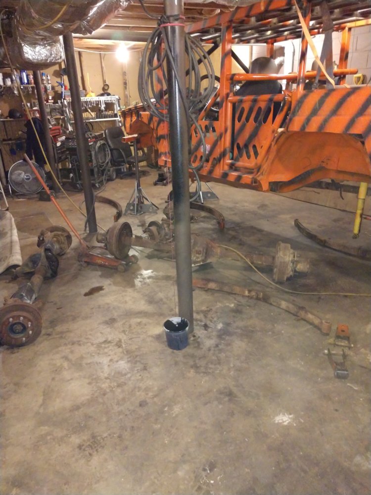

So can't help to notice the rear body leaf spring mount is perfect location for lower link mount...any reason why that can't work?
Or cut out that whole section plate it all and make whole new box?
That makes better sense, thanks.Do what works for the proper link geometry, not what works because it is most convenient.
Hell no, carry on! This thing should be linked and a roller by Friday.Do what works for the proper link geometry, not what works because it is most convenient.
I remember you saying that, got it.Plus those leaf spring mounts are in no way up to the task of PROPERLY supporting the loads a LCA mount will see.
If you're really going to link it front and rear, you are going to have to plate the frame front to rear. Again.

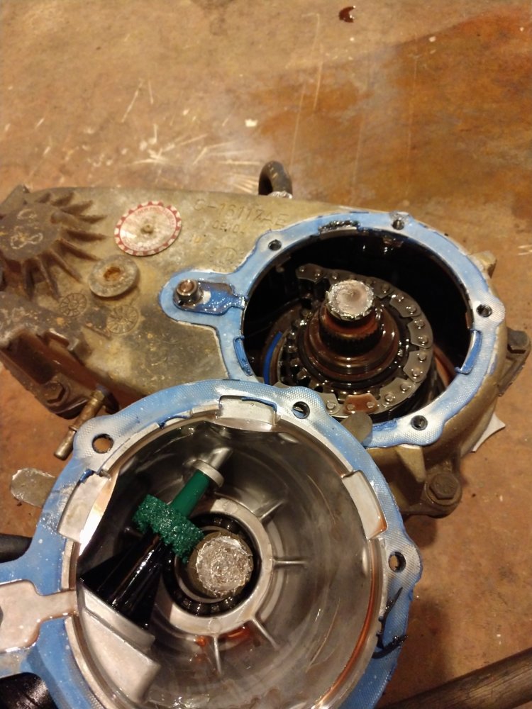

)Pretty amazing that everything else is perfect inside. Clean snap that's it.
