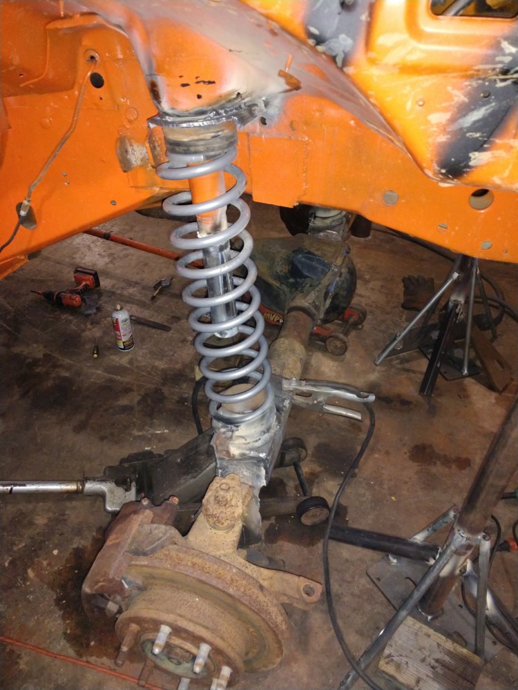

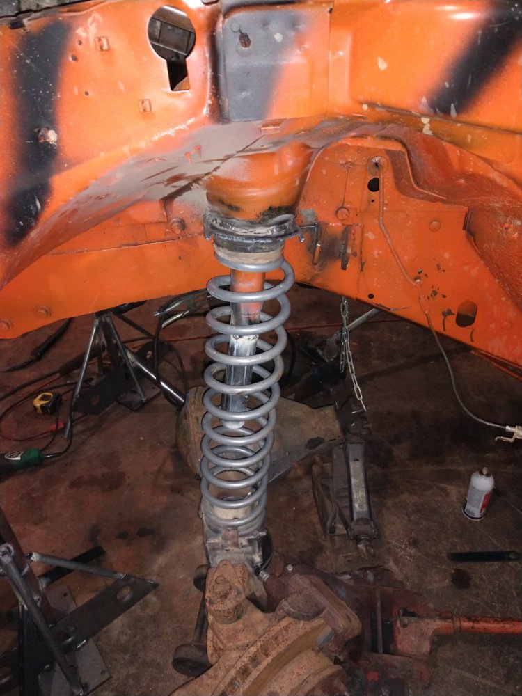

Well got the front axle installed where I want it. Moved upper coil buckets out an inch away from body to keep springs from rubbing and got pinion in good spot to start until I get tcase mounted.
Parts were shipped today so this week will have links made for front.
