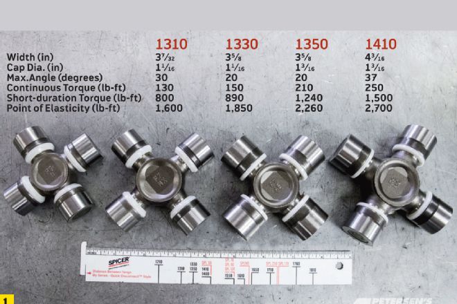

So the caps are the same size, but the joints are wider, correct?
Then, based on the abundance of information we have given you in this thread, what size joint fits that yoke?

It's only wider one way, the other way is normal jeep width..1310 joint..(bout to go double check lol)

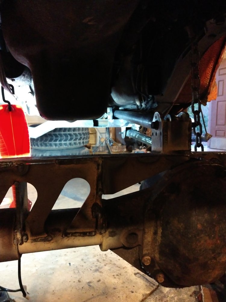

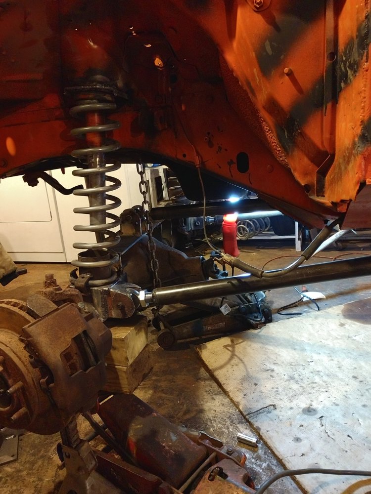

Now take the springs out of it and cycle the suspension through the range of travel, check for any interference. And at this point just make room. I would even put the driveshaft in it and check full stuff to full droop to make sure it’s not hitting that upper link.
Just kidding you need a track bar now and set up your drag link. Then you can cycle the suspension and check for interference with anything.

If he doesn't use one at each corner and only one in the middle the way you suggest then when only one side is compressed and the other extends the shock will be what limits the droop on that end, not the middle limit strap. That kind of negates what you said about not using the shock as a limit strap. If you mount it correctly your tires shouldn't get into your limit strap.
thats exactly how I have mine setup; performs double duty very well. the center limits total axle total droop ,and the bumpstops on the opposite side limits the others droop prior to shock max extension.

If you're going to run a bastard u joint then you better carry a spare. A 1310x1350 u joint is weaker than a regular nongreasable 1310 spicer.
How much shorter is your strap compared to the droop possible if it was limited by the shocks?
A few posts back he said both sides had the same cap diameter, but one was wider. Sounds like to me that the pinion uses a 1330 joint, not a 1350, which has a larger cap diameter than a 1310.
Regardless, I'd change the pinion yoke and just run 1310s.
a "wider" 1310 would be 1330, right?
1310/30 share the same cap size but are different widths.
