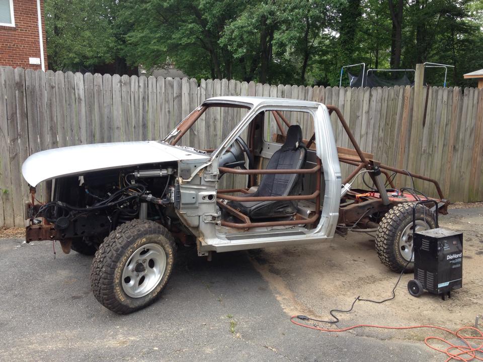

I think he's saying that weather it's the door trim or the door bars..it's still occupying the space that his shoulders need. In other words, I think his door needs to be wider than anyone else..which I think would be just fine if he had it fabbed up to fit him.
Nah no custom doors here...seat position will fix it.
Now to see if I can get me big ass in and out of a Ranger window...
I was under the mis-impression that the doors could be replaced with door bars only...this changes my ideas a bit
No Ron you cut the inner part of the door out so you can put the door bars "inside" the door and keep the seat in its original position.
Thats just it.
I cant fit inside a ranger with the stock door and a Mastercraft suspension seat without in boarding the seat 4-5" inches BEFORE we add door bars.
Still plan to check other seats but had one in the garage ready to test fit so I did.

All that should be between you and the fender on the truck next to you is 3 door bars a a thin pc. of sheet metal aka door skin.

Ron will fit through the window.

Oh i get what your saying now.
Thats just it.
Well if you need to inboard the seat why not just move the steering wheel with the seat so you stay lined up with it?

The ones I have seen cut the skin off the door and bolted it to the cab. The door bars ended up where door innards would have been.
thats what I was thinking. the door tube bars should be thinner than teh stock door, plus no handles etc getting in the way.
Yeah, the door is about 4" thick. Push the door bars as far outboard as you can, and the cab actually gets wider.
Does it even require the door bars be "inside"? or even factory-looking doors?
A lot of the guys at Line Mountain run side bars that go outward from the A-pillar about 4" then curve back to meet the B-pillar in a sort of hoop. Just skin that.
I think we're talking about the same thing.
Then you cut the skin off of a factory door and bolt/weld/etc it to the cab to give the appearance of factory sheetmetal.
I think Dave is talking about the way I originally intended. The door bars actually bowing out several inches proud of the body lines
Now you're just being difficult.
The door bars bow out from the B and C pillars, just like most any dirt track/modified/nascar/etc/etc car that's ever been built.
