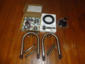

First time I've seen new parts in a while, sad news is my wife is selling her car and she will be driving my truck for a little until we can get her a jeep, so project is on hold for a couple of weeks. :( But thanks ECGS for great prices and a speedy delivery!

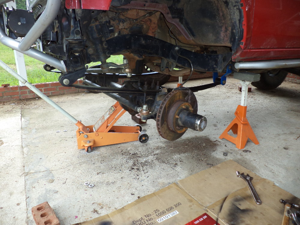

Gears are installed no pics cause my camera crapped out on me, but I would really like to thank ECGS, and Tom Woods for all the help and the great customer service! any way im stalled out again on getting it back together, i broke a knuckle stud lol....but not really :mad:
Anyone know where i can get these? (chevy 44, flat top knuckles)
If your busting studs off, you might want to look into the keyed arms and knuckles. little more cost effective then the 4 bolt knuckles
HUGE thanks to ECGS they've have helped me greatly with this part of the adventure! Sorry still no pics but the truck is put back together, and it works! the tom woods offset u-joint gave me the clearance i need at ride level but im scared it might bind at full droop but i have no way to test it now soo ill have to wait and see. The next pics i upload should be offraod shots but will see if i cant manage to break it before then :shaking:

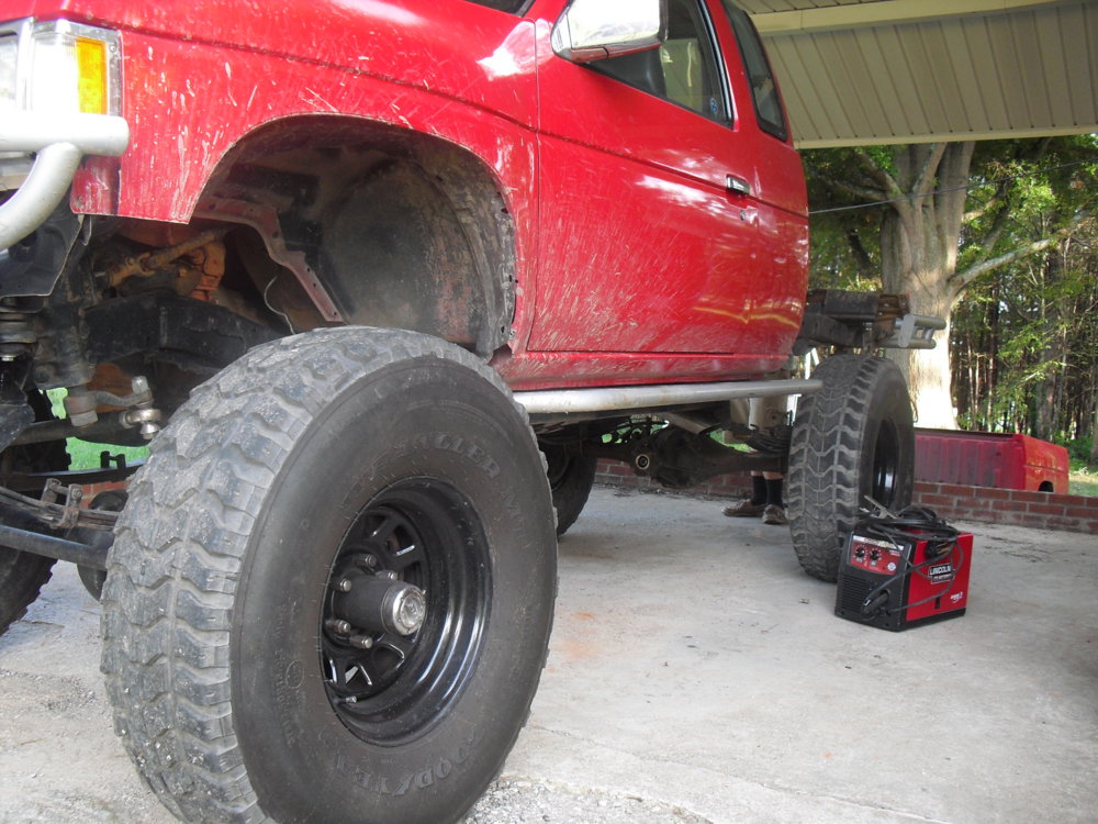

ok well i decide to go a different route than the DOM, Im just going to get some 2x3 tube and finish the crossmember out of that. heres the progress i made today, my welds sucked, im not decent at joining to pieces that are different thicknesses, yet.

finished the cross member today, nothing fancy but it works
(If you are using MIG) Set your welder for the thicker material, start your weld on the thicker material and draw the puddle over to the thinner material to get it to melt into the puddle to join it. Otherwise you will blow holes in the thinner stuff.
thanks man im always i need of tips and tricks and thats most likely why i was having a hard time with it, i set my welder for the thinner metal. It should still hold right? I patched the holes, Ill go back and re-do it if i have to.

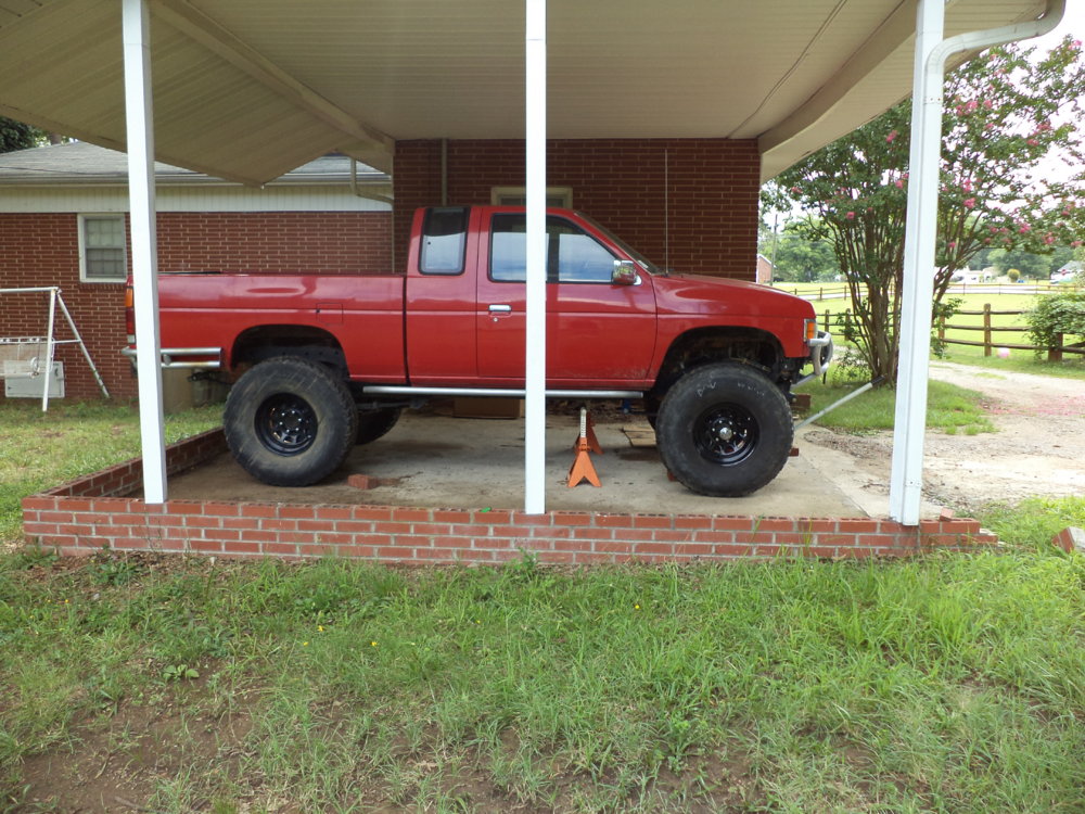

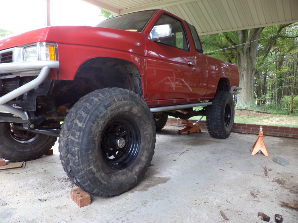

Here are a few pictures of a before (Bed off) and after (Bed on), and id say about 4 Inches of drop. I cant tell you accurately because i forgot to measure the thing up before i took the old springs off.
