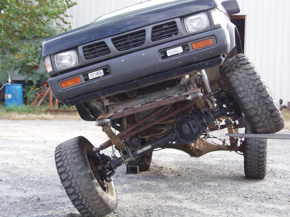

sick! What front springs are you useing?
I'm using my stock rears up front (RUF) like the toyotas do when they go SAS, but I kept the add-a-leafs from my 3" suspension lift to keep everything level.
Its the calmini spring hanger up front and I think all my other brackets were bought from ruffstuff to keep bracket fabbing down to a minimum during the work weekends.

What axle is that lurch? What wms to wms measurement you have?
Its a D44 I pulled from an '89 Grand Wagoneer at the pull-a-part in Charlotte. WMS it 60.5" IIRC
That axle is close to being the same length as the rear axle (stock H233B), and I'm using 1.5" spacers at all 4 corners.

Those rears look flexy, how do you compare them to waggy springs? Flex better or not? Arent they the same width?
Another question i have for you, where did you get the gears for you h233b? And was it worth re-gearing compared to swaping in a different rear end?
OH and are you using the double shackle in the rear w/63"s or single shackle

I never ran the waggy springs, so I can't answer those questions...
I got the gears from a Nissan Junkyard in the Concord area. The guy's shop/jy is down the street behind the Lowes across the street from Concord Mills (on the right if you're going away from Lowes). Can't remember the name or a number, but I bought an entire rear axle from a 2004 Xterra (IIRC 2000-2004 had 4.9 gears from the factory) for $300 & scrapped the rest. I think the swap was worth it for the $$$, plus I think its kinda trick to have a pure Nissan axle (discs from a V6 pathy, gears from a Xterra & stock housing). That being said with 36" tires, I can't use 5th gear without a tailwind going downhill! If I break an axle, I'll use that as an excuse to go bigger & 5.XX gears...
I'm using teraflex revolver shackles in the rear that I had from the 3" suspension lift, I'm happy with them...
