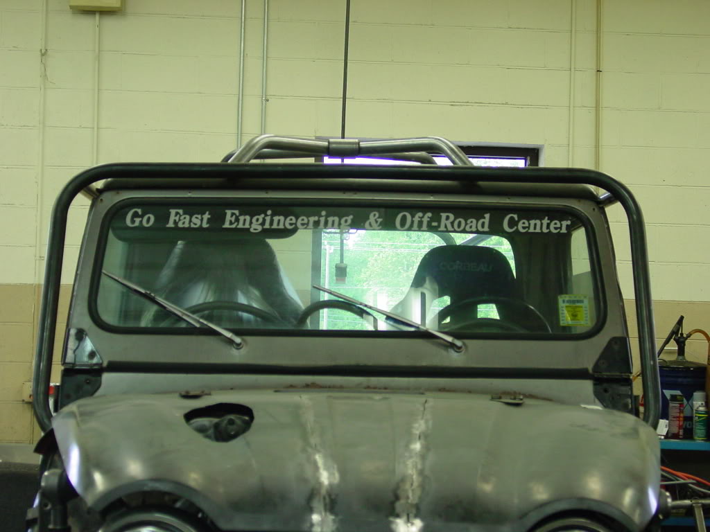

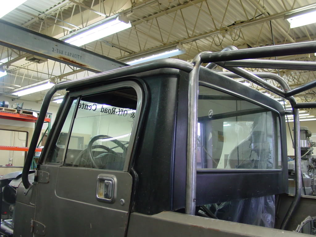

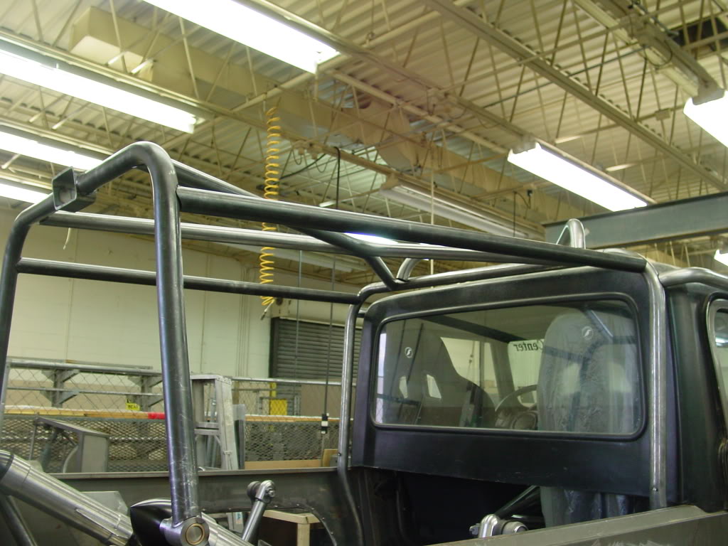

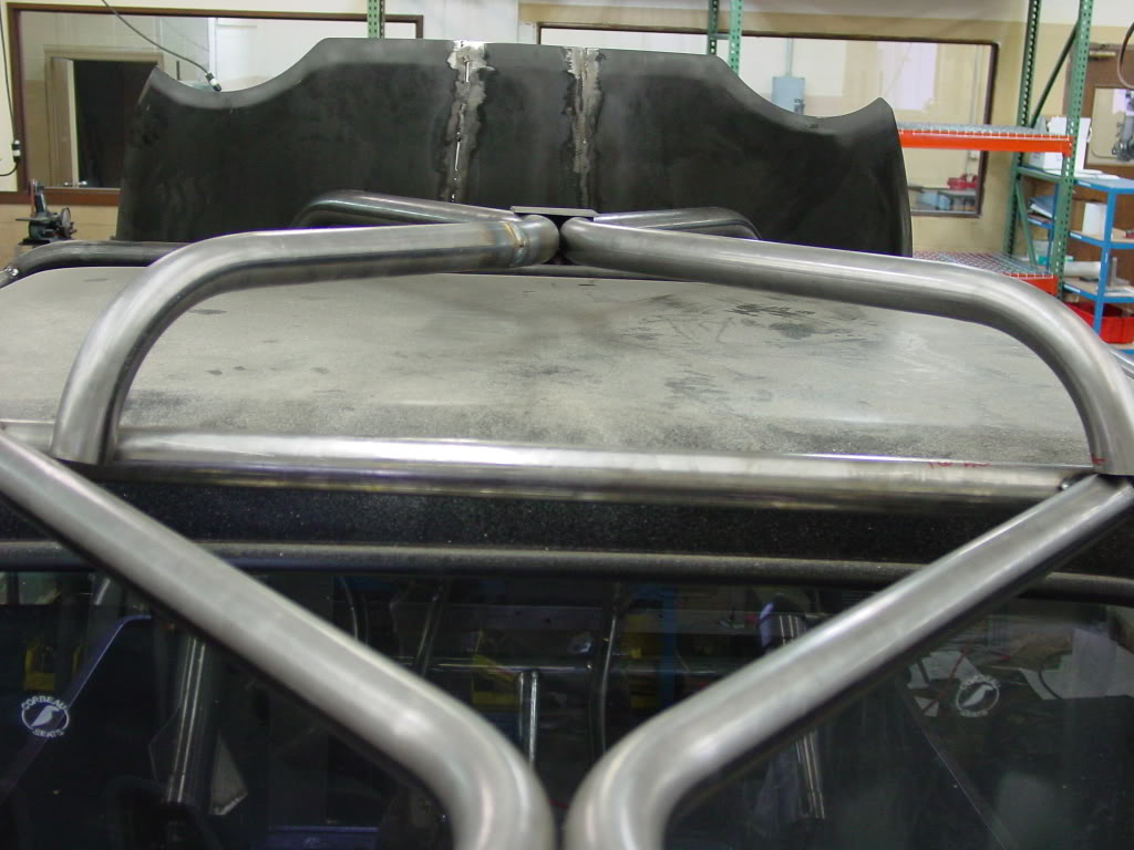

He has been working on the Exo Cage, There is allot left to do with it, It will be removable so that the Hard Top can be used, I am interested to see how he does it, But he has a plan. The top cage work above the cab is an Idea and may not stay, He really isn't happy with how it turned out.

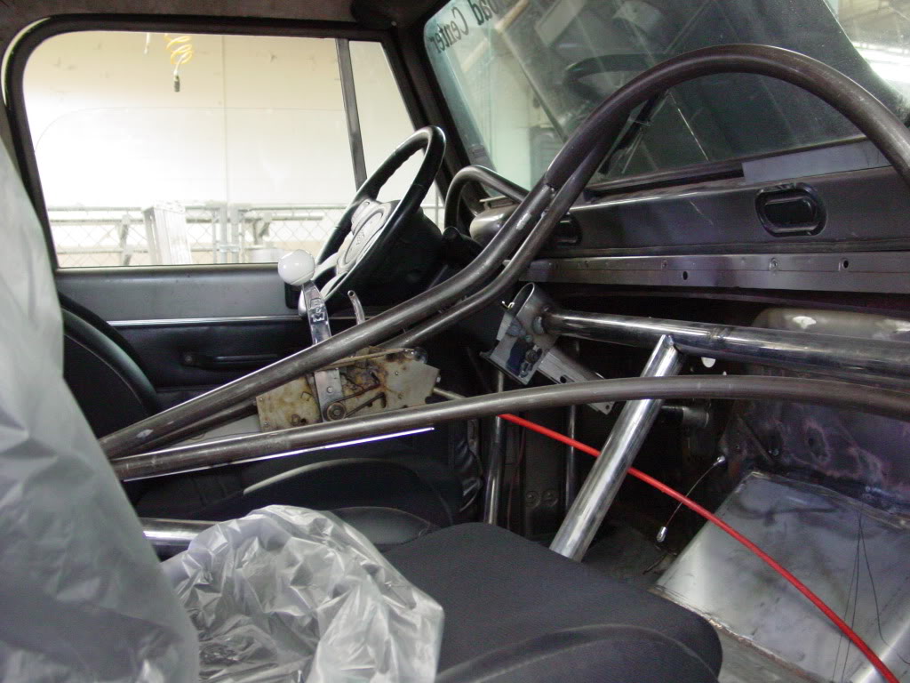

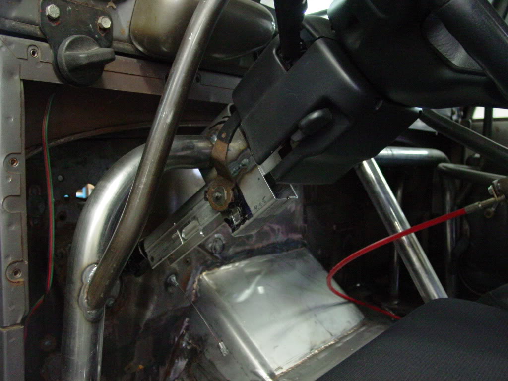

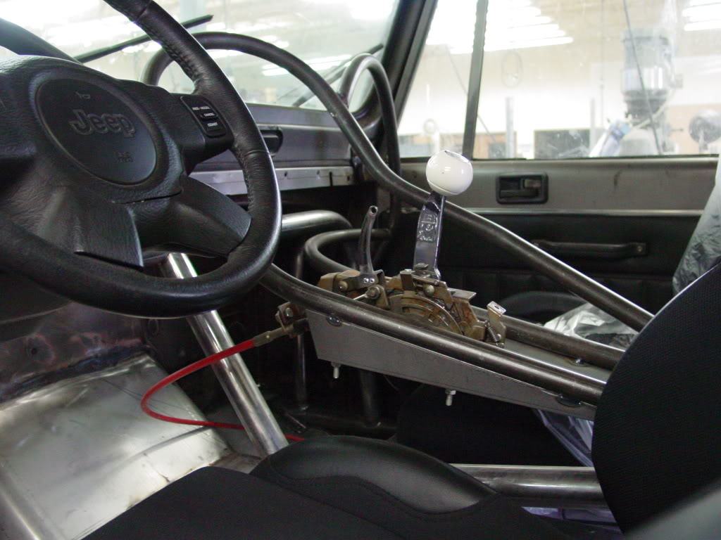

The interior is coming together, The shifter is mounted, The steering wheel is mount and have a custom adjustable bracket to allow the wheel to fold up and out of the way, He is incorporating the buttons on the wheel to control the air springs.

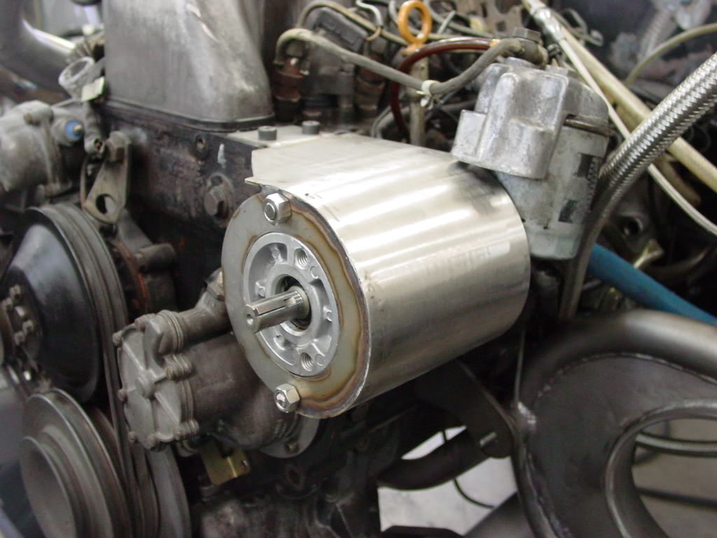

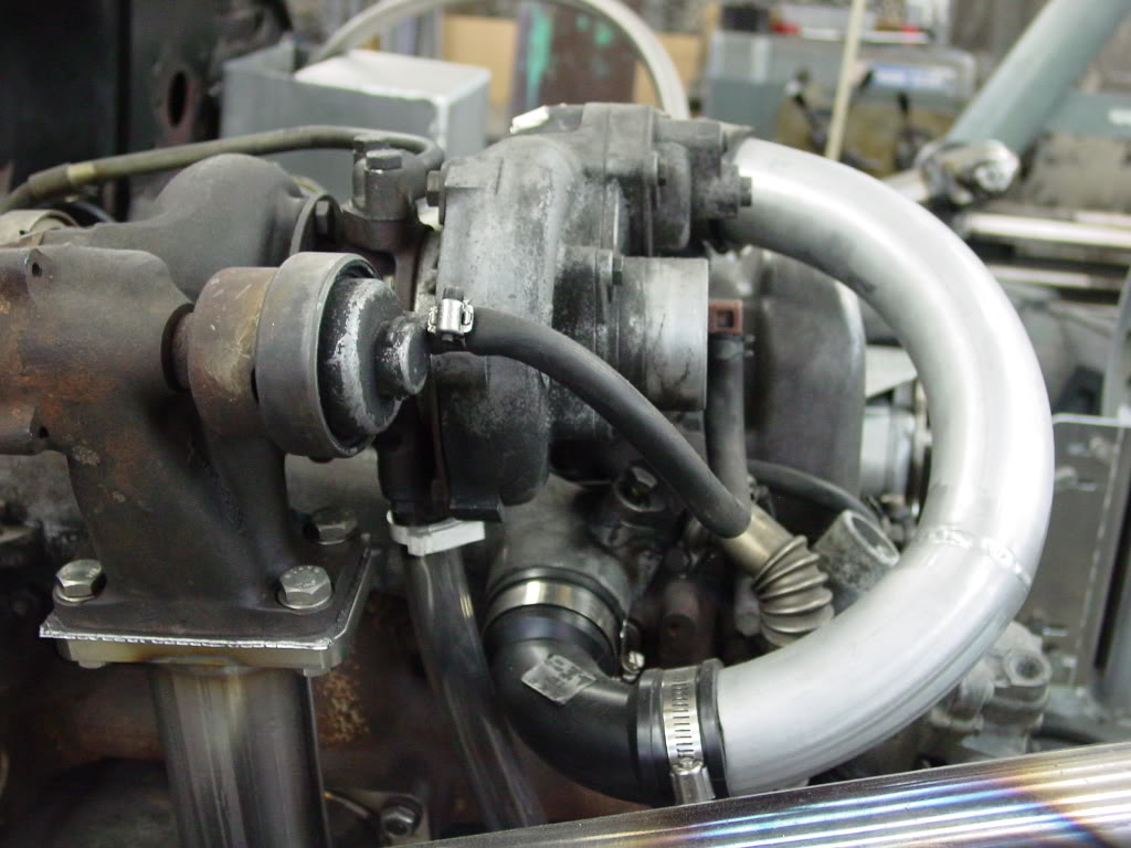

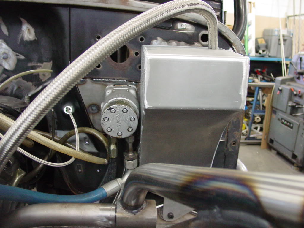

He has his hydro steering box and pump mounted and plumbed, He also got the oil warmer built and mounted (hydro line laying on it is not staying just laying there for now) Turbo is also mostly together, and I have heard it run on Diesel and cooking oil.
Awsome! would love some info on the injectors on the motor. I was told I would have to change cam lift to get more performance out of the the injection system. Is the Bosch p-pump similar to that of an older cummins?
It's differnt pump not a P at all should be a Bosch MW Pump....injectors are not the hold back on the OM617.9XX motor. The fault is in the pump. You do have a couple different adjustments on the pump and you can removed the ADLA. If you want real power Myna Diesel in Finland will modify the M-Pump for around 1200ish euro. Contact me and I can get you more info. Then new thing in OM617 power is the modified M-Pump from Myna with the VGT controlled Turbo from a new cummins diesel. They have stand alone controllers and you can control the turbo vs air flow vs fuel. OM617 is a great motor but more power can be had from the OM603 6 Cylinder found in the 300SDL's but were known as the "Head Crackers" and the 350SDL's which were known as the "Rod Benders" Sorry for the MB speak but good luck with the 5 cylinder
