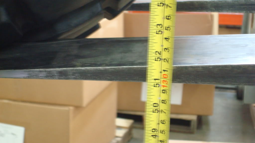

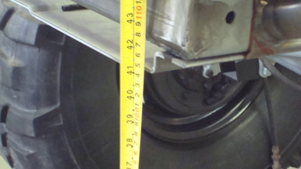

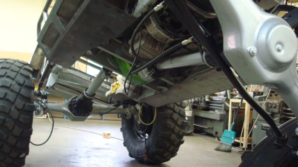

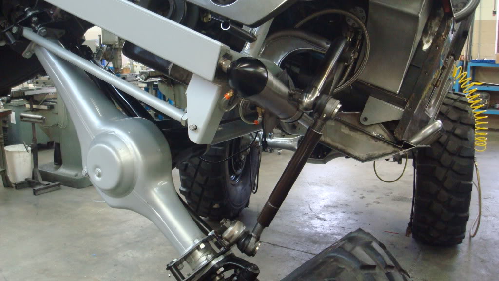

Belly Height
ai822.photobucket.com_albums_zz145_HeavilyMOGified_001.jpg_05739e73254632ee20d8128ba7db4c1f.jpg

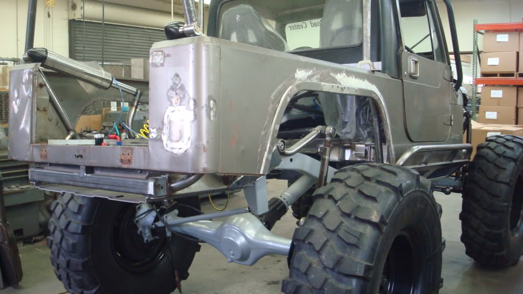

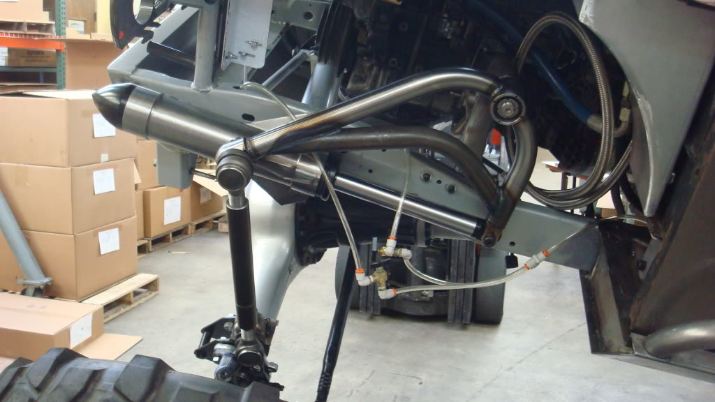

Rear Bumper Height
ai822.photobucket.com_albums_zz145_HeavilyMOGified_002.jpg_343c5cc33d833b79fc807f444844dfc7.jpg

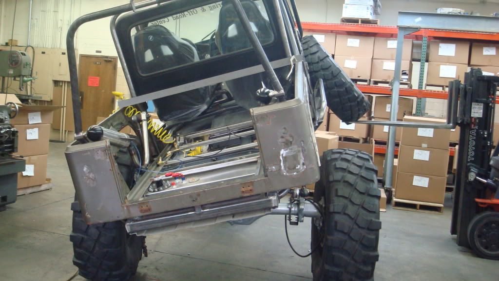

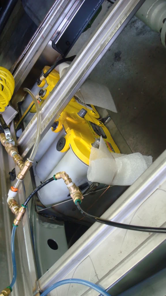

Aired mostly Up
ai822.photobucket.com_albums_zz145_HeavilyMOGified_004.jpg_793400e2444ebbdf6eba96929f4cb5e3.jpg

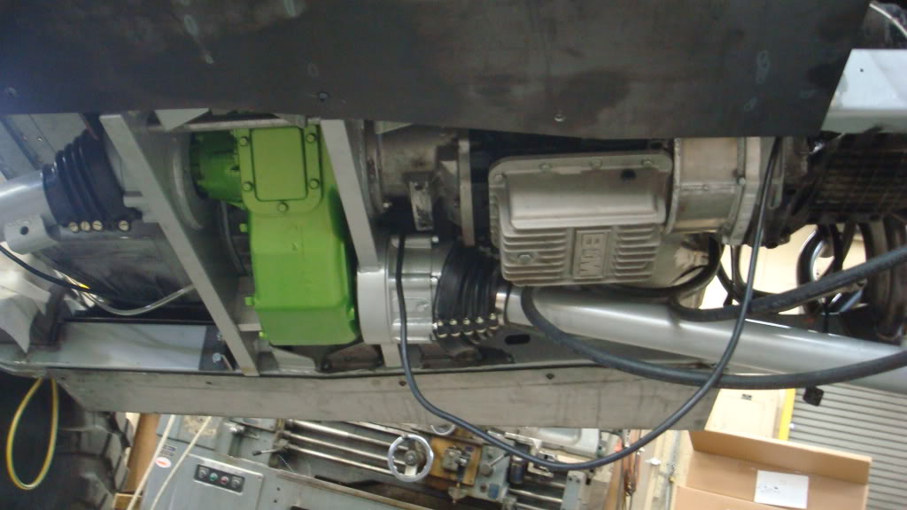

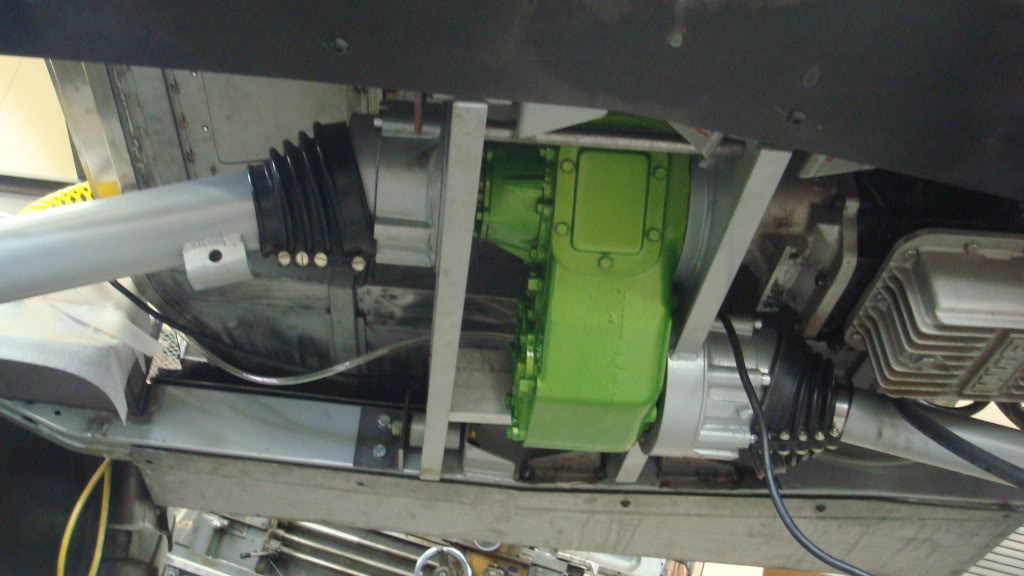

Another of the Transfer Case, With Mog Adapters
ai822.photobucket.com_albums_zz145_HeavilyMOGified_029.jpg_1fc9dc0257fa41f17d2e09d9d3021a2c.jpg

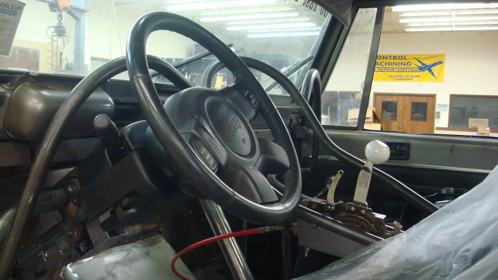

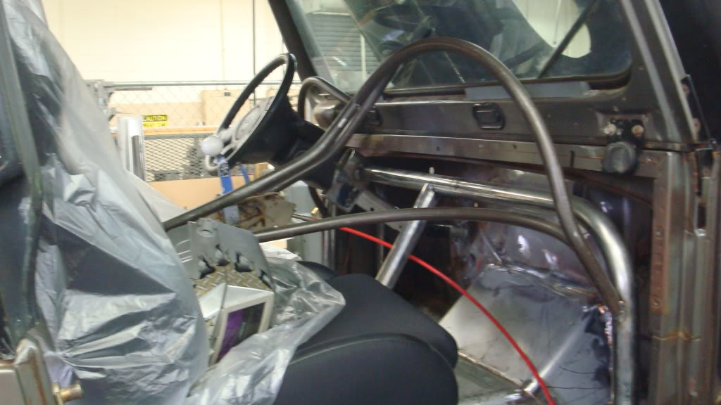

Interior Setup, He is using the Multifunction Buttons on the Liberty Steering wheel to Control Lights and Ect.
ai822.photobucket.com_albums_zz145_HeavilyMOGified_031.jpg_bd62b50eb433cb93f62084782d4c5588.jpg

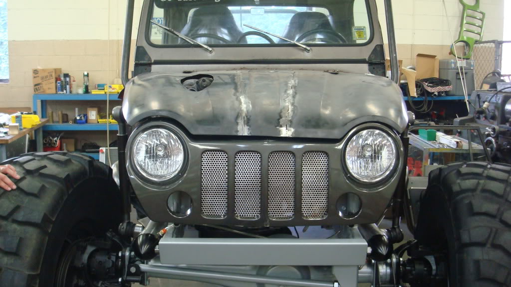

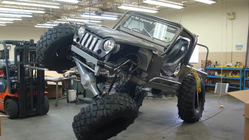

Another Shot of the Front
ai822.photobucket.com_albums_zz145_HeavilyMOGified_032.jpg_b783c4d4f595065942f89f6b66e2d286.jpg

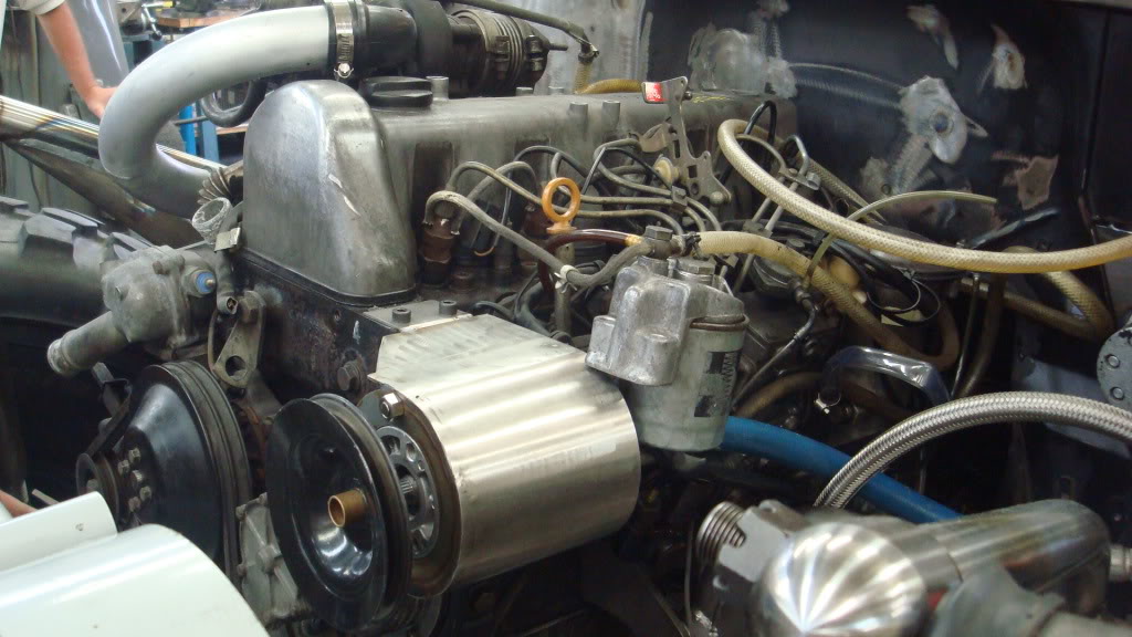

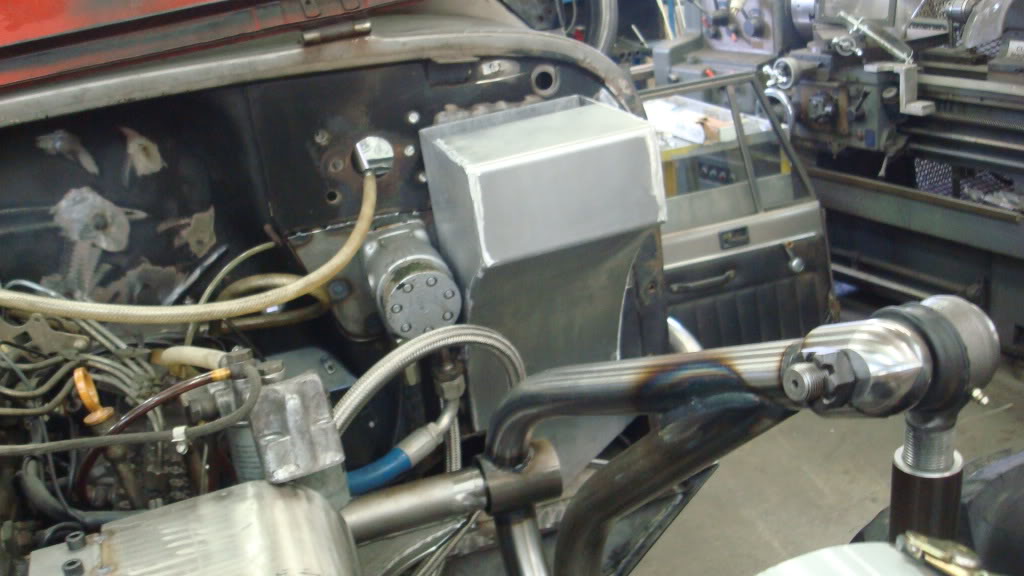

Shot of the "Oil Warmer", In order to run Veg Oil it must be preheated
ai822.photobucket.com_albums_zz145_HeavilyMOGified_033.jpg_c8432da4eb58fb3634cb547a6ceed119.jpg

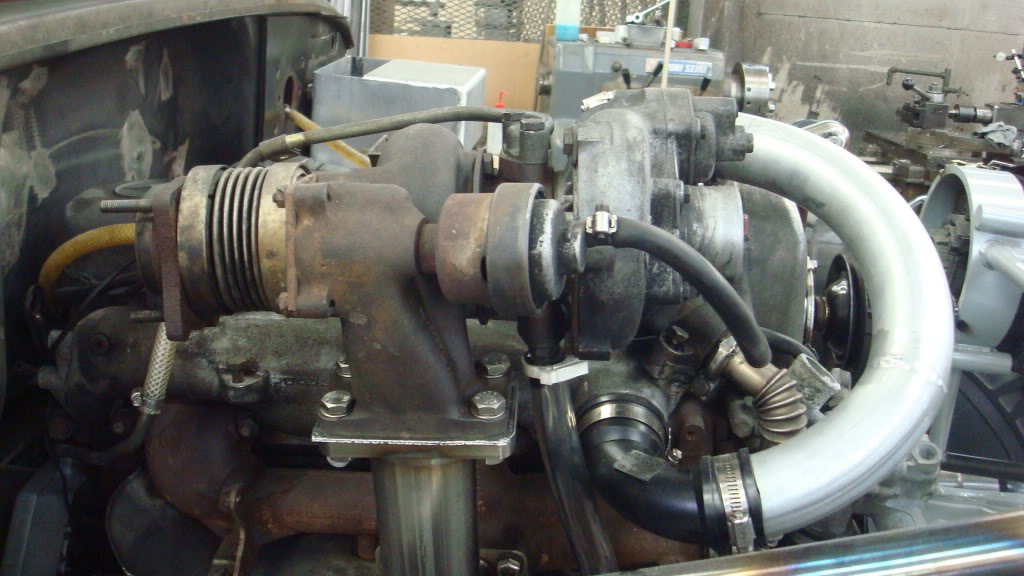

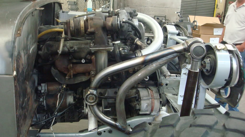

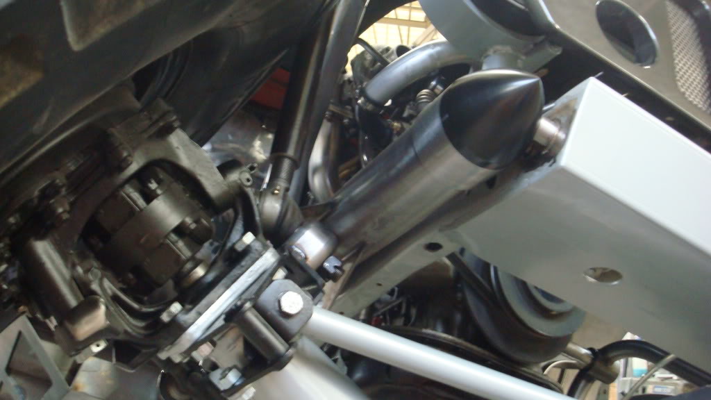

Turbo and a Profile of the Lever
ai822.photobucket.com_albums_zz145_HeavilyMOGified_034.jpg_79187bf39183b4e62fd1551bb4eac086.jpg

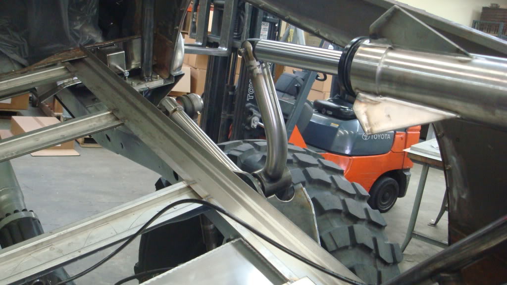

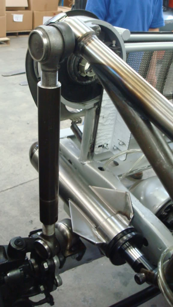

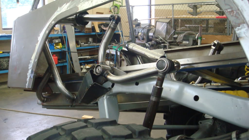

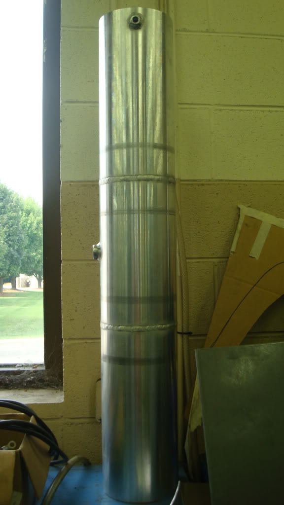

Looks awesome. Is there a reason the rear suspension levers haven't been additionally gusseted/supported like the front? The front looks solid, but the rears look like they will bend if another piece of tub isn't put in there to triangulate it more.
Justin correct me if i am wrong, But the arms are just mocked and not a completed part as of yet, So I am sure the bracing is just not been added.
...bad ass. I think it looks so cool from the front, actually the whole truck looks awesome. i cant wait to see it wheel, keep the pics coming!
Updates? Also, what size is that cold side piping between the turbo and engine? I've got quite a few silicone intercooler piping hoses and 90's in a box that he could use if he wants. Those rubber plumbing boots don't hold together very well.
question.. i was looking at the suspension and saw nothing that would prevent for and aft movement of the axles. i know its not finished yet, just curious.
Updates on this thing? This is definitely one of the coolest builds I've ever seen. I love the new designs and thoughs behind the engineering in that suspension setup as well as the attention to detail in the fabrication.

so is this using the offroad only's airock setup's software ? or did you say he custom made the software.?
this thing is really sick , i definately would have to see it in action. i like the liberty grill looks good on it too.
how would u say the power of the benz motor is compared to a 4bt ? i would imagine the mercedes motor is a little easier to find. they are both 4 cyl right with turbo right?

He has custom software

Can't wait to see the finished product. Most interesting suspension setup I've seen. Also, some of the best fabrication I've seen on this forum. Looks awesome, please update soon.
The suspension system reminds me a lot of the Lull forklifts. Of course those aren't automatic and hydraulics are used, but still the concept is quite similar.
