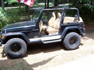

The one found in the picture attached. Im looking to add some rock sliders (probably poison spyder Rocker Knockers)
Problem is, that damn strip is in the way, any tips on removing it?

good choice on ditching the chrome. I have the poison spyder ones and I like them. How are those attached? Is it just some kind of adhesive? Maybe try heating it up and slowly prying it off.
It looks like just a stick on. Heat and chemicals are your friend. I would start by spraying the top with windex or similar cleaner and using a hairdryer to heat up a corner. Once you get it started, it will just be a test of patience to get it off without messing up the paint. However, if you are putting full rockers on it, you may not care, in which case, just rip em off ASAP with a crowbar!!!

They dont go under the body actually, they just stick on and end right above the side step.
I suppose I COULD leave them on, but Id rather not.
