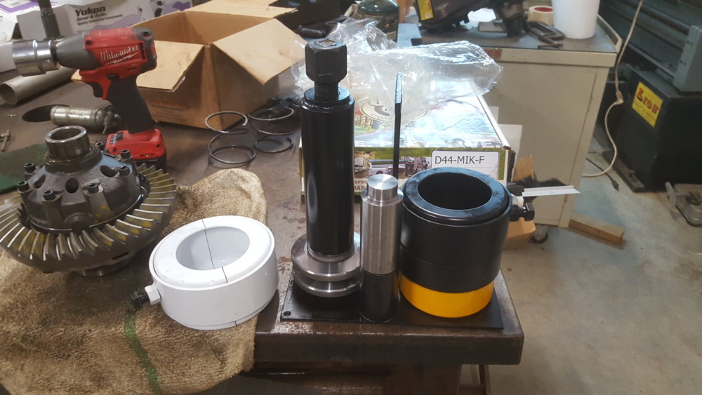

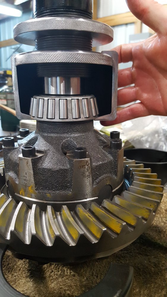

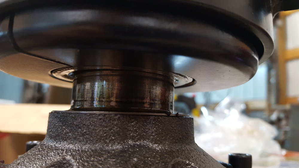

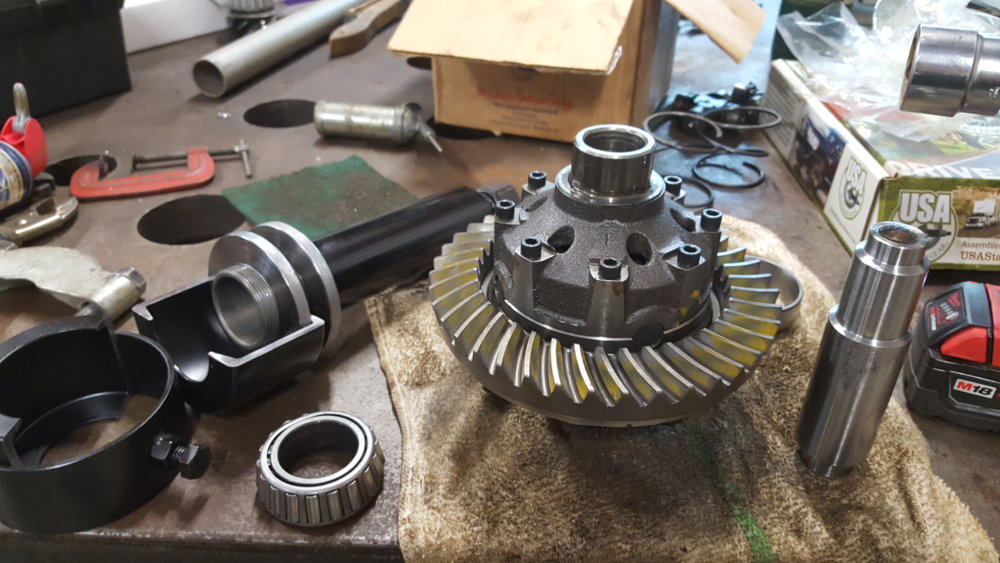

Got to play with my new toy, a clamshell bearing puller. Started to set up the gears on my front D44 probably 3-4 months ago, got frustrated with getting the old bearings off the carrier and moved on to other things. Last week I finally decided to pull the trigger on a clamshell puller.
Thing works like a champ. Pulled the old ones right off. About 1 minute to set it up, and 1 minute to pull it off. I was done with both sides in less than 5 minutes. (Edit: Dont do it like I did. Put the race on the bearing, and thread the lower ring down to it and the upper ring tightened against the clamshell) Well worth the money.

That's not the correct way to use that. Your suppose to put the race on the bearing and screw the lower adjuster down to the top of the race and the upper adjuster to the inner top of the outer cup.

Good to know. It didn't come with any instructions. They are the old ones anyway, so I just wanted to let damn things off in any condition. Now it makes sense why there were 2 threaded rings.

I have had one of these for years. I can't imagine doing gears without one anymore. Every time i see it, I think about selling it, but then there will be the day I need it again.

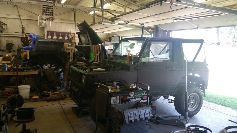

Started off working on the sami but my helper disappeared :confused:. Since that's at a standstill I started cleaning the shop (it could be featured on that hoarders show).
