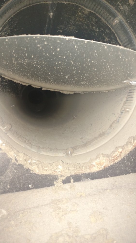

Yes. 150-175 constant psi, flexible rods and a forward/reverse head and most agitator heads will clean it well without damage.
I'll dig up some before and after pics of recent jobs. It's quite amazing.

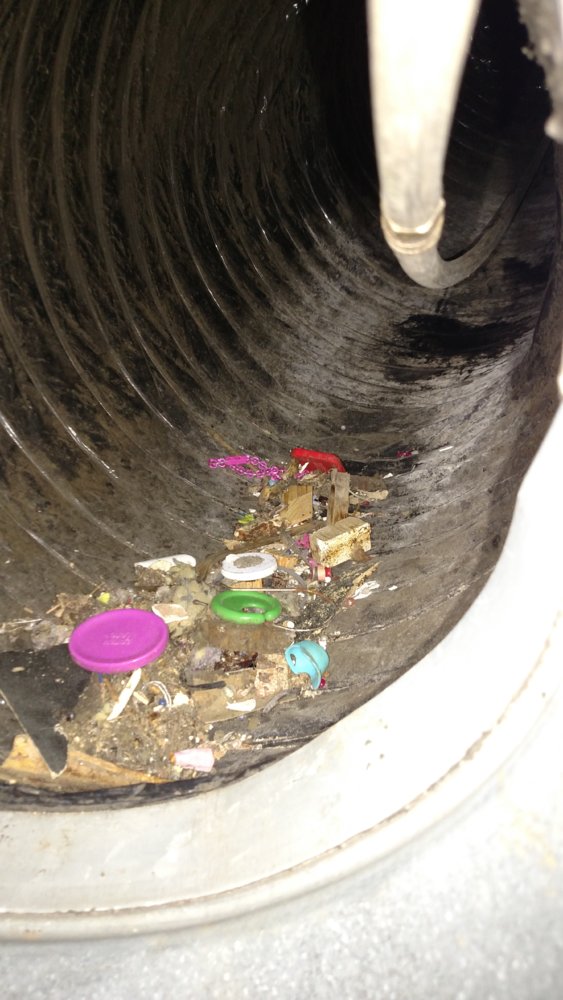

In my experience a floor system will usually get 10x dirtier than one in the ceiling. Gravity sends all sorts of dirt, debris, liquids and everything else down inside the secondary lines and over the years, this buildup of stuff will collect moisture and grow mold. I've been on plenty of jobs where the homeowner will call us because of a musty smell and as a last resort get a duct cleaning. More often than not, that's the source, either moldy buildup of trash in the secondary lines or an air handler with a clogged drain, dirty coil, dirty fan or microbial growth on the inner lining. All of which is addressed and remedied by a good duct cleaning processional. Never a 100% guarantee, but never a waste of money.

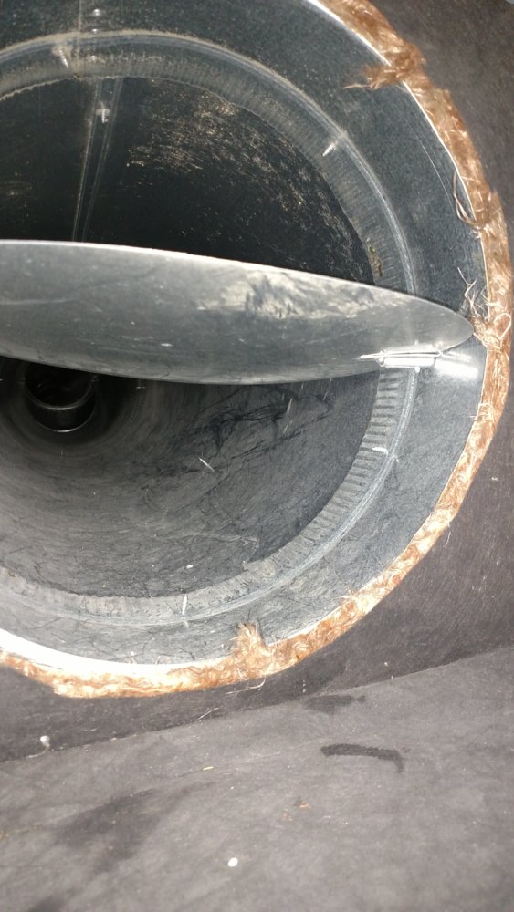

This is a documentation photo I took of a 5 ton split system plenum box. For a system with fresh air return, this is typical for 10 years of buildup. This was in a doctor's office.
This type of duct lining is common in both commercial and residential systems and SUCKS to clean. Results are typical.

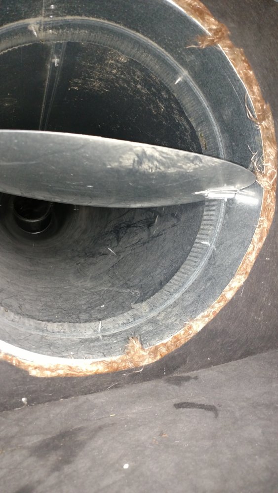

This is a documentation photo I took of a 10 ton split system plenum box. For a supply with fresh air return, this is typical for 10 years of buildup. This was in a doctor's office.
