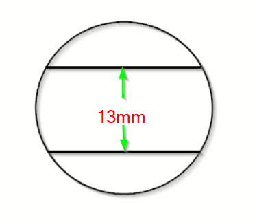

13mm rectangular drive. Basically 2 open ended wrenches welded together. Needed to turn a weird low profile nut on the end of a shaft that looks like this (13mm flat to flat):
And it's only about 2mm/0.080" thick, so an adjustable wrench is difficult to get a good bite on it. Is there anything commercially available that would work for this application?
I'm not sure I understand the shape. 2 open end wrenches welded together? That's picture is what the nut looks like but there is a shaft in the middle? What is 2mm thick? Have you tried a spline socket?
2 13mm open end wrenches tip to tip, so you could hold like a 13x26mm rectangle.
