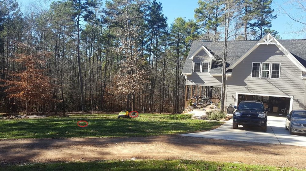

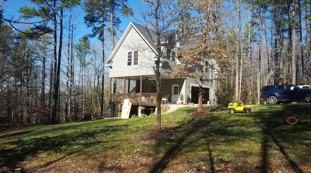

It’s about time to add on to our house, and there’s a tree in the way. I want to keep it, but don’t want to do anything weird to the house shape and design as a result. The wife is fine with cutting it down. It has grown tremendously in the 6 years we’ve been here, leans slightly away from the house, and is the only decent sized tree on that side of the house, so I’d really like to keep it for the shade and character. In order to do that, I need to move it. It’s an oak, either scarlet or red I think. It’s about 8-9” diameter at chest height, 12-13” at the base, the crown is in the neighborhood of 15ft, and it has a height of about 40-50ft. The good news is that I only want to move it ~15-20ft, in a straight line, on basically level ground (maybe 1-2ft of rise over 20ft). See red circles in pics here:
