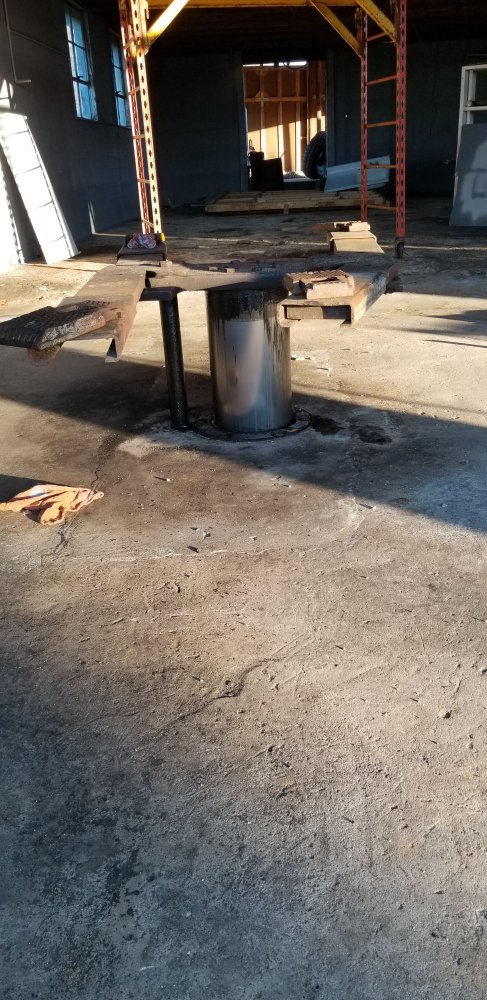

My new shop has this, and it works now that I got air to it. Anything I need to service/ know/do to it for maintenance or anything. Thank you
Been long time since I used one, what's the lift capability
Go ahead and take the time to reseal it.. if you can. Every time I see one it's surrounded by kitty litter and is slowly leaking down.
Yeah every shop I worked at with these we had thick steel tubing to keep it from slowly leaking down lol but at least this one has the safety lock on it.

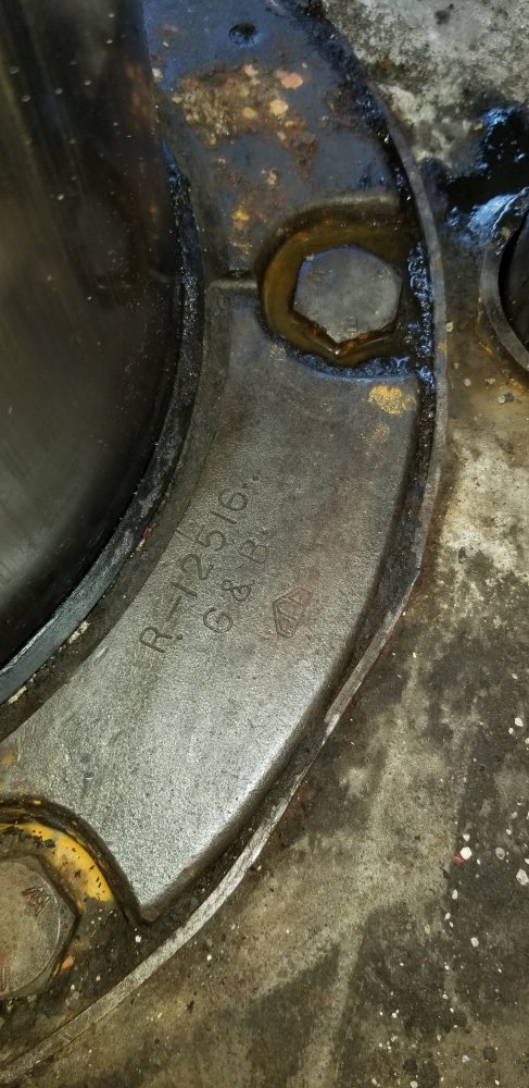

So there's hydraulic fluid in it correct? How do you "add" or can you?

You have to go underground!
Somewhere on the floor away from the cylinder you will find a pipe cap or plug, make damn sure the system is vented of air before you loosen it. That’s the hydraulic tank fill. Stick the tank to figure out how deep it is and how much oil is in it,. Too little oil and air will cause the cylinder to jump up and you’ll loose the vehicle. Too much and it vents oil when you drain air to lower and makes a mess. When cap is in place and you apply air it pressurized the tank and pushes oil into base of cylinder. Good luck, those are notorious for suddenly swinging an arm and vehicles falling off. There are no locks
Dont have one?!
I've used them I've never felt sketchy but I've also never put big ass trucks or suburbans on them either lol
If it’s like any of the others I’ve seen, it changes it’s hydraulic oil by leaking into the ground and you constantly have to keep adding and adding. Most shops I’ve seen have switched to the 2 post lifts.

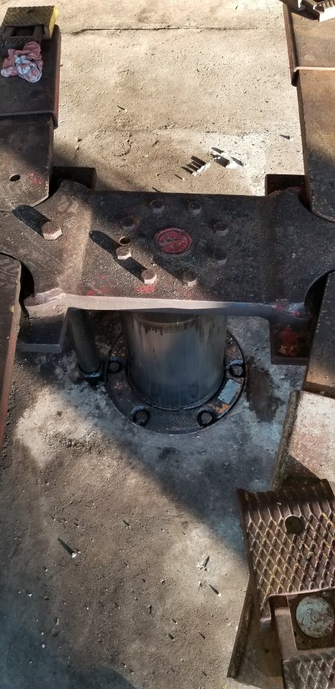

How is that possible if there is pressure on the arm? I must be missing something.

Be careful around the cap in the ground that is on the tank. My neighbor almost got killed back in the 90's when one blew off and hit him. Put him in the hospital for months and to this day he has very little memory of anything before his accident.
