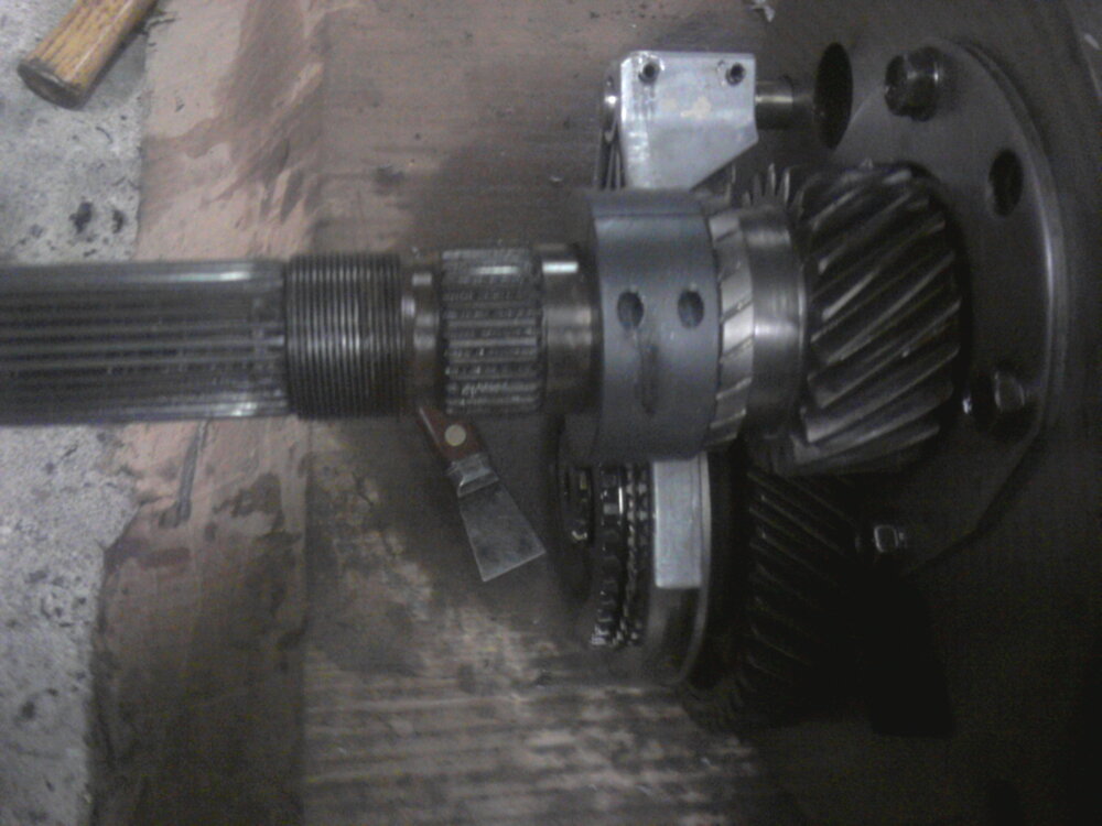

The best one I've ever seen is this clamp....which being a fellow machinist now, you could buy a pre-made clamp and machine the ID profile to fit :D You'll see the groove in the output shaft. Once that thing is on there, there's no way 5th gear can move. To hell with tacking the nut to the shaft or dinging up the threads!

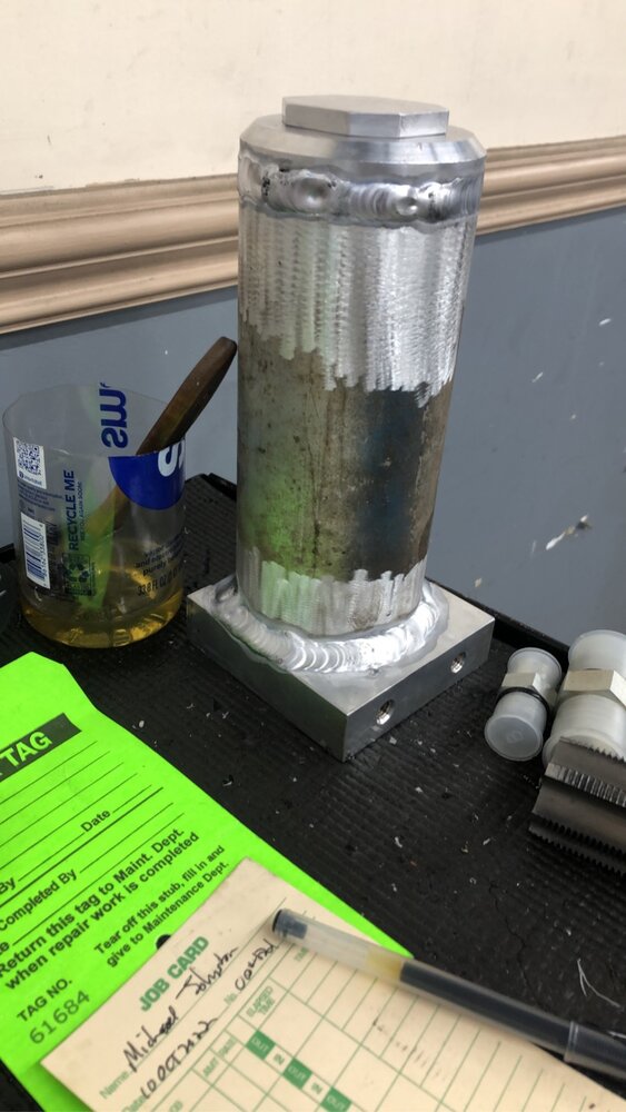

Welded up my power steering resi while my assistant shop manager was finding me some work. I’ve really gotta pick up a tig rig for the house so I can practice more. I plan on machining the outside diameter to clean clean it up and I might do a radius at the bottom of the resi so then ugly ass welds don’t show.

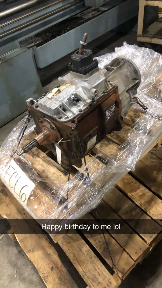

I’ve got most of it welded some stuff I’ll get to when I pull the engine and trans out to swap in this nv4500 I picked up.

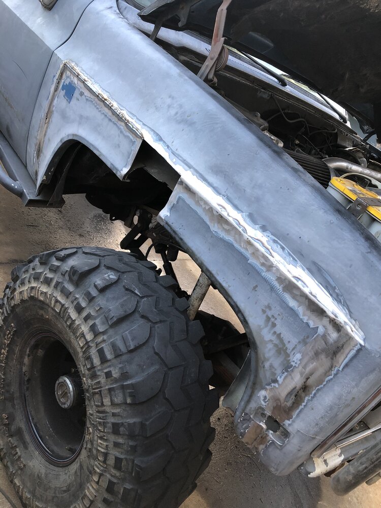

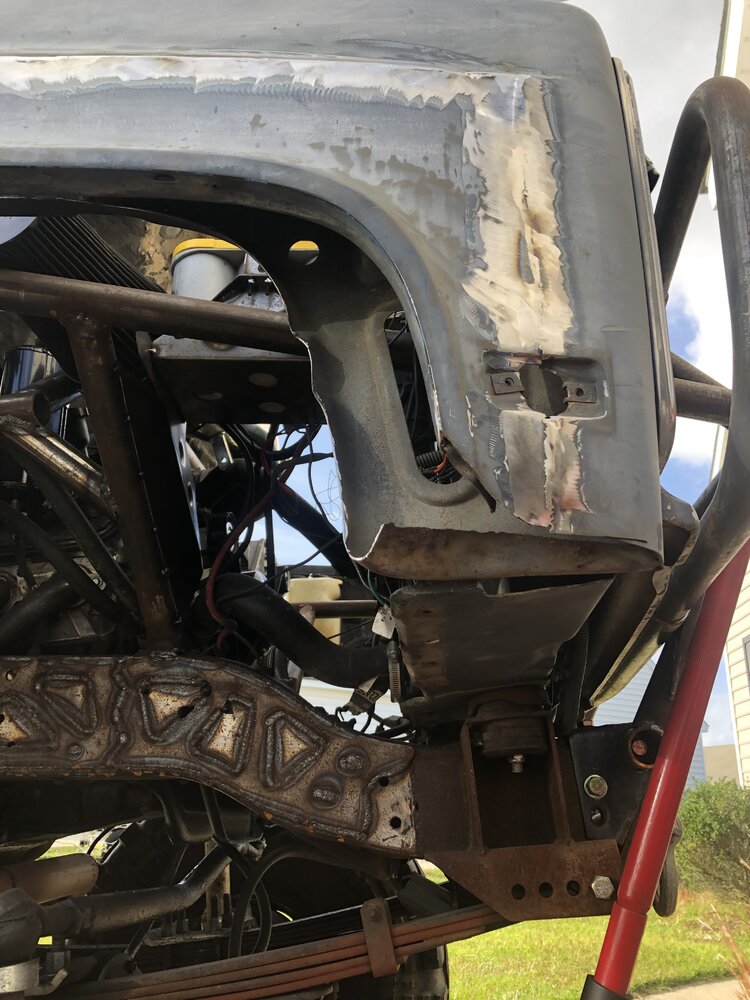

Well I got that part done, but I feel like just cruising in it since it’s a pretty day out. I’ll start my fender mods this week. Gotta get that done, weld on end caps to the sliders, lengthen the front drivershaft, build a traction bar, figure out if I want to just put the 5.38s in rear so I can take forever to get to uwharrie next month. I’ve gotta decide on some things so I can get this thing in the woods here soon.

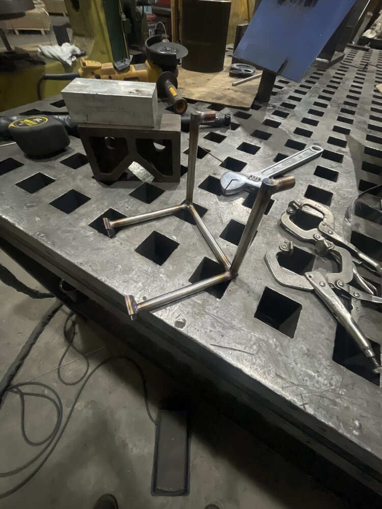

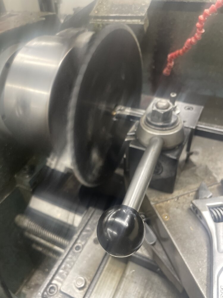

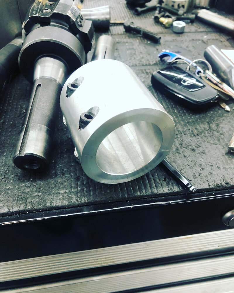

Made the clamp I’ll build off of for the power steering resi, I’ve gotta see if I’ve got time to wire EDM it or I may just do it on the bandsaw

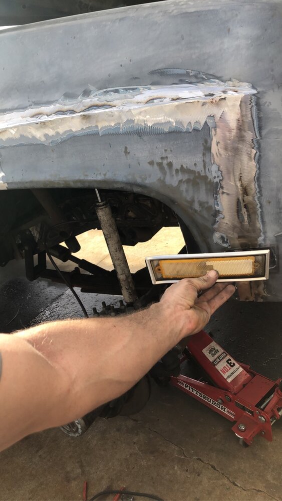

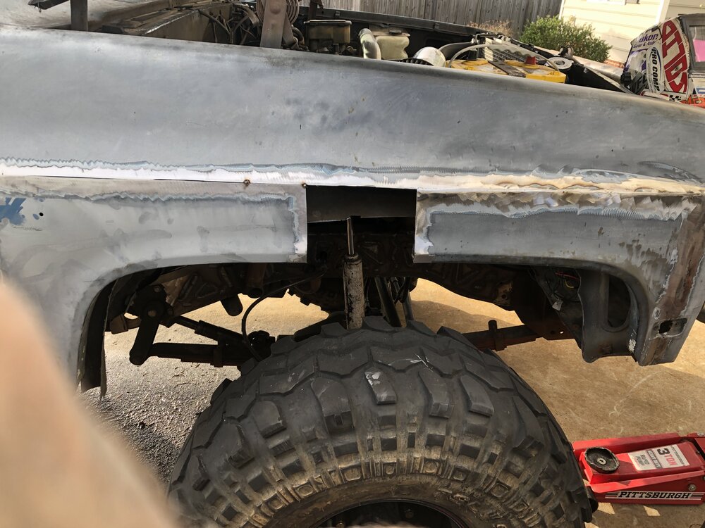

Made the wheelwells 7 1/4” wider on the passenger side. Gotta finish that side and do the driverside tomorrow.

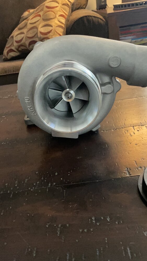

But one day this 70mm tsunami slinger will find its way on a LS powered square body. My daughter ain’t gonna be impressed easily to say the least.

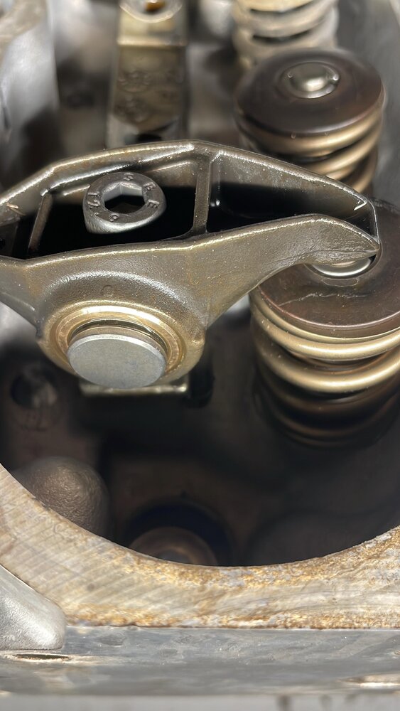

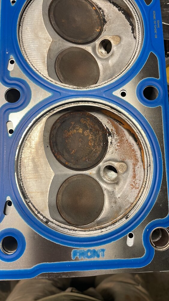

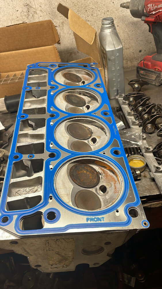

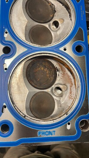

Well made a little more progress and decided I want to do more work, lol. Picking up a can of layout fluid from work and then scribing the head gasket on the heads. Gonna break the shaper edges in the combustion chamber and blend them a little. Also going to clean up the valves and lap them back in. Had to put a dual spring, and tool steel retainers to see if everything would jive. The 5th gear lock nut, figure 8 adapter, and 32 spline input should be here today as well.

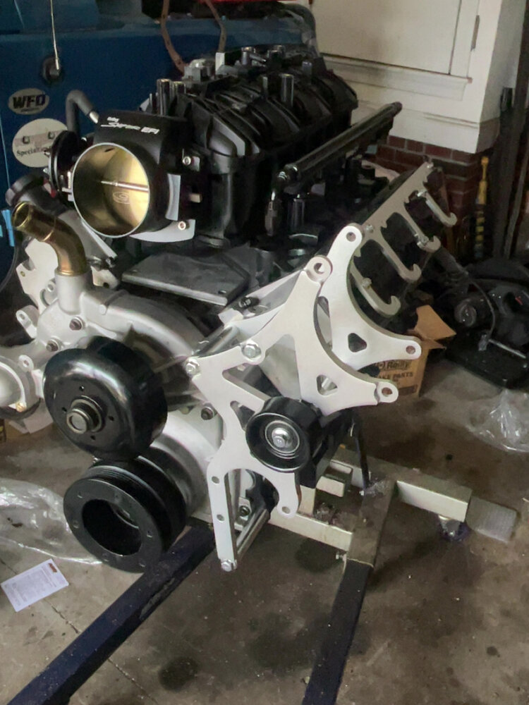

Well I’ve made some time to put the long block together, but I haven’t decided what I’m gonna do with the valley cover. Debating taking it to work and surface it to smooth it out and make it look a little better. My plan is to make it a 100% complete just plug it into the existing harness after bolting it in. So I’ve got another power steering pump, need to pick up some flex fuel injectors, IAC, TPS, plumbing the new fuel pressure regulator setup, buy another alternator, belt, and tensioner.
