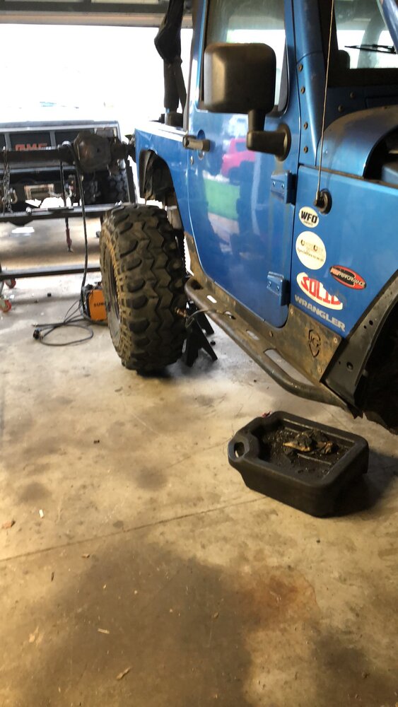

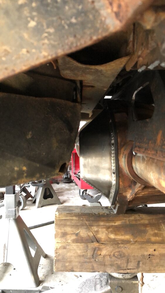

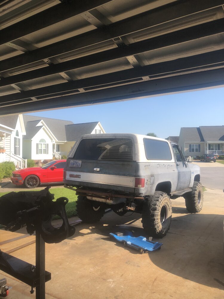

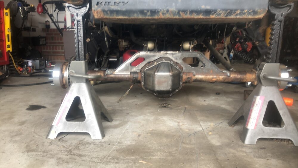

I put the rearend back under it, all I have to do is jack up the pinion a little bit with the axle sitting on the ground and the bolts slide in fairly easily. Frame is clearanced for full bump, need to order some bump cans and come up with a bumpstop pad. I need to exchange my bottle Monday and I can get to burning a lot of stuff in. My fancy spines pieces can’t go all the way to the axle tube because of how close clearances are at full bump. I still plan on doing them but just to cover the flat parts on the top of the truss. I’ve got to figure out how I want to do my lower shock mounts and out board them as far as possible.

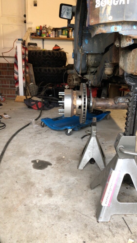

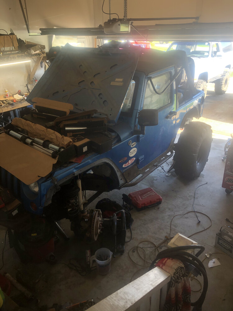

I swapped back out to the 38.5s on the k5, looking to do a gear change to it as well soonish. The 39.5s are mocked up on the Jeep, I need to order some unit bearings for the front so I can start mocking up the front soon as I finish welding in these filler plates on the frame. I’ve got to do my rear coilover mounts and bump cans, and my plan is to drive it out of the garage on the bumps and back it in to do the front. Anyway more pics,

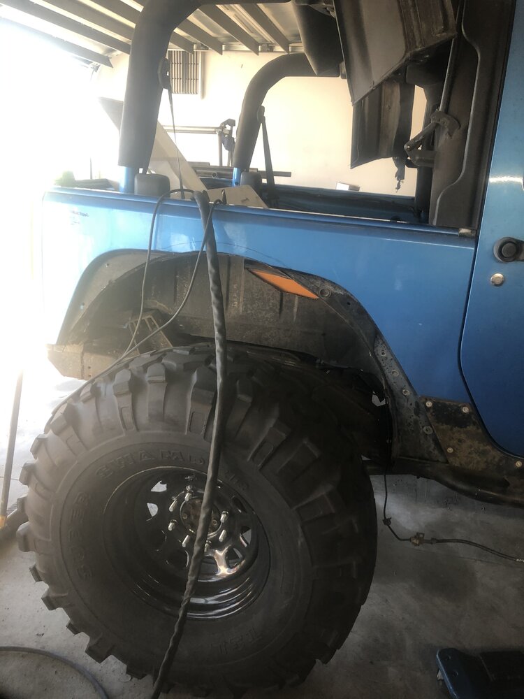

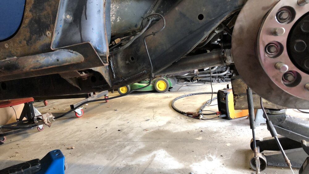

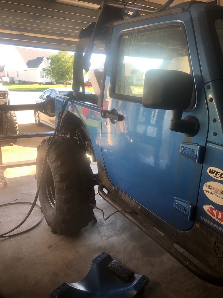

I like this fender to tire gap ratio. Mainly Bc I know I’ve got to cut a little higher to clear 100% full stuff and driverside drooped out 100%. Eventually I’ll remake the whole inner fenderwell. And skin the outside with 1/8” sheet. I’ve got an idea for a rub rail but not the towel rack looking kind. If steel ever goes back down I’ll need to cage it. When the 3.8 pops I’ll likely LS swap with a 4L80e. Keep the 4.0:1 t case.

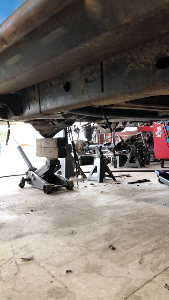

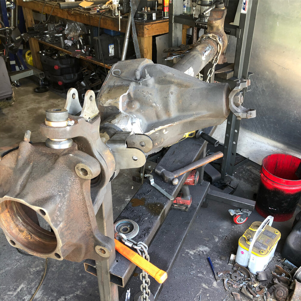

Also started cleaning up the 60 front, gotta do the cast part now and flapper wheel the other side.

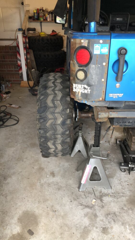

Fixed my back window today, now my GF won’t complain about the fumes. Had a plug wire work itself loose, also need new boots since these now after two years have burn marks on them. I need to pull the plugs and check them, but it’s a whole different animal with 5.38s and 38.5x14.50s on it. Likely going to 4.56 so I can actually drive it on the highway. I need to wheel it again soon I’ve got that itch kind of bad and the Jeep is a few months away from being finished.
Get on Summit and get a set of MSD wires. The ones with the flexible ends. You can bend them to whatever angle you want. Then hit up ebay for some heat socks to go on the boots. No more issues :D
I’ve got the heat socks on them. OEM plug wires don’t work but the 135 degree ones clear pretty decently. The socks don’t touch the header tubes but your like 1/4-1/2” away from them. But even then, these block hugger headers I ran in order to clear a Y pipe to get my exhaust around the t case being clocked up still you can see the white spots on the socks where they do get rather warm where they are at. I’ve been thinking of getting some ceramic booted plug wires and doing away with the socks one day.

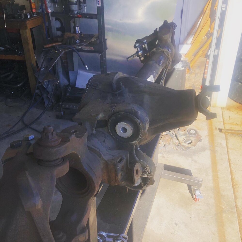

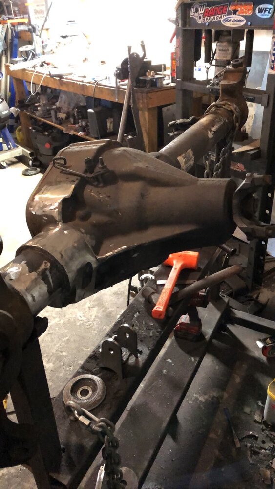

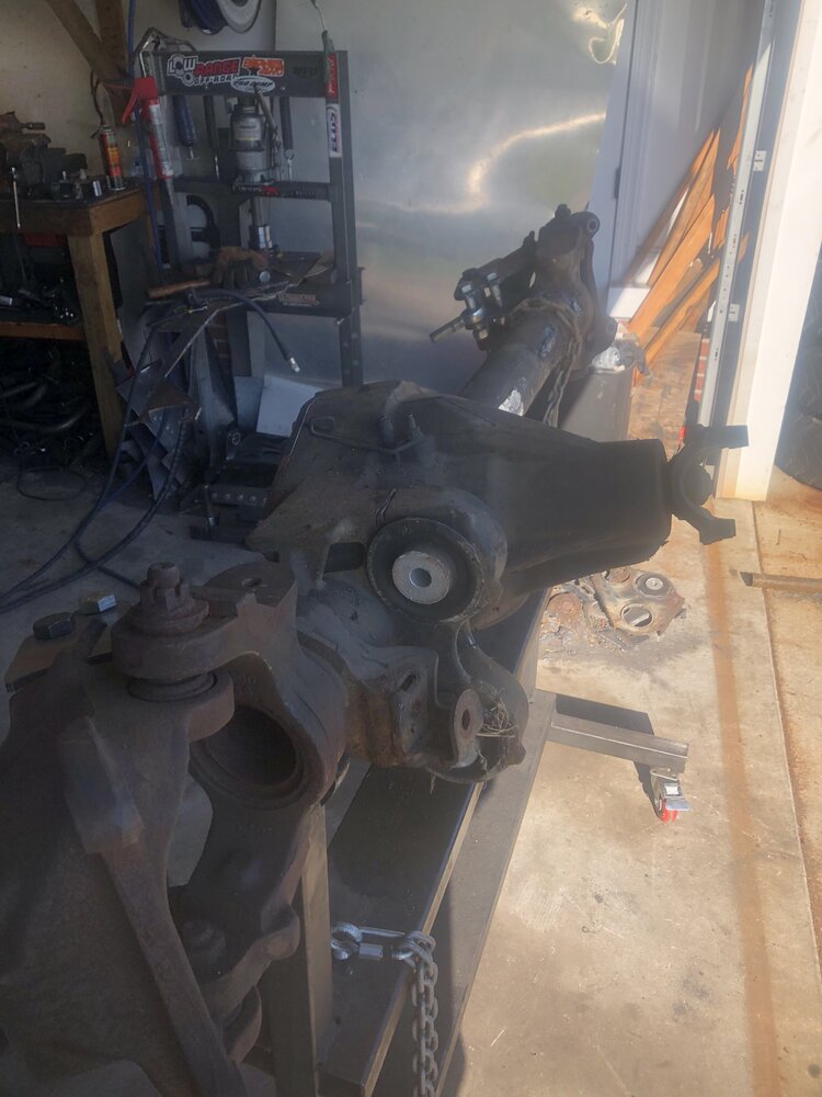

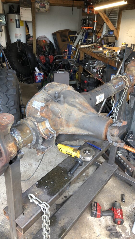

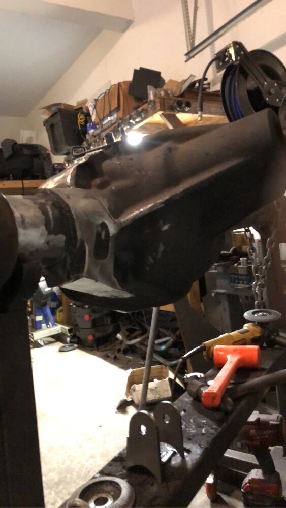

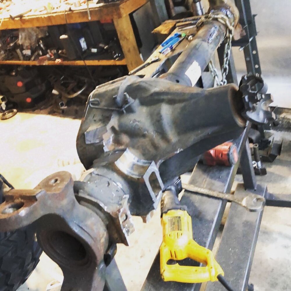

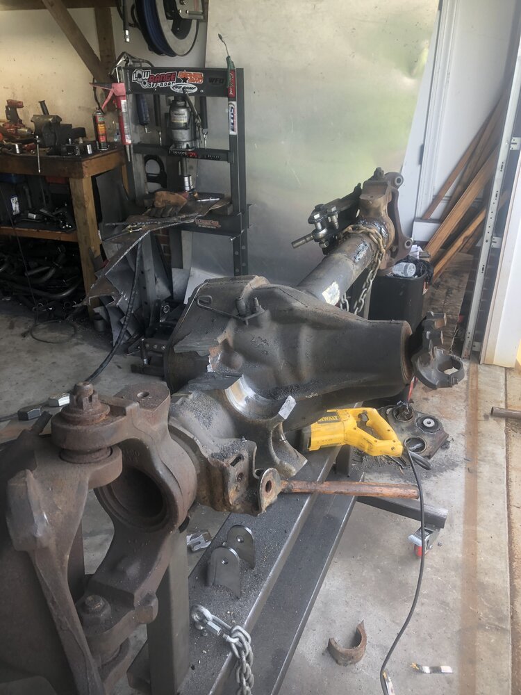

Got some progress made on tearing down the 60 housing and trimming off that driverside bracket. Need to pick up some more longer sawzall blades and I got the torch swapped out on my cheap plasma cutter to get ride of the rest of that shock mount.
got most the casting cut off, need to pick up some longer sawzall blades and some cut off wheels to finish it off. I’ve heard rumors that this was a pain in the ass. It’s really not all that bad once rhe shock mounts are out of the way. I used a sawzall and cut off wheel to score the casting around the tube, then plasma cutter to cut the casting, then hammer and chisel to pop it off. I need to order some more 3/8 thick flat bar to make the front truss, gotta figure out how I want to do my bump stop mounting pads. Also I think I’ll tie that driverside control arm mount into the truss because there isnt much space to weld it. Also hoping the 10 degree lower control arm mount will allow the 38” lower control arm to clear the front shaft. I like a lot of caster (8-10 degrees) on my stuff so it handles good on the

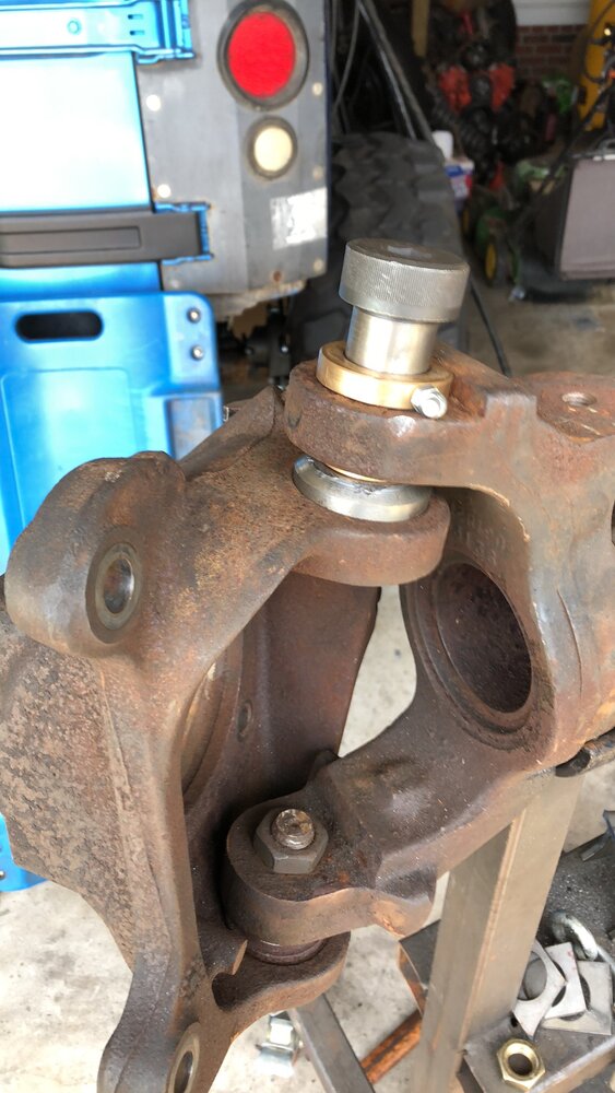

the nick burna ball joint eliminators are stupid beefy
Got the casting part all done, need to weld around the tube on that side and finish cleaning off the passenger side. I’ll likely do that tomorrow after my job interview. Hopefully with getting an actual job I’ll be able to fund my builds easier and get more stuff done. Scraping by every month and devoting a little here and there towards my builds just ain’t cutting the mustard living off my retirement stuff from the Army. Honestly I should have gotten a job as soon as I got back to NC in April 2015 but I was all snooty and felt I could easily sustain off what I was getting. Which is true but I can’t have the stuff I want like that. Anyway enough of my personal life issues and on to pics.

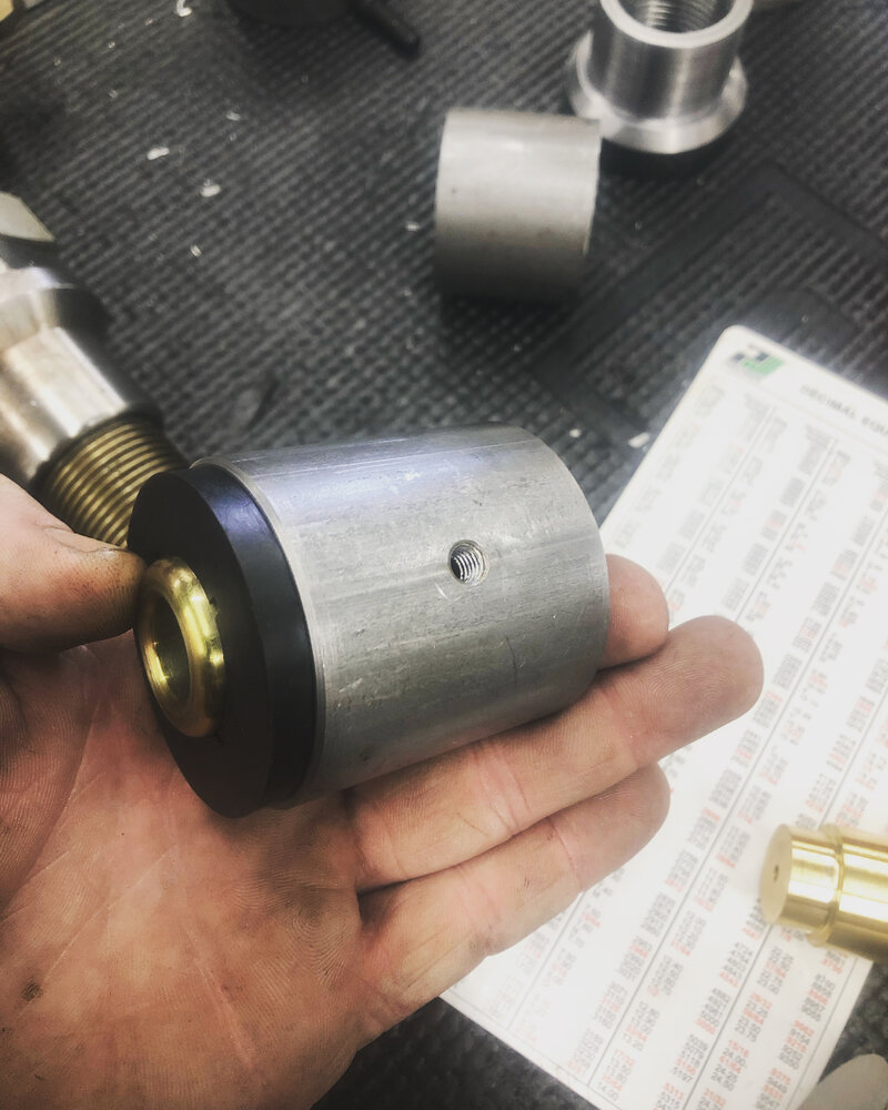

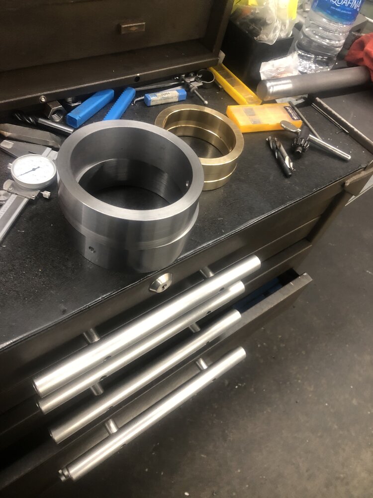

some bushing sleeves I made at work the other day. Out of 5” diameter 1” wall DOM

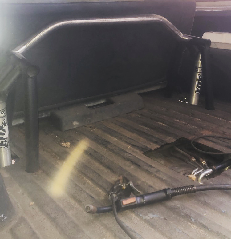

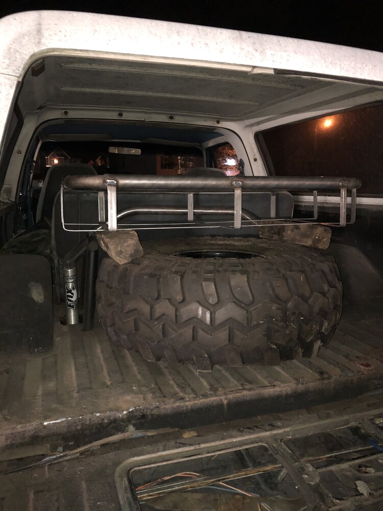

Been making things at work for the Jeep, finally bent up and welded in my crossover tube for the k5 rear shock hoops. I’m making a basket to go over the spare tire. Going to make some brass bushings this week to make a pivot point for the basket. Going to dimple some aluminum panels, I may even bead roll them too. Really just because I want to play with my man toys. Working away from home, really makes me enjoy these projects but I really need to get these front frame plates welded on this weekend, and get the front shock hoops setup. If I can get the fenders trim, then atleast make a few panels keep the air filter and electrical bulkhead free from moisture and debris I’ll totally make it to uwharrie for Veterans Day.

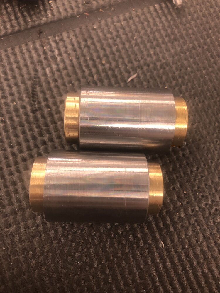

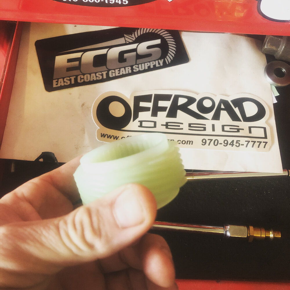

Made my bushings and barrels for the k5 basket pivot point on my lunch break.
Somebody was back dragging his tool :D
You know no I’m not sure how the barrels got it, I know the bushings got it Bc I was rushing on those.
Pffft....it's fine. We all do it, I just try to remember not to on my final pass if anybody has to see it before I go shove the bushing in a hole. Airplanes and what not, you know...I guess they want it to look good or something. :rolleyes:

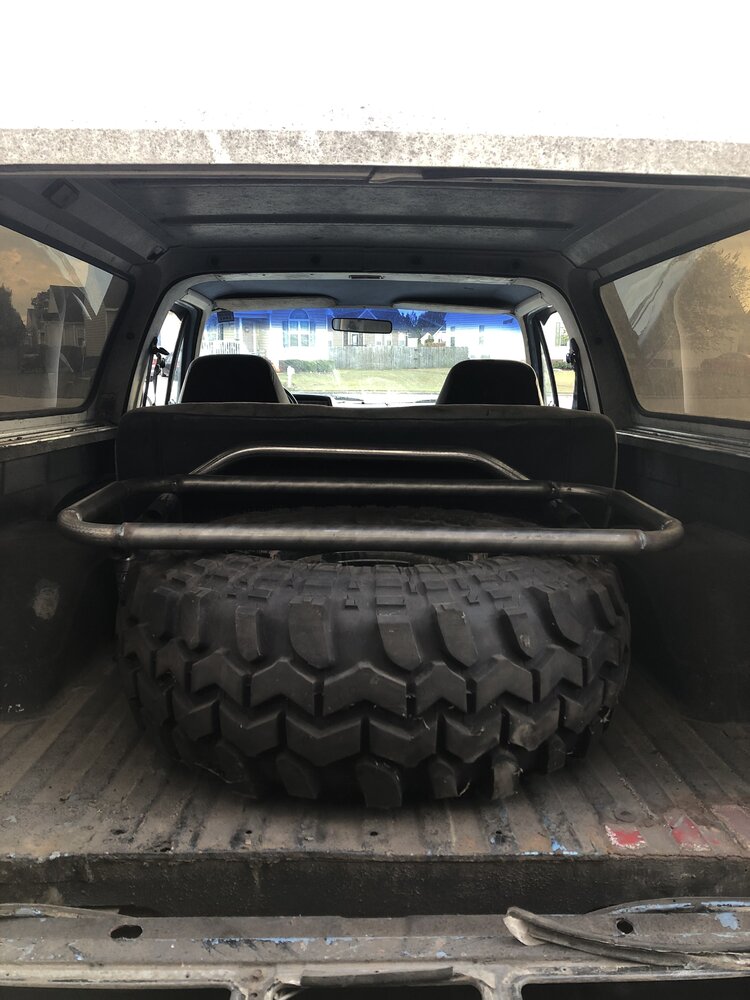

Finally got most of the basket made, now for mounts after I decided how much I want it to be above the spare tire.
