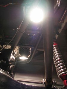

Installed the center and rear rock lights tonight, and then remembered where the exhaust might go. Damnit. Gotta move 'em.
I purposely left alot of open space between things, and I can see everywhere those lights are except for in front of the RF tire. It's neat to look down & back and see what your driveshaft is hung up on.. (Not that it'll be an issue anymore)

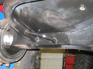

Since there's no way to get an axle strap around the tube on my axles (especially the front), I added these tie-down points. old u-bolts are good for something! (Thanks RK)

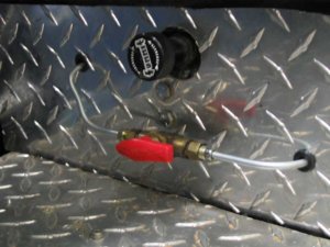

And, the proportioning valve & line lock, just under the seat.

Looking good. Do you think that u-bolt has enough weldable surface to be a strong tow point? Think of places you won't be able to get out of in that. They'll be nasty.
My bad.. I didn't read the "tie-down points" part of that. Sorry

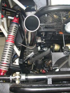

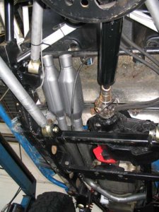

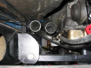

A few pictures of the exhaust work.. a VERY complex system, to be sure, especially up front. The sound is fawking GREAT though.. Deep, rumbly, and nice and agressive when you get on it. Not *too* loud, but you know it's there.
2.25" pipes through 2 Hushpower II mufflers (17" case), into a 3" collector, then out a :bling:stainless steel tip that they had basically installed before I even knew what was up, but it actually looks pretty good in person, IMO.
The hushpowers are nice because they're double-walled, so they don't radiate nearly as much heat as a regular muffler. I am going to be wrapping the pipes this week where they go under the floor, and also under the cooler.
