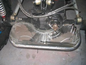

Maybe this was covered already or you just have not got to it, but the rear pinion disk looks vulnerable to some rock rash fro the pix.
Haven't gotten to it yet, but you're right. It won't be once I'm done though... :D

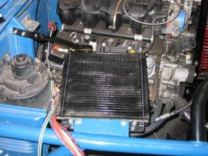

Got the power steering & transmission cooler mounted up.. Was a pain to find somewhere where the tires wouldn't throw things at it, or where they weren't too close to heat. The fan blows up from the bottom, and the hot air will exit out the louvers in the hood..

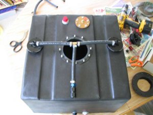

Did the Holley multi-pickup kit also, center of the cell, one at the front, one at the rear. This is just showing the mockup.

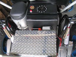

And, the rear area is complete.. fuel cell & cooler are mounted. Amazing how fast the room got eaten up!

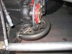

Also made a guard for the pinion brake, complete with speed holes..
Looking good! I like the speed holes! Now you have a nice table on your rear axle to eat off of! :D
