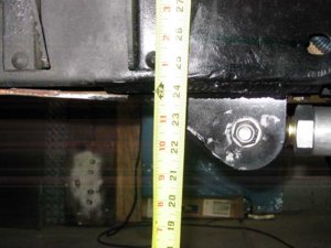

In an attempt to get the rig back down to my target height/uptravel.. Not to mention the spring rate was waaay too high. Anyway, the goal was 24" under the belly at trail pressure (7front / 6rear) with 5" uptravel F&R.
Well, I didn't get that.. I knew it was going to be difficult, especially for a first attempt.
I've got a little over 6" uptravel at 24" belly height!! :bounce2::bounce: I'm expecting the springs to settle in some, as 6/8 of them are new. But still.. I'm MORE than pleased.

Belly height

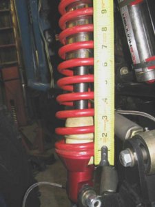

Front shock

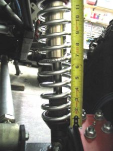

Rear shock

It weighs 4640..It did really good at Harlan, the tires "came in" halfway into the 1st day. Took me into the 2nd day to start staying in the gas on things.. Had a blast after that! The rear shocks are too stiff, I do need to re-valve them, hurts me on climbs.All in all, I'm REALLY happy with it.. The only other thing it needs are some boot guards, BAD :D

From talking to the suspension guys, it seems like the compression valving needs to come down some.
