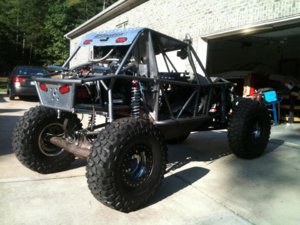

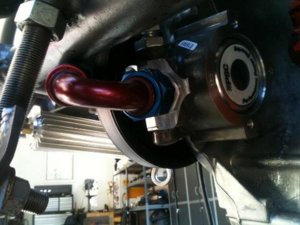

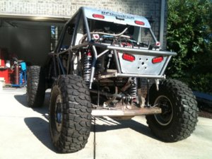

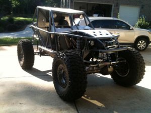

New pics and race ready. It is lighter, narrower, and faster. Got a secret weapon for the steering pump finally!

Yea your not kidding. Just bought a house so life is taking over plus I wanted it to be perfect this time. The pump company is not the secret. Its the kind of pump. Lets just say you dont have to worry about feedline being perfectly fed into pump or bleeding for that matter.
